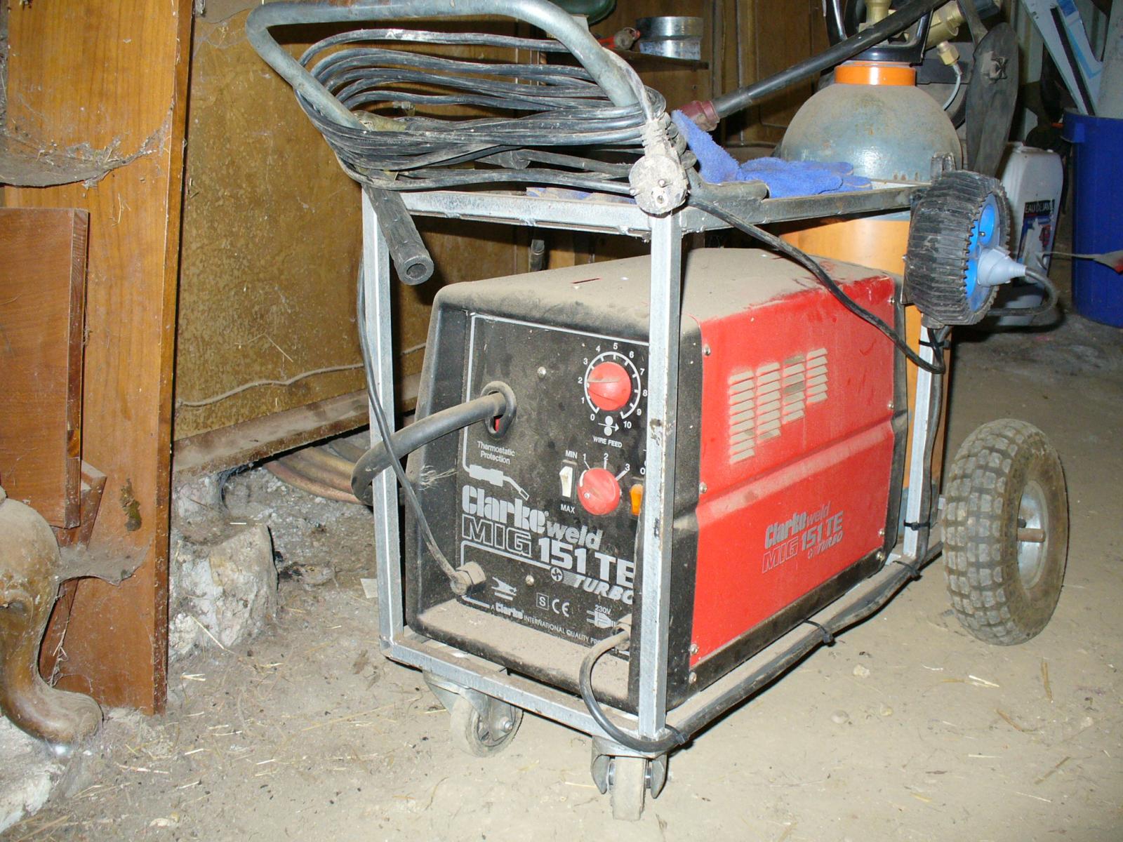

The best thing about my old SIP 150turbo welder was the nice thick side panels which I cut up to use as repair sections on a car chassis and to make a cart out of the leftover bits for my Clarke 151.
