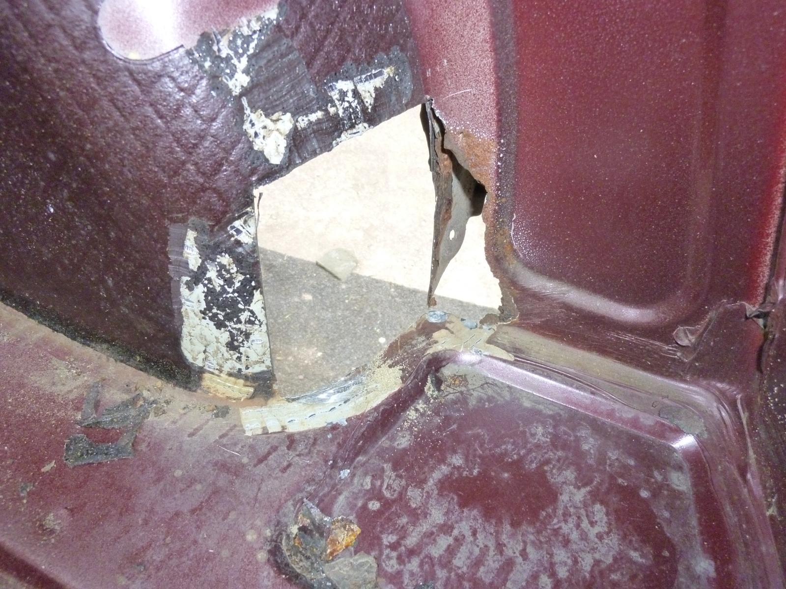

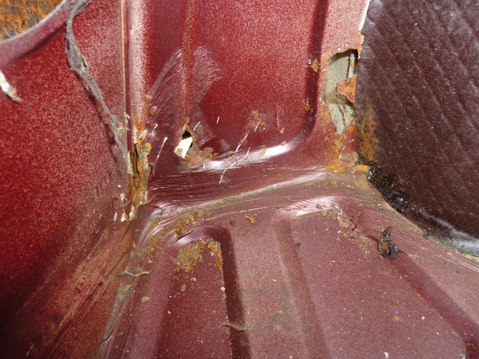

So back axles on these are an easy job, done loads over the years. Wasn`t expecting to find so much rot thought which I discovered while the boot carpet was out. rear floorpan rotten too. Ah well,I`ve gone so far now I have to finish it and besides the car is worth bugger all with no mot, the only financial value is the engine which is worth £150 all day but I doubt any other fool would repair it so I have to fix it to save its life. I quite like it though and will probably use it as a run about, the auto box really suits thesepost-19511-0-92671000-1467919453_thumb.jpgpost-19511-0-23329000-1467919572_thumb.jpg

At least it's a fairly easily patched part where you can access it. Once it's welded up its done then.
