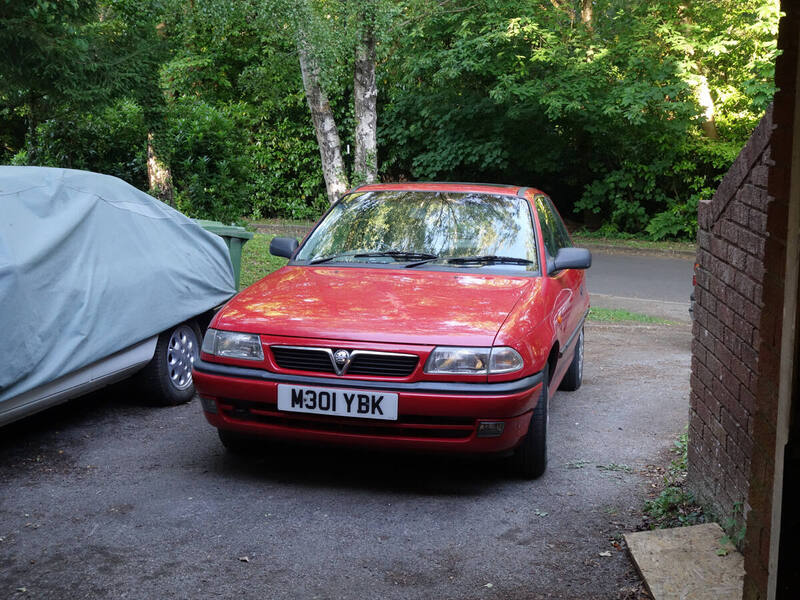

The car is in the bodyshop.  I visited today and it is all filled and ready for the next stage, but I had said to them 'take as long as you like' and they got some vans in which are in need of immediate work.  So my car waits, which is perfectly ok as it has given me an excuse to get 'the other' Astra out.  That's my red, two owner from new, LPG 158K mile much cleaner car.  Which begs the question: why do I have two?  I have no idea.  But I got it out of the lockup this morning and have used it for charity food deliveries today.  Some people were really pleased to get some food today, what crazy times we are in.

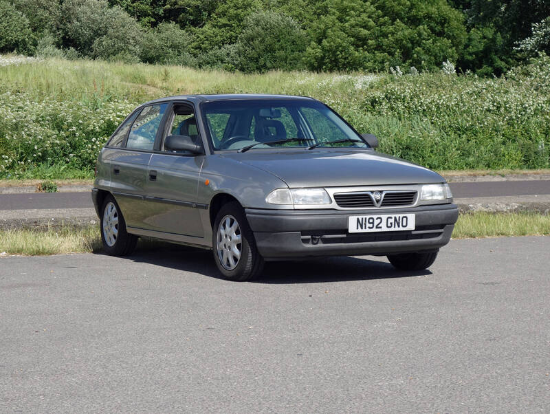

It is back.  They painted the drivers side front wing, which replaced the totally rotted one at the bottom, painted and stone chipped the drivers side sill which was scabby but not rusted through or anything, filled and painted the rear arch drivers side, painted the top half of the drivers door, painted the bottom half of the rear wing and cleaned up the rear arch on the passenger side, again not rusted through and painted it and the bottom half of the passenger side wing.  I put most of it back together though they put the front wing on.
It looks a lot better than before.  I had been told that this was a difficult paint colour to match and they said that they had eight variants but still were not happy with it.  It does show but I guess that's why complete sides of cars get painted.
