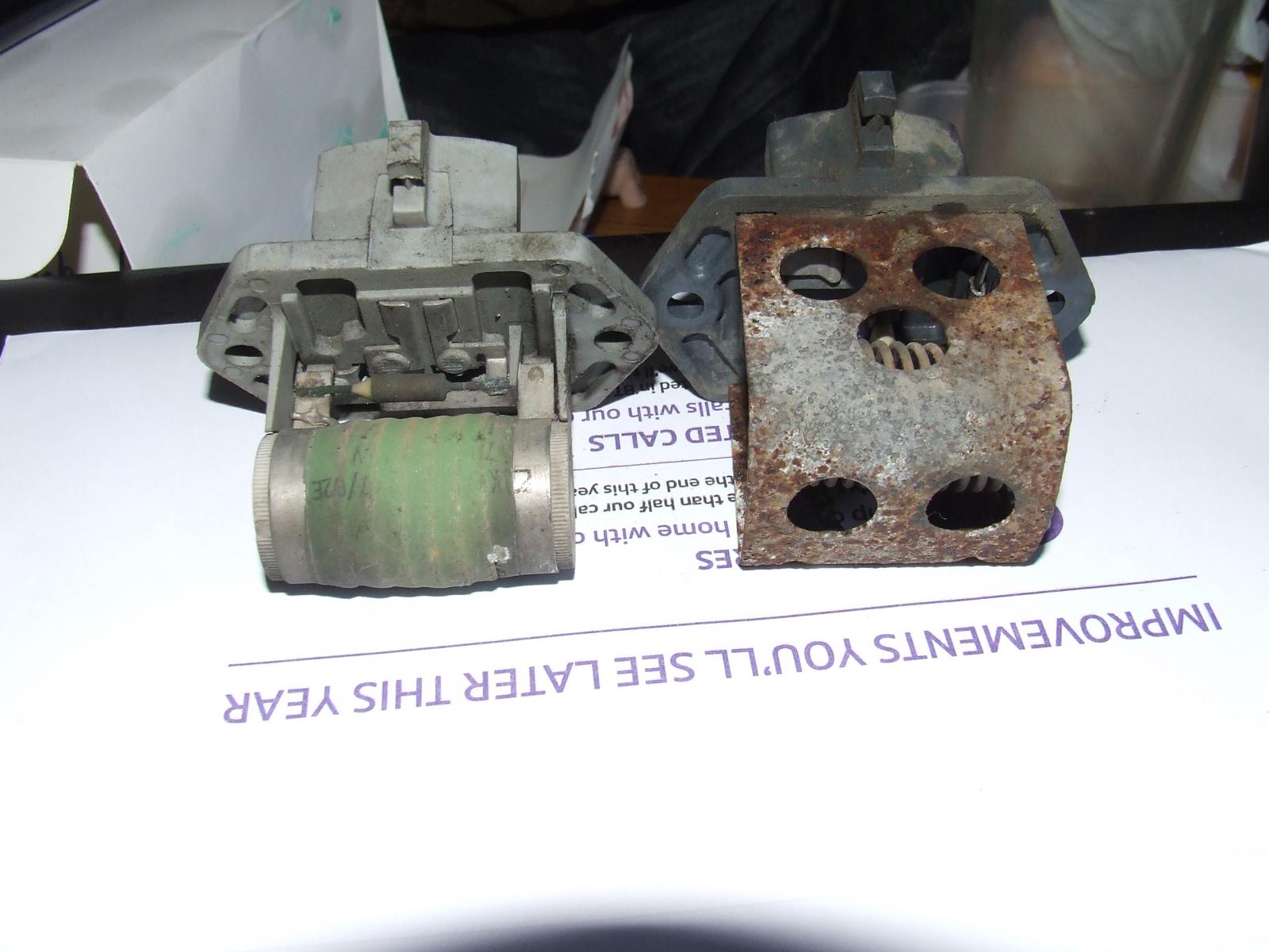

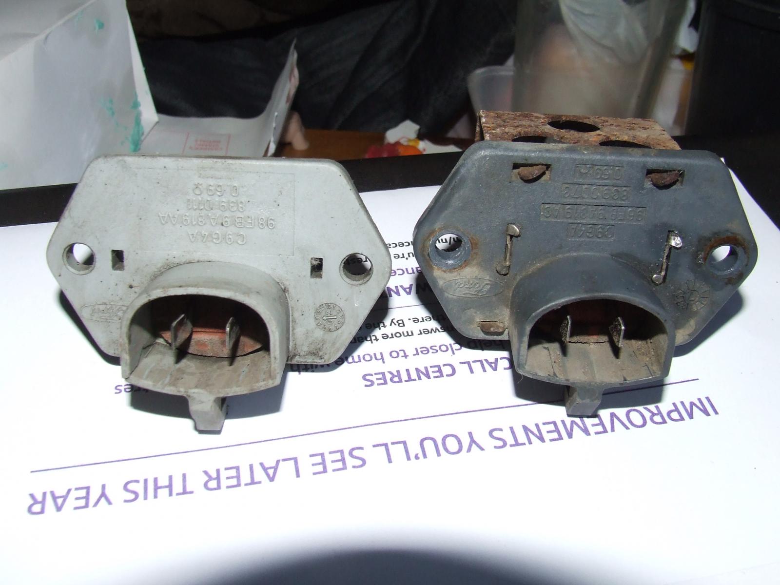

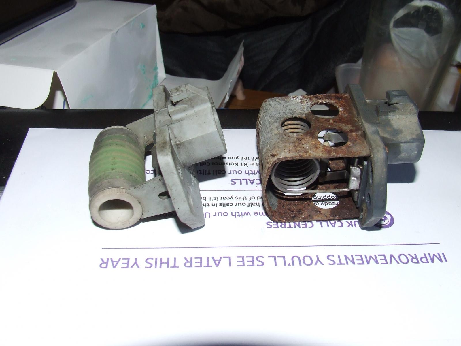

hairymel Posted May 24, 2016 Posted May 24, 2016 i have had a rummage and have retrieved 2 rad mounted resistors, 1 from a mk6 fiesta and another from a random mk4/5fiesta/puma fan housing. to my untrained eye they look interchangable and are both marked 0.69ohms if you need one/both drop me a pm with your address and i will pop them in the post
