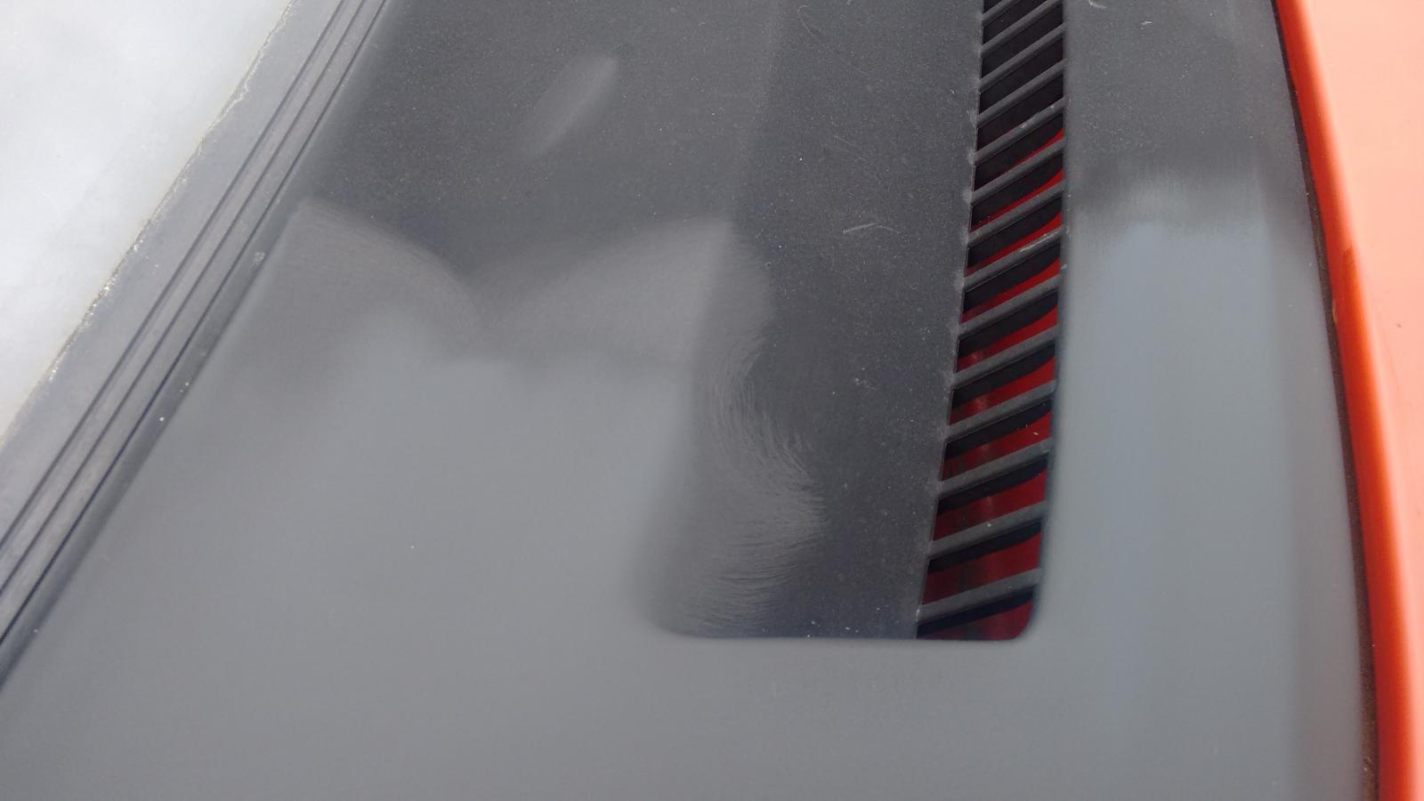

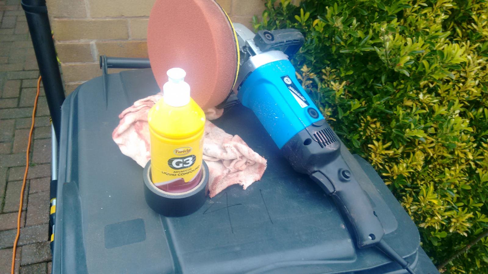

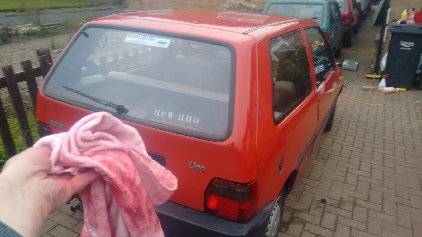

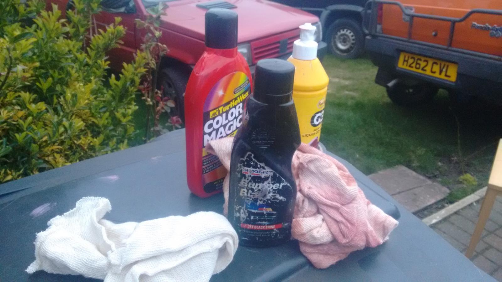

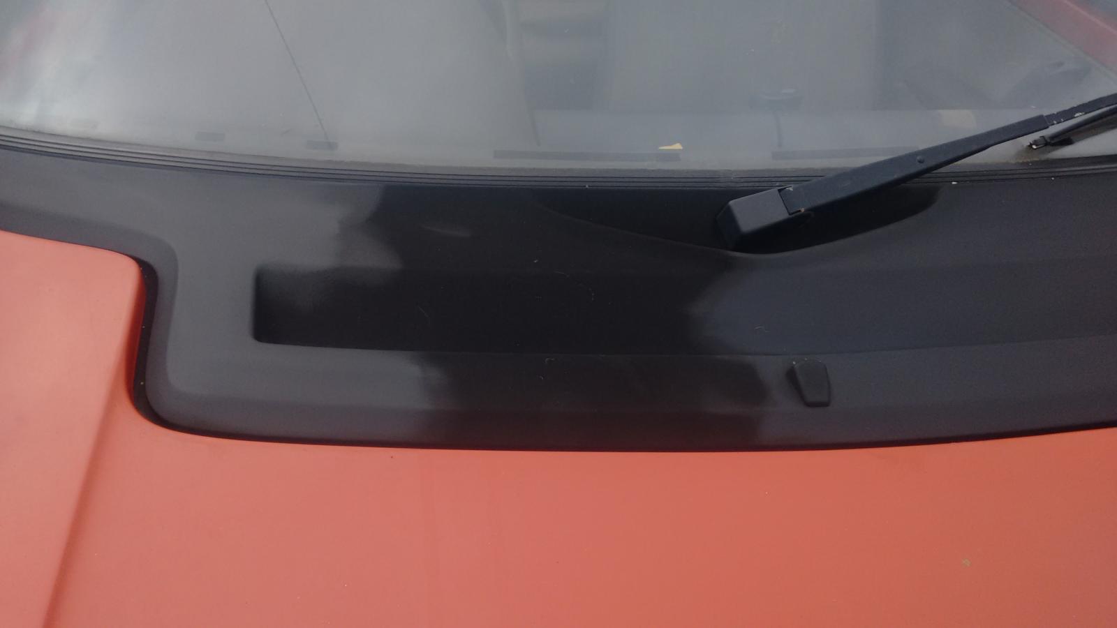

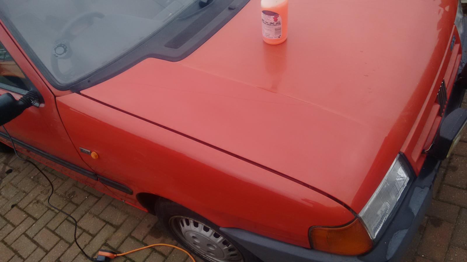

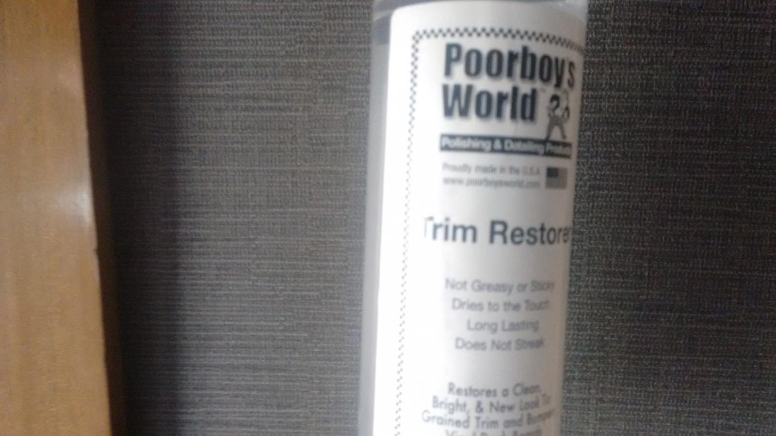

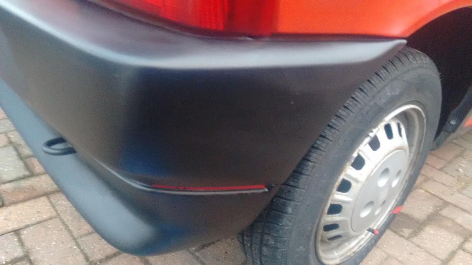

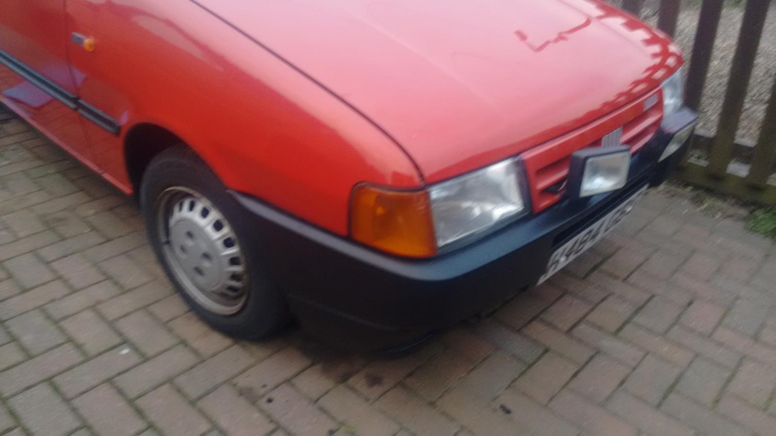

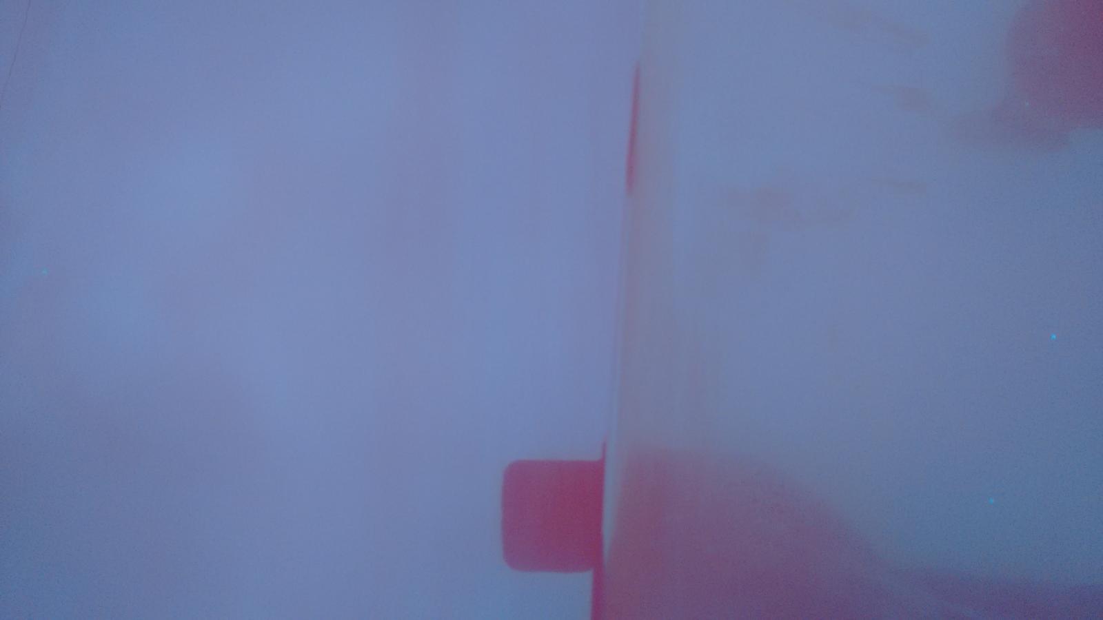

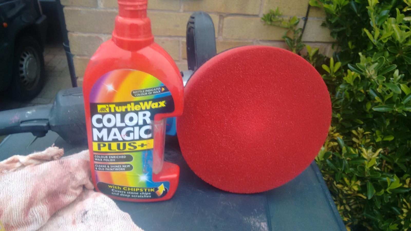

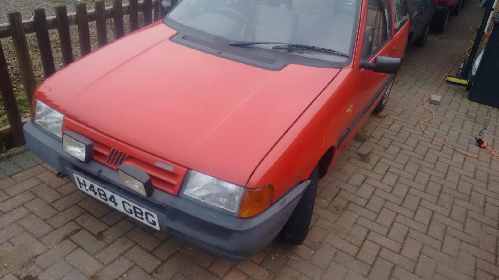

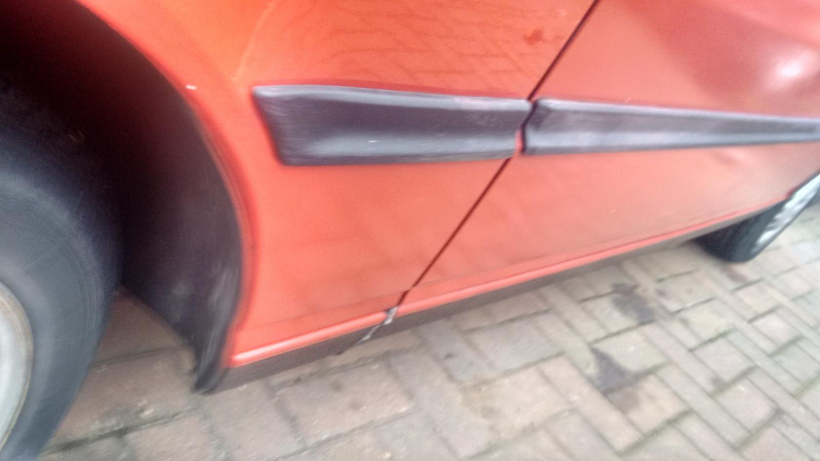

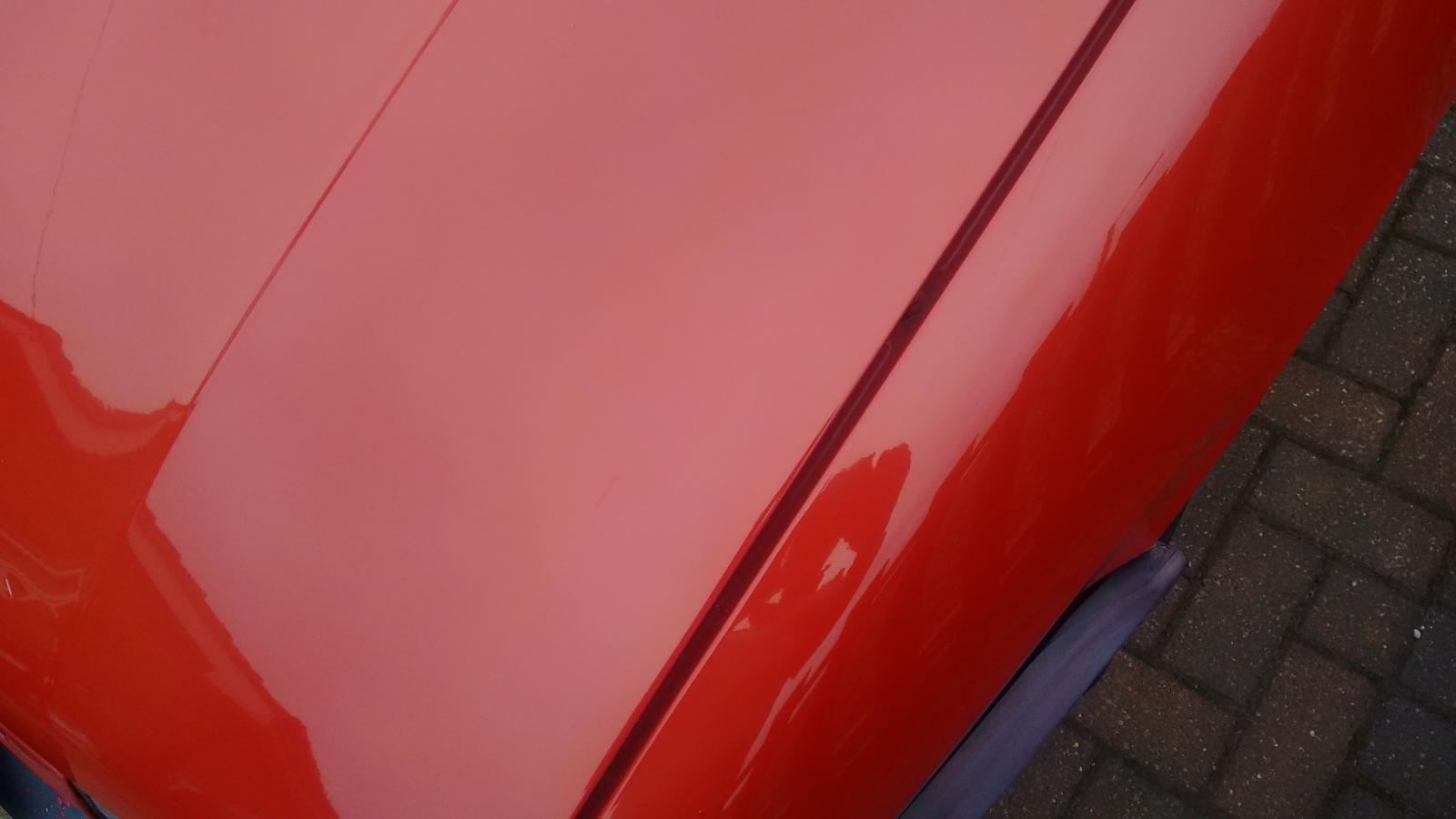

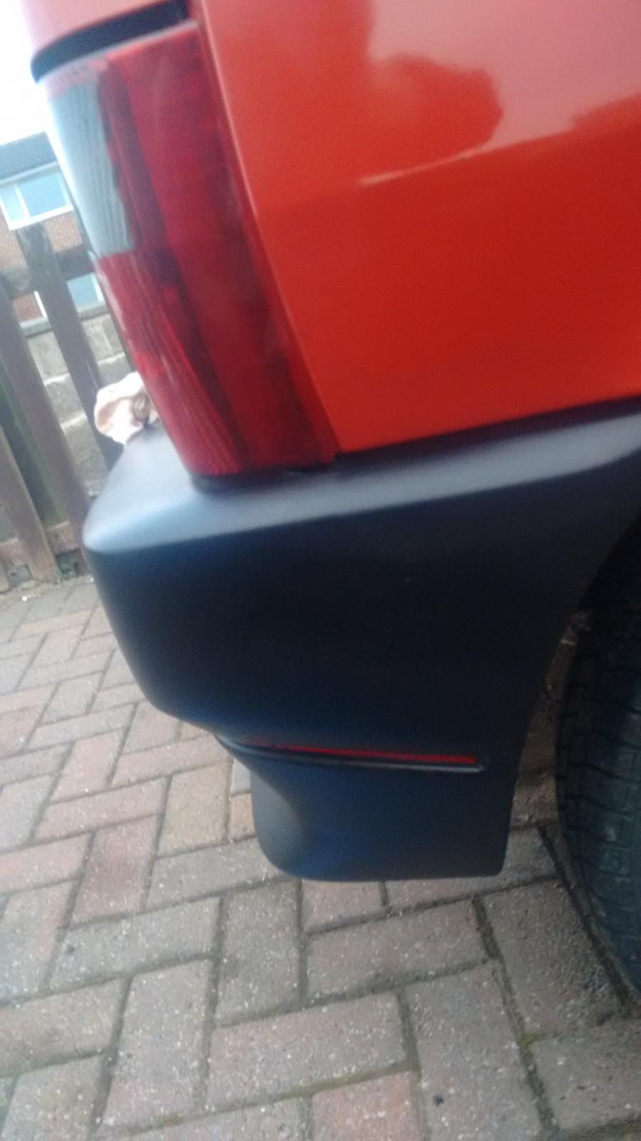

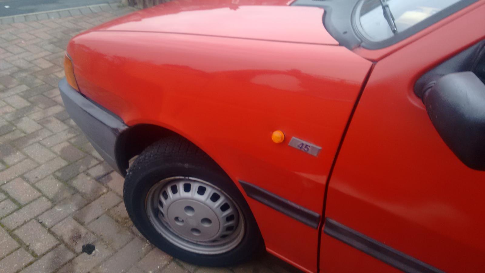

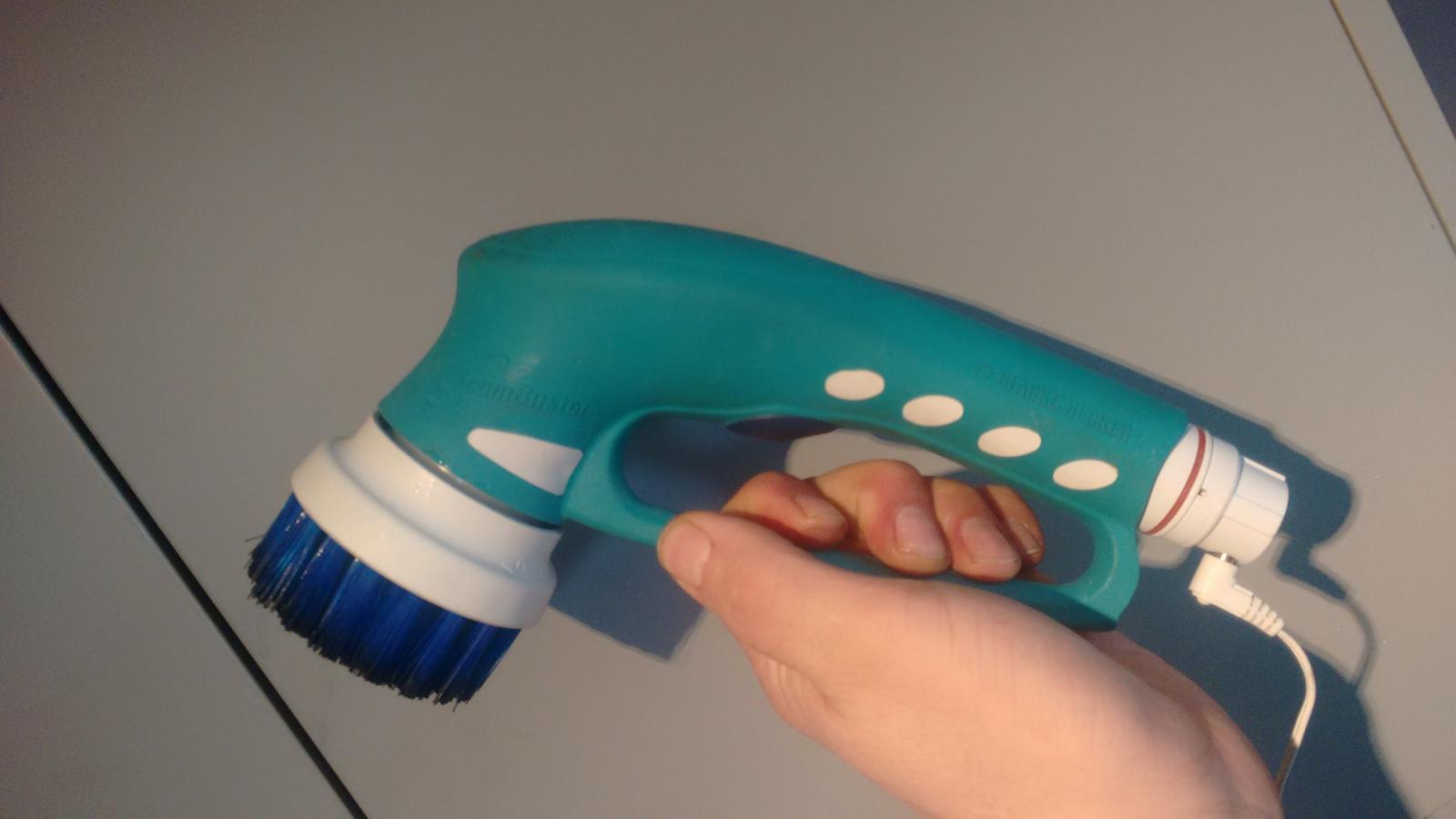

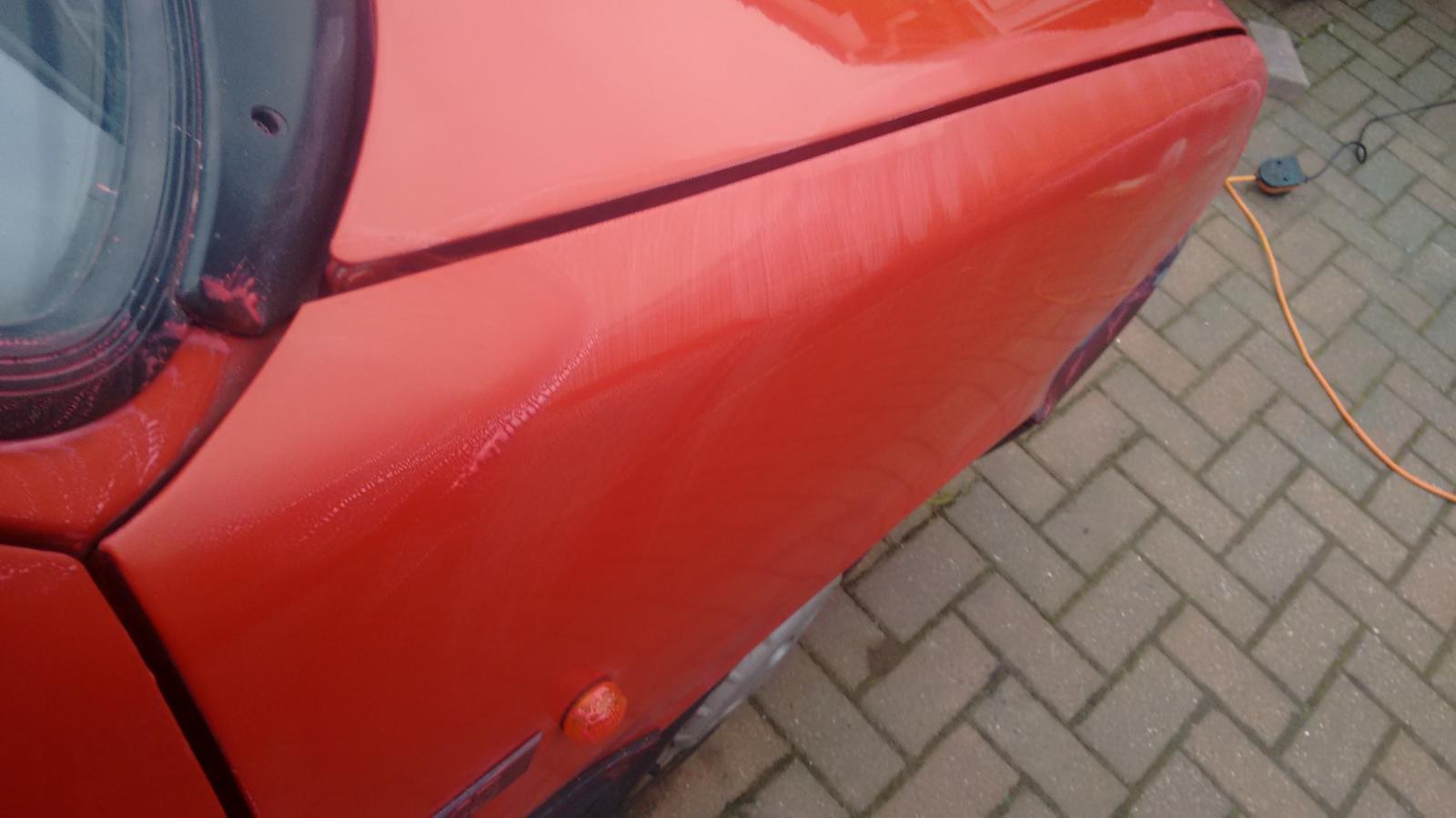

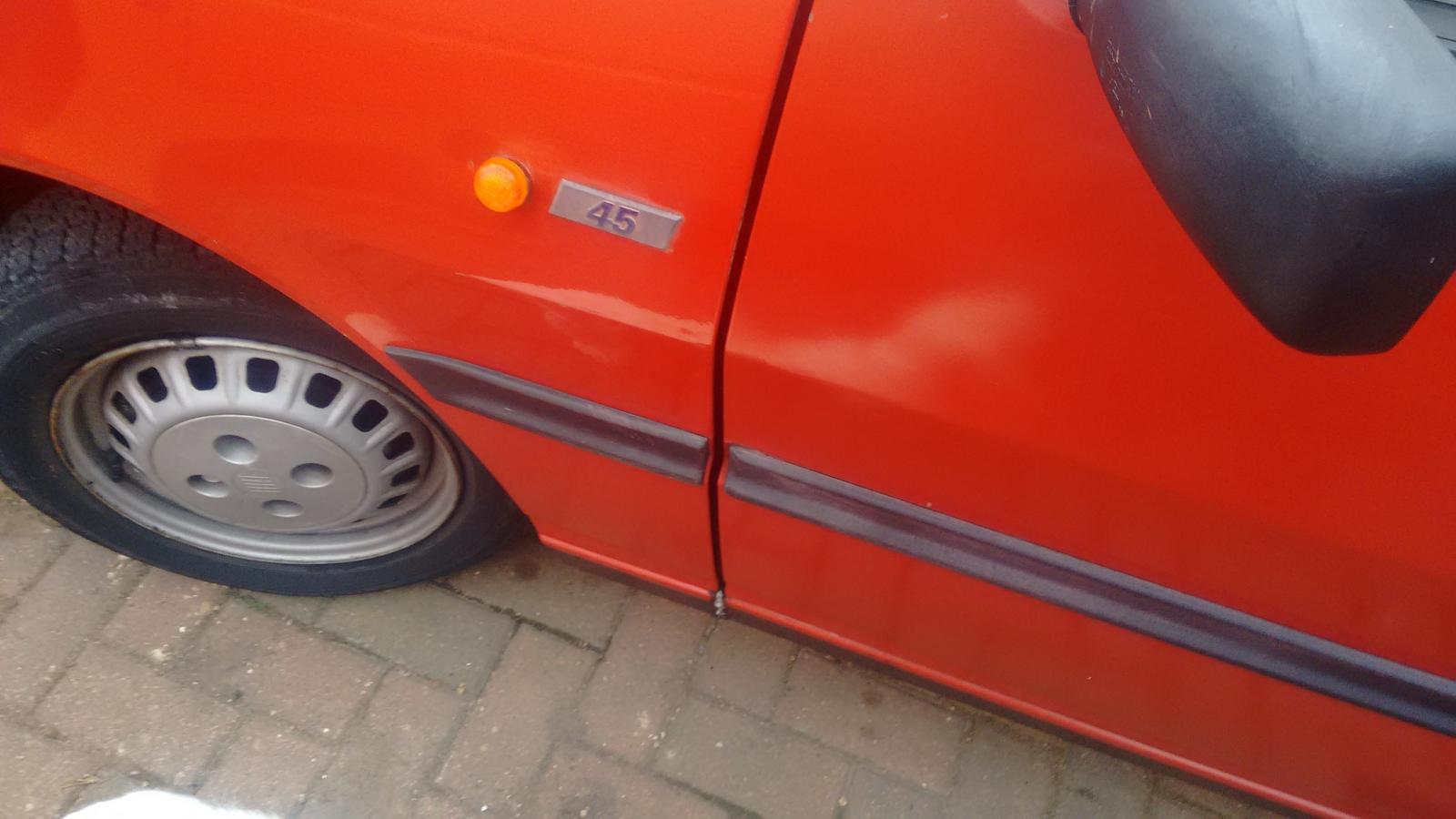

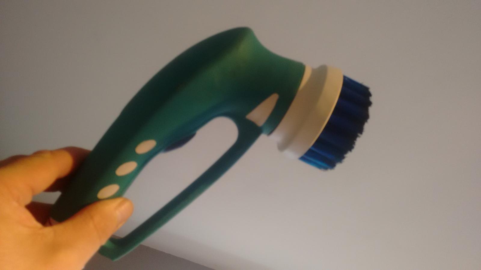

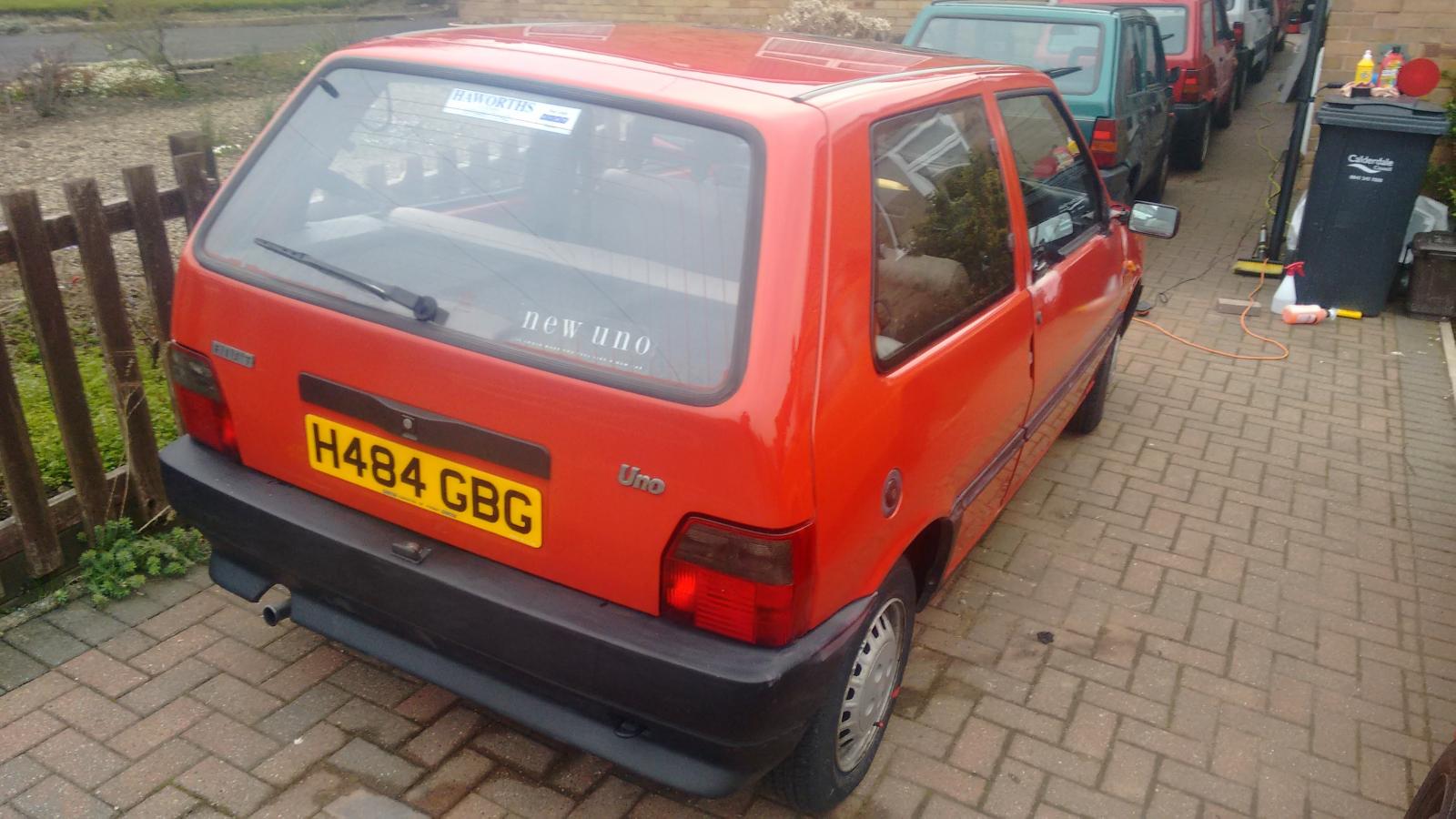

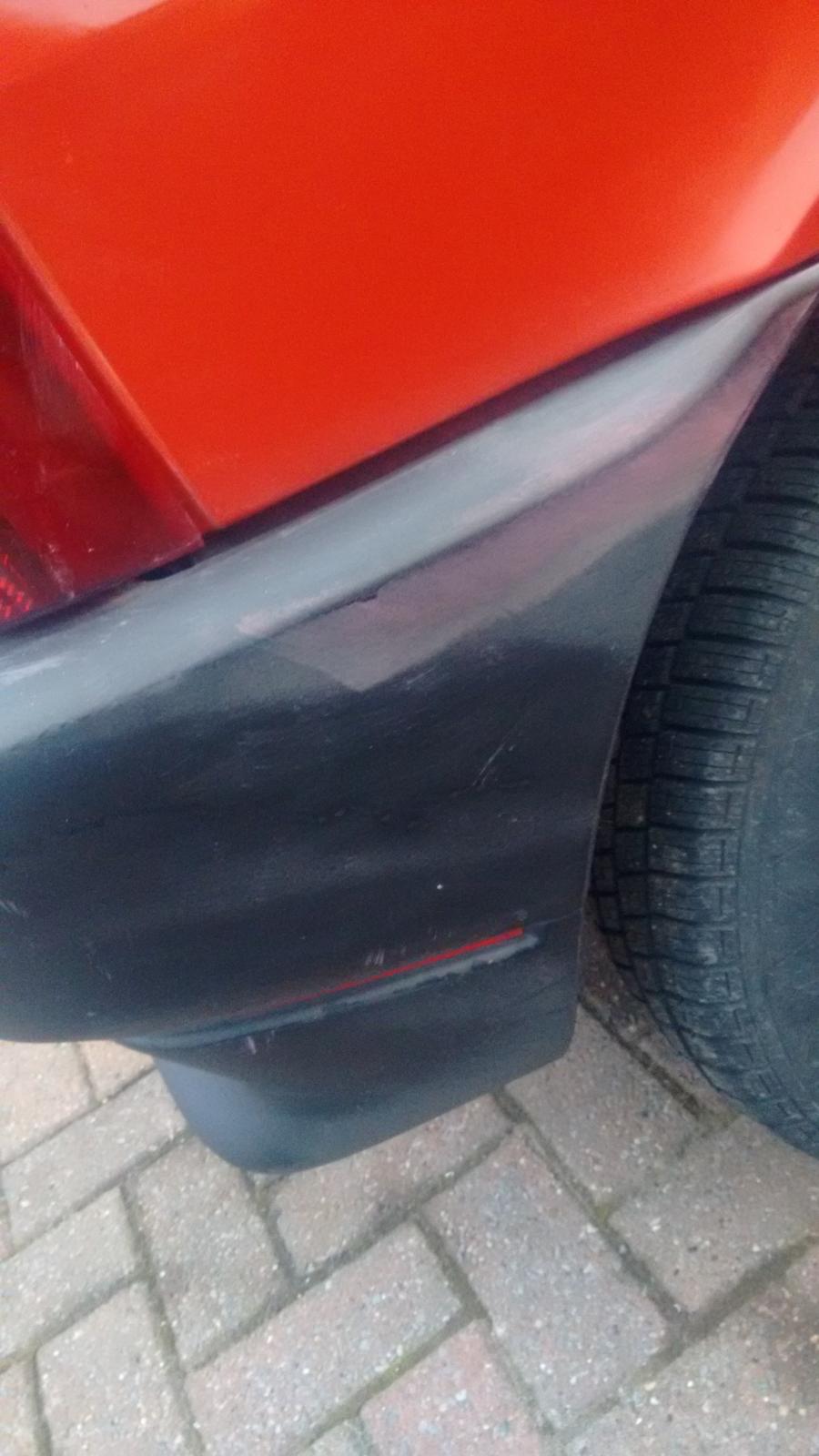

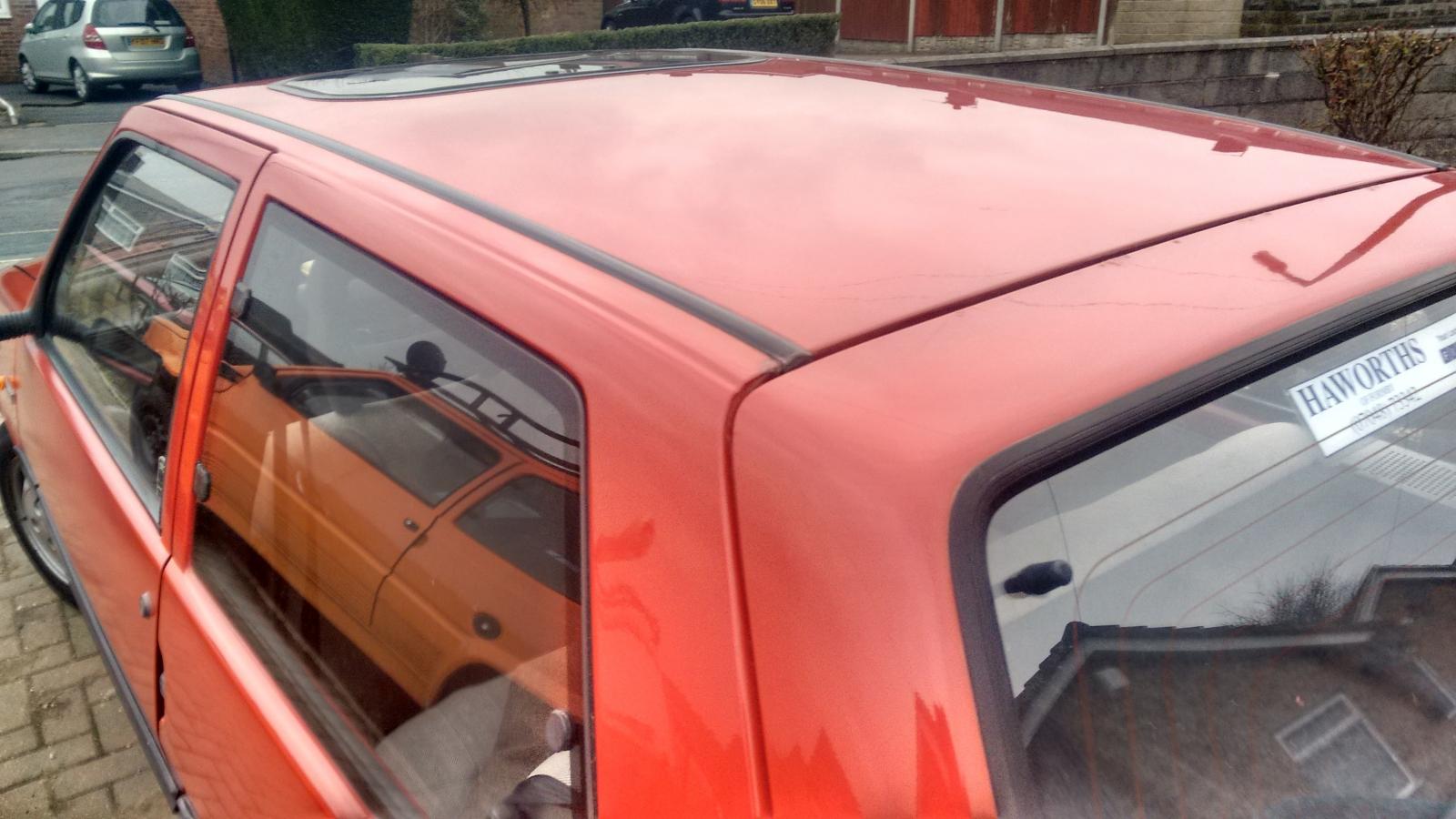

For Fiats Sake Posted March 23, 2016 Author Posted March 23, 2016 Having a bit of a do uploading images so you've got them in one block. I googled how to restore oxidized red paint and it was recommended that a claybar was used first. Went to ebay and ordered one, then got bored and decided to wash car first anyway. Used cheap car plan snowfoam (attaches to hose pipe) then used (detailers look away now) a rotary brush on the power washer. Amazingly this was enough to remove most of the oxidization from the paint - so much for clay bars! Next it was trying to find the rest of my cleaning/polishing kit. Pushed the mk1 forward in the garage abit and I was able to retrieve the polisher and some g3! I didn't want to go mad so used it pretty sparingly with a good spray of water. Last time I used g3, I followed it up with AutoGimp polish and sealant but this was lost somewhere in the garage. Luckily I managed to find some colour magic polish (bought 13 years ago) and decided to whizz over it with that for a bit of protection. Then I had to try and rescue the bumpers and trim that had got a bit of a polish/g3 on it. I'd used the poor boys stuff on the bonnet plastic earlier in the week using the funny looking rotary hand brush I've had years but only found in the recent move! It made a good job of taking the oxidized film off the black plastic but did nothing for the bumper. Another rummage turned up some evil bumper black circa turn of the millennium. God knows what this stuff is made of but it stinks like shoe polish, stains everything it touches and has the consistency of turned milk - just the job then. Applied with the black and decker grime buster and an old electric toothbrush head it really turned the grey bumpers to black though. I made sure I wiped off the excess though as I didn't on a white car once and it streaks like a bastard. So my antics cost nothing (apart from the ebay purchase that will get used on something else), not a lot of elbow grease due to use of electrified kit, used old products that worked well and produced a shiny car! Pity it was such a cold miserable day as the pictures don't do it justice. egg 1
HMC Posted March 23, 2016 Posted March 23, 2016 That's come up a treat! Impressive work, you must be knackered!
For Fiats Sake Posted March 23, 2016 Author Posted March 23, 2016 Thanks! Cold more than anything! Started about 2 and light failed about 6. Once I start I find it hard not finish the job, it got dark or I would have done all the window rubbers and trim. Very satisfying when it is so bad anything you do makes a difference!
