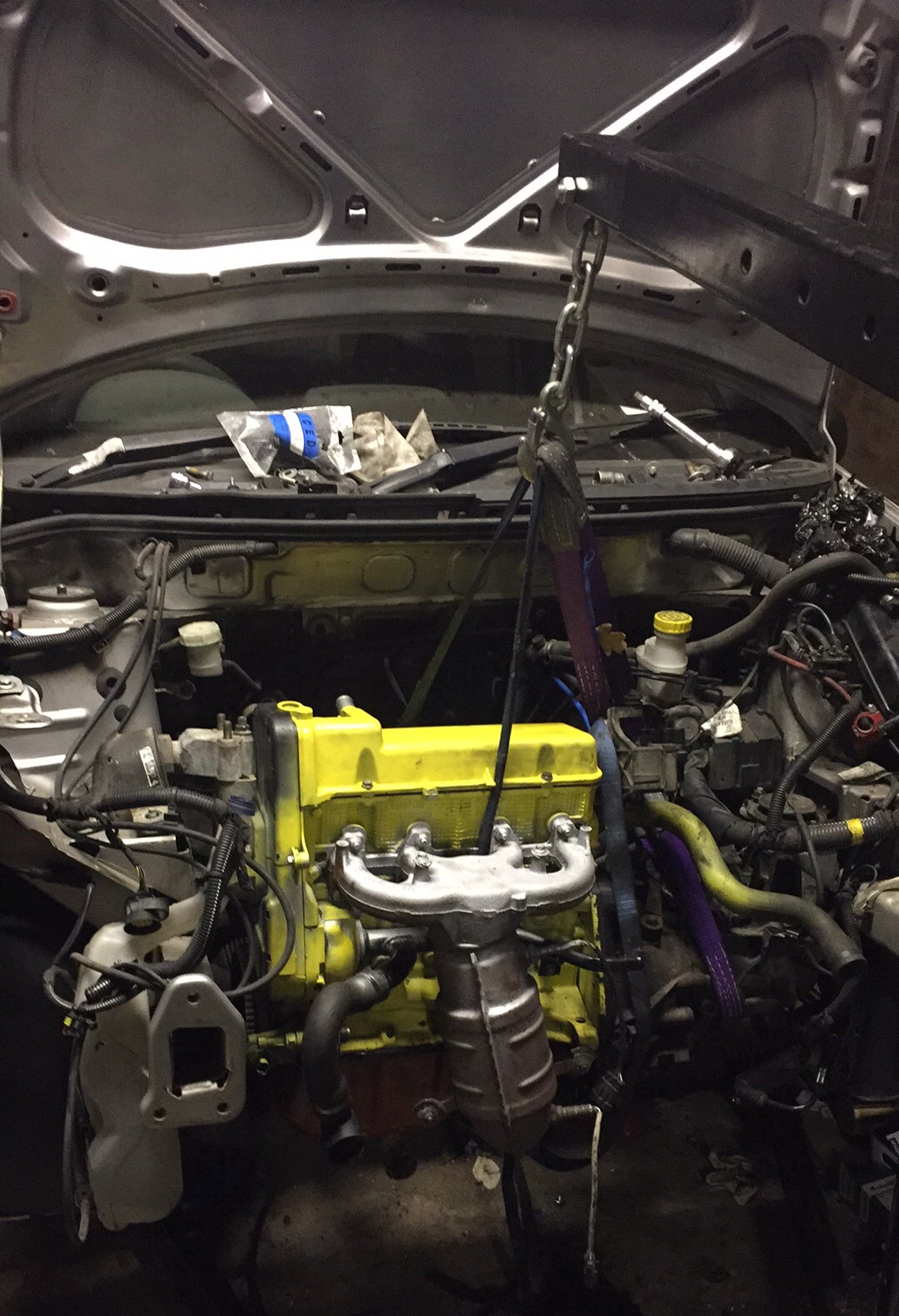

Kiltox Posted October 9, 2016 Author Posted October 9, 2016 Engine swap hasn't fixed this pile of shit - it's still fucked. Think the ECU is fucked as I originally thought before I started doing compression tests and finding water where it shouldn't be.

SiC Posted October 9, 2016 Posted October 9, 2016 Have you done a total reset on the ECU, using a diag tool? I seem to remember Fiat ECUs adapt themselves a lot.
Kiltox Posted October 9, 2016 Author Posted October 9, 2016 Yeah did that ages ago, it didn't fix anything
Kiltox Posted October 9, 2016 Author Posted October 9, 2016 Start engine Engine revs it's bollocks off for a few seconds (no rev counter but I'm guessing 5k revs) Revs die down and then pulse between a normal idle speed and 3k or so After a bit it dies down a bit more like it's going to idle properly and then stalls Hugely difficult to restart unless left for hours
SiC Posted October 9, 2016 Posted October 9, 2016 Tried disconnecting all the sensors, apart from the bare necessities? (Probably just needs crank sensor connected to run)
Kiltox Posted October 9, 2016 Author Posted October 9, 2016 It keeps throwing up random fault codes too so I'm guessing that's another sign the ECU is borked
Kiltox Posted October 10, 2016 Author Posted October 10, 2016 Haven't tried disconnecting it but I have multiple throttle bodies (ICV is integral) and there's no difference between them
