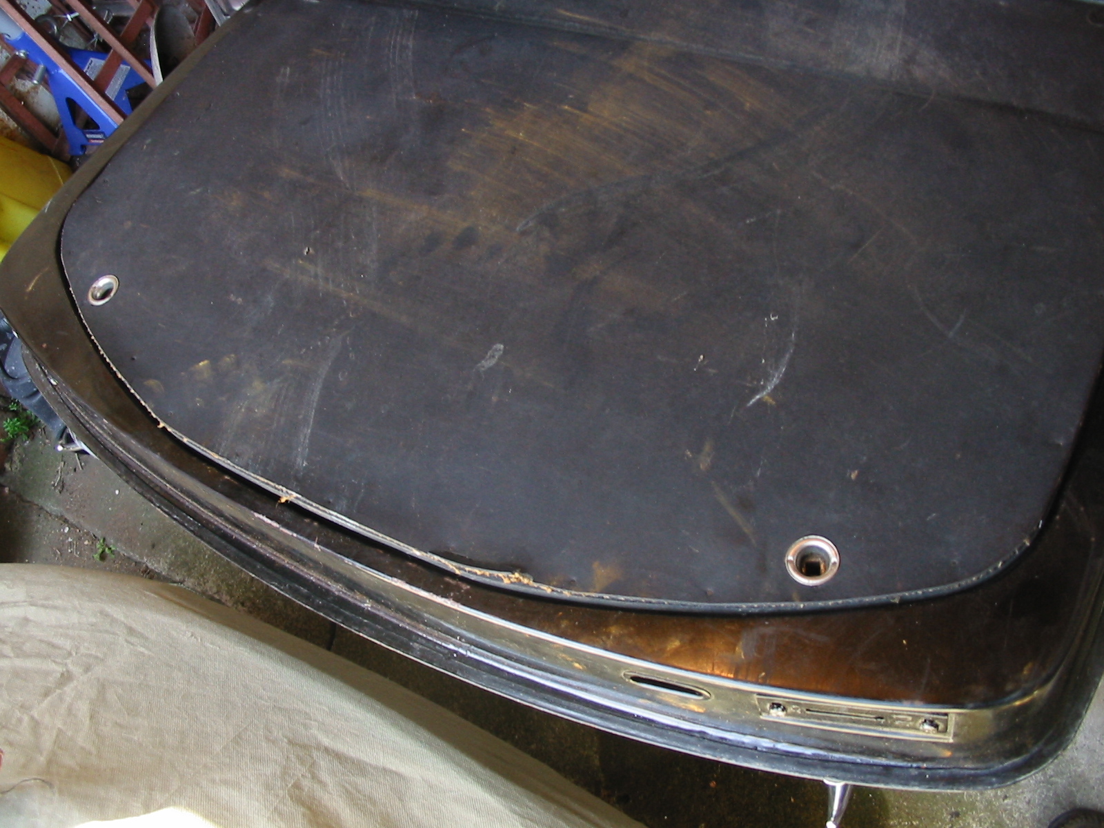

So let's open the boot.

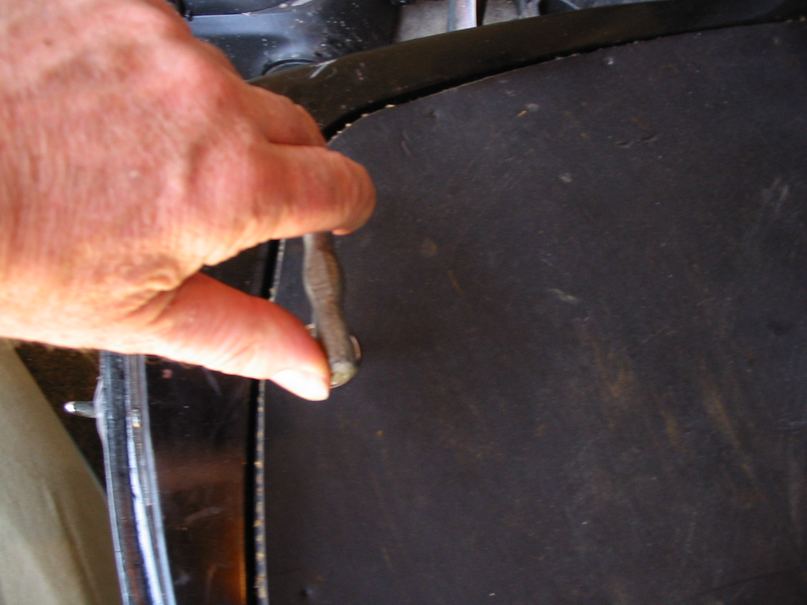

Oh, I need a carriage key to open the inside of the bootlid.
There's one in the toolkit under the dash...
...so we'll use that.

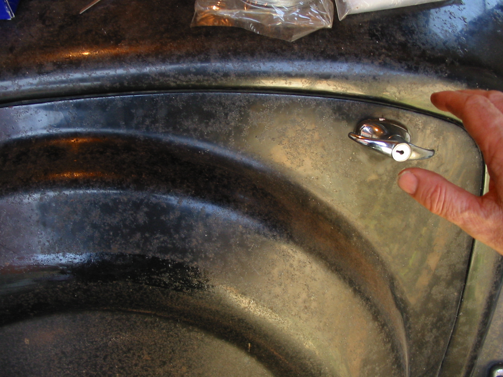

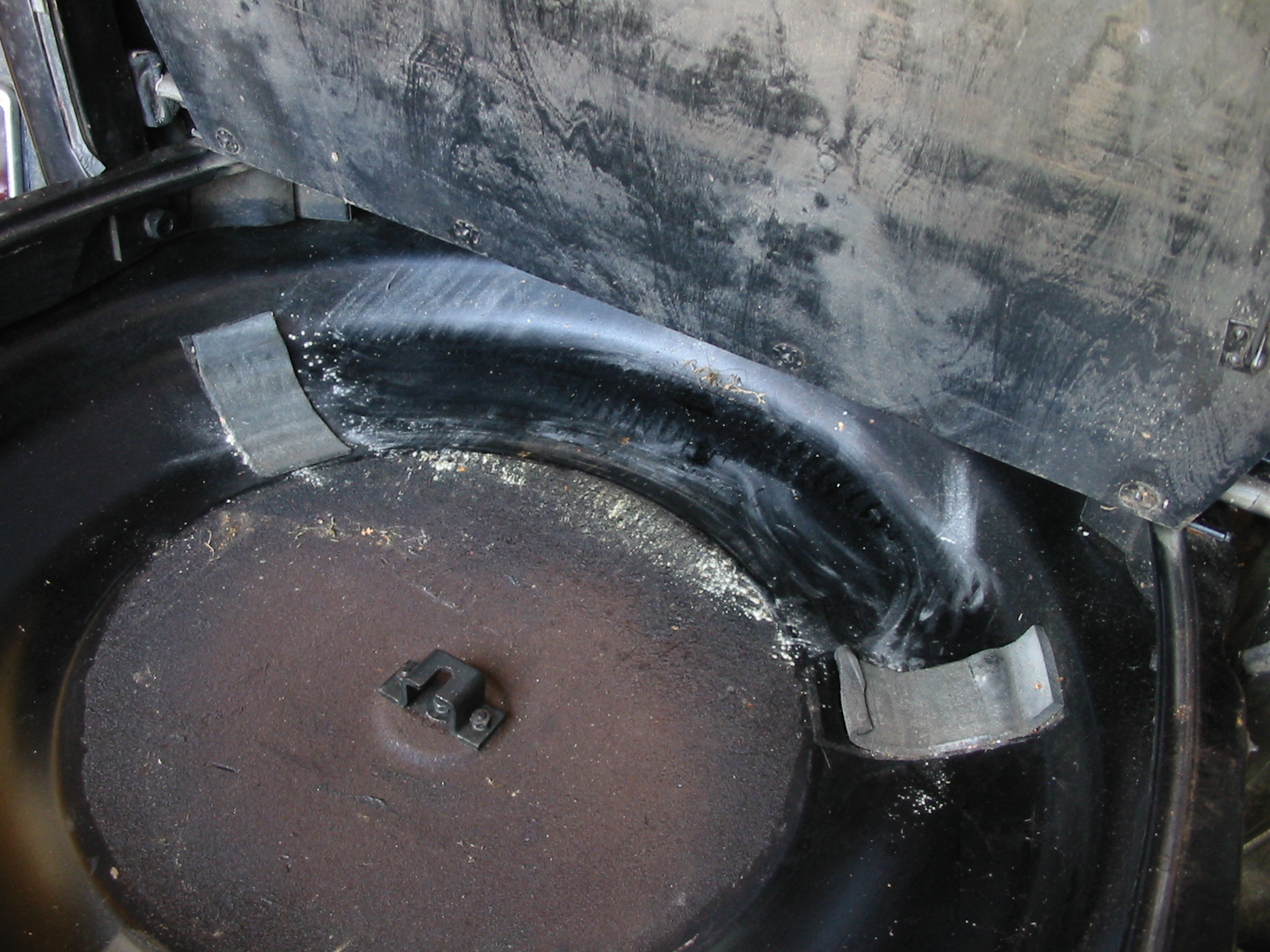

Now unscrew the spare
Oh.  That needs cleaning.

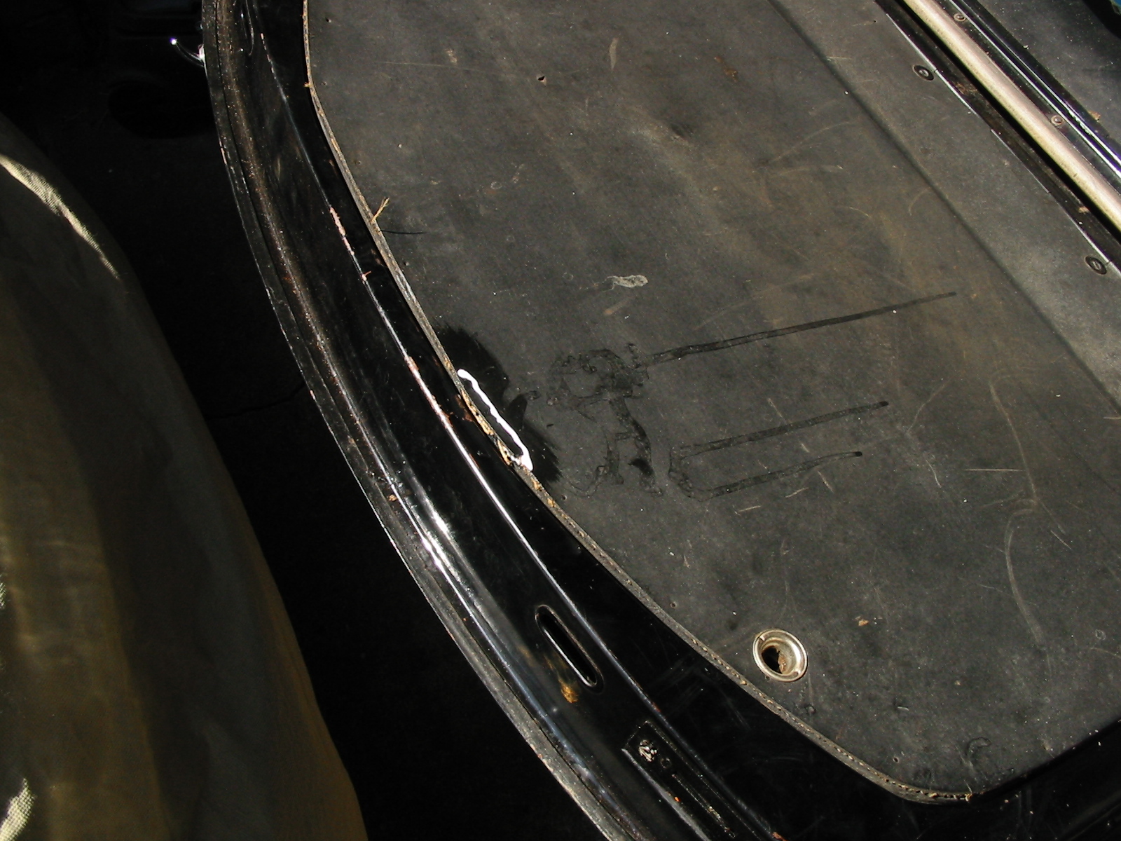

And I'll just glue up that loose bit of lino.

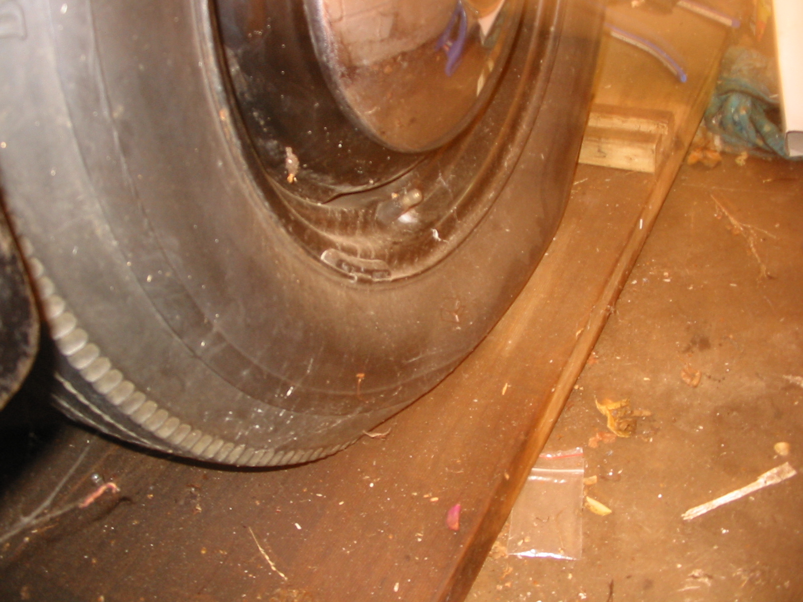

Chock the back wheel.

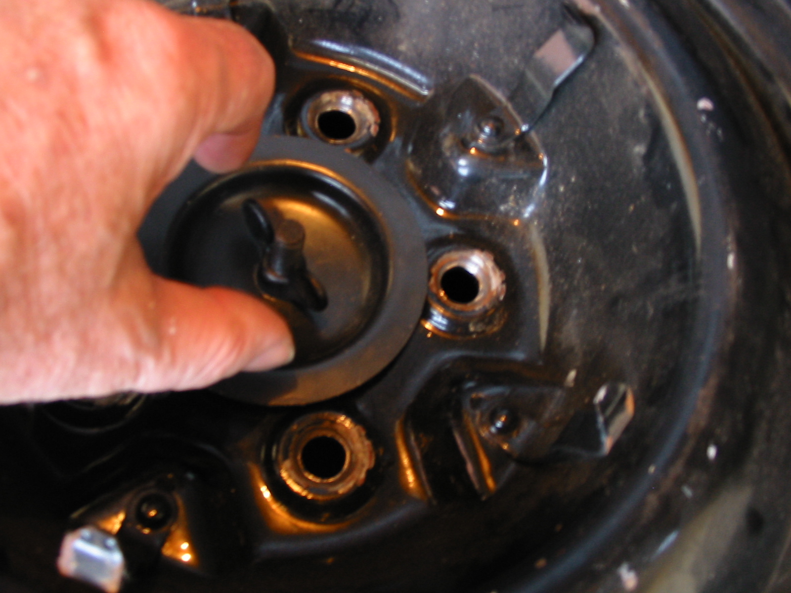

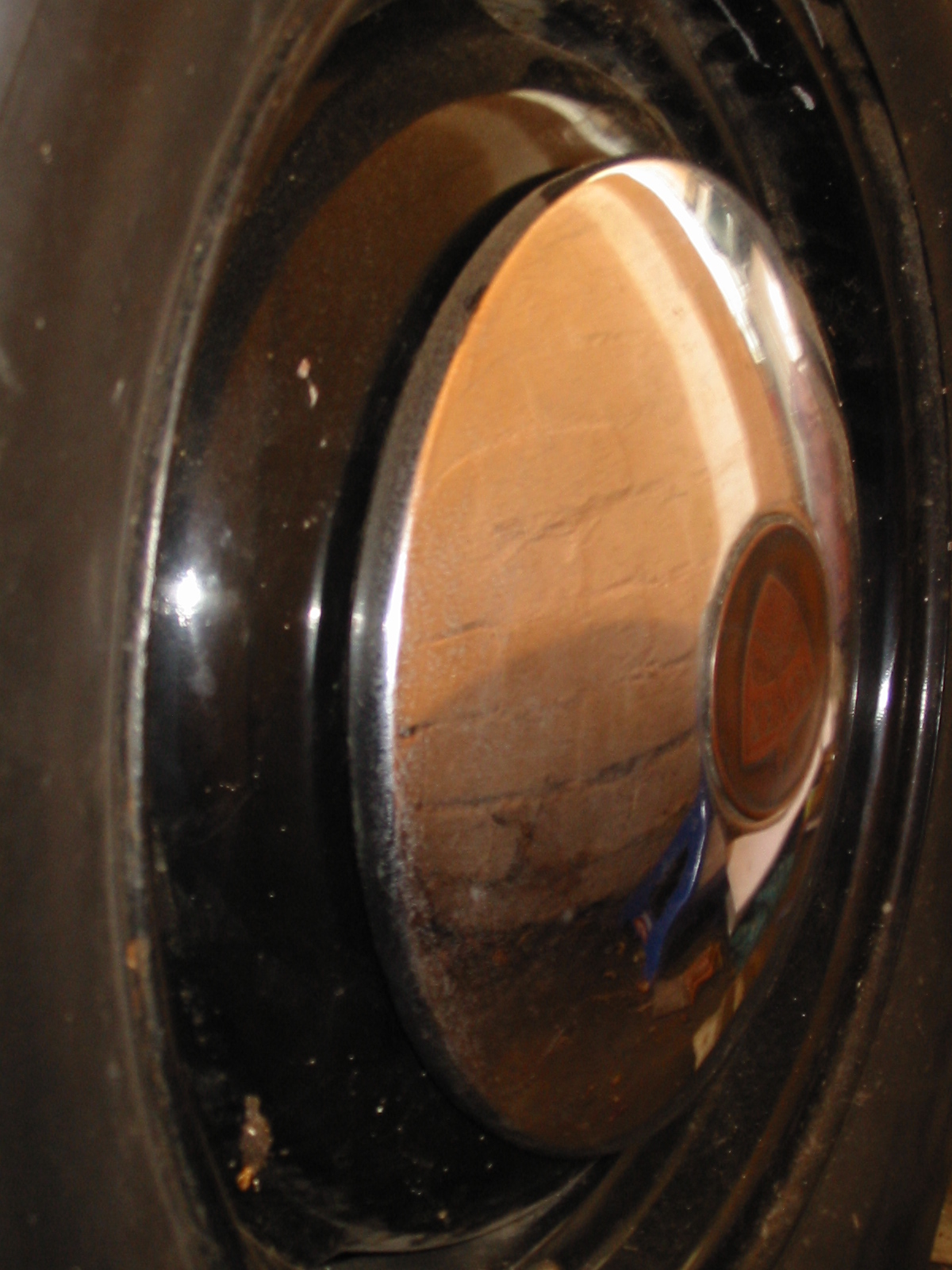

That hubcap will have to come off.

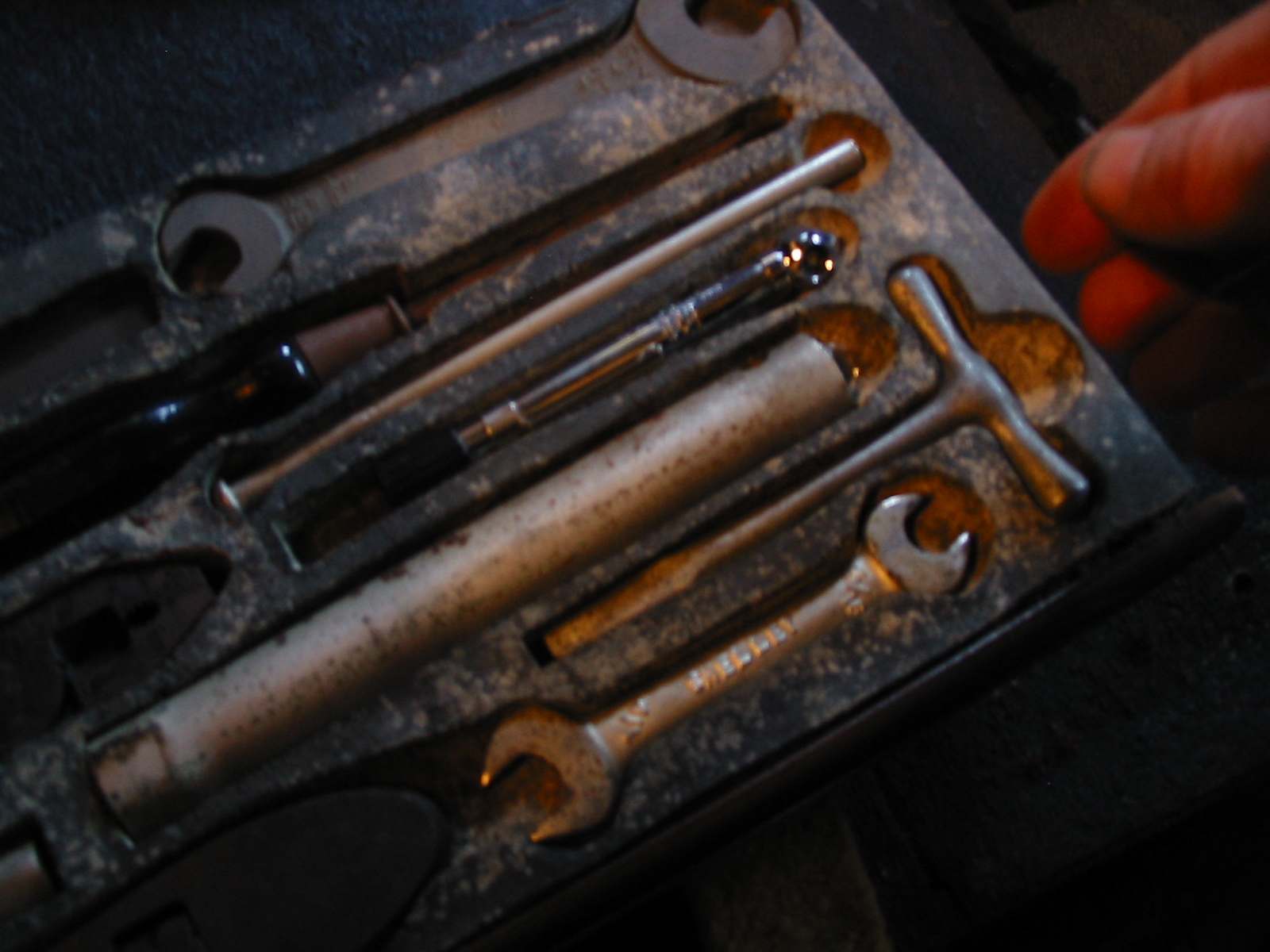

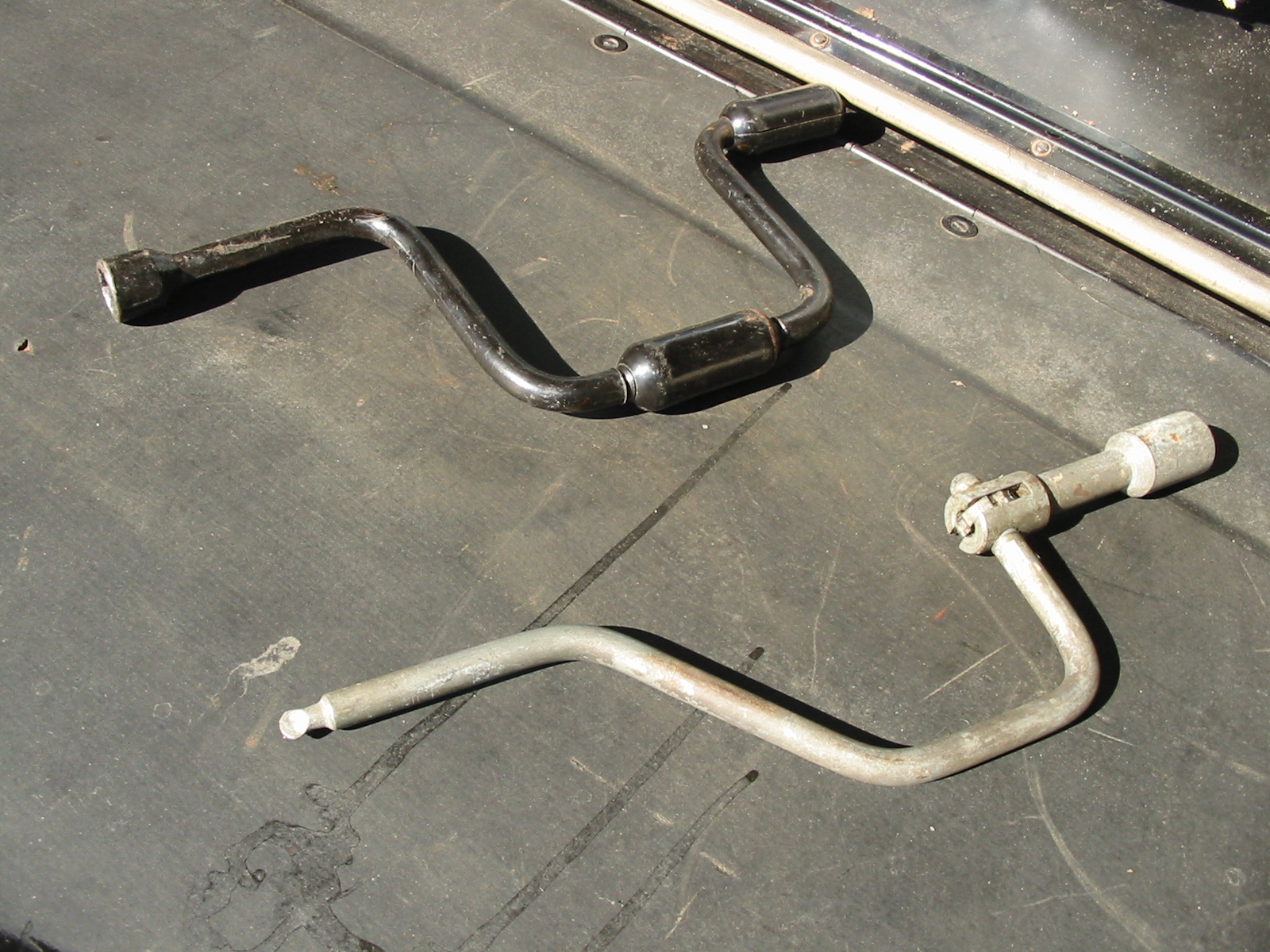

The original tools from 1949:
This is a SERIOUSLY well made car.

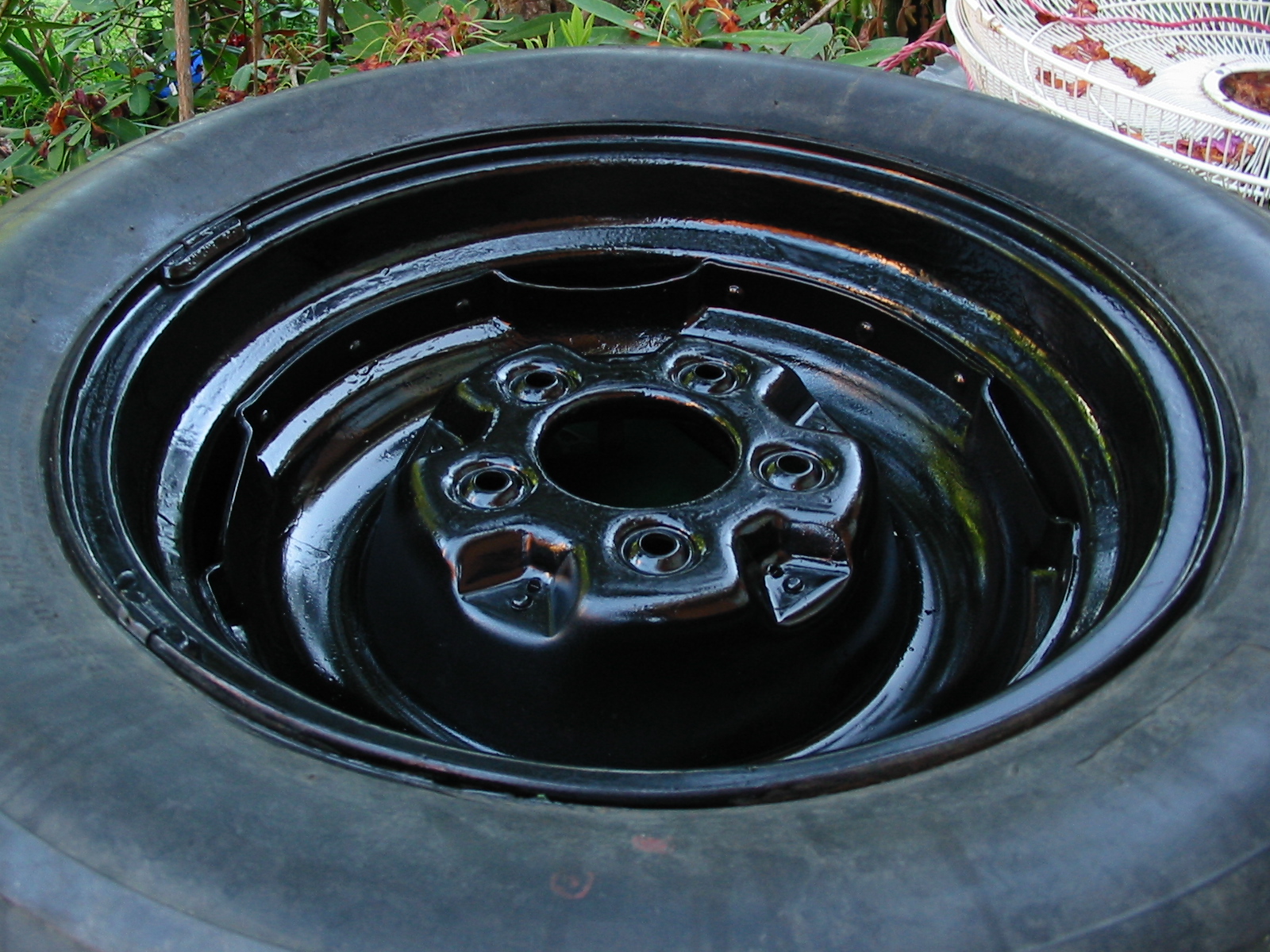

Spare wheel was filthy so I cleaned it up both sides.  The car will need 4, probably 5 new tyres before it gets submitted for a roadworthy as each tyre, although mostly brand new with full tread, are all nevertheless old and cracked.  And this spare I'm putting on is the worst.  But for now, while the car is standing getting worked on, I'm just tubing up the old ones.  Plenty of time for buying tyres when I get to drive the car.

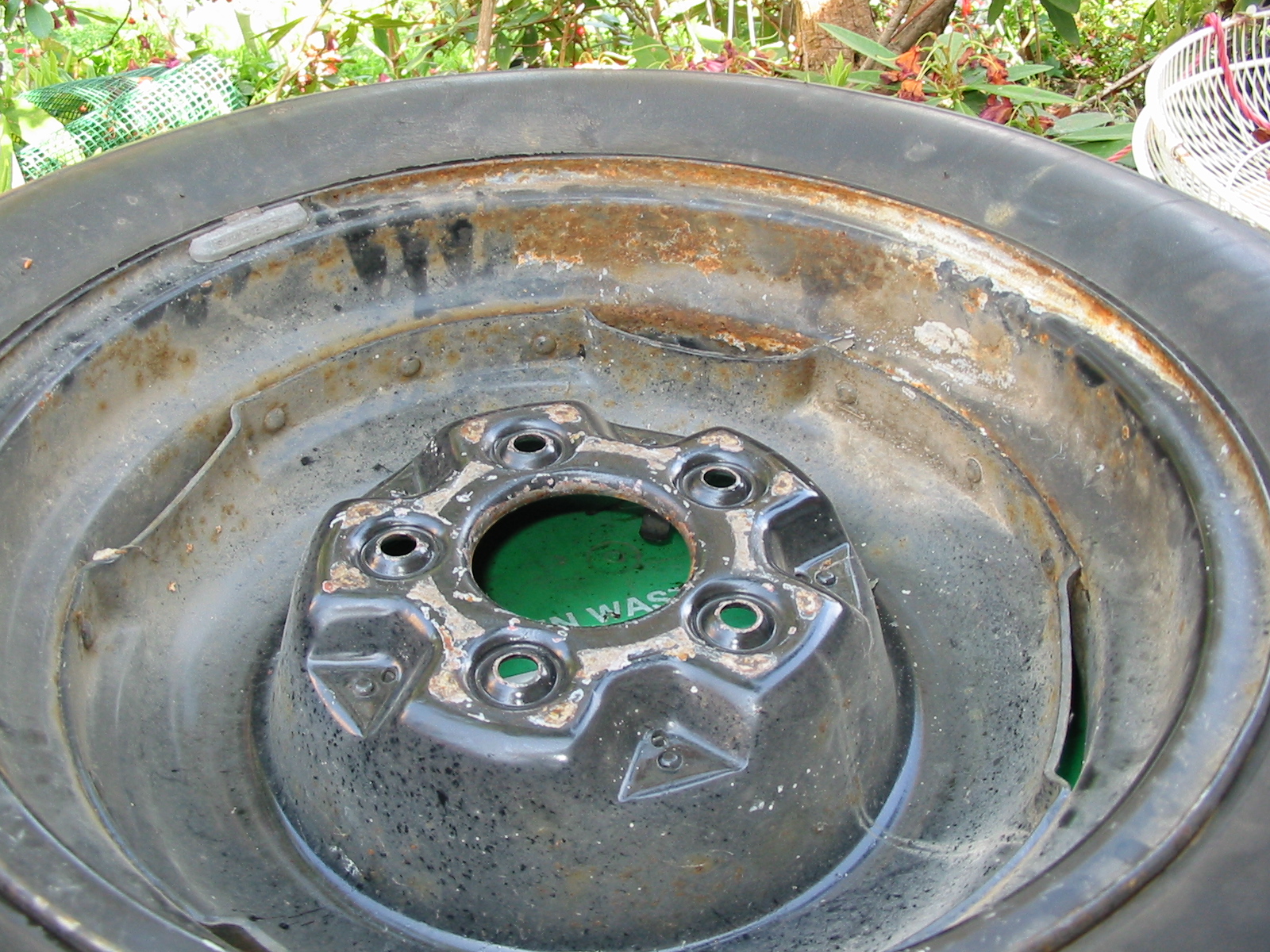

The rest is straightforward wheel changing 101, until I came to look at the wheel I took  off:
That's the ravages of brake fluid you're looking at.  The front brakes are hydraulic, and the wheel cylinders were leaking badly.  That's another story I'll tell another day, but there were rivers of brake fluid running down the inside of this wheel, which is now rather rusty.
What should I do guys?  Just wire brush it and use this?

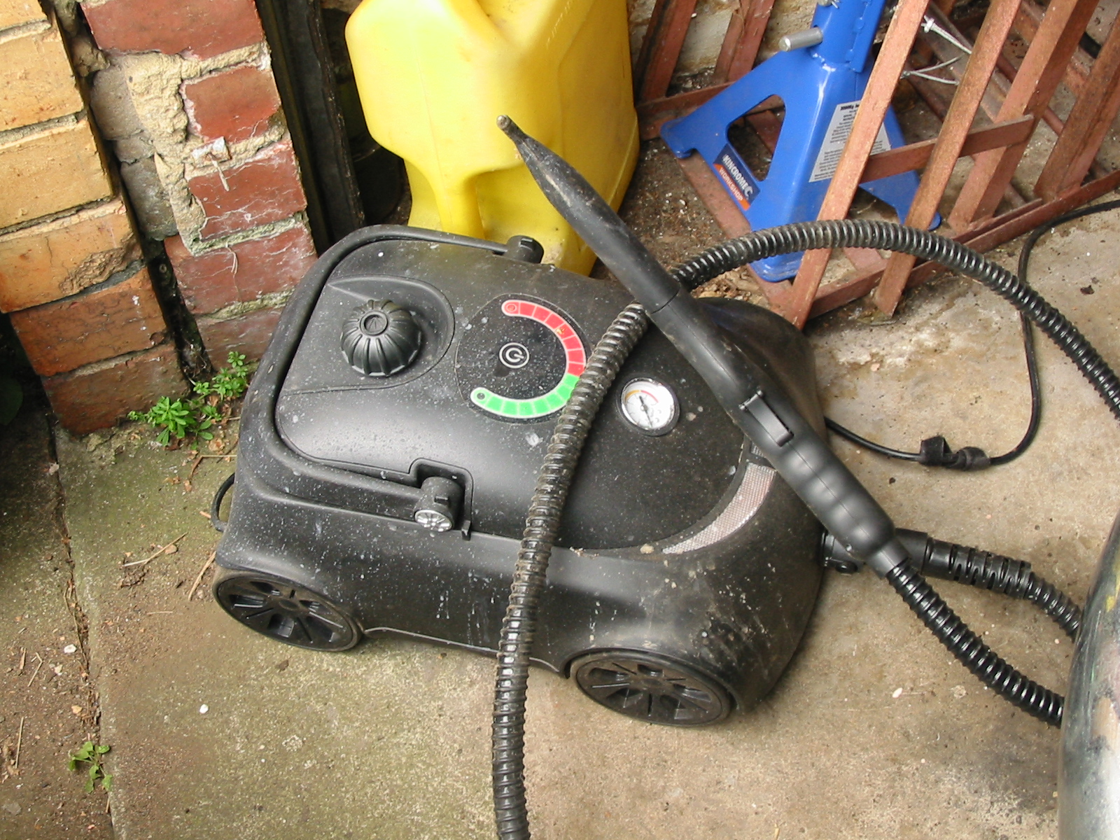

In the meantime, I'll get back onto what I went out there to do - steam cleaning the chassis, ready for repainting under there.

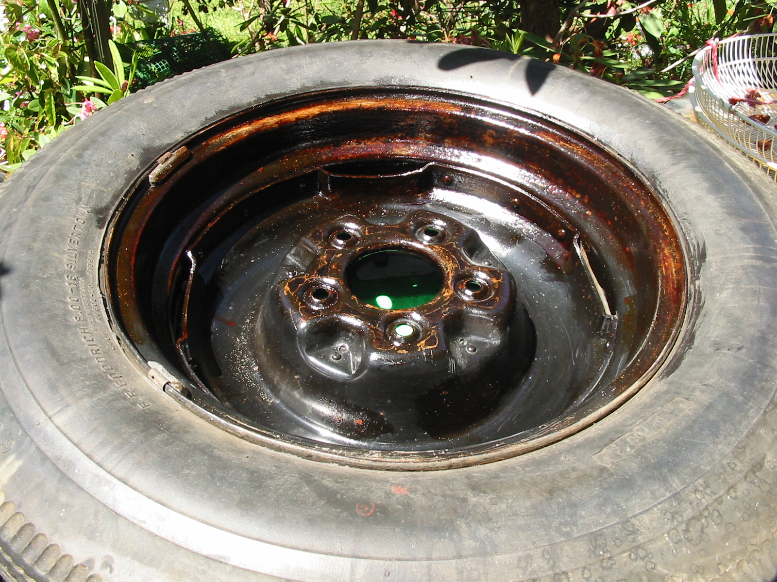

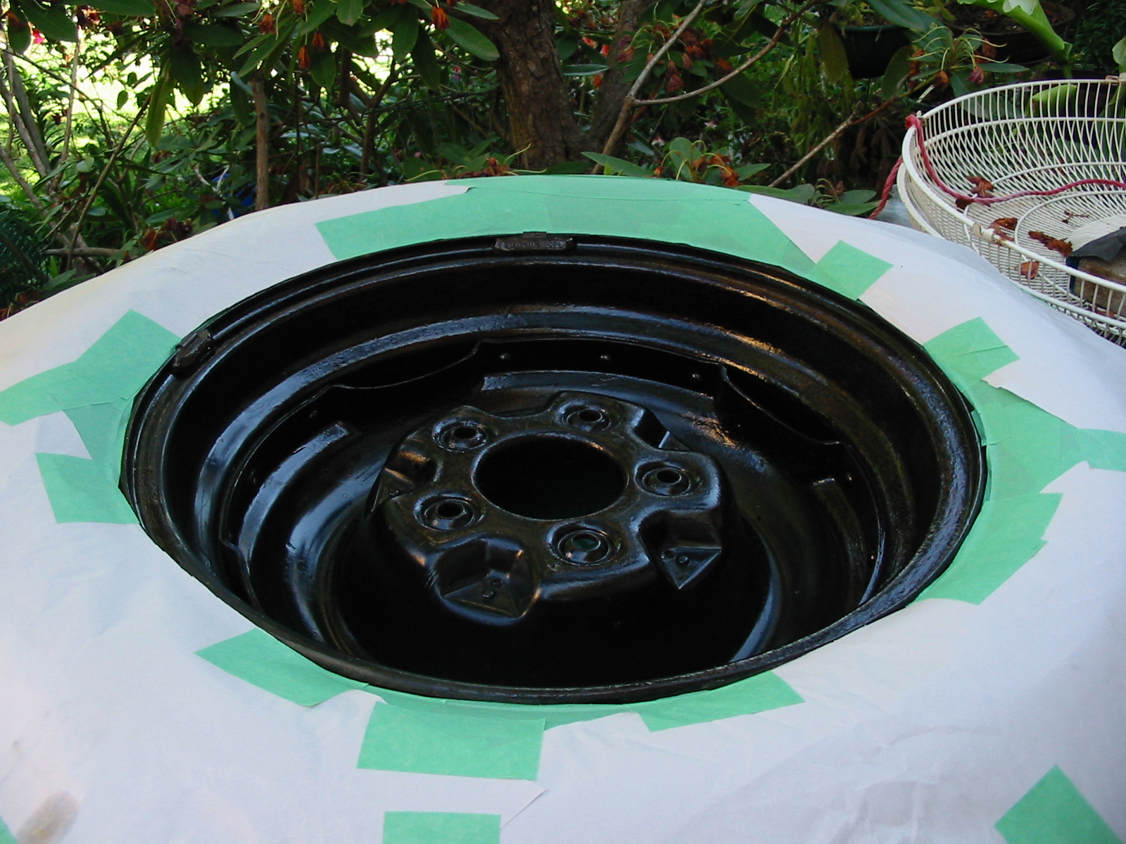

OK.  First a stiff and then a soft wire brush, then two coats of chemical rust converter:
Hmm.  Still rather rust-coloured under that plastic surface.  So let's sand it down and apply a third coat.

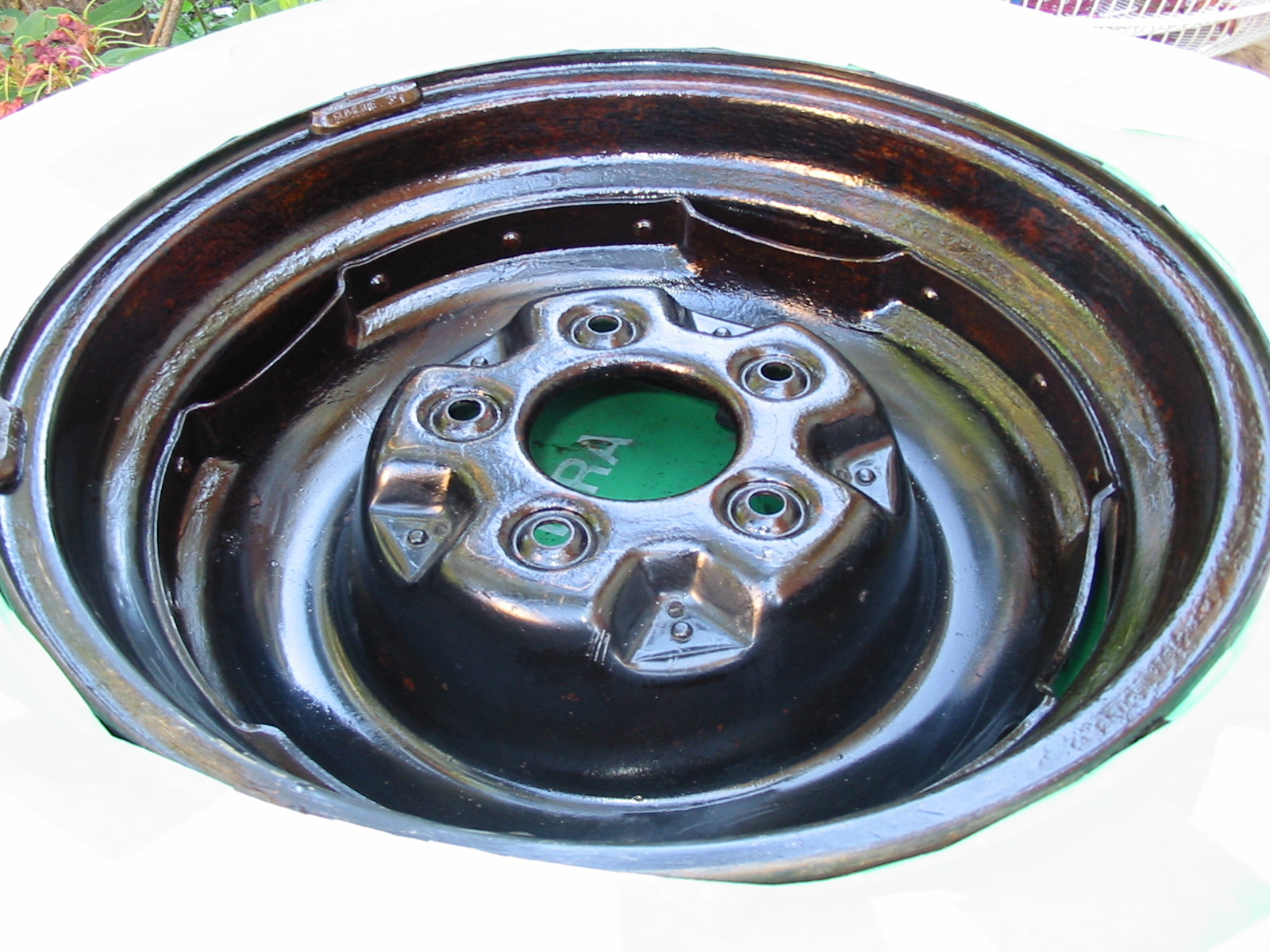

Much better.  So mask it up ready for painting:
Good.  So now for the prescribed three coats of wheel paint:
You might think this job is pretty rough, but by my standards, it's quite outstanding.
So now it's time to get in touch with my inner tube.

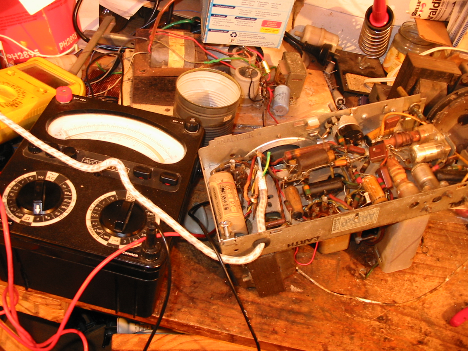

Apologies for lack of recent posts, but life gets in the way sometimes.
Customers' radios are on the workbench and the 1949 Rover must wait.
Edit: come to think of it, this radio is older than the Rover!

In a few days' time I'll post a photo of the factory jack (very busy few days ahead), but a photo of the jack in operation will be impossible as the garage is just too tiny.
