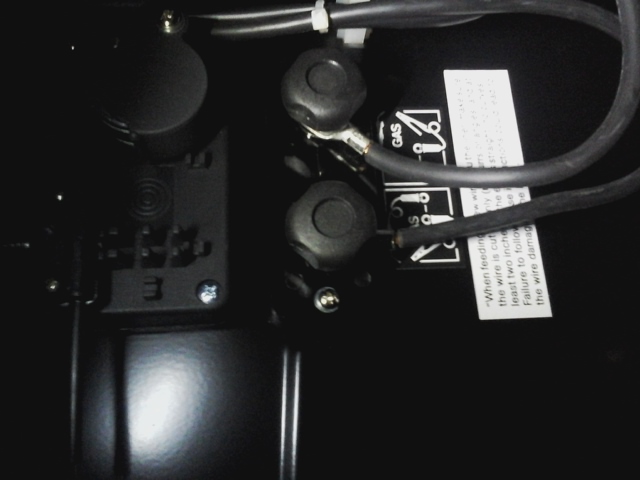

How do you change the polarity of the earth/ground for gasless? I have 2 migs, a Murex Tradesmig160 amp jobby and a Cebora Pocket mig and have used neither for years but looking to resurrect them. I've got a small reel of gasless to try, do i have to reverse the polarity? Sorry for the hijack!
Hello, feel free, and anyway it gives me the chance to help out. My Clarke gas / no gas has terminals inside you can unscrew and swap the leads on (excuse poor torch light camera phone without flash photo)
