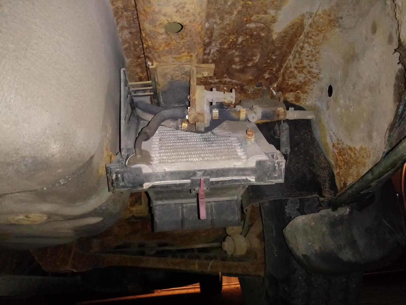

Can I ask, have you ever checked the condition of the rear chassis rails in yours? Mine have quite a bit of surface corrosion from the trailing arm mounts right to the rear valance. The rear subframe looks little better.
Mine did that too. Could well be rear light gaskets, or the washer behind the mut that holds the last part of the chrome waist rail is loose or missing. Mine is clean underneath, when we painted it we cleaned up underneath and I keep on top of it. Rear jacking points are scabby, will get this sorted soon. Jack pads are missing so I think I will replace these.
Little surface rust from memory. Mate at bodyshop said it was a clean car when he had it on the ramp. Do you have photo of yours?
This is the area above the diesel cooler, thats as far as my flash would reach without actually crawling under but it's a good representation of the condition of the back 1/3 of the chassis.
Just seen a photo on your thread. Im sure mine was not as bad as yours. But then I paid 1k more than yours for mine. Best get it on a ramp for a good look before spending a lot. I also had bumper off when fitting towbar and it was fine too.
