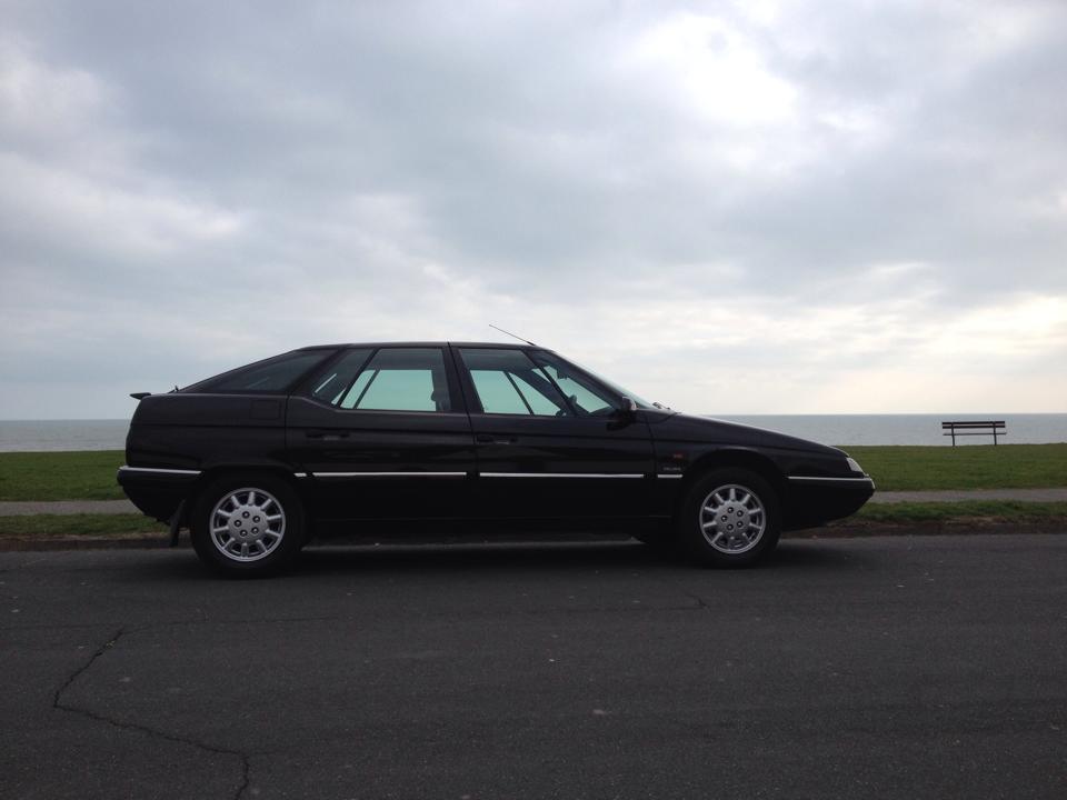

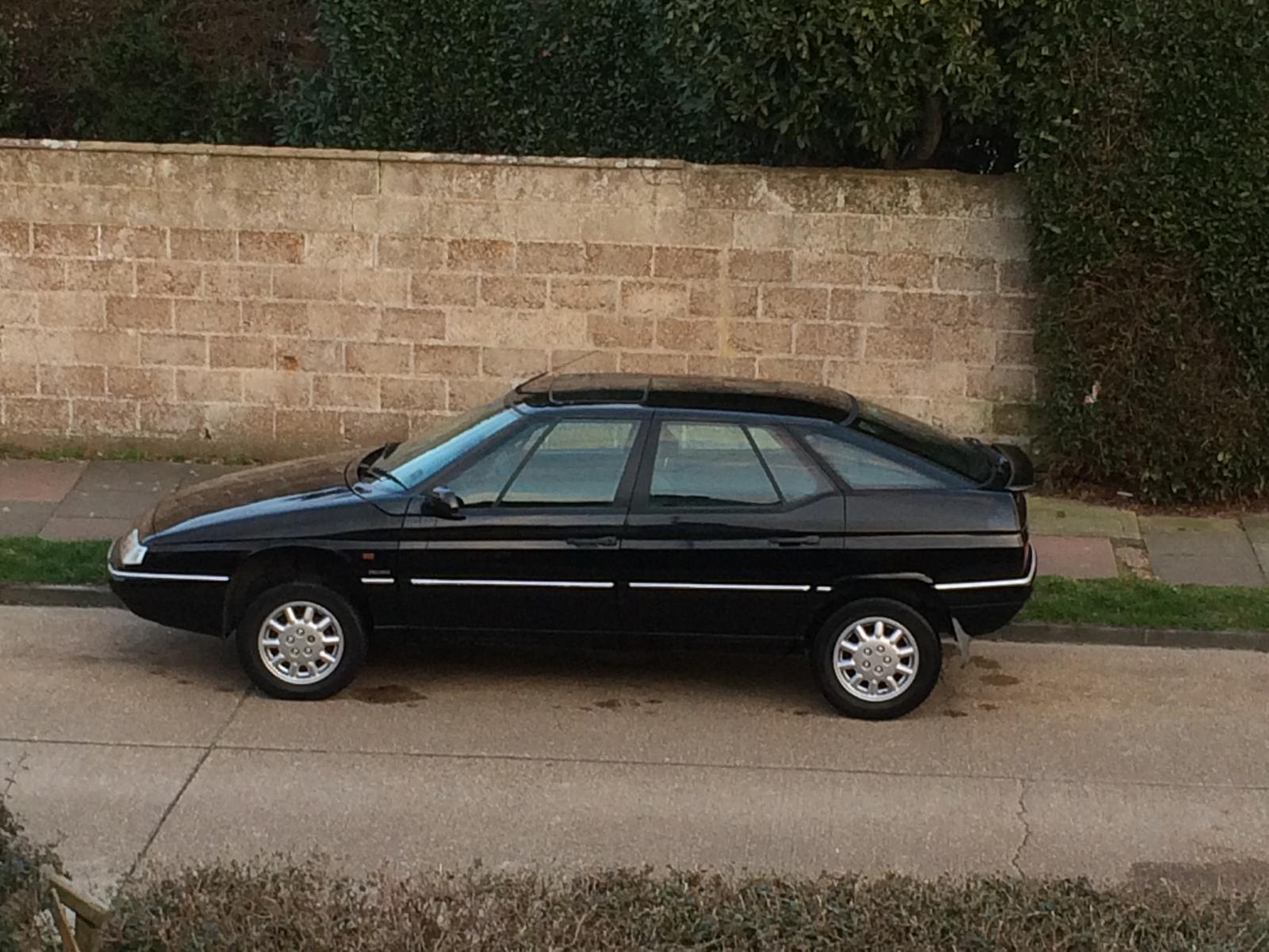

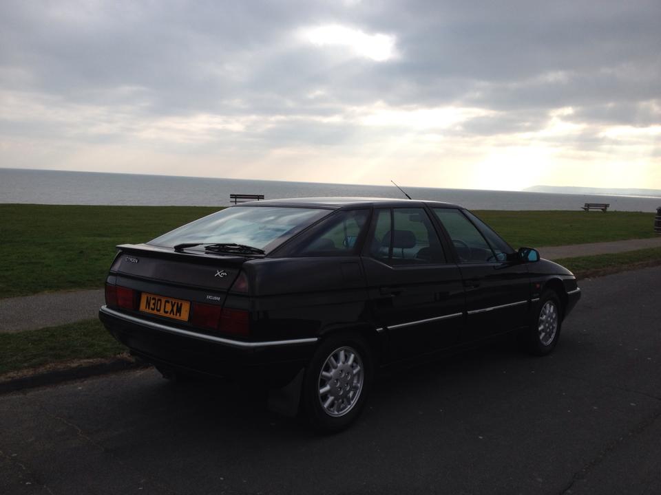

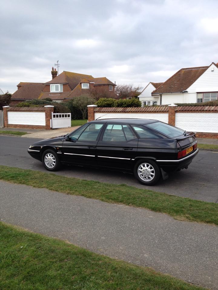

Well today I realized that I'd washed the XM twice and it hasn't been used at all in that time, so took it for a quick spin as a treat! Also took some new pics by the sea.

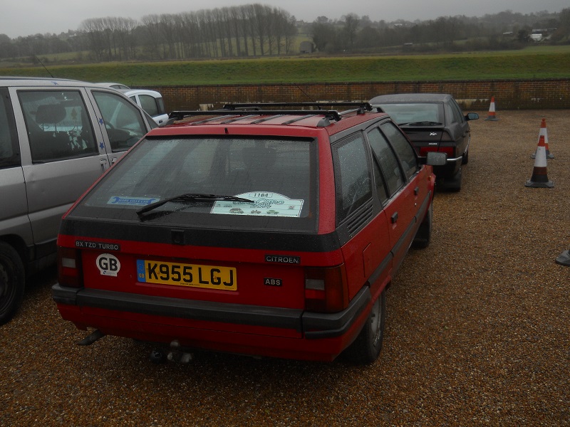

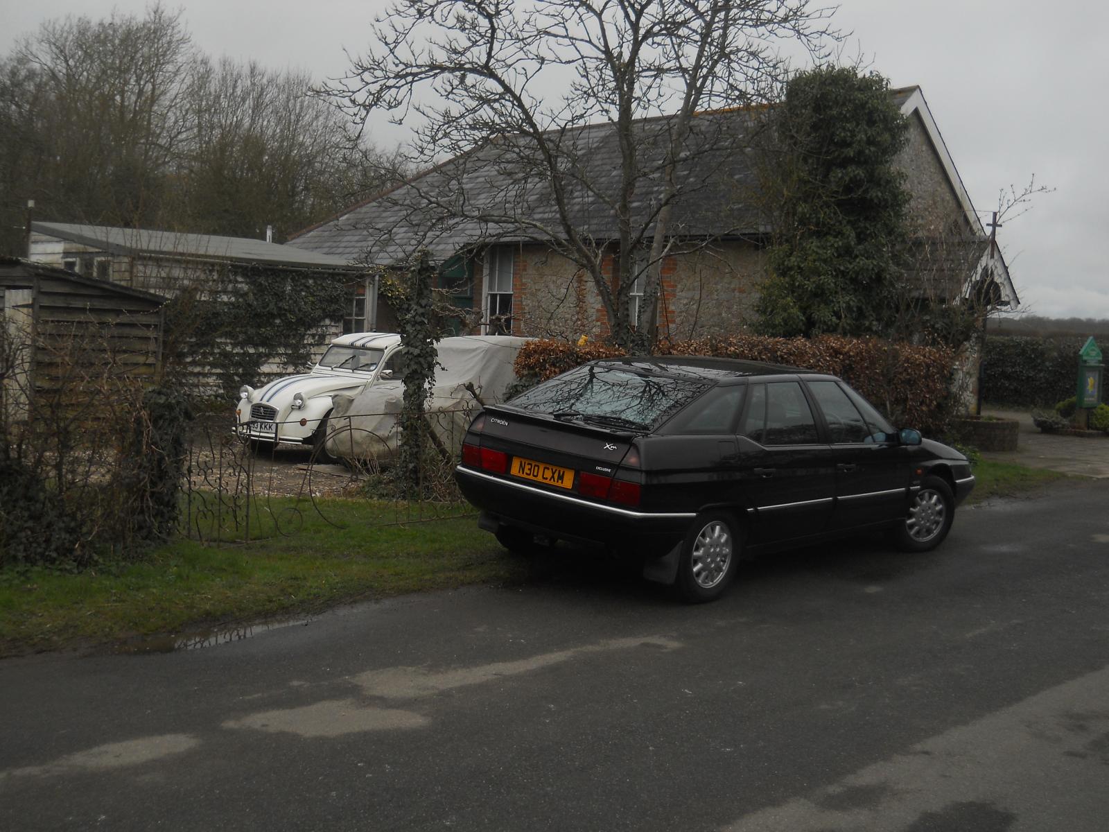

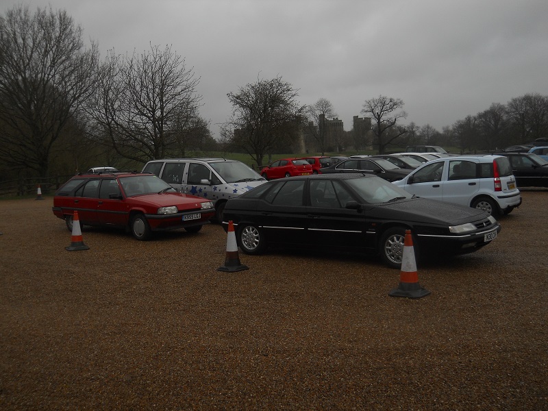

Went to the FCF Robertsbridge area meeting today after breakdown man jump started it from his booster pack (note to self, use the XM a bit or even at all!). Found the headlights were flashing on & off together with alarm warning and it's raining. Never mind head out to Bodiam Castle to meet Citronut about an hour later than planned. I missed someone else in a silver BX (cant remember the name), but met Malcolm for some lunch, well he'd had his already. We didn't bother with the Easter egg hunt as it was raining! Luckily he knew how to sort the headlight flash thing, so all good

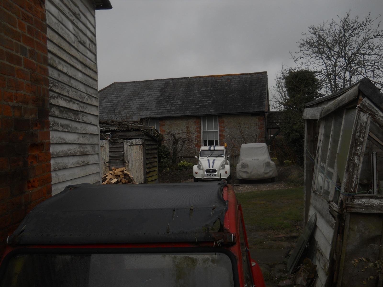

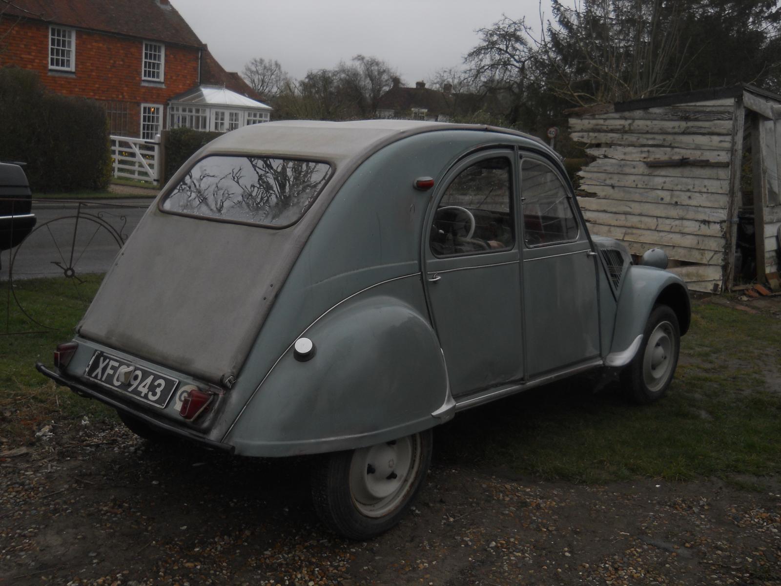

Here we are meeting with more 2CVs, in this case belonging to my cousin.

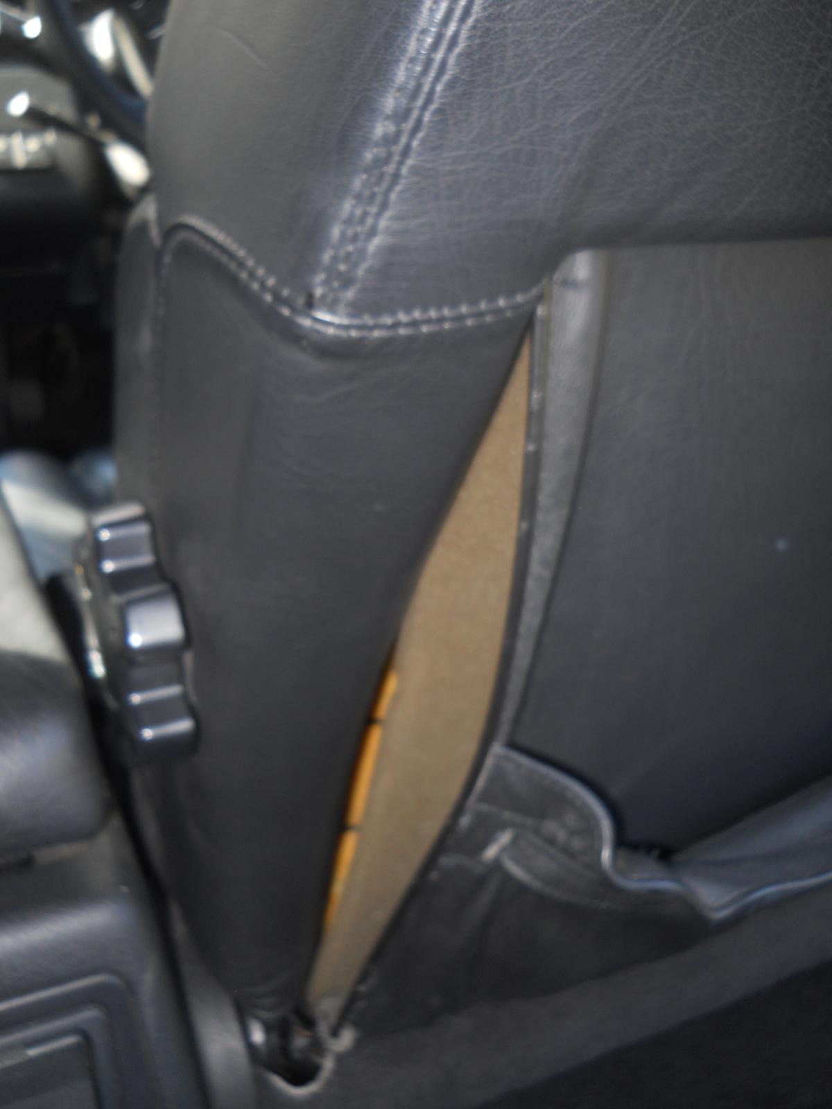

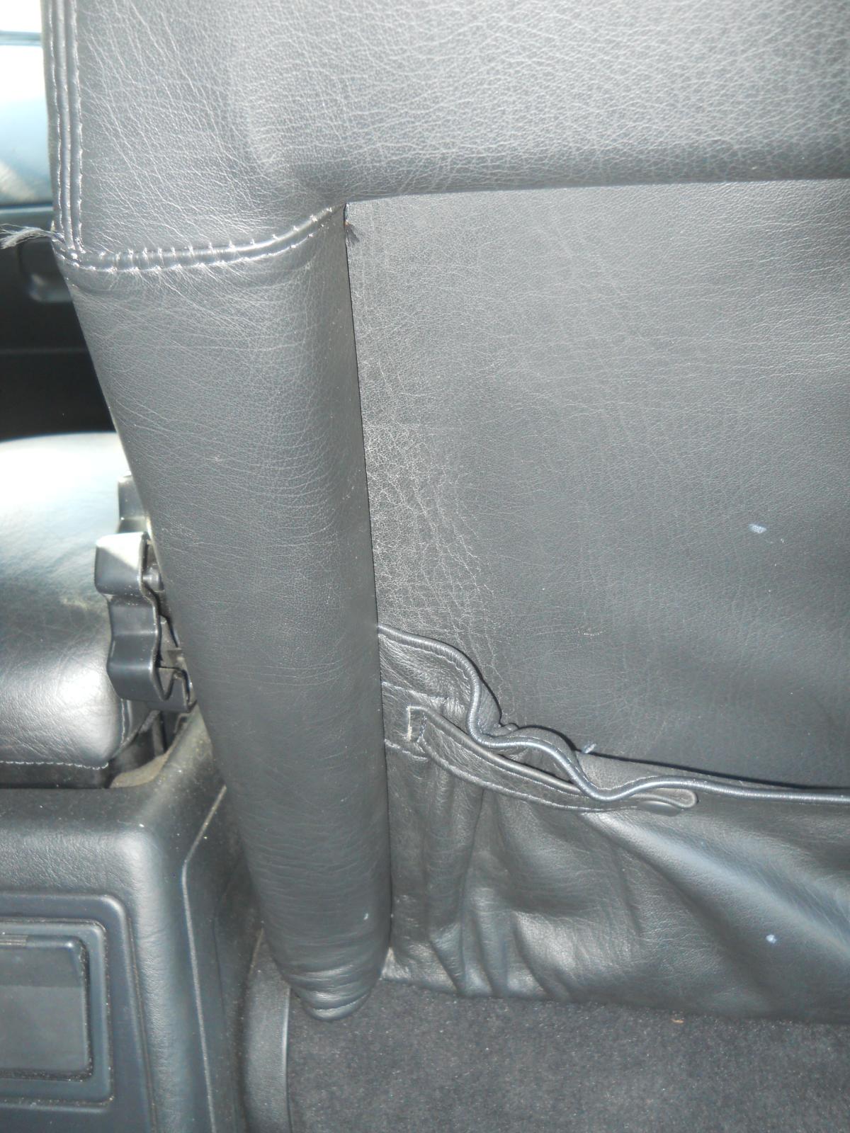

The back of the driver seat has been undone since I had the car & every time I pushed it back, it would come undone with use. So I have tried a shite fix, by taping a length of electrical cable to the edge to make it thicker & tucking it in again. I've not driven it yet so don't know if it will last.

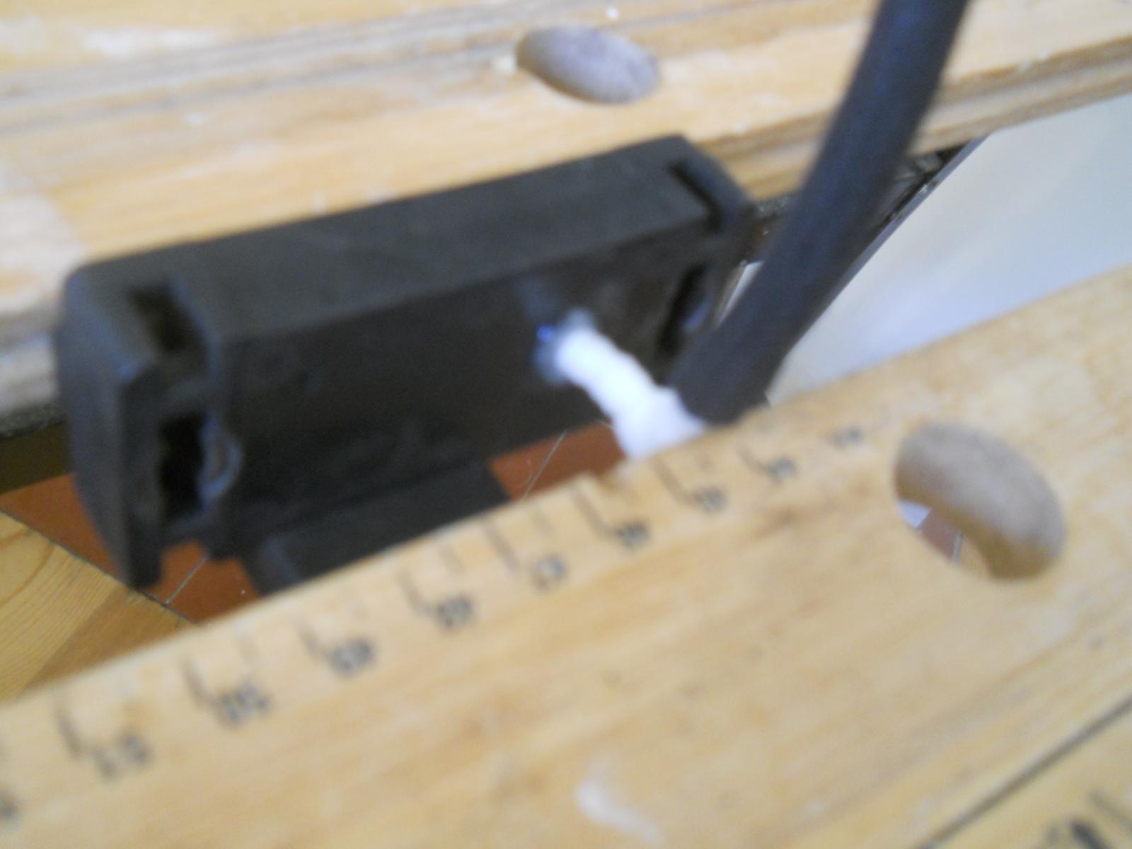

I managed to get a new bit of pipe & today fitted it. Trying to detach old pipe from MAP sensor it was very tight (you can guess what's coming?) 20 year old MAP sensor spigot snaps off (bugger!). I have no idea what gubbins is in a MAP sensor, but the case is pretty thick plastic, so I drilled a hole & glued a Halfruads pipe connector in with Araldite. I put it back together and................ it's exactly the same! I had better get Lamda sensor & maybe a new MAP sensor.

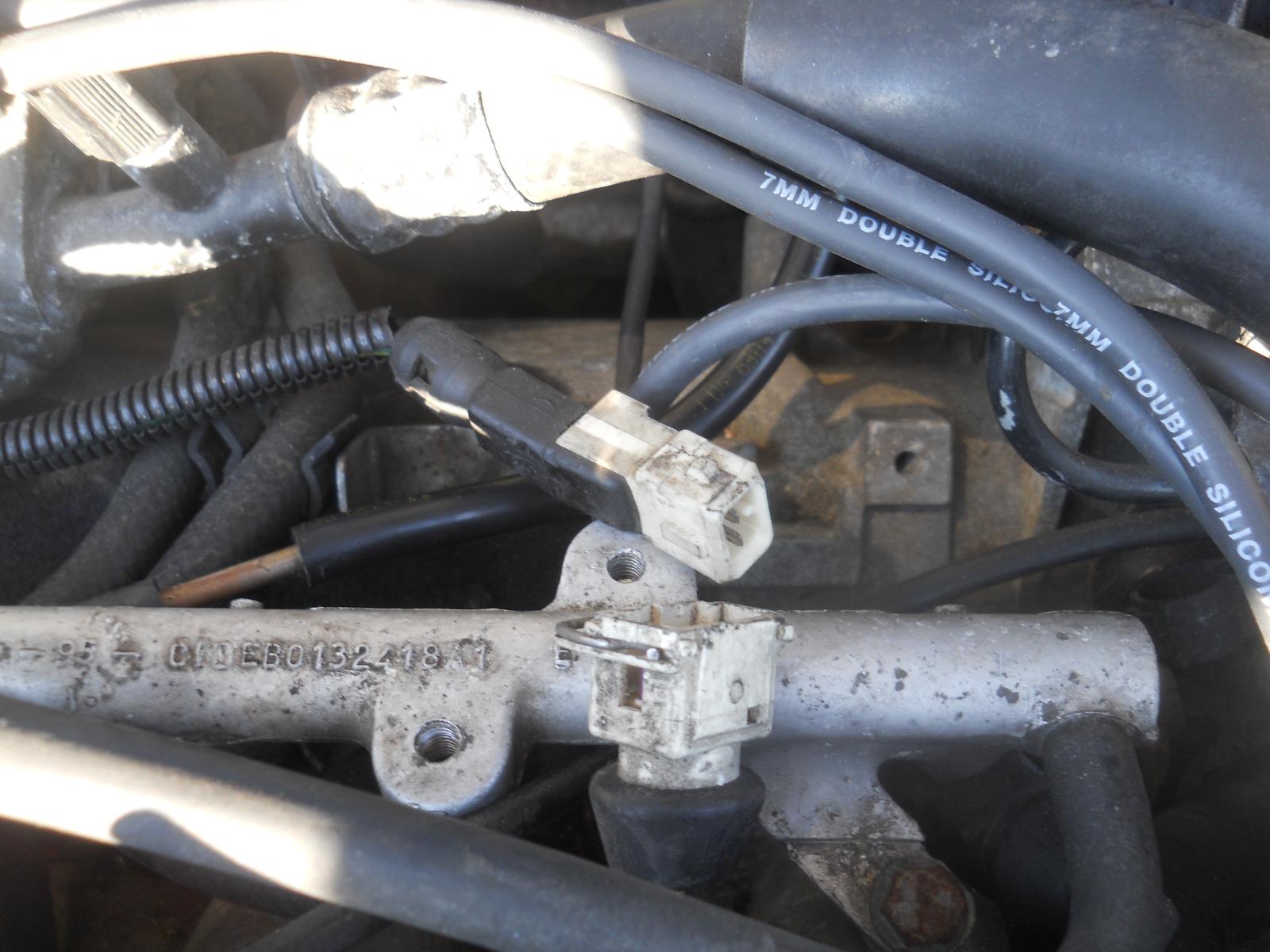

3) Found this cable disconnected, no idea what it's for, didn't make any difference when re connected.
4) MAP sesor "repair"

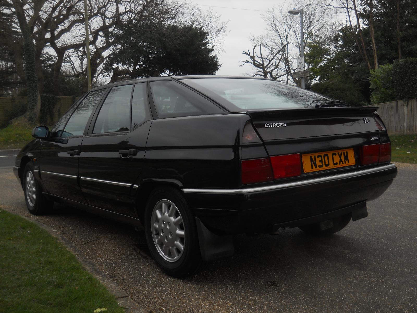

Just gave the XM a wash for the first time in Months and as it's been my daily since the C4 VTS was smashed up, it was pretty grim. Just discoverd that it is actually black!
