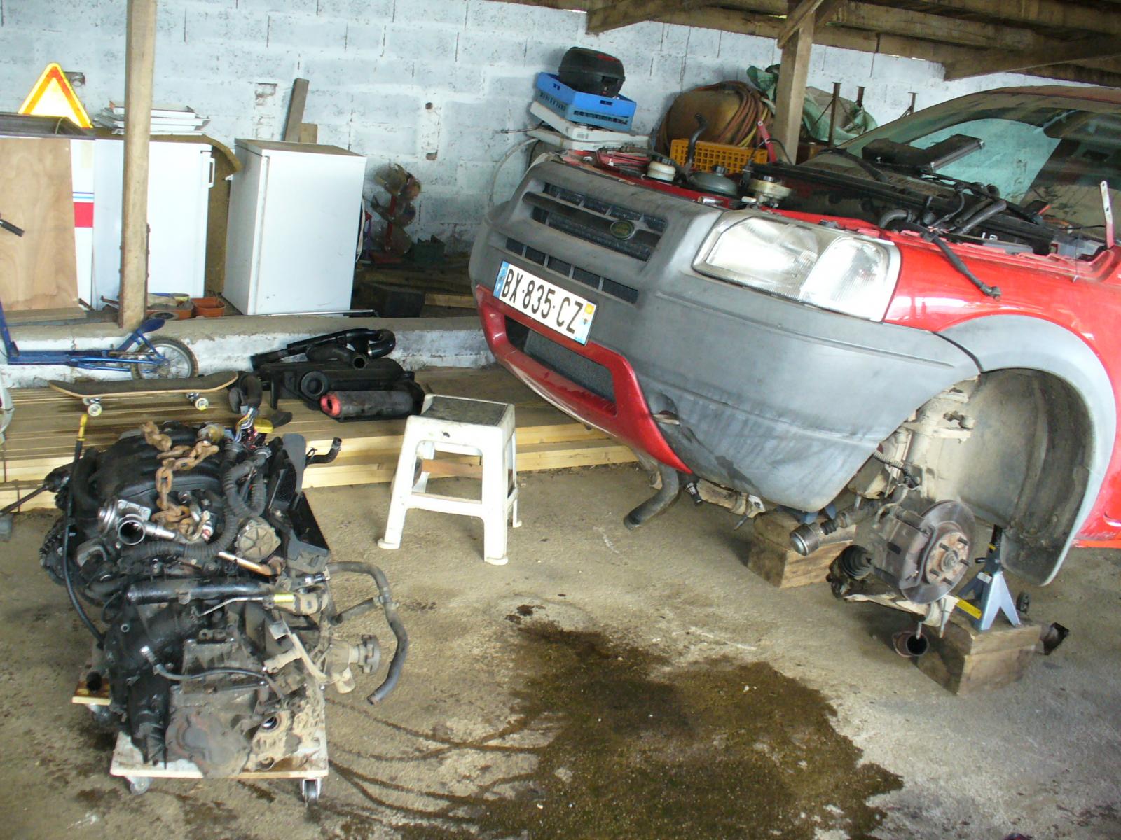

So, I changed the clutch on the freelander a while back and fitted a new slave and master cylinder at the same time as is advised to do. The slave is on of these silly concentric things inside the bellhousing. The parts are separated by a quick-release coupling in the pipe. The slave side of the pipework is metal, and from the master cylinder to the coupling is plastic.

And yes, it was two brand new, sealed units that just straight up didnt work. I am not going to buy another master cylinder as it would be wasted money, and if the fault is with the slave cylinder then that means doing this....
...again and frankly - fuck that.
