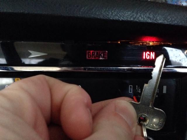

scooters Posted June 26, 2014 Posted June 26, 2014 OK, here's one for you.The car is an 850 T5 Auto estate with 120k on the clock, year 1996.It's been mothballed for the last 6 months and today I put it back on the road. Sailed through the MOT, bunged a tax disc on it and had to run some errands.Now before it was put away it was developing some electrical gremlins - especially-indicator lights and hazard warning lights stop flashing intermittentlyspeedo sometimes fails but odo still worksstrange things happen when you push the winter button - the arrow lights up on the dash - when you press the sport/economy switch nothing happens.I made a metal note to look into these things over the winter suspecting a dodgey connection/earth/fues box.SO - today, driving along start to notice warning lights flickering like a Christmas tree. I pull over stop the car. Try to restart - nothing. So I pop the bonnet only to discover that the battery isn't the battery I put the car away with 6 months ago, turns out one of my colleagues swapped it and replaced it with a 330 crank battery which looks like it might be from a 1.4 Clio - much swearing and a phone call later I hook up the jump start pack and get the engine going, drive 100 yards and once again, dash like a Christmas tree and it dies in the middle of the road. Jump pack again - this time I get 1/4 of a mile before it happens again. I'm round the corner from Unipart so pop round and spend £80 on a brand new Unipart stock battery for the 850 T5 with a 4 year warranty.Now while I am round at Unipart, an RAC man turns up speaks to my wife, bungs on his tester and announces that the alternator is borked. However, he doesn;t know about the wrong battery or that the car has been laid up for 6 months with all the fun that entails (old petrol etc), I come back with the new battery and pop it inI pop the battery in and no problems at all - no warning lights, every thing working fine, nothing to worry about. No charge warning light.Except -I switch off the car and the charge warning light/battery is illuminated.I disconnect the battery and run to the PC -Thoughts?I haven't got my multimeter with me so can't test output. However, I do know enough about charging systems to know that unless you have the right size battery in the circuit to start off with you can get all sorts of readings especially with this new fangled modern 19 year old stuff.
the judge Posted June 26, 2014 Posted June 26, 2014 Sounds like overcharging and a duff diode pack. May go away with more use, but who knows?? fordperv 1

scooters Posted June 26, 2014 Author Posted June 26, 2014 Wise heads on yank volvo forum say this: "The amount of voltage an alternator puts out is second to the amperage. If called to do so the alternator in an 850 should put out close to 100 amps, it's what they are rated at. The voltage will vary depending on the state of charge of the battery and the amount of accessories operating at the time of the test. 13.6 volts is NOT below normal, having a charge or battery light on is.The alternator may be bad but if it were it's because one or more of the diodes had gone bad and is allowing the battery to discharge through the alternator. It's fairly rare but it's difficult to catch. The alternator will charge properly when it's running (like your light being out) but when you shut it off the battery starts to feed current back through the alternator so it acts like a big light bulb draining the battery but nothing physical to warn you it's happening (except volvo do warn you with the charge light). You need to check for a draw and find out what is causing it.If you pull the big wire going to the alternator and the light goes out you likely have a bad alternator. If you take it in and have it bench tested it will likely pass even if it has this fault as most testers are looking at what the alternator can produce rather than if there is a "leak" !" The sitting around outside over the winter could well have caused some diode issues - other gremlins seem to be sorting themselves out as the car is used. We will see what happens over the next few days - in the meantime I'll disconnect the battery overnight
