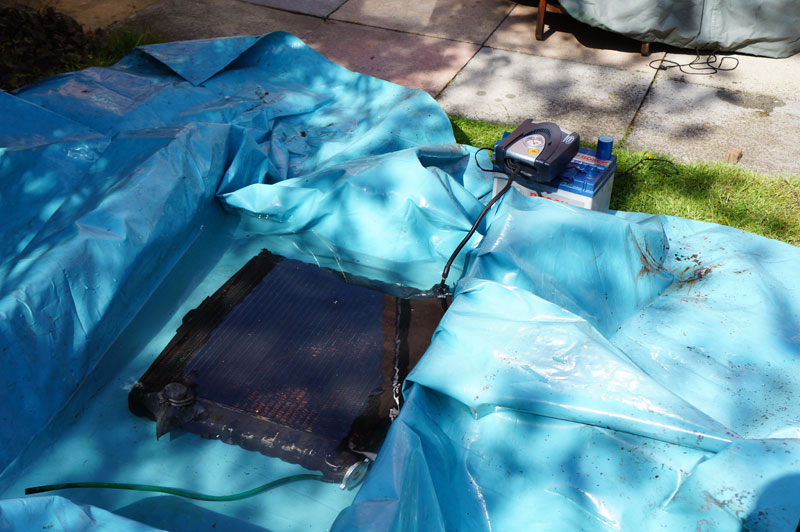

Conrad D. Conelrad Posted April 29, 2014 Author Posted April 29, 2014 I have sorted the temperature gauge in the red issue, it was an airlock. Gauge sits dead centre now. Nice simple one, that. lol no But now with cautious optimism I think I might have solved this issue. First job was to check the radiator. I took it to my radiator testing facility, but not a single air bubble was seen. It might not be working at full efficiency but at least it's not leaking. Next up: the thermostat, trapped under the fused on housing. An afternoon of PlusGas, prying screwdrivers and (most effectively) mallets got that changed for a known good one (albeit 88º instead of 82º) with only one snapped stud. Bucketeer and Junkman 2
