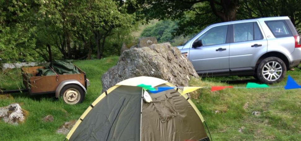

But old Rimz on traloors is for winnahs. My camping trailer has A40 Farina wheels,complete with brake adjuster holes for mk1 non hydraulic back brakes.post-17414-0-02691300-1389956405_thumb.jpg
I bet,those wheels never went as fast on a A40 as when I forget it's there on the back of er indoors' Freelander.
