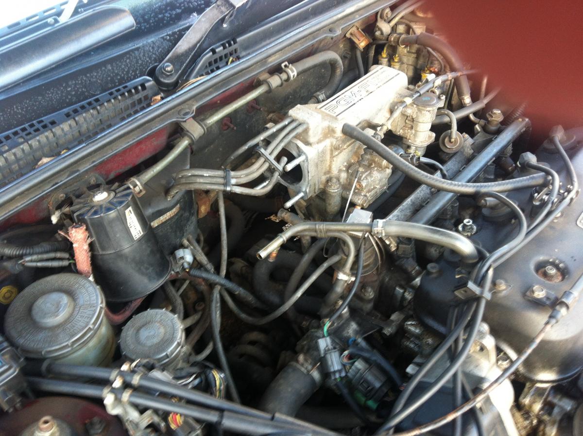

Thought i would start a thread re honda as i am going to make a start tomorrow,with the help of my son in sorting faults.
No pics today as i have just been looking at what needs doing at moment,but plenty to come as things progress.
first job will be to sort sticky throttle cable,It sticks when first used and takes a fair bit of pressure before it pops free,also mahes car a bit jerky to drive.
cable looks ok so i suspect that this will be a lubricate and adjust job.
Has squeak /rattle from osr wheel,sounds like pads sticking or something,so this needs checking out.
Abs light comes on after a while,maybe connected to above.

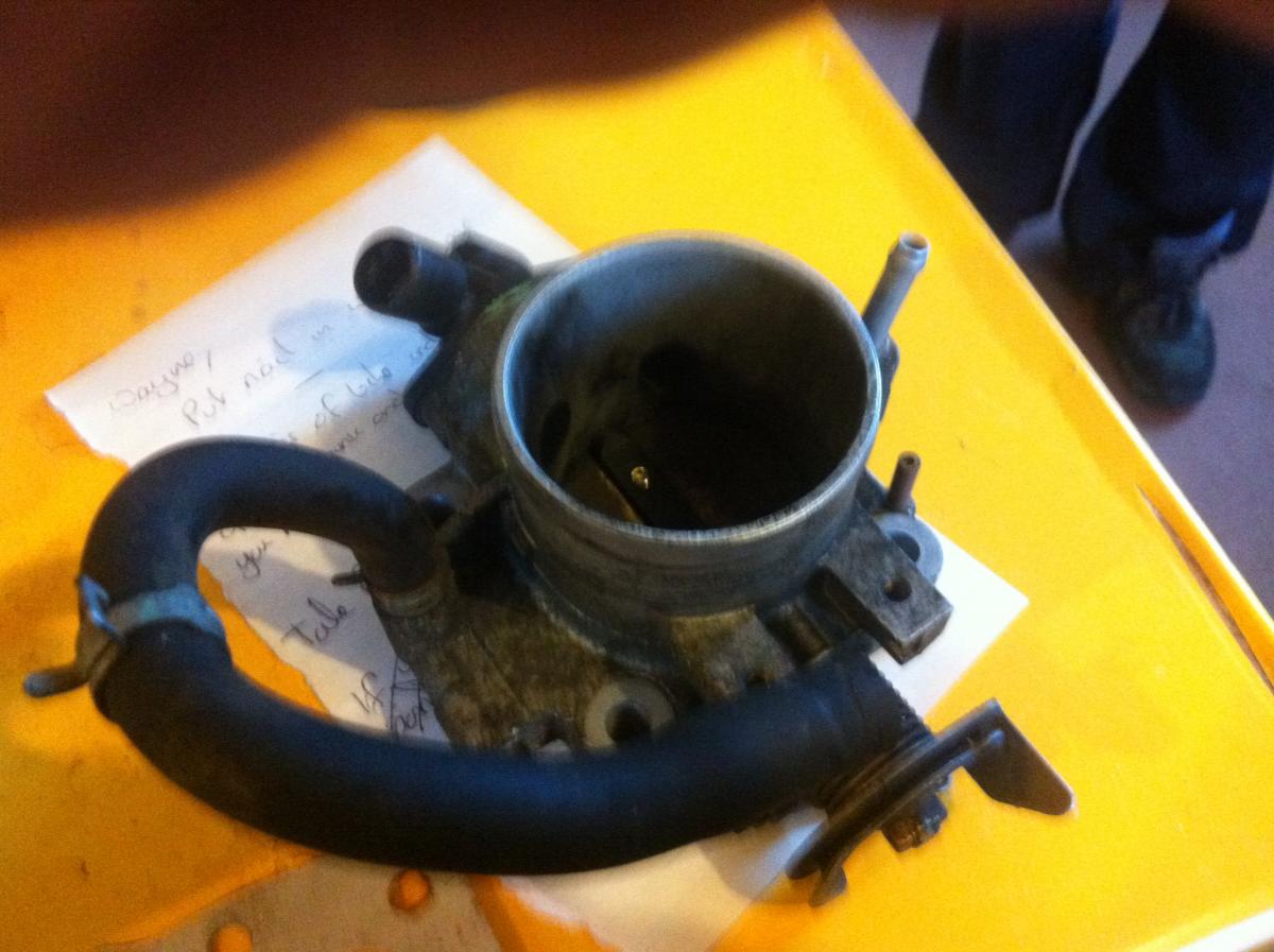

The sticky throttle will be crap/ carbon build up round the butterfly. 5 mins with a rag and some carb cleaner will sort that out.

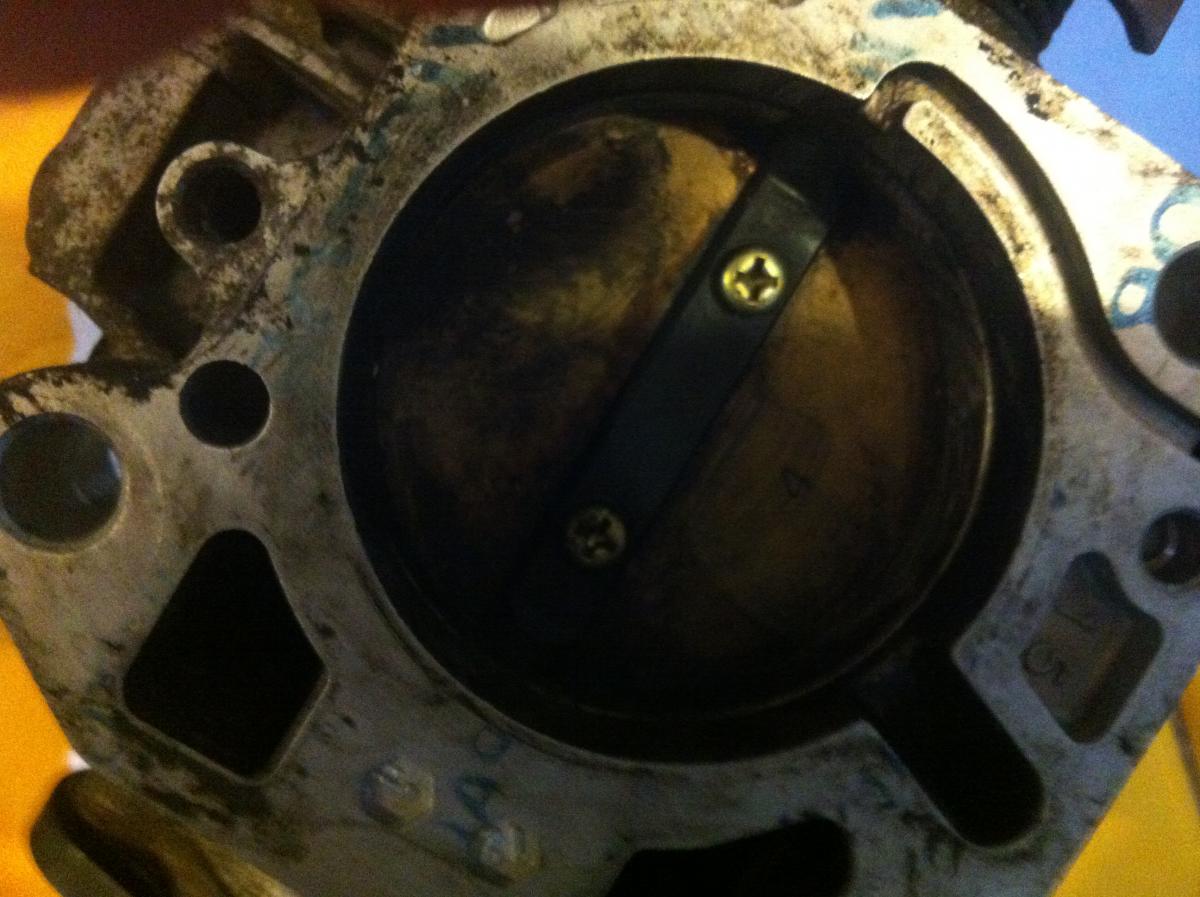

Well we sorted the sticky throttle,Removed it
Good clean with carb cleaner.
New gasket made
But carbon wasnt problem,the screw that sets throttle stop was loose allowing butterfly to jam in housing,set this to correct clearance and locked it.
Problem solved
