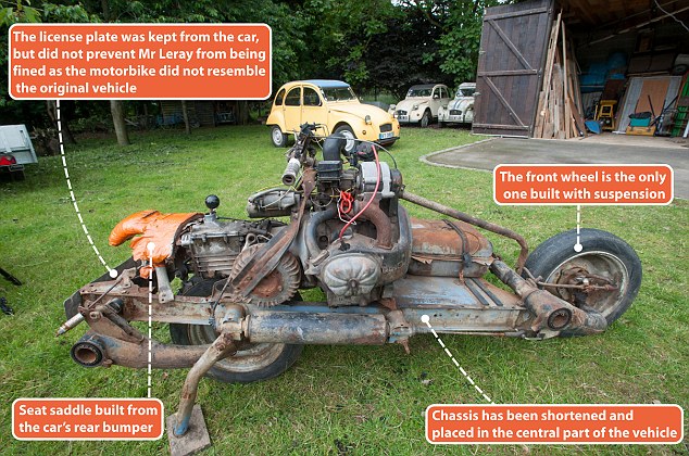

  • Emile Leray broke Citroen in Moroccan desert 20 miles from nearest village
  • He engineered own rescue by rebuilding the damaged car into a motorbike
  • His hastily-made vehicle included the car's bumper as a seat
  • He put car's engine and gearbox in middle of vehicle and shortened chassis in rebuilding job which took 12 days

At first sight there doesnt seem to be connection between gearbox and back wheel,steering looks unworkable,and no sign of a battery.

Hold on a minute, it's nearly possible.
article-2168061-13E6FE96000005DC-594_634
The battery can be seen just behind the fuel tank, the steering would be at least as effective* as those ridiculous trike things, and it looks like the power comes via direct drive onto the back tyre from the stub on the gearbox.
One drawback: four gears backwards, and one forwards, massively geared down.
