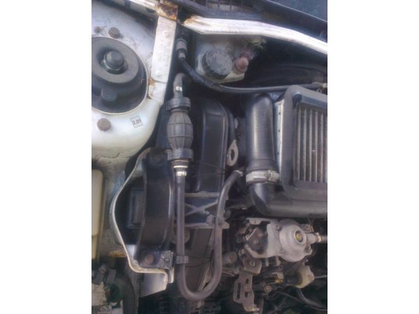

Cavcraft Posted November 3, 2013 Author Posted November 3, 2013 Right, same sort of question, different day. What fuel pump is this, please? Thanks in advance etc.
Partridge Posted November 3, 2013 Posted November 3, 2013 That looks quite new? Could be a chinky "Dingshung" one I fitted to a mate's Pug this week.Or if you mean what kind of pump, they call it a 'bulb' pump.
Cavcraft Posted November 3, 2013 Author Posted November 3, 2013 Hey?I meant is it Lucas or Bosch. Not Len Hatred Lacquer Peel I love Scotland Alex Salmond horse train I have shit taste in cars! Partridge 1
Partridge Posted November 3, 2013 Posted November 3, 2013 Just thinking it looks very new?It may sound obvious but have you had a good look to see if it says who made it on the pump itself? Do you know the part number, you could google it.
Partridge Posted November 3, 2013 Posted November 3, 2013 just googled BOSCH fuel pump, and yup, looks like Scruff is right.
Cavcraft Posted November 3, 2013 Author Posted November 3, 2013 WINNAH! Cheers, Scruff. AP: I couldn't look because it's not my car and I'm nowhere near it's location. Yet. Partridge 1
