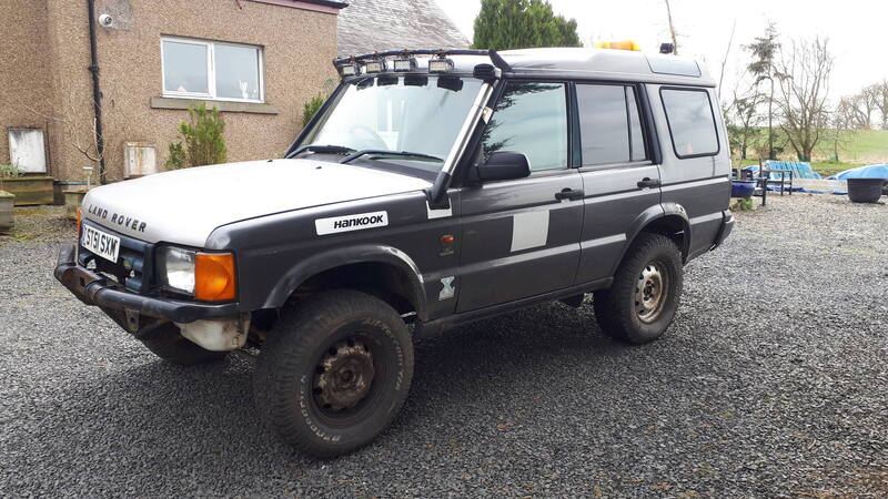

garbaldy Posted April 10, 2020 Author Posted April 10, 2020 Does anyone fancy this disco ? I stuck it on bumtree and have had plenty interest and offers for swaps but none serious enough to pledge a purchase.

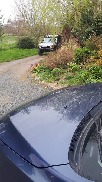

garbaldy Posted April 10, 2020 Author Posted April 10, 2020 Let's off road. loserone, Jim Bell and rainagain 3
garbaldy Posted April 13, 2020 Author Posted April 13, 2020 Disco now sold and reversing off onto pastures new. Corona Distancing sales are easy chuck them the keys and tell them my bank details.
