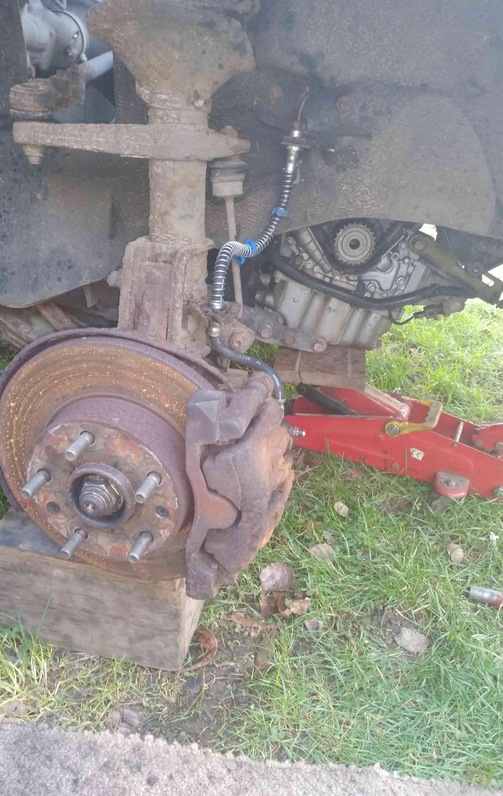

All the brake hoses are replaced along with some copper ones that had eroded in a way I've never seen before. Last owner must have kept it parked in a midden.
