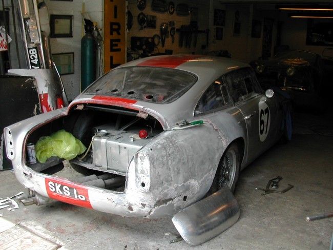

seth Posted August 26, 2010 Posted August 26, 2010 I know someone in Ealing, West London who knows what he's doing with this kind of thing. Here's a DB4 GT he was repairing one time I popped by. It had gone backwards into a tyre wall I think. What car is it?
AXrescuer Posted August 26, 2010 Posted August 26, 2010 Is it an Airfix 1/32nd scale Aston Martin DB5
Des Posted August 26, 2010 Author Posted August 26, 2010 Good soap tip Boswell, Had heard that oil will start to smoke at about the right temperature, but soap will be far less messy, hadn't heard of using a wood dolly either. It's an old Bristol Seth, Ealing is fairly close, wouldn't mind your guys details, could make sense for me to get off my backside and do some work so I can pay someone to sort out the tricky bits, the cars been off road for 4 decades, one of them down to me.
