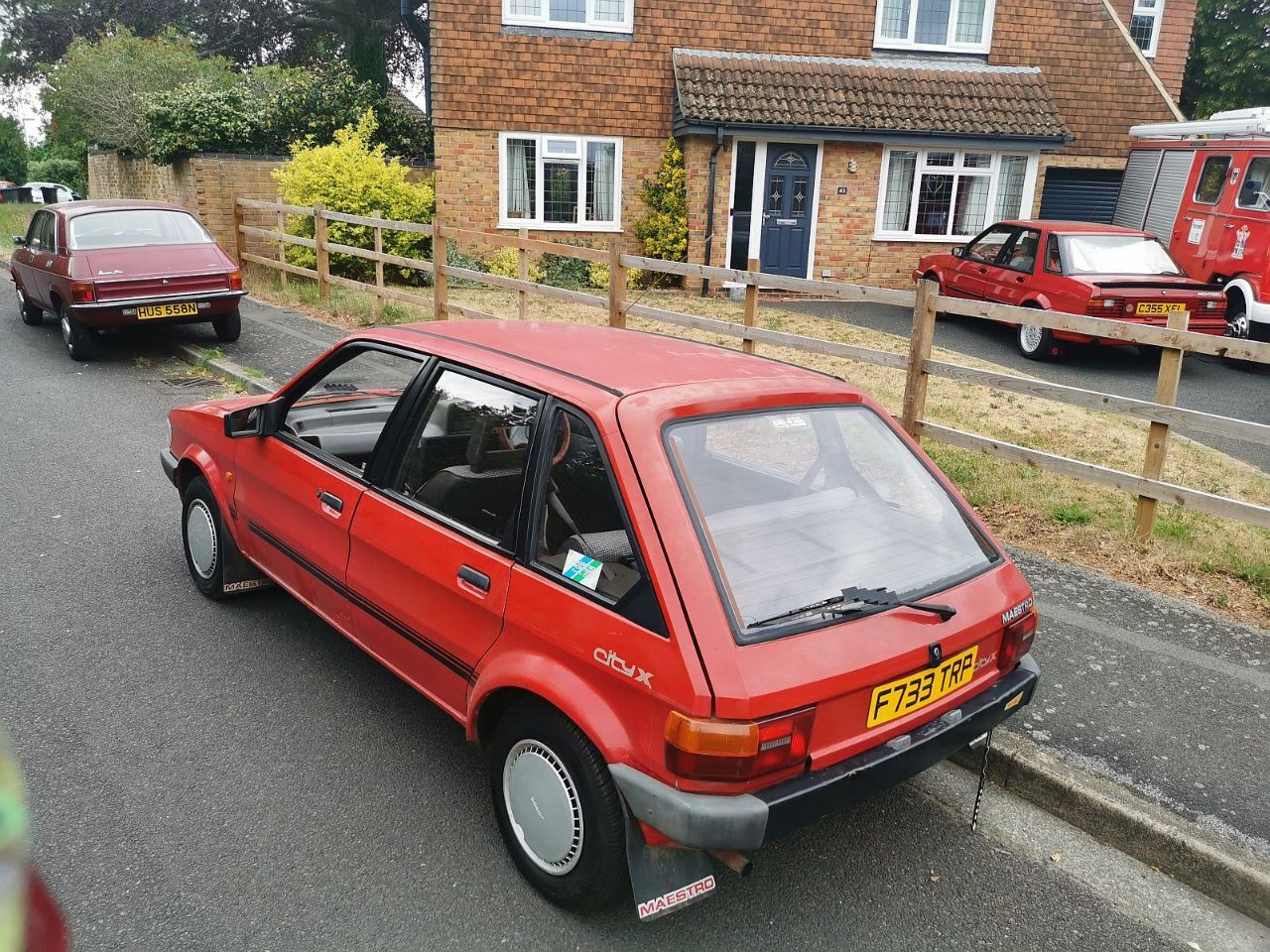

It was white with a blue tinge apparently, but I have yet to be followed since we got it running smoothly and quiet now having adjusted the valve clearances it's so much quieter and on a quick drive around the village it's like a different car altogether, so much more responsive and accelerates freely up to 50 so I'm hopeful we are getting closer to getting it back to being usable. It's sitting at 183,xxx miles currently, I've not put more than about 350 miles on it due to it's mechanical situations, and it being a one-owner car until what... 4 years ago? where it seems to have been "kept going" rather than "no expense spared". I will return to the smoke situation as I certainly don't want anything getting worse considering how much better the car is getting every time something gets sorted but a little break from the engine side as the next bit is a leak test on the boot to see where the rain is coming in from before going back to mechanics...

Only a small update for this week. Maestro is now running so smooth and is actually fun to drive finally. A friend told me about an Allegro and Montego (MG) in the next town he had seen on his way to work so I stole an hour of my day to take the Maestro out for a run to meet some relatives. Talking to the owner the Allegro has been sold and collected by the time I'm posting this and the MG was listed for sale this week, only has 25k original miles and was in stunning condition, unlike my 183k miler I took to see them!
