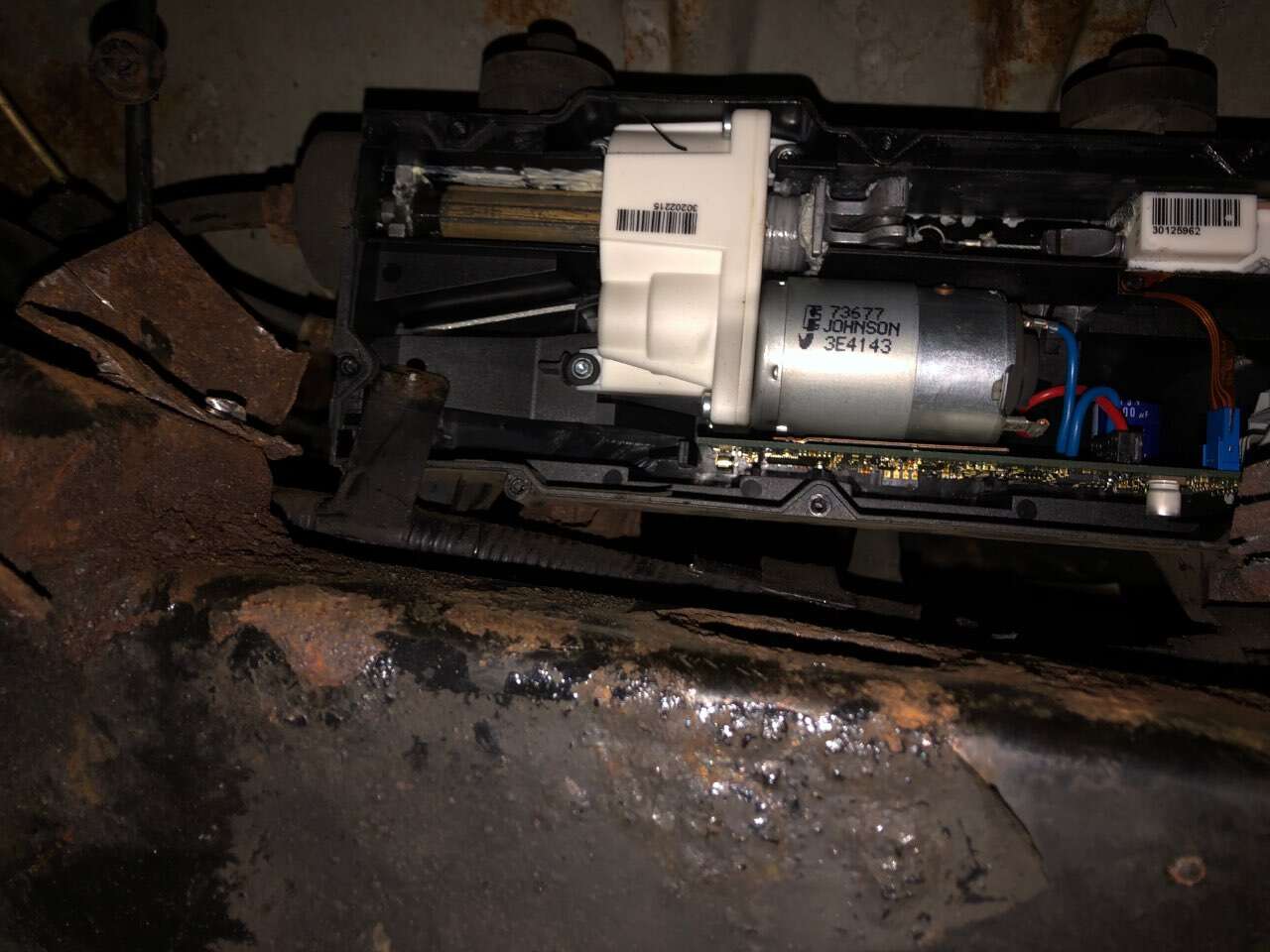

SiC Posted February 14 Posted February 14 On 03/02/2025 at 17:55, Urko said: So this is the gubbins - apparently I need to wind in the slotted rod at top left as it's extended too far. If I am lucky that will sort things out (pending inspection and adjustment of the parking brakes). If not, I am going to need the plastic cogs I bought in a kit off eBay just in case. That looks almost identical to the units that Renault use on their vehicles of a similar vintage. Urko 1
Urko Posted February 14 Author Posted February 14 21 minutes ago, SiC said: That looks almost identical to the units that Renault use on their vehicles of a similar vintage. Crikey - that's actually very useful, I am just watching a video of a bloke doing one on a gooner 3 and the internals appear identical. Coprolalia and Barry Cade 2

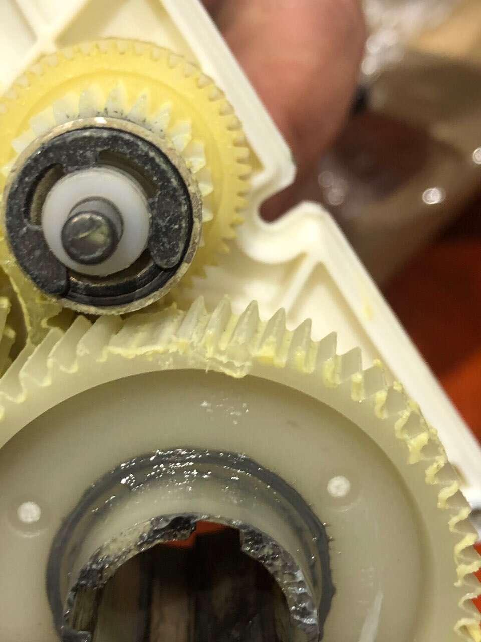

Urko Posted February 15 Author Posted February 15 Round 2 today. At first (after a lot of struggling to remove it) I was dissapointed there was no obvious problem with the wee plastic gears - until I looked a bit closer - Yeah, that won't be helping much. Wibble, beko1987 and GrumpiusMaximus 3
SiC Posted February 15 Posted February 15 I think I've got an old Scenic II unit in the garage. Bought it second hand as something to test against CAN diagnosis. As a compulsive hoarder, I don't think I threw it away. If I haven't, would it be useful to you? No idea how similar the insides are but maybe some bits might be useful from it?

Urko Posted February 16 Author Posted February 16 Well it's all back together and working. New cogs fitted - ebay £29. I haven't been able to deal with the issue of the rusty remains of the old mounting plate and the bolts so I have zip tied everything to within an inch of its life. Parking brake started working normally straight away with zero issues and no coding etc. needed. beko1987, Rust Collector, Tickman and 2 others 2 3
