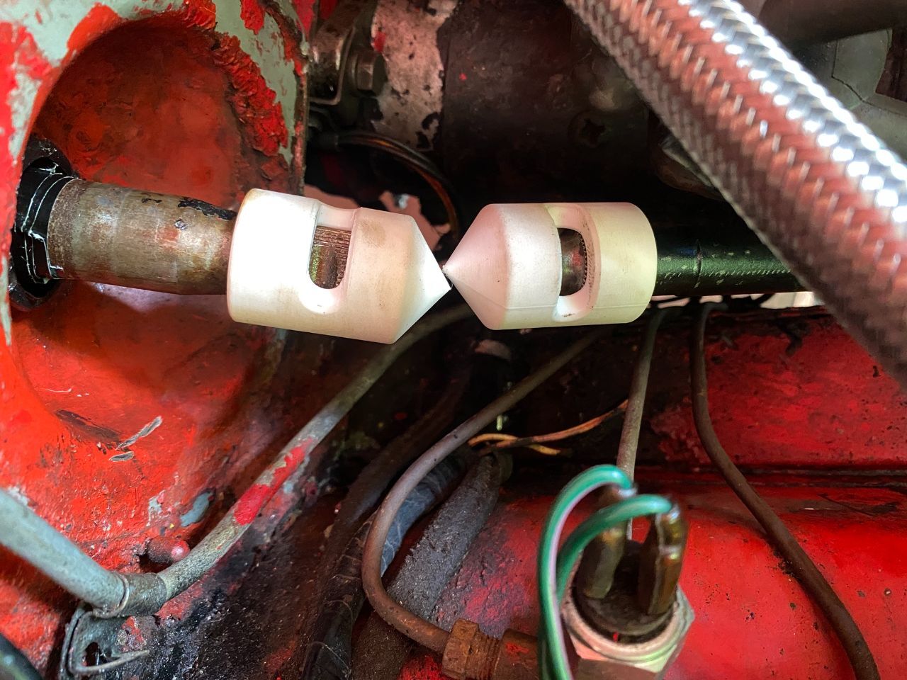

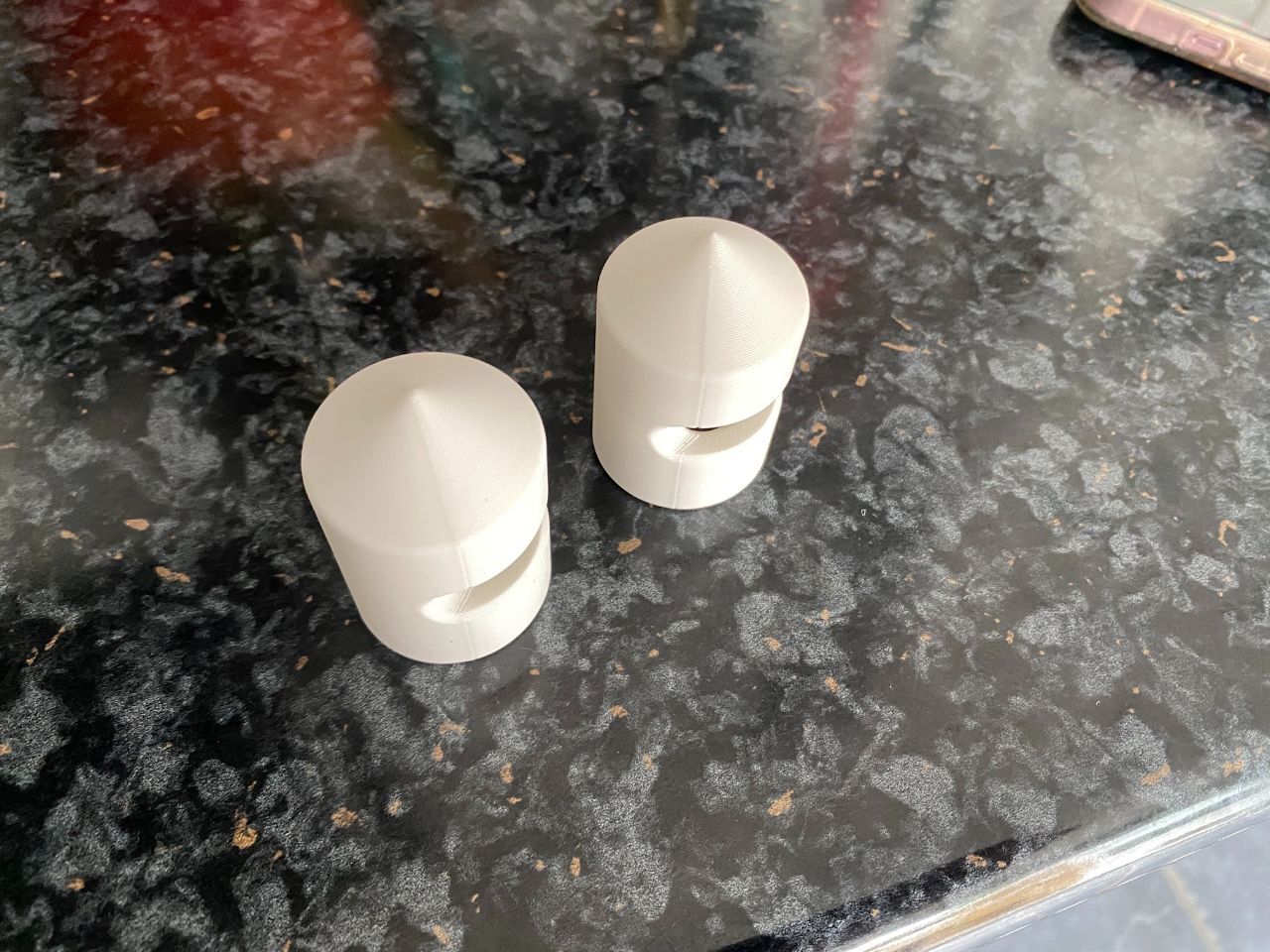

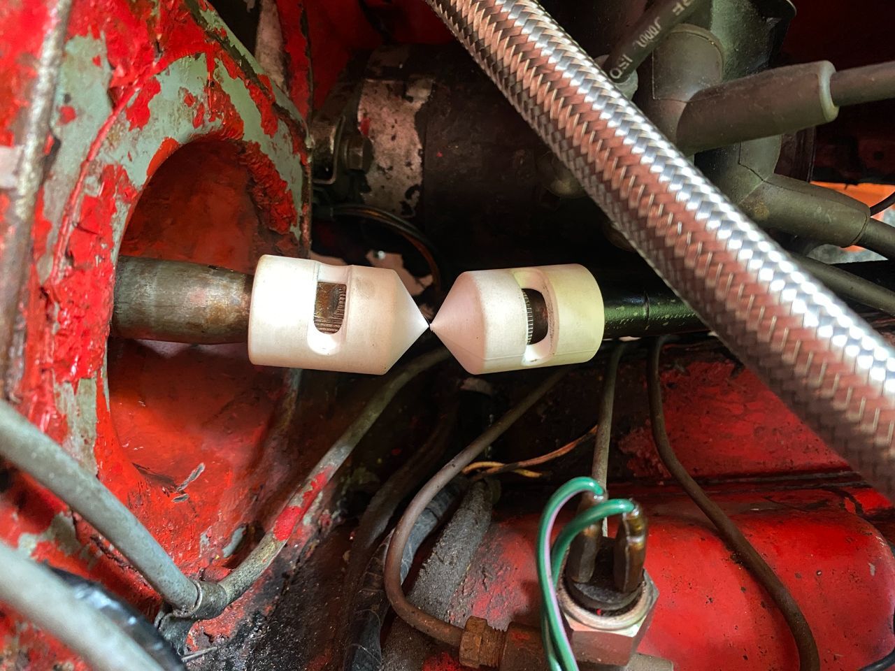

These funny looking things arrived a couple of days ago. Once I'm done fixing the MGB they could be fun in the bedroom.
I put the guides on the ends of the upper and lower steering shafts and immediately I knew that the shafts were misaligned.
I sorted the vertical misalignment by placing a washer between the steering rack and the subframe.
At first, I couldn't figure out how to adjust the horizontal misalignment. Most of the advice I found from Google searches discussed adjusting the upper column up and down but nothing about moving it left or right.
Then I found this: Steering Column/Rack Alignment

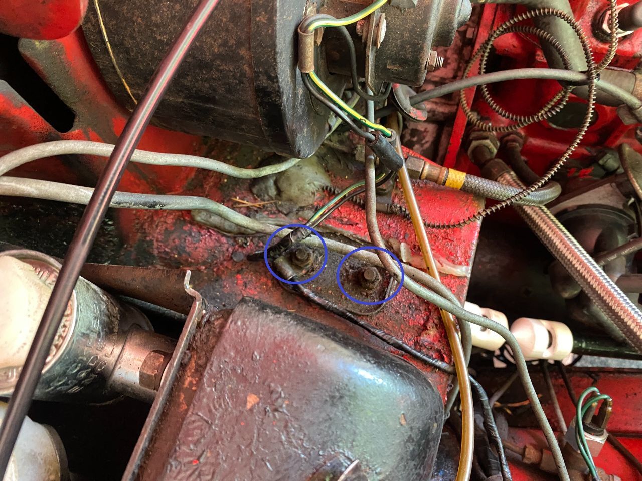

And I figured out that adjustment can be achieved by loosening these two fixings, which secure the lower steering column bracket to the underside of the bulkhead.
Luckily, despite the extensive corrosion, both fixings loosened just fine and enabled me to adjust the upper shaft across.
Hey presto.
I re-fixed everything and went for a test drive.
The problem is 95% fixed. There is still slight tightness around the straight-ahead but it's very slight and the steering now self-centres ok. The remaining tightness might be down to the steering rack having just been rebuilt or perhaps some more adjustment is required. Now that I know what I am doing, I might have another go in the future.

Nice one👍
That alignment didn’t look that far out without those pointer things, but it actually was miles out wasn’t it!

Hopefully that straight ahead stiffness is the tips of those new parts being nice and tight. Might sort itself out with some use?
It did look mega out before though so 🤞

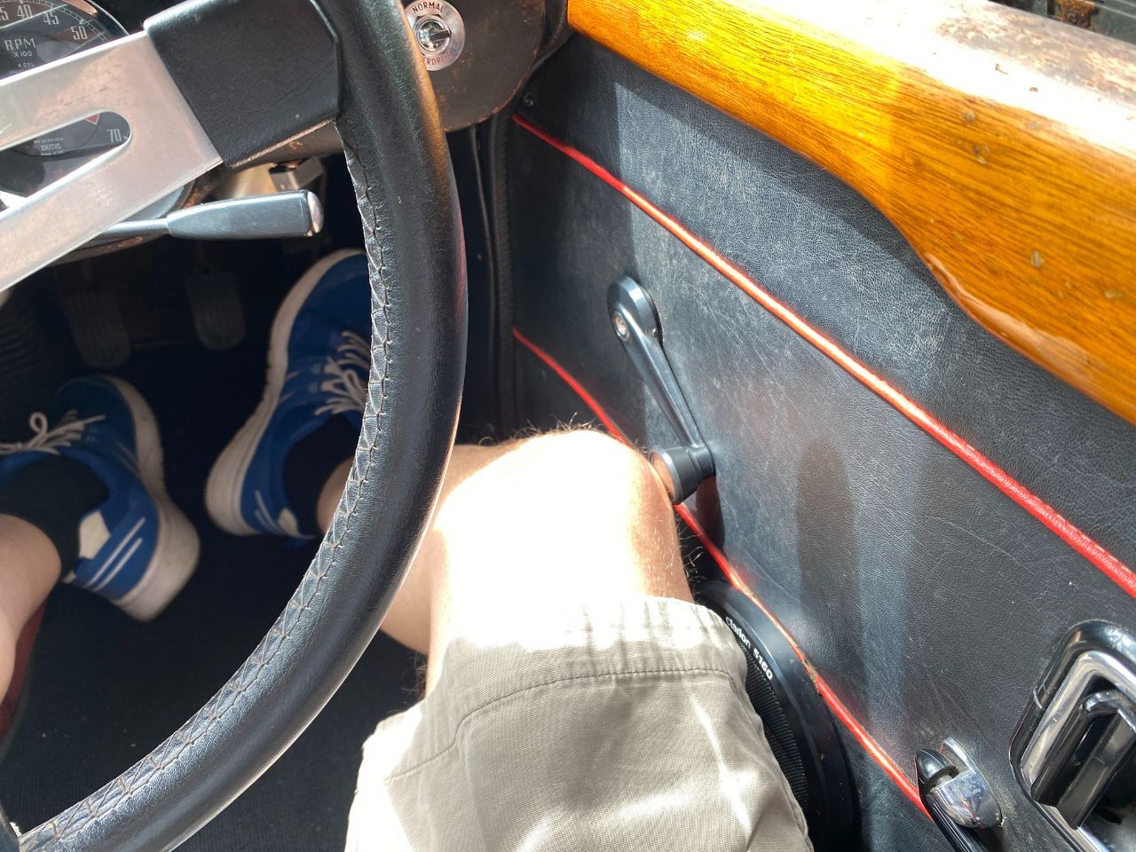

Next job was easy. I can get fairly comfortable in the MGB but on longer journeys I like to rest my right knee against the door. I also like to drive with the side windows down. Unfortunately, with the window down, the winder prevented me from getting comfortable.

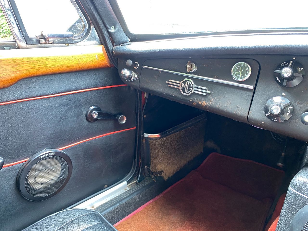

I removed, rotated and re-fitted the winder. Job done, all good now.
Naturally, I also changed the position of the passenger side window winder, as my OCD would not allow me to cope with having two winders in different positions.
