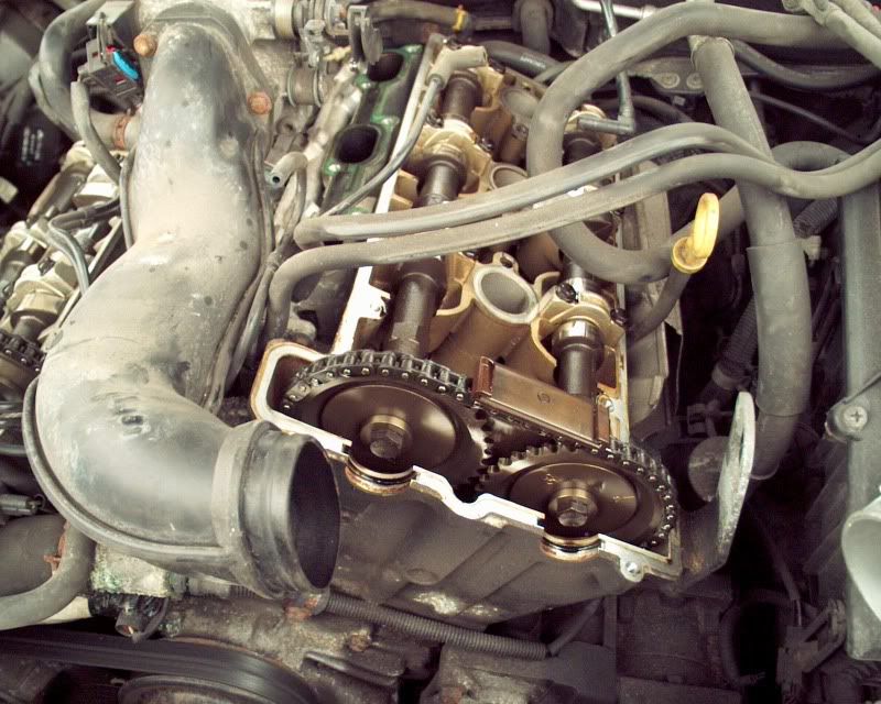

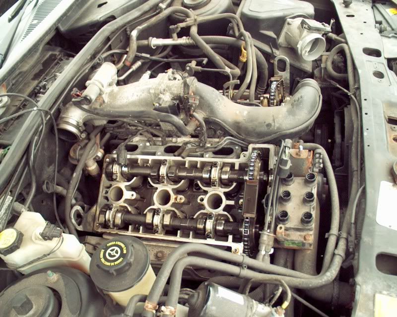

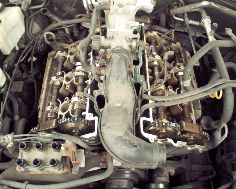

dont talk to me about 24v ultima'si borrowed one yesterday, and i killed it this morning :oops: either one chain snapped, or one chain slipped because of a tensioner failure. sounds terrible, no power, maximum 3k revsowner going to investigate tomorrow
Could it be sensor failure and on limp-home mode?
No leccy rear seat on the frogface, it was only available on the earlier sierra style granadas.Ace cars though, is it a 12 valve or 24valve? i think 95 was the changeover year
could be...........
as the chains both look fine, and still seems to be timed-up
top end looks remarkably clean after 130K miles
