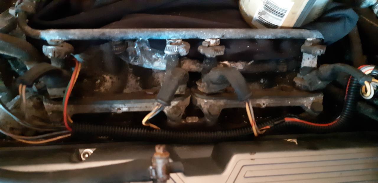

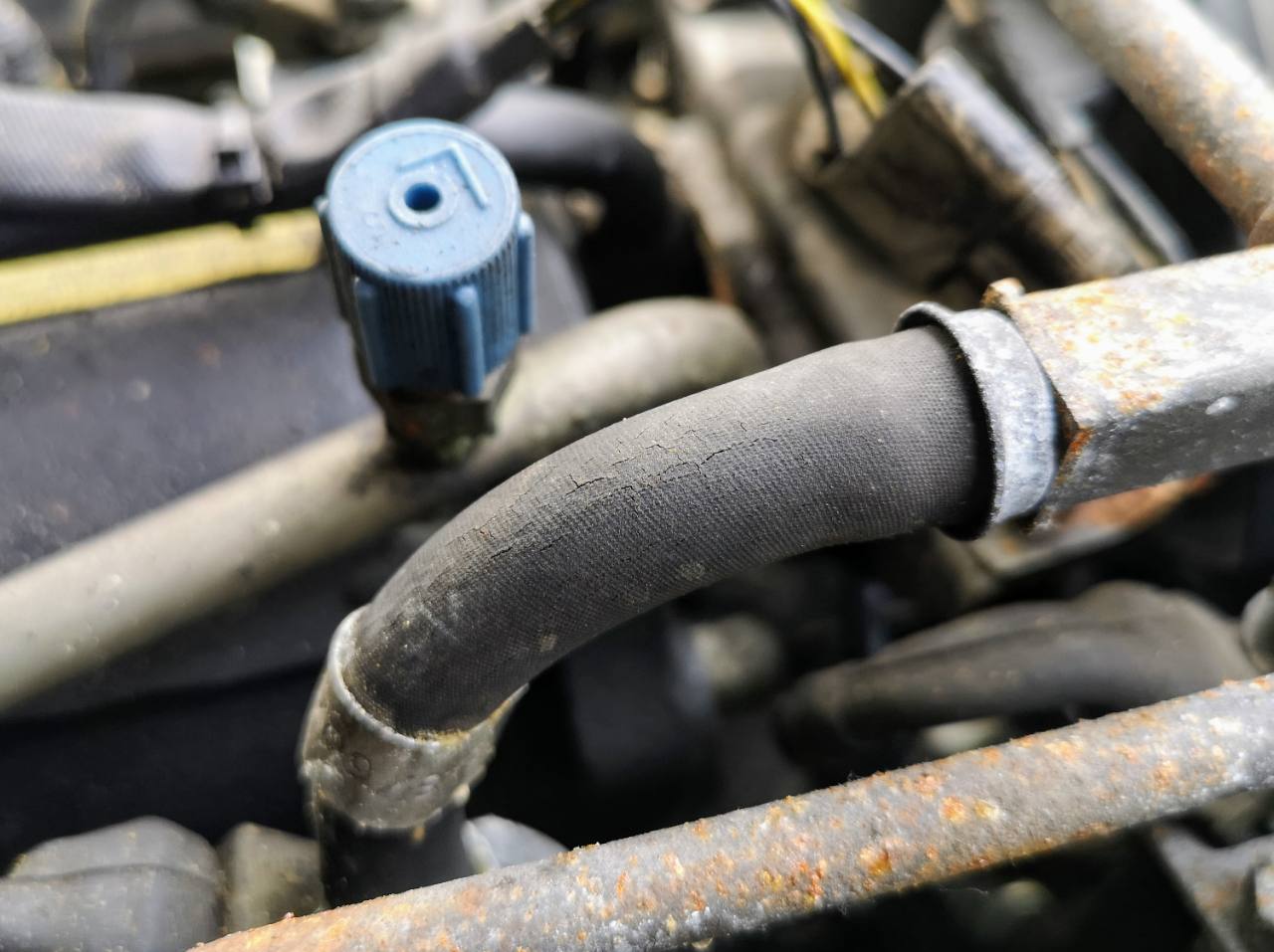

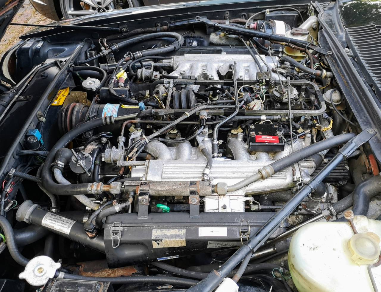

Much of the hose on my SD1 has never been replaced - it has done well to last 35 years. The hoses that are fitted to the injectors are original - not surprising as replacement is not a five minute job.
Mindful that the injectors had never been touched I thought it prudent to give them a service. A kit comprising new hoses, ferrules, pintle caps, filter baskets and seals were obtained for around £60. Not cheap - but something you will probably only do once.
I removed injectors and rail in one - it came out fairly easily. A blast with an airline before you start (or a vacuum) saves shit entering the inlet manifold - there will be a ton of it as well.

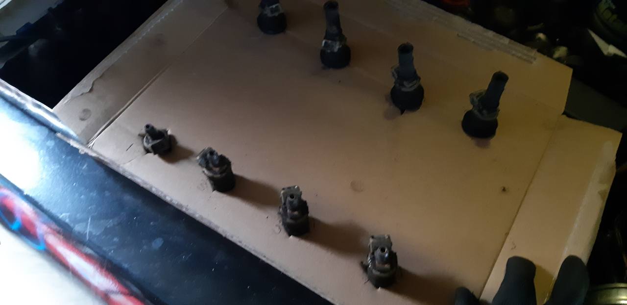

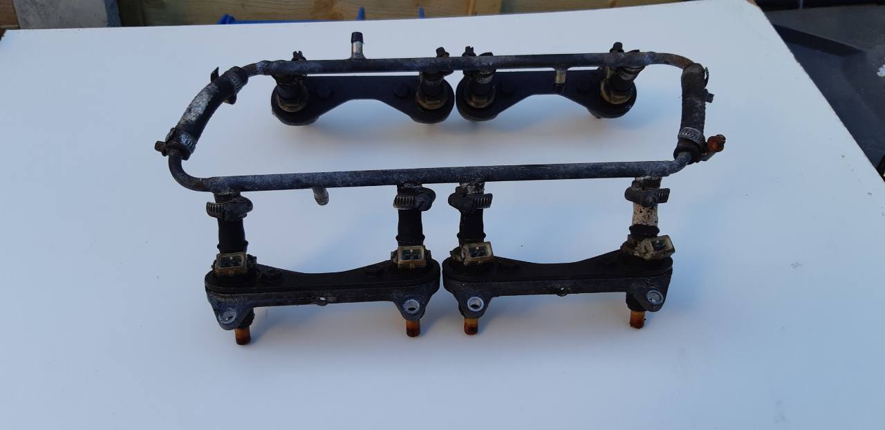

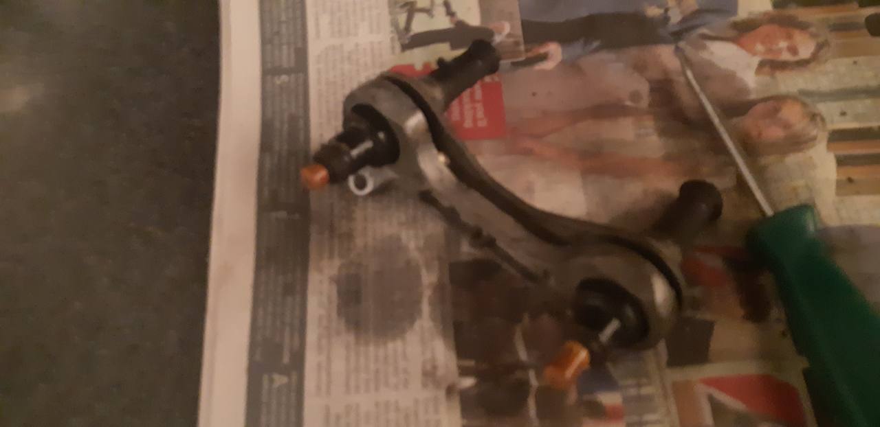

I dismantled the rail and removed the injectors from their housings - corrosion had done a good job of holding everything together.
Once they were out I put them on some card - they needed to have the hose and ferrules removed.

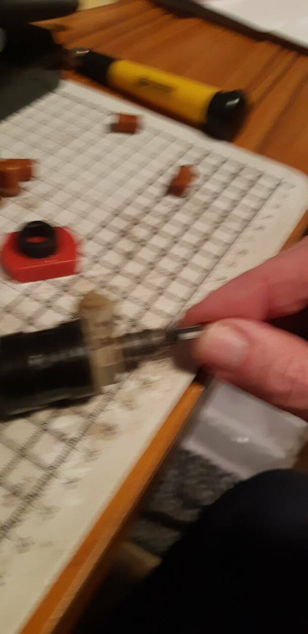

Cutting down the hose and into the ferrule with a junior hacksaw is how you remove them - a pair of thin nosed pliers is then used to pull them off. The original hose was still hard to get off - austin rover used good quality hose.

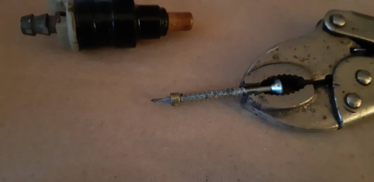

Next - removal of the filter baskets. A wood screw wound in just slightly is enough - a pull (and a wiggle) and the basket is out - I used vise grips to pull the screw out.

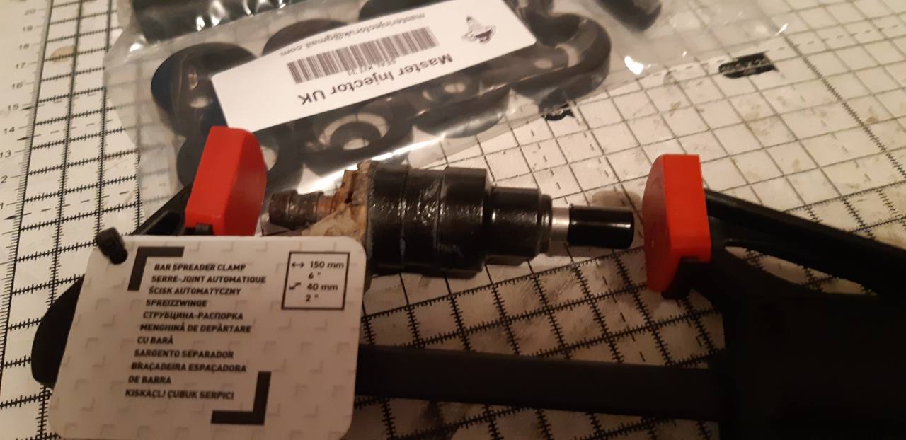

The pintle caps were placed in the hole and tapped in with a rubber mallet - I bought a spreader clamp to push them in but it was too much of a struggle. Apologies - it should say filter baskets.
Pintle caps - I cut down them on either side with a hobby knife then pulled them off with pliers. The spreader clamp I mentioned earlier was used to refit the new ones - you will hear a " click" when they are fully home.

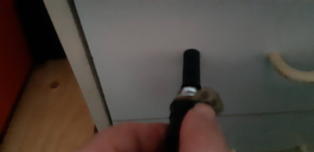

To fit the hoses was simple - put the ferrule on the metal inlet. Take the new hose and lube the bottom 2mm - I used silicone spray. The hose is pushed onto the inlet - you then push the hose and injector against something solid. The hose will now be fully home - the inlet has a double arrowhead - the ferrule grips the pipe and the arrowhead prevents the pipe and ferrule moving up the inlet.
I then fitted the rubber o rings around the outside - these sit inside the fixings that hold the injector - a plate then screws down and clamps the pair of injectors in place.

These are past their best.
