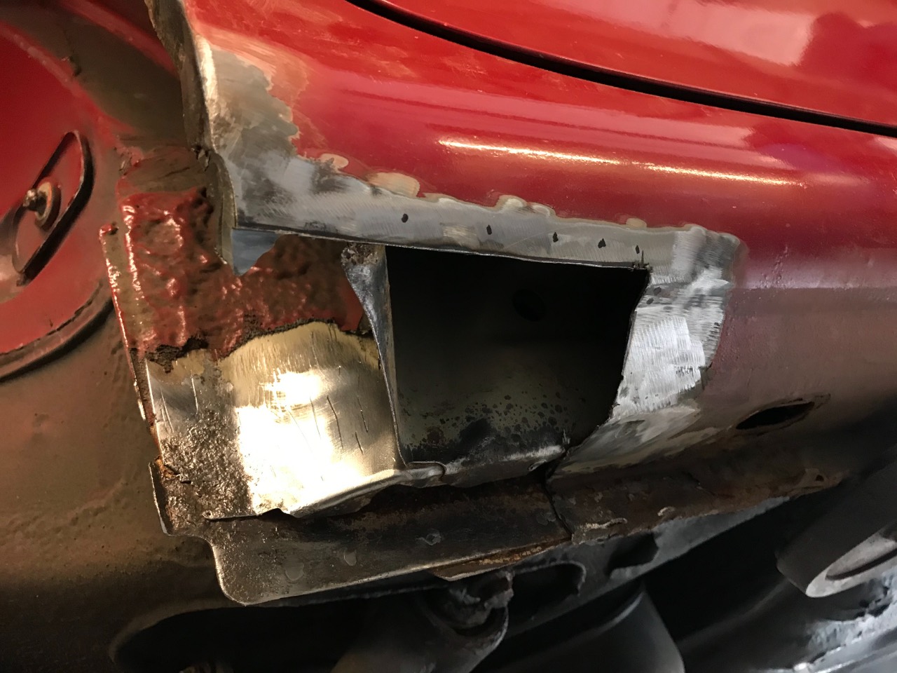

Not a massive patch, as you can see, but the grot had gone into the base of the wheel arch, which the repair panel included. Prep done, patch ready to go in.

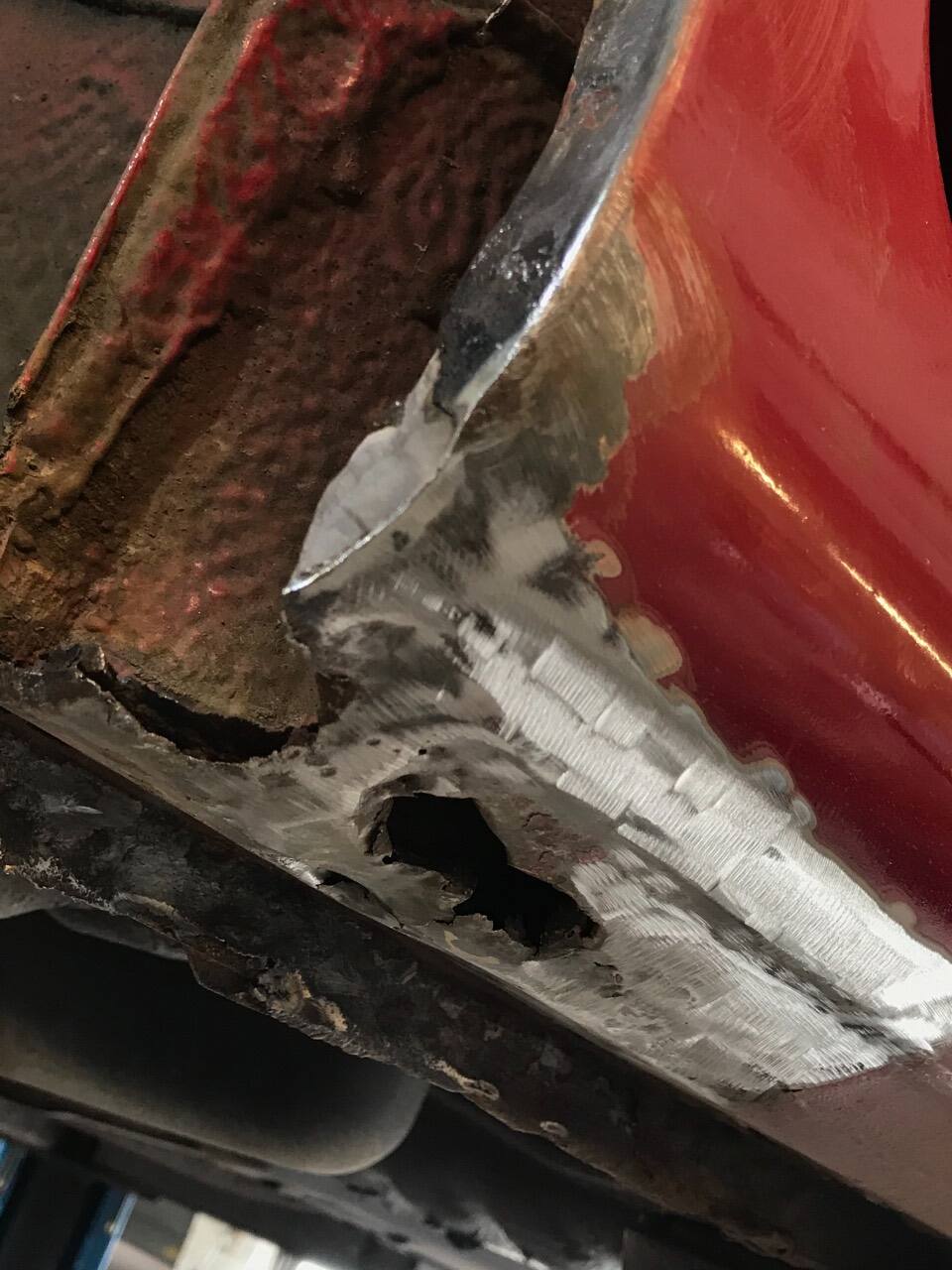

Extent of the corrosion;
Cut back to decent metal;
Welded, ground back, skim of filler and etch primed. Should look better with stonechip and body colour.
Top work.
Could have easily slapped a patch on the sill, followed by a massive black tide mark, but glad you didn't as looks miles better when done as you have which is properly.

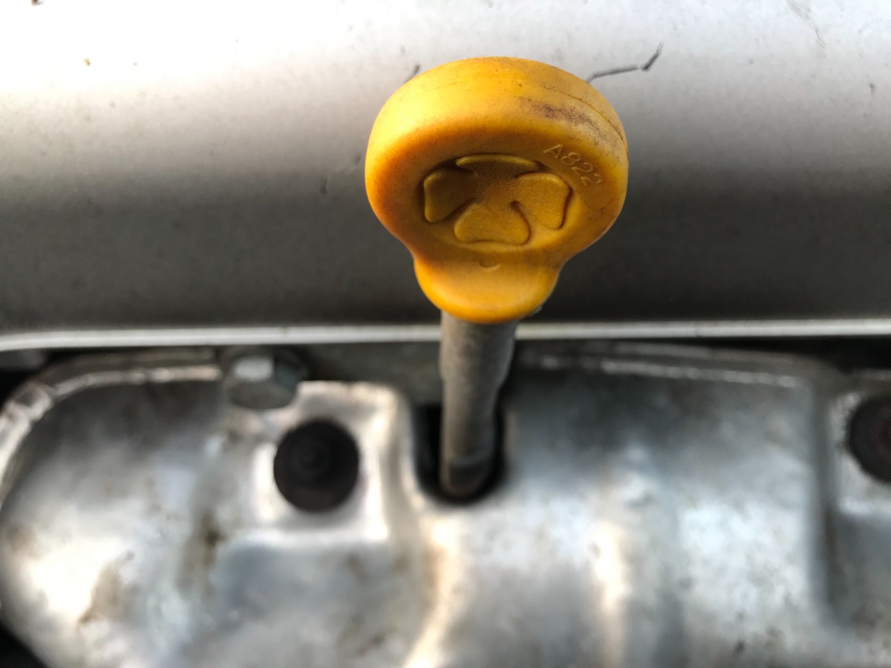

I’ve never noticed before but I do like the detail on the dipstick, Alfa really do a nice engine bay. @wuvvumis spot on, a well sorted 147 is a lovely thing.
