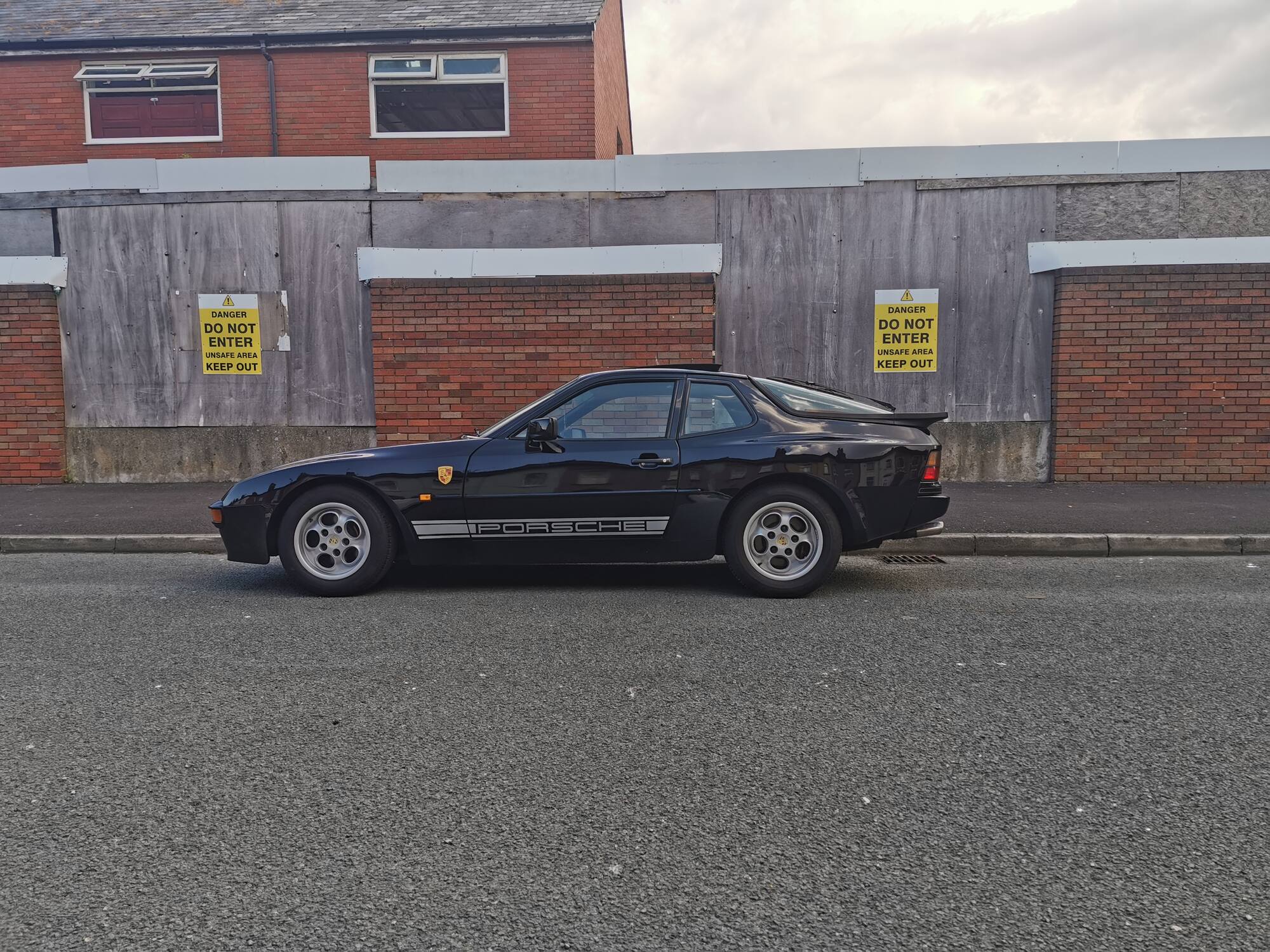

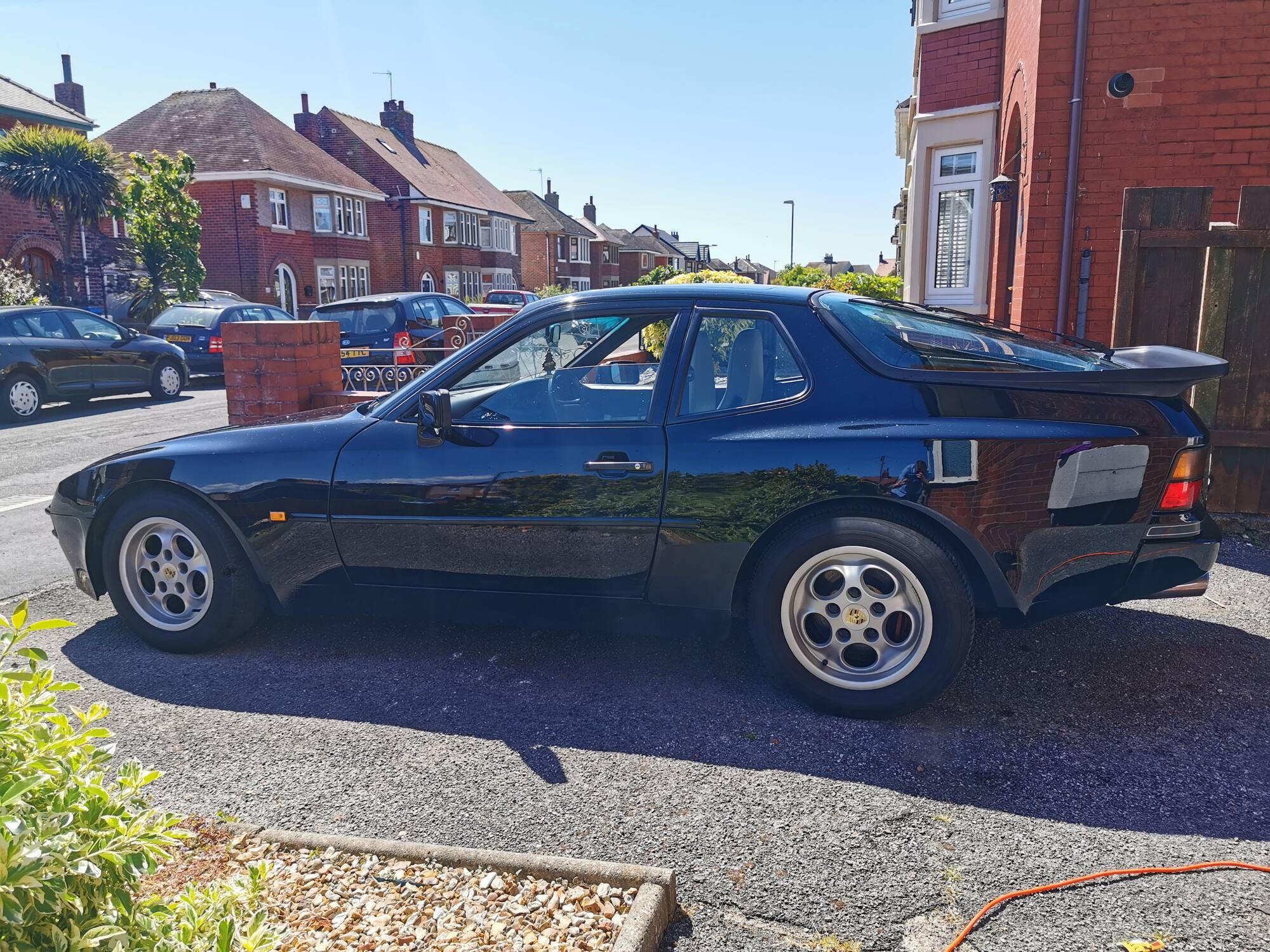

Firstly is the newest addition, my 1987 Porsche 944.
I got it delivered during lockdown, I was quite happy with it, but the first job was to get rid of the bloody stickers! Heat gun and some cutting and polishing resulted in,
Much better!

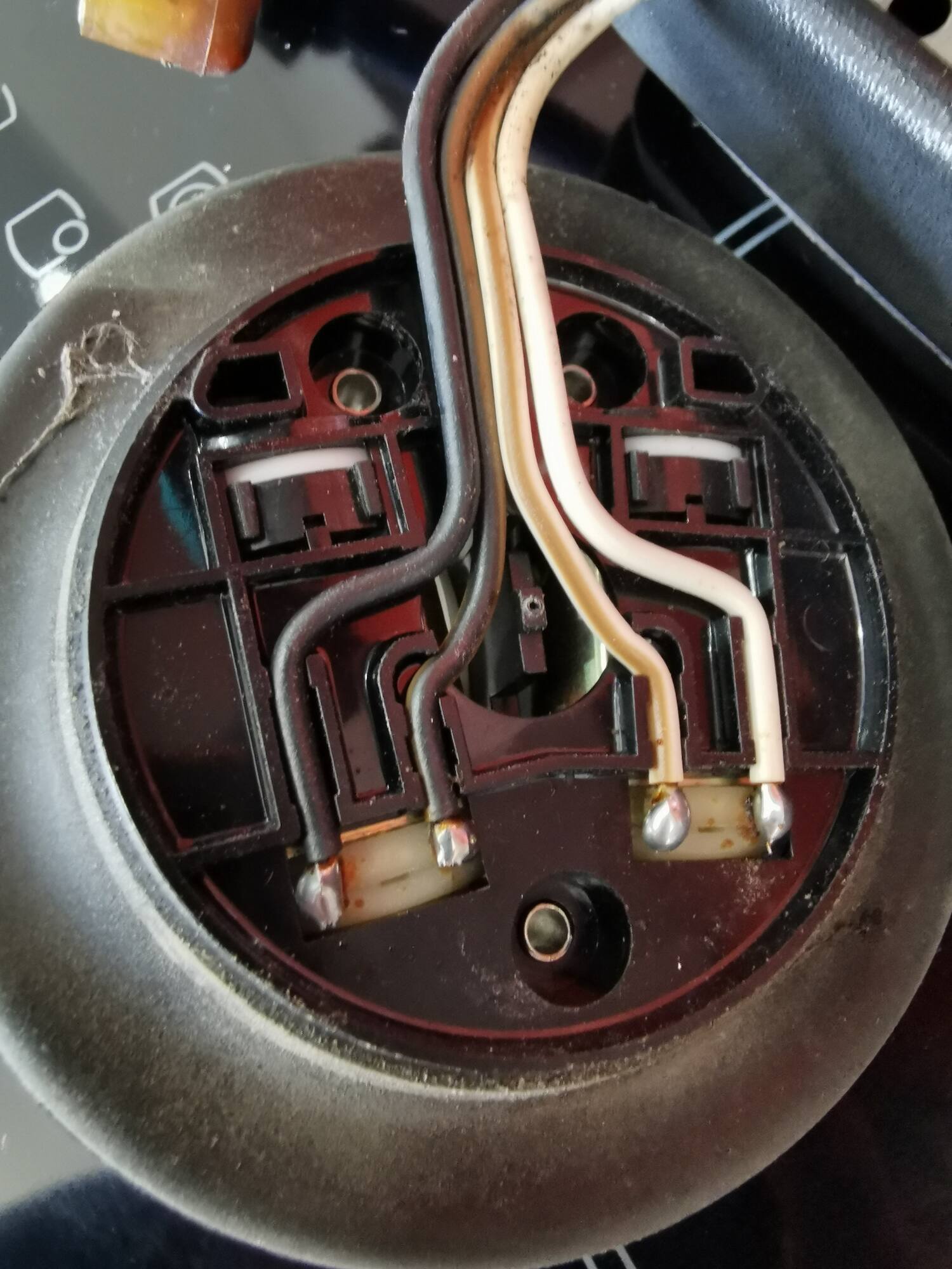

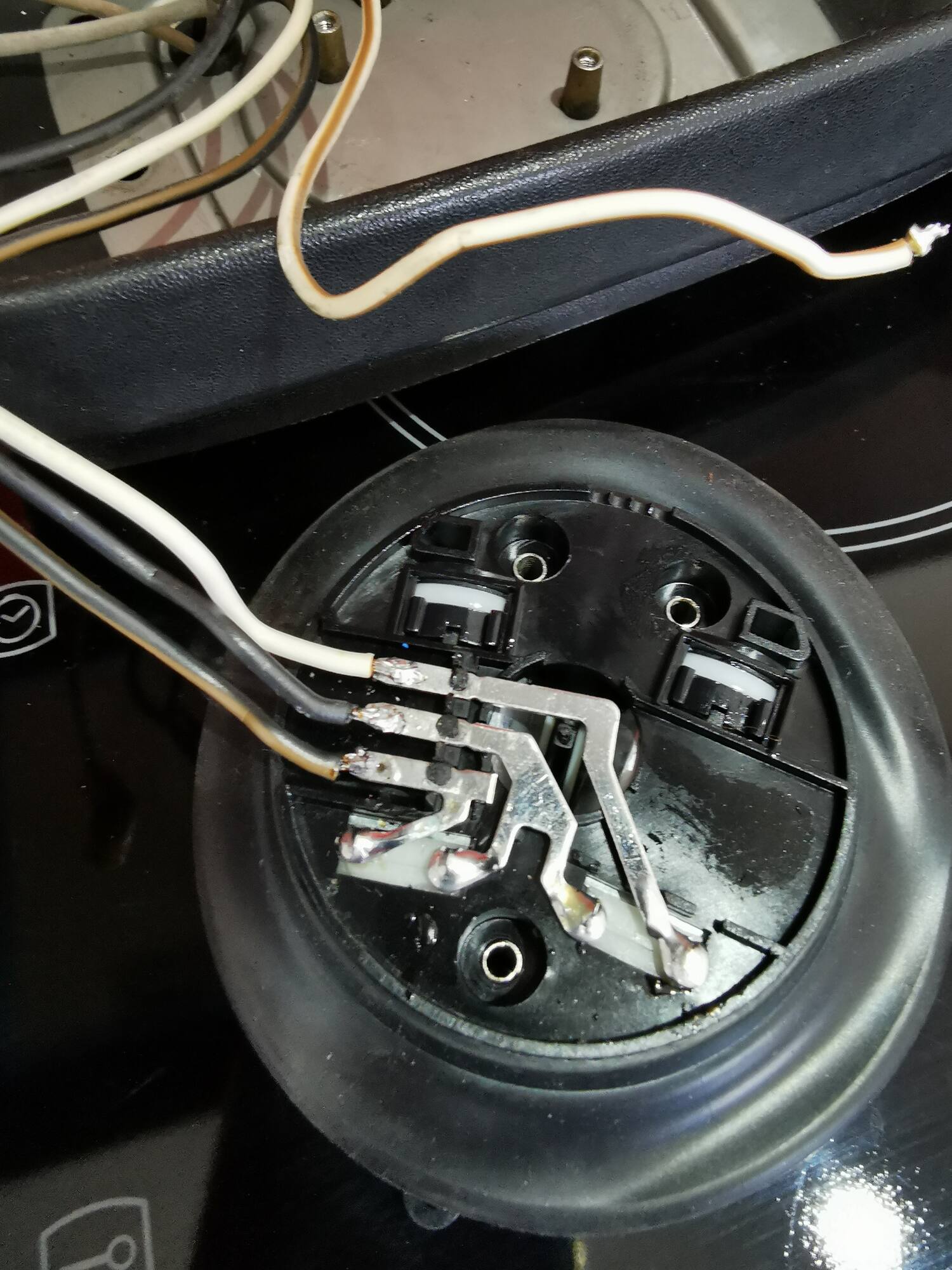

Next up the passenger electric mirror wasn't working properly. After some research I found out a genuine Porsche mechanism was around £80, no chance, but it seems there is an Audi item that will fit with some modification, and at £11 that seemed the best idea!
As you can see the Porsche item had 4 connectors, and the Audi item only 3,but 2 on the Porsche were grounds so 1 was just taped up. Other than that the screw inserts had to be swapped from the porsche mechanism, as the audi ones are longer, and the back cover plate from the porsche mechanism had to be modified and re used.

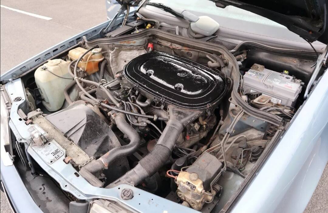

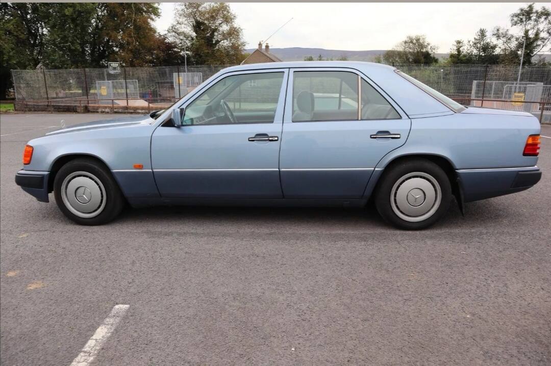

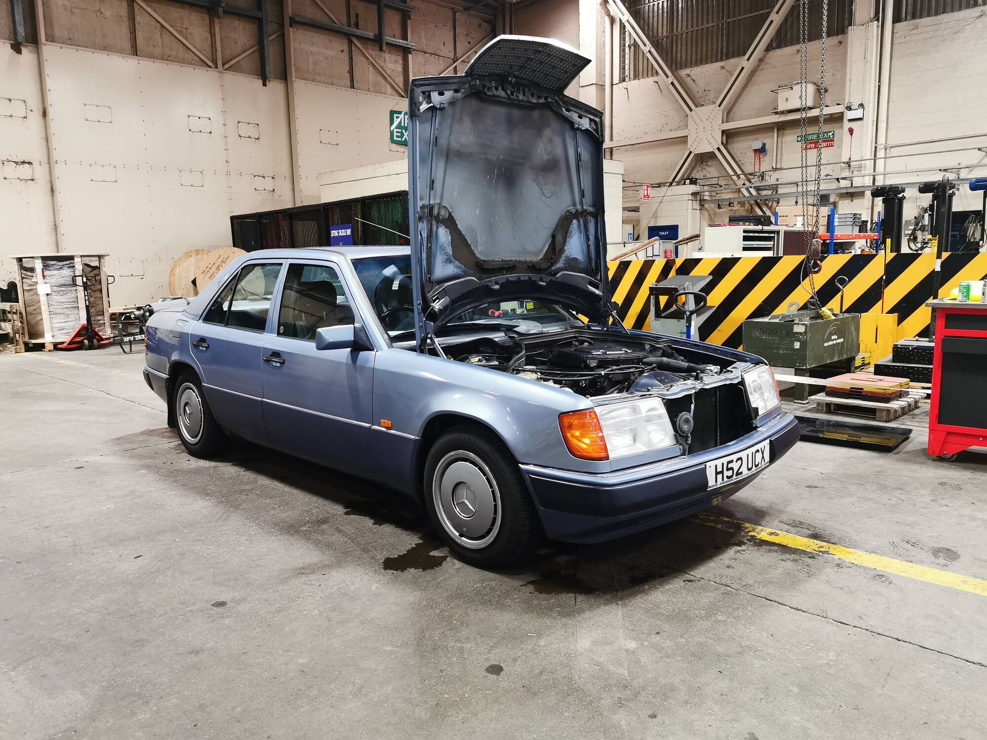

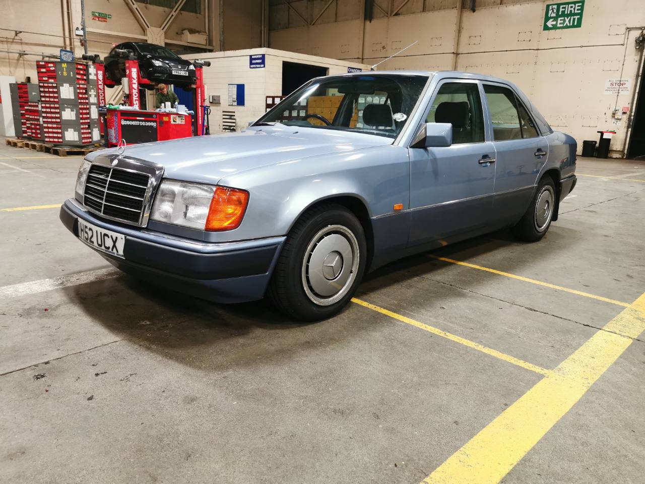

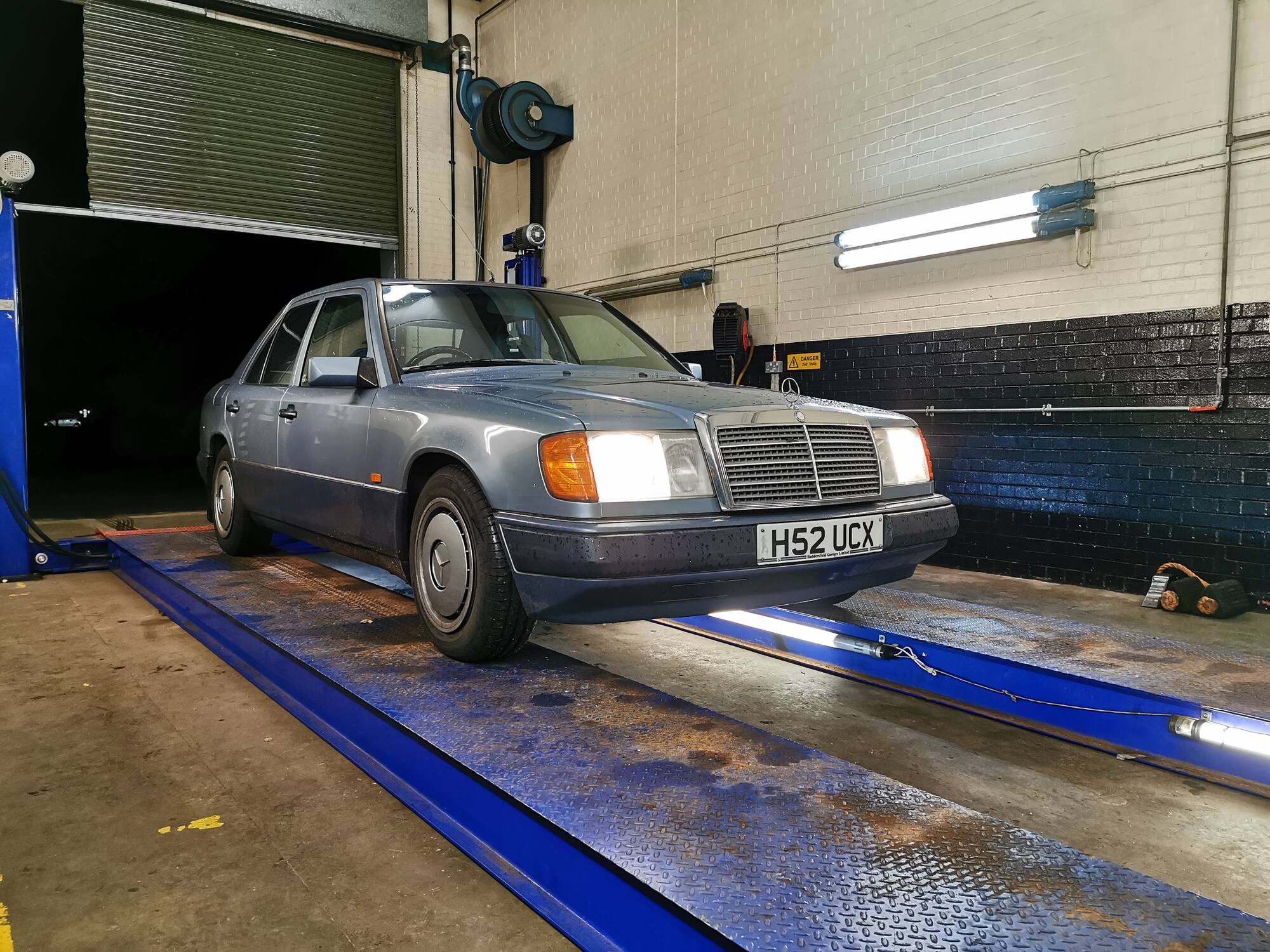

Next up is my is my 1990 W124 Mercedes 230E. I've had this car a little under a year. It was an impulse purchase as I felt it was going to sell too cheap on Ebay.
Photos from the original listing,

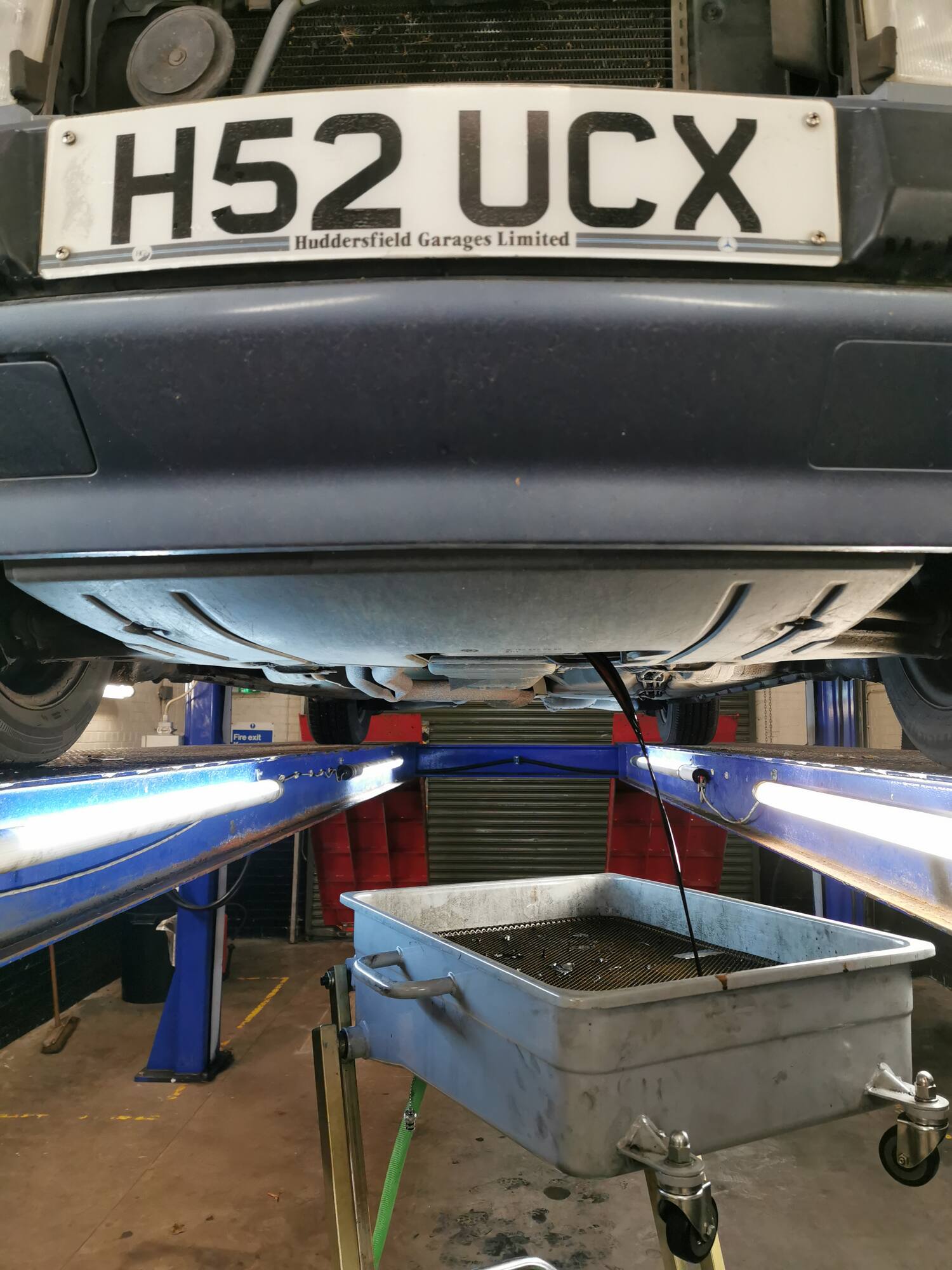

So far it's mostly been treated to general maintenance, and cleaning, it's had all new fluids, a new thermostat and housing, a new exhaust, and some general cleaning and tidying. Here are some general photos of work being done, consider them a montage.
Next jobs are to replace the Cat as that's started rattling, and it really annoying, do some much needed paintwork tidying, and do a little bit of welding in the inner arch,see below for the welding, and it looking it's best!

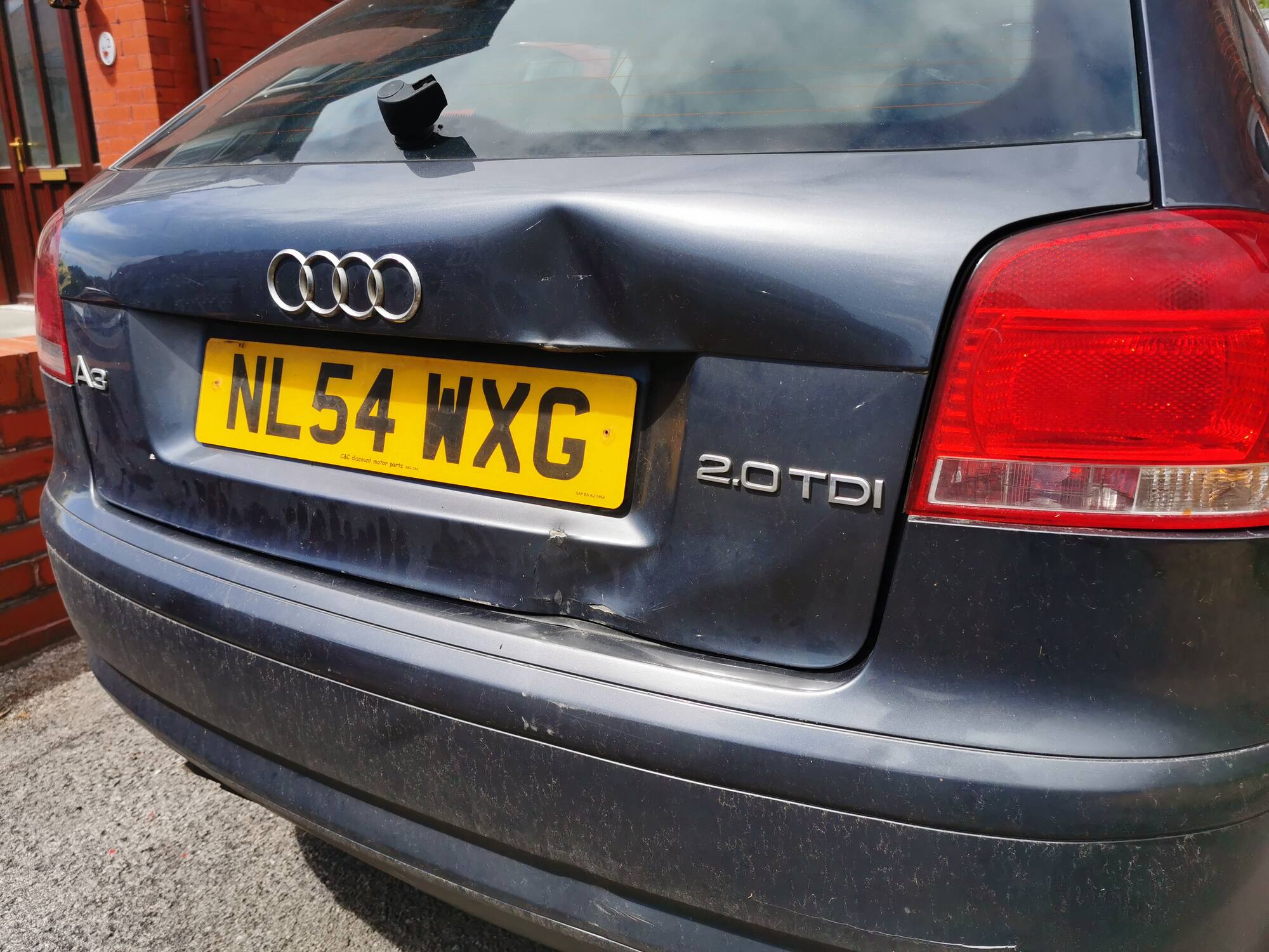

Since I sold my E39 I was I need of a new daily. Luckily a work mate stepped in and successfully sold me a slightly crash damaged and filthy Audi A3 2.0 Tdi for just £400.
Its about as dull as a car can be, it's even grey, but it good on fuel and perfect for my weekly slog to and from work!

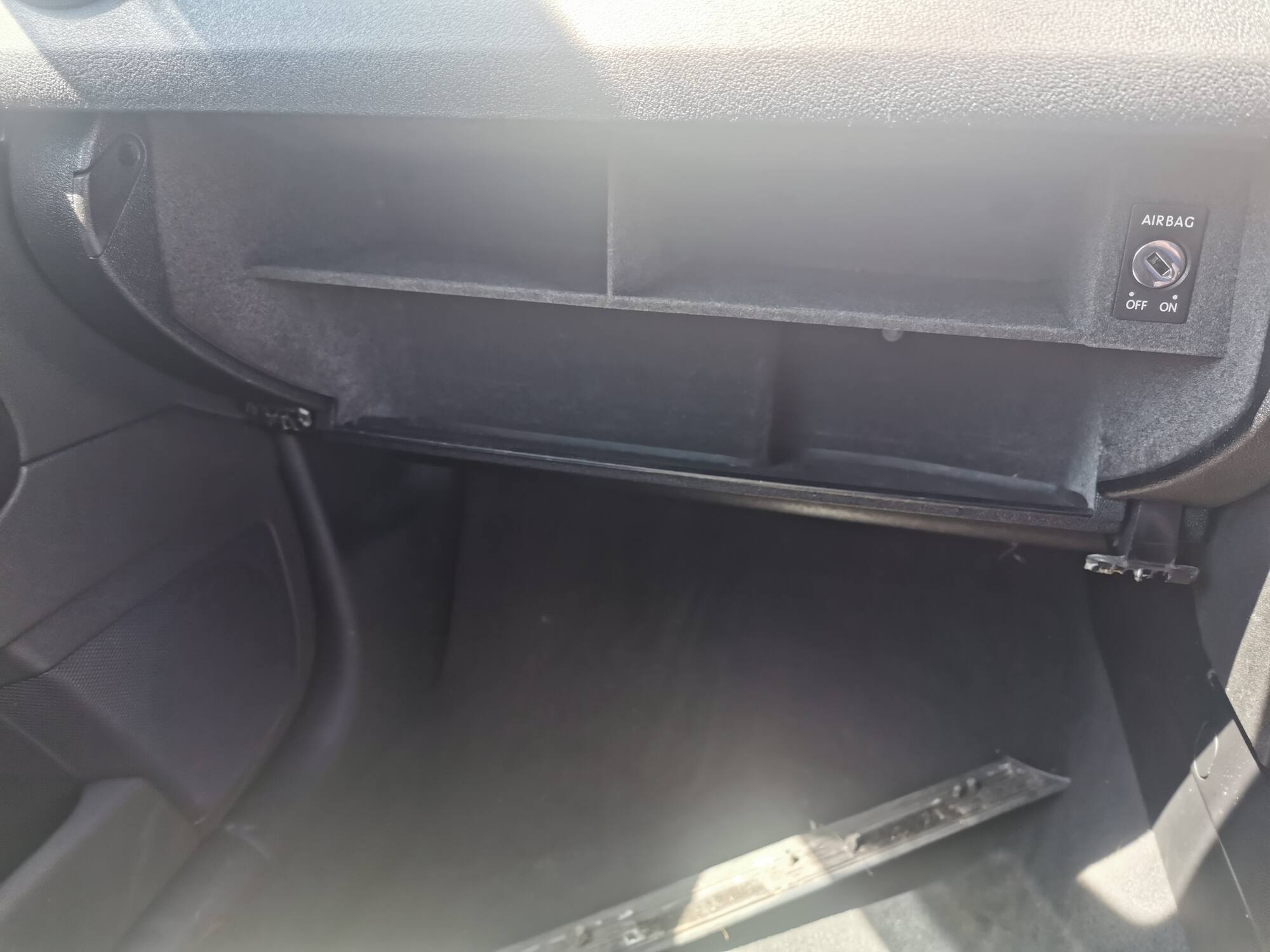

I was even able to re attache the snapped glove box lid with the aid of some self tappers, I need to get to a breakers for a few bits so I may replace it!

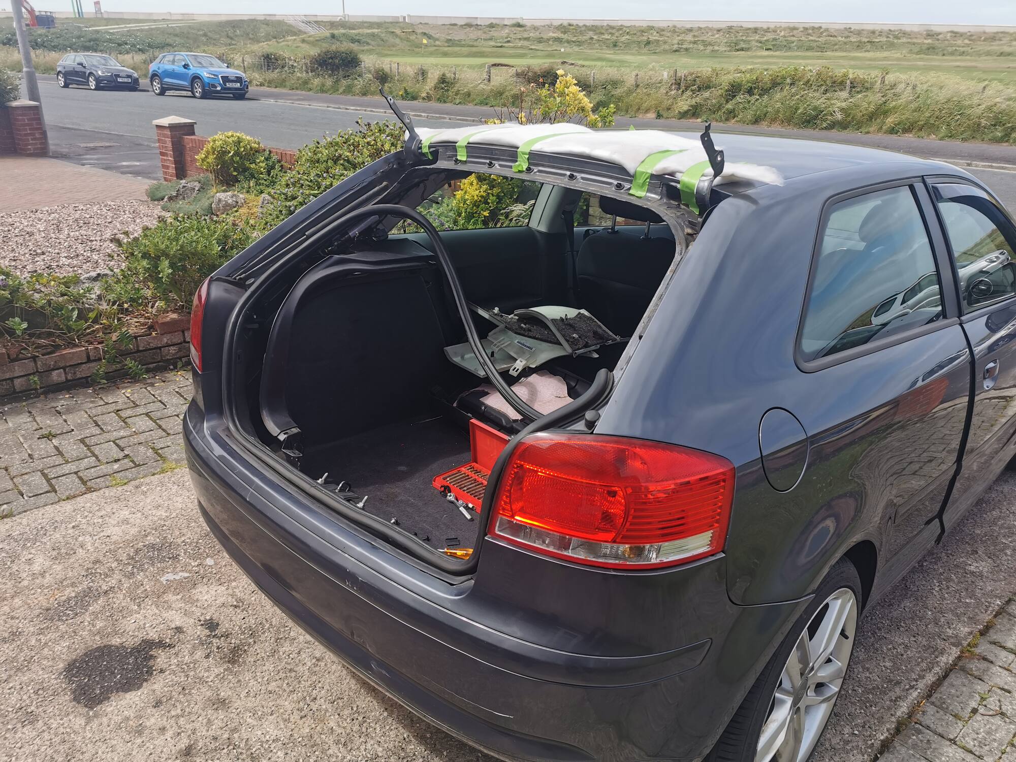

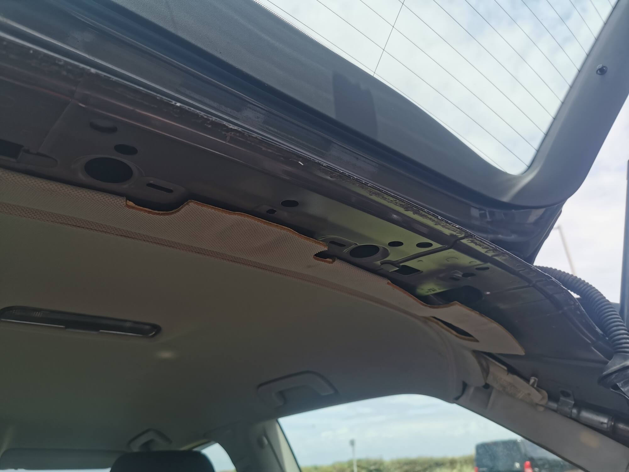

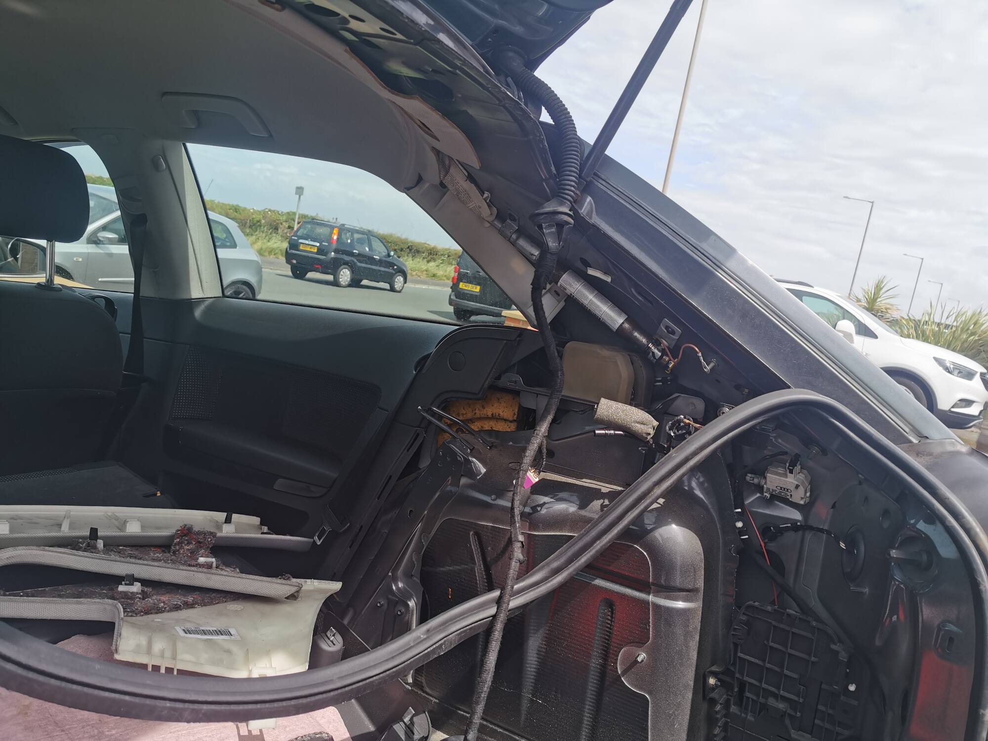

Next job was the damaged tailgate, I found one on ebay in the correct colour for £60,so that was ordered and delivered.
The fitting was quite an involved job, and requited a lot lot of interior trim to be removed, but managed to get it done, what an improvement!

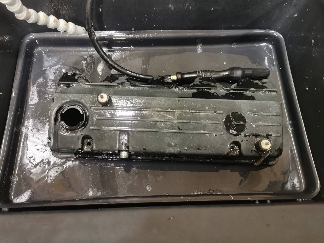

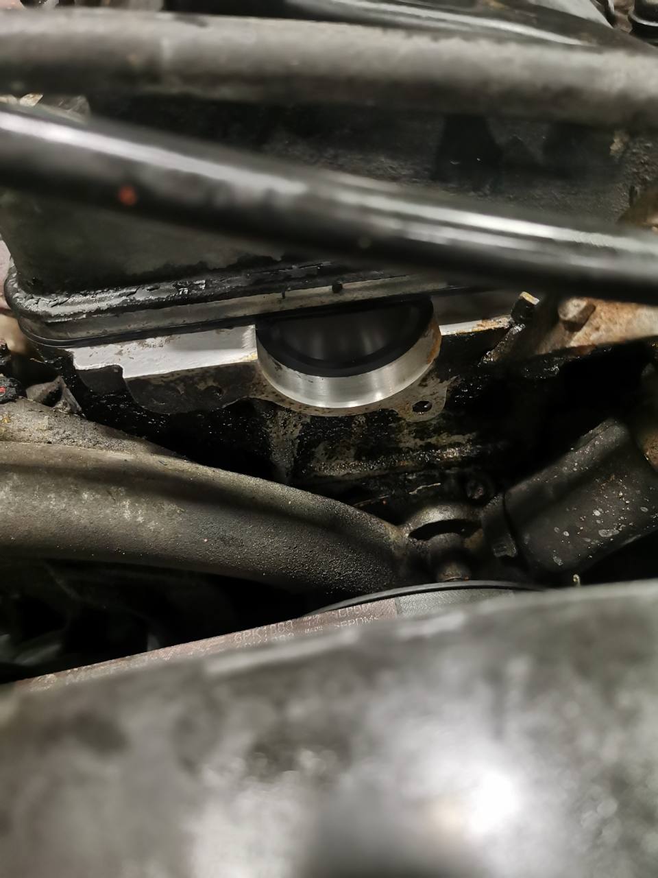

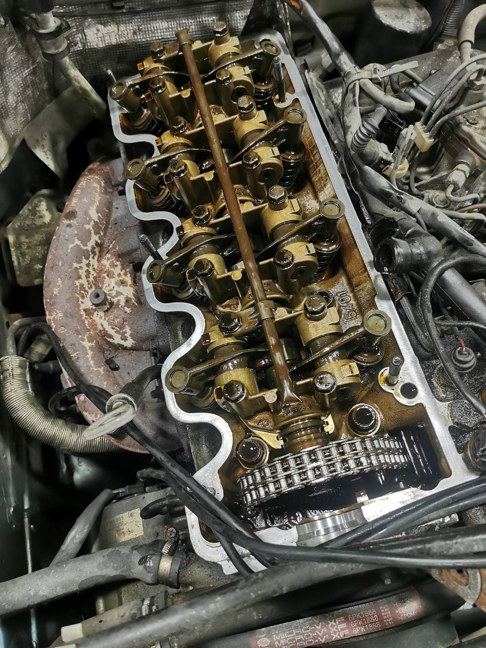

While I'm at work time to start undoing months of neglect on the poor Mercedes, starting with addressing some of the oil leaks. Even treated the rocker cover a bath!
Much better!
