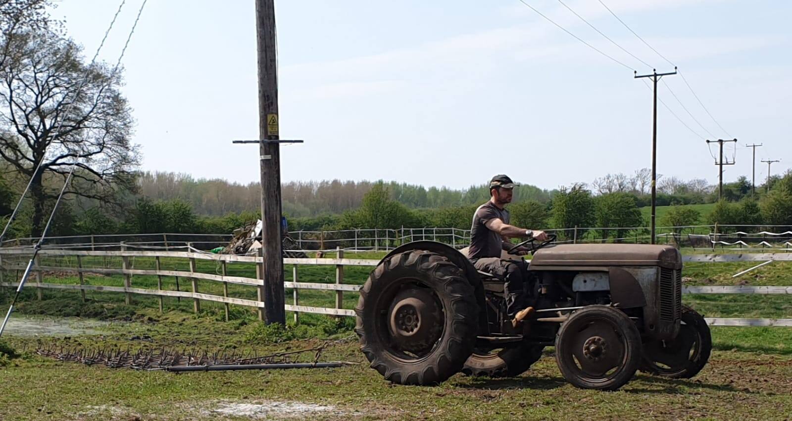

19 minutes ago, spartacus said:
Here you go. Not restored or anything like that, just a solid workhorse.
Bloody love that. If I had a large driveway etc...

Lovely little Fergie!
I'd say coil as well.Have a real soft spot for petrol Fergies,first vehicle I ever drove at age 10.Looks great.
