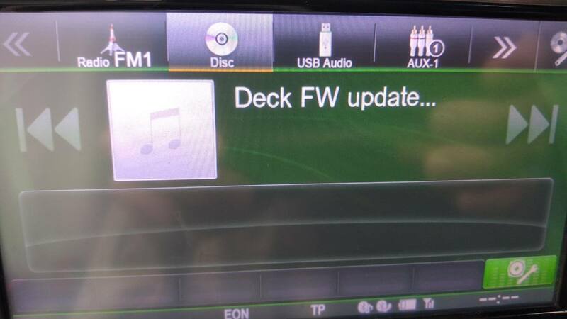

Hey. Blank CDs arrived today. Done the biznis, whacked the disc in and...
Done. All that messing around was worth it because... Er.... Nothing has changed that I can see and as a bonus, I still have no satnav or clock. Excellent.

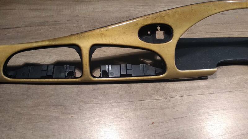

So why am I removing the wood? If you have to ask that then you haven't read the entire thread. I'm removing it because it's had it. It's faded and cracked.
Faded ∆
Cracked ∆

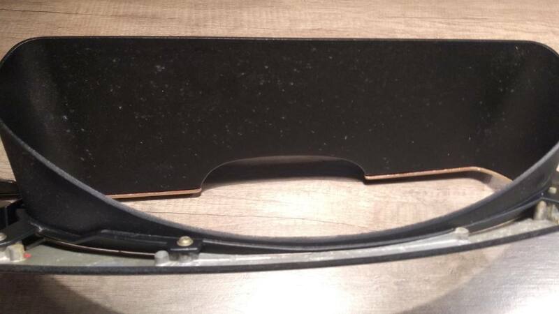

Also, the instrument cowling is pitted with white spots on a black finish.
Pitted with white spots on a black finish ∆

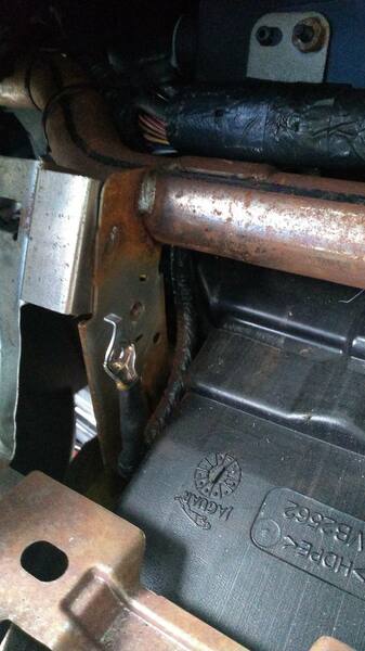

Whilst poking around my newly cleared hole, I noticed a pretty rusty earth point, so cleaned that up...
Who knows what that does?

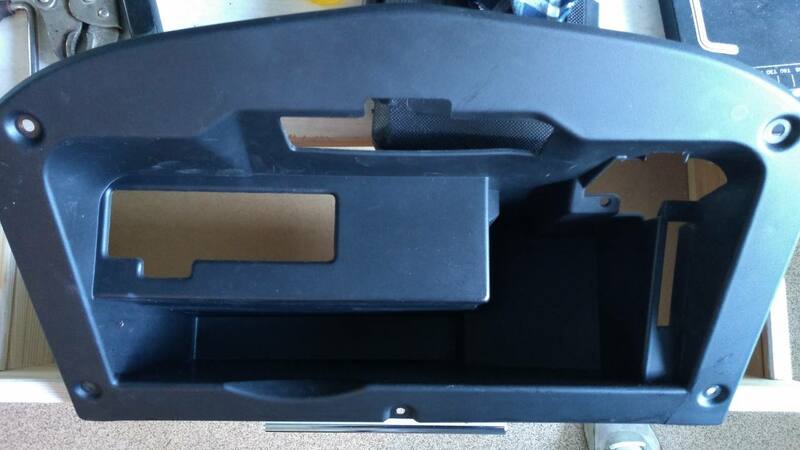

The glovebox.... This thing haz been on my mind for months. It was a great idea* of mine to decide to experiment and remove the old box as there was no room in there for anything as 97% of the space was occupied by a molding for the CD autochanger. As far as I can see, the X200 only has this fitted. The other downside is that if you have the lid open and drive forward, everything that you managed to squeeze in there just comes shooting out. Below is an image of what you see when you drop the lid down:
At the time I found on the bay a box listed for a 2001 model s-type which was cheap enough so bought it. When it arrived, it was for a X202 and all but what the lid face looked like, was completely different. The newly acquired box was for the updated model, with it's updated and restyled dash.
However, being me, I took a fancy to the grey flock finish inside it and liked how it weighted 50% less than the existing unit. I was pretty sure I could maybe get it to fit, perhaps...
With that being the only plan I had and knowing that it would involve me taking a saw to the dashboards nether regions, I just put both boxes in the shed, tried to forget about them, and drove the car with a gopping hole in the passenger side trim.
UNTIL TODAY! Today, I put on my inventors hat and went and had a look. All I had to do was make the new black bit fit in the old hole. How hard could that be?
It is completely not the same. For a start, I needed to cut out the lower plastic cross support... V WOT? LIKE THIS M9? V
There was no going back! Many things were 'coachbuilt' to fit the new... er... back bit and a grinder was used more than twice. Luckily, when they did the reface they left all the fan blower and vents in the same place which was a bit of a result.
Then with even moar luck, the box could be installed.
That went straight in, and operates just fine. I think the finish colour is a little off... not that bothered, and there is still this big gap along the top edge of the lid which happened on the old one. I tried to improve it but it's ended up exactly the same!
I reckon if I added a couple of secret* fixings we could improve on it a bit as it's only using the original fixings for the newer box. The old box lid was made from scaffolding and other parts and held in with countless screws. But it really doesn't annoy me enough yet.
So if* anyone ever says to you in a conversation... "I wonder if you can fit an X202 glovebox into an X200 dash", then you'll be one step ahead with the old answer which is: You can, but fv[k me, don't bother unless you are (to quote Timmy Mallet) completely and utterly bonkers. At least now I can actually put gloves in the glovebox eh?

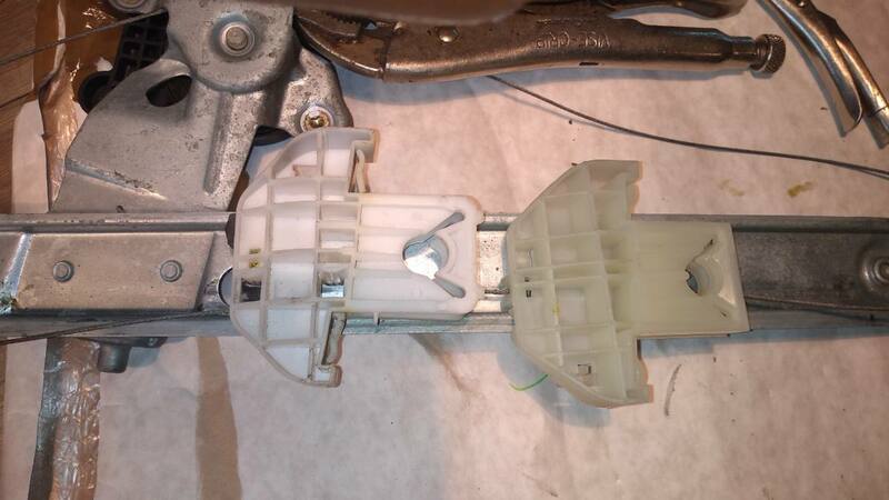

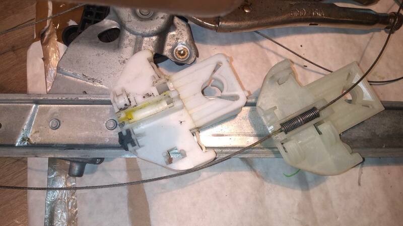

Next up was the window regulator on this door. the motor works fine as does the cable but the guide is busted on the track. It worked for about 2 days after I bought the car but then that was it. Further inspection revealed a failed temporary repair. No fear, I bought two non Jag and made in Turkey repair kits, left and right side off of ebay a while ago and chucked them in the parts bin to resurface on a day like today.
This afternoon I went to fit the guide and well, the kits have been made wrong. The track on the regulator is wider on one side so the guide is moulded to fit this. So far as I can see, they have made the replacement with the guide runners the wrong way around, so both sides are junk. You can't even switch them because the shape of the glass sits on a slope so it would ride wonky plus it holds the glass 'off center' to the track. Switching them would make them off center on the wrong half of the track an therefore the glass locating hole would not align.
Pictured below is the original on the left and the replacement. Look closely now...
It's an absolute sod as the regulator is out of the car now so, me being me stuck on my engineering hat. We can fix the old guide right? A bit of drilling, some round head bolts, number plate screw covers and some JB weld later, we had guides that looked promising.
IMG_20210128_144030086.thumb.jpg.2aa453e8795819c9ea5afed02d7471f6.jpg IMG_20210128_153244766.thumb.jpg.6db0f13138a67e7bb8225d3299986fb2.jpg
There's a little bit of play in it of a few mm because it's as close as I could get without the metal bolts contacting the track as I don't want metal on metal grinding noises or squeals from contact whilst it's running. I'm gonna let it sit overnight for it to think about it's bad behaviour and then fit it tomorrow after a bit of a clean up on the glass.

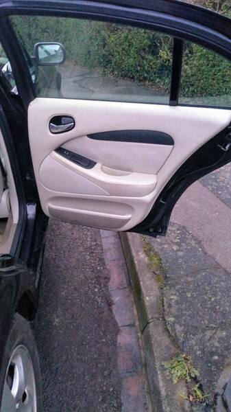

With that contraption in the car and fully guaranteed for 5 days, I stripped the door panel wood bits and covered them. A bit later I snuck out and fitted the door panel minus the handle cover bit because although I have fixed it, it needs finishing and painting as it's faded to some weird translucent cream colour.
Now I have a fully functioning door which is no longer a problem area letting the car down. Just the other side to do now!
