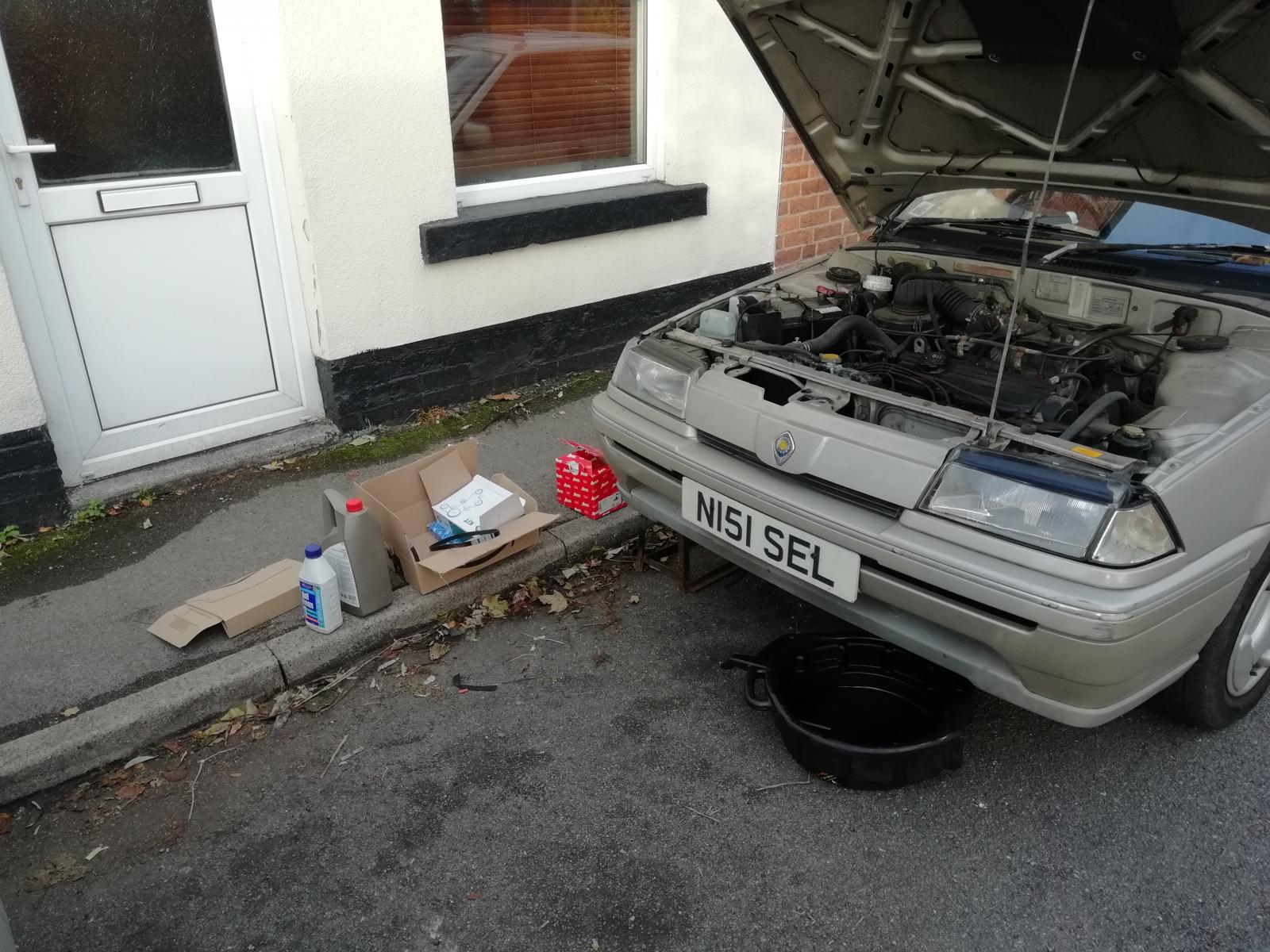

Well so it begins. All items ready for fitting.post-5685-0-61324000-1539943940_thumb.jpg

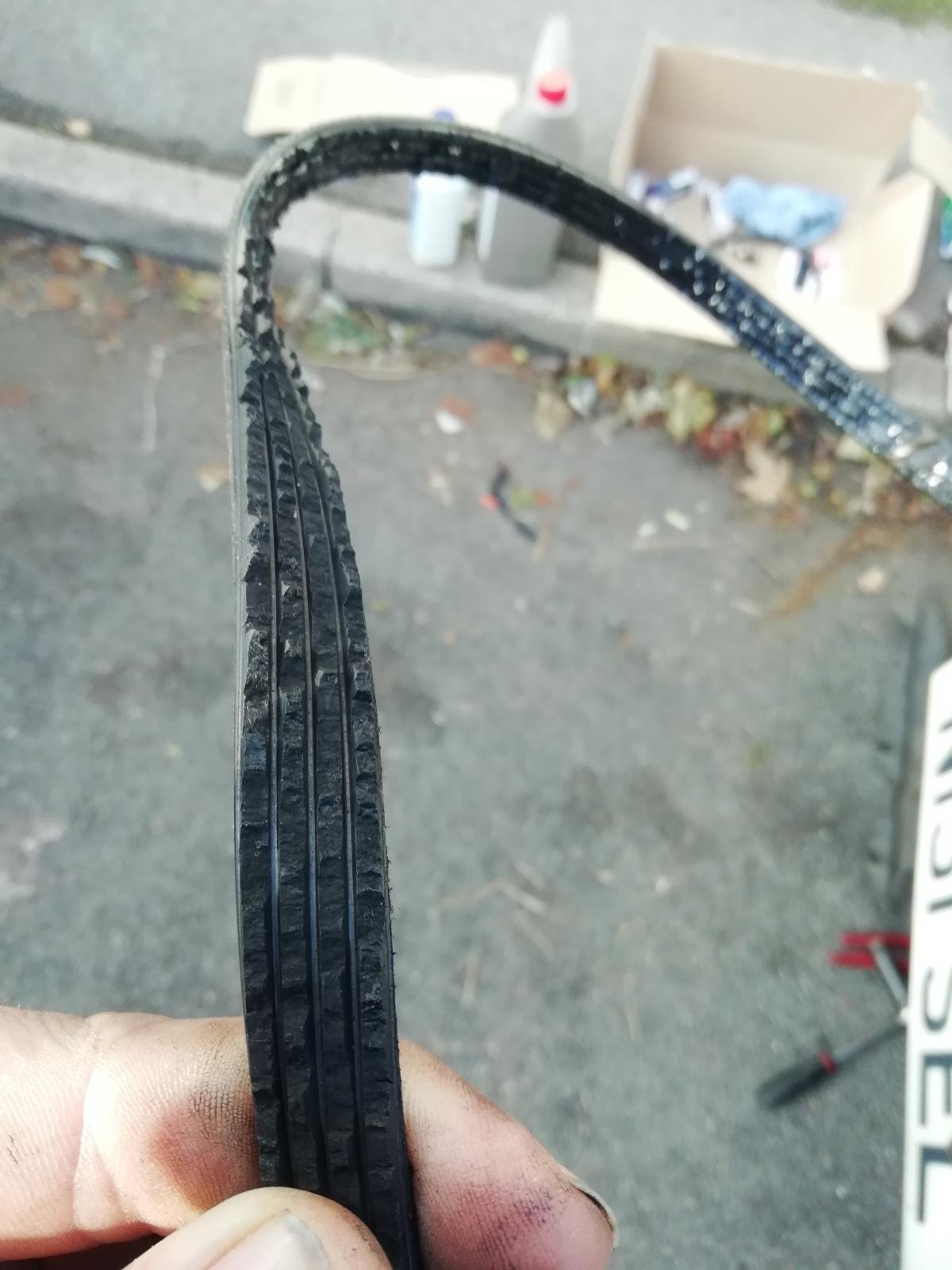

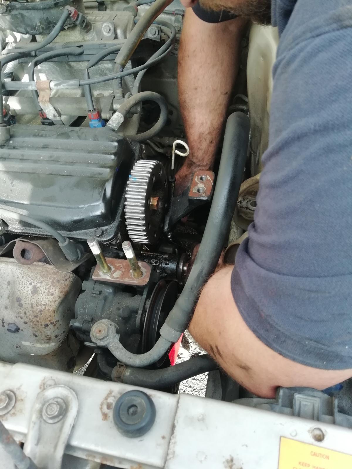

Belts were very worn as was the plugs
post-5685-0-93424100-1539944003_thumb.jpgpost-5685-0-87953400-1539944062_thumb.jpgpost-5685-0-06967700-1539944095_thumb.jpgpost-5685-0-65366300-1539944128_thumb.jpg

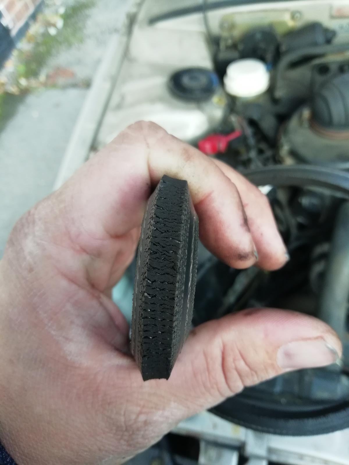

Water pump and tensioner also being changedpost-5685-0-16277400-1539944194_thumb.jpg

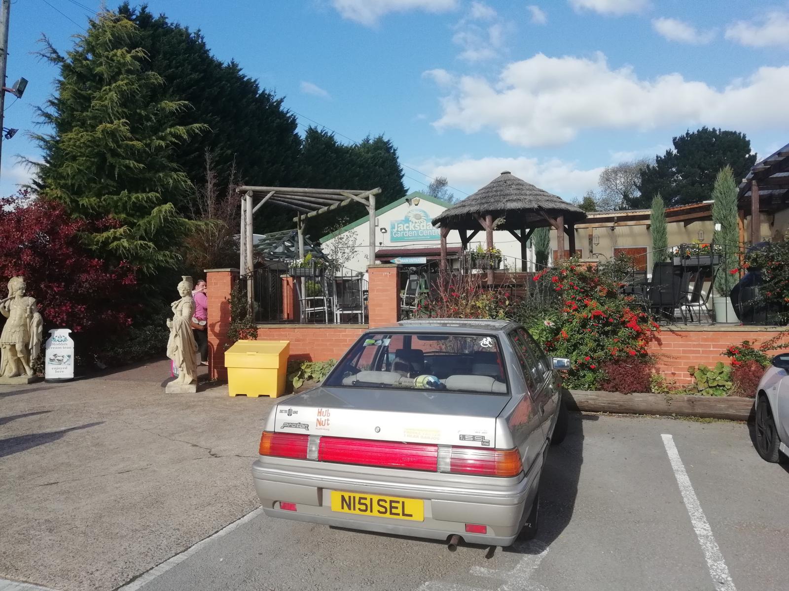

Had to get a photo of the car in its natural habitat. A disabled bay outside a garden centre.
The trims are great. Sadly also a massive pain in the arse as they are the locking type which screws onto the wheel bolt but the key is missing!
Badly parked almost out of the space for max giffer!
In the bay but not much space on driver side if I'd parked further over. Need to be able to open door fully.
