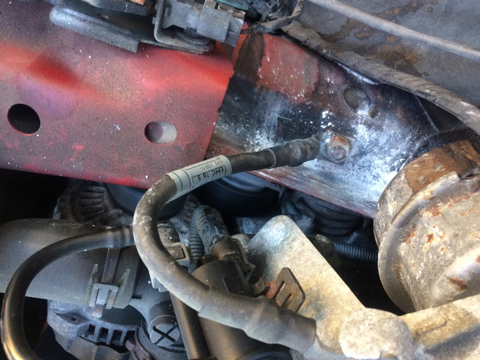

Vince70 Posted June 30, 2018 Author Posted June 30, 2018 I just had a look and the sound seems to be coming from the auxiliary belt area and the tensioner seems have an awful lot of movement when the engine is running but I’m not sure it’s supposed to be like that as it doesn’t do it on my old E36.

twosmoke300 Posted July 1, 2018 Posted July 1, 2018 One way clutch seized on the alternator? Vince70 and Christine 2
Vince70 Posted July 3, 2018 Author Posted July 3, 2018 Cheers Twosmoke it was exactly what you said and a new pulley and belt sorted it out. Christine and Parky 2
