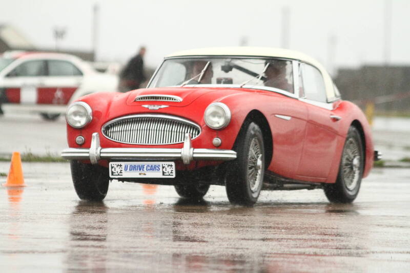

When I got out of the Mustang I was directed straight into the Austin Healey 3000.  Now this was a revelation.  I drove '70s cars a lot when I was younger and I've had the occasional go in older stuff so I thought I knew what to expect; something really physical and tough to drive, probably with pretty sketchy steering and brakes.  It wasn't like that at all; the driving position is apparently intended for a T-Rex (In most cars I have to adjust for long legs and short arms but even my arms are too long for a big Healey).  Once we got under way though it was just brilliant; now that I think about it this was my first time driving a real sports car and it delivered.  The steering was perfectly weighted, the brakes inspired confidence and it handled just like it should; just perfectly precise.

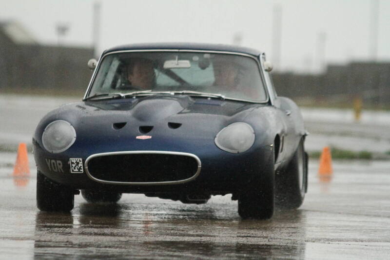

My last drive of the day was in a Jag E-Type; an early '70s 4.3 litre that was restored as a track-day car in 2011.
Let's take a little pause here.  Surely every classic car enthusiast wants to drive or own an E-Type; it's one of those very few cars where there just aren't enough to go around.
So what did I think of this one?  Well, as a car, it was more spacious than I was expecting.  Sitting in the driver's seat... well, what the hell do you think?  Looking past three wipers down a bonnet with an aeroplane engine under it; that has to be exciting.
I spent an amazing five minutes with this beast and I felt like a hero, but I probably didn't even begin to discover its abilities.  It was always pulling on the leash, wanting to go faster.
