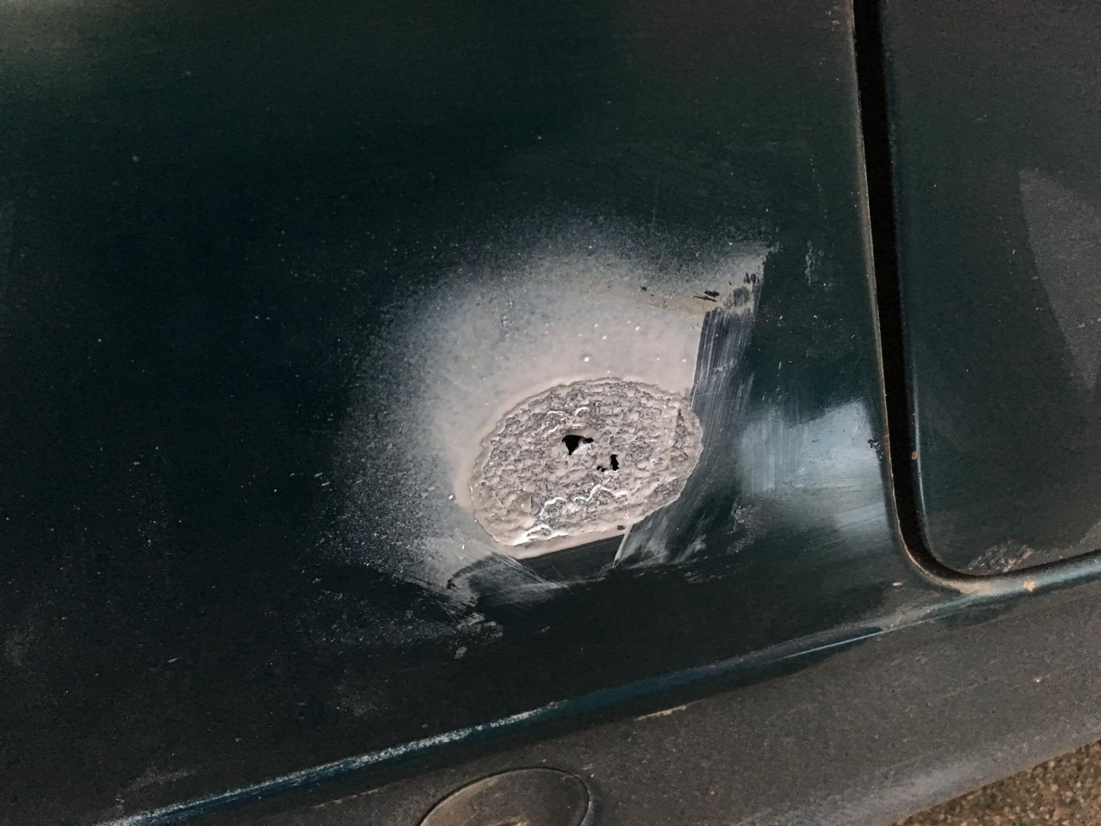

On the drivers side there was a big rust wort, I decided to prod it to see if it was MOT worthy. Now there is small holes.
Rubbed it down, thrown on some zink paint and just away to throw some filler on.

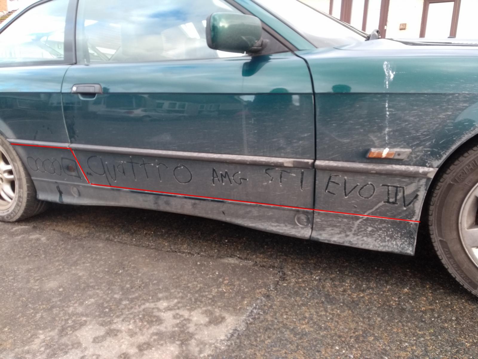

We also decided to do some badge engineering.
You can see the rust spot before primer in that picture too.
If it gets through an MOT without too much bother, it'll be getting a tide mark up to the rubbing strips in order to cover the rust 'repairs' :D
THATS SONE PAYBACK FOR WHAT YOU DID TO THE CAPPUCCINO!
Doesn't look as bad as I thought it would:)
