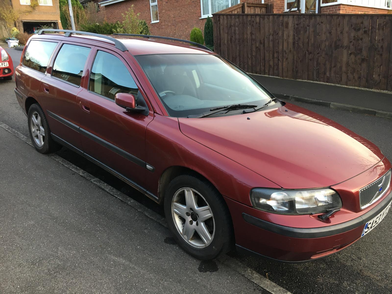

13. It's from Scotland so has unfortunately the mud has got to it a bit. It's cleaned up as best I can but there is some light bubbling on the wheel arches. I never gave it a really deep clean but it isn't horrible or anything like that. There is also some lacquer peel on the shoulder at the rear driver's side. It don't think this is the type of car to go rotten.

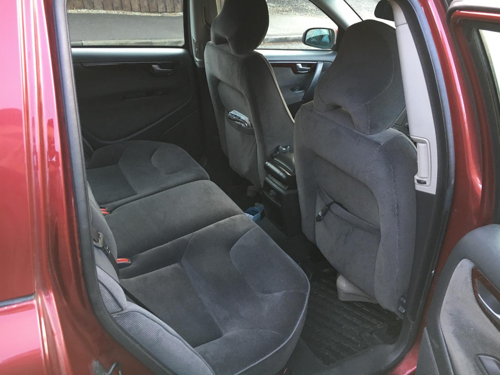

This is the second V70 D5 we've had and we've also had a S60 D5 and S80 D5. I like the D5. This V70 has the best engine of all those. Even with the slight issue with the intercooler it goes very well, and the average fuel economy on the trip computer has peaked at 63 mpg with some hypermiling (which consist using the cruise control constantly). Also of note is that the air conditioning works. Without it I would have expired in Spain. One key. All the electrical bits work except the trip comp. Cloth seat, which are far better than leather.
