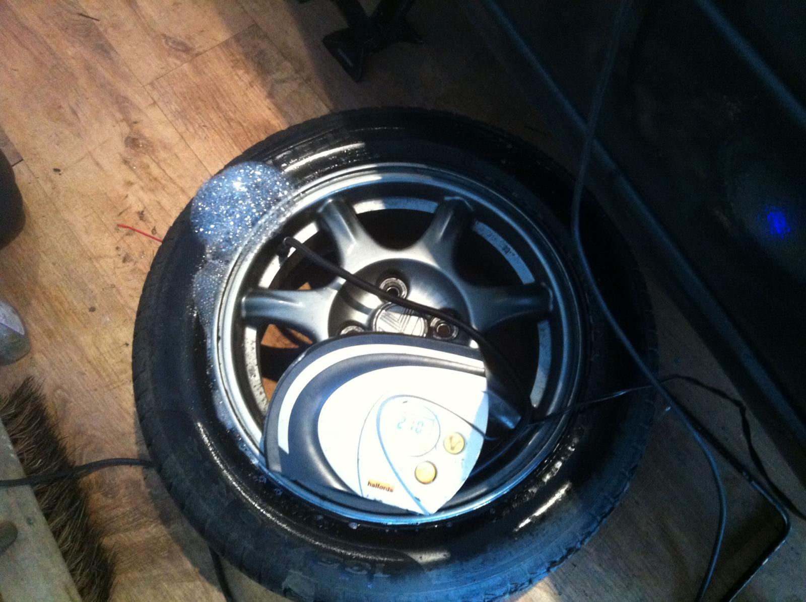

Pump it up, check the pressure in a couple of days. If it's gone down again then take the wheel off and put it in a big container full of water to try and locate the leak. If you can't see it then it's very likely a porous alloy.

Well i put it to 35PSI from 17PSI on Thursday, last night it had gone down to 31PSI so definitely an issue, so went to the garage this afternoon, the same garage who had supplied and fitted the tyre 3 weeks previously, guy couldnt see any punctures so dunked it in their "bath" and the valve was bubbling away, reckoned a faulty valve core so they stuck a new one in for free, love a freebie repair!! Boy said even if I hadnt just bought the tyre from them a couple of weeks ago they would still have replaced it FOC anyway because its so cheap its hardly worth charging and is more likely to get them customers when they do need new tyres if they are decent enough about daft stuff like this.
