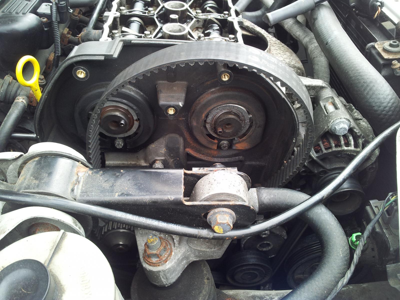

My mechanic and I were both curious about what was actually wrong with the engine so I whipped the cam cover off to have a look.  All looked ok, so I moved around to the cam sprockets.  Off with the belt, the timing covers actually go for a few quid on eBay so they'll be saved.  Timing was spot-on so it's not that.
But hang on, what's this?
This is the opposite end of the engine to the noise but it definitely isn't good, there's a wonky seal on the front cam and the surrounding area is coated in a grey paste consisting of oil and fine metal filings.  I'd guess it's had the top end refurbed and it's been done badly, perhaps partially seizing which might explain the difficulty it seems to have turning over and the compression sounding a bit off when it's trying to start.  Odd, but anyhoo, it's had a chance, can't save 'em all.
