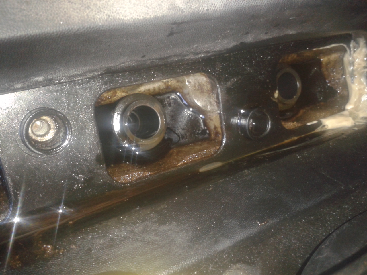

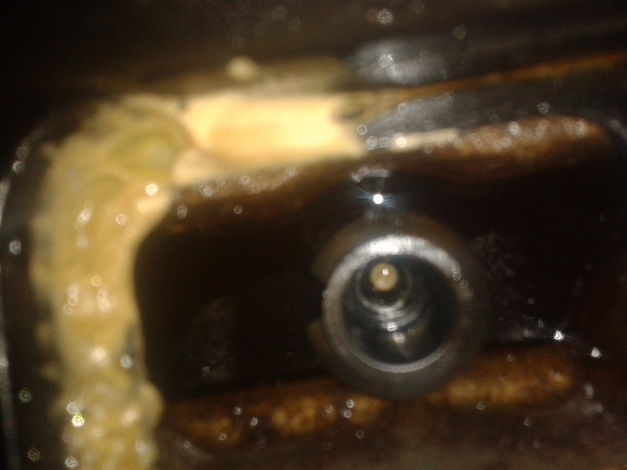

omegod Posted May 2, 2017 Posted May 2, 2017 Either one of the ( two, one for each bank) coil packs failing or rocker cover gaskets spewing oil into your plug wells, i'm doubting crank sensor as it usually just stops them running completely
red5 Posted May 2, 2017 Posted May 2, 2017 Rocker gaskets get my vote. If I'd had some money for each one I'd done...I'd have, well, some money. Fairly sure one type used to be a rocker cover change rather than gasket ^^
lisbon_road Posted May 3, 2017 Posted May 3, 2017 If breathers have been cleaned, likely it/they were blocked, hence fair chance the rocker cover gasket has been pressurised for a while and might be damaged.

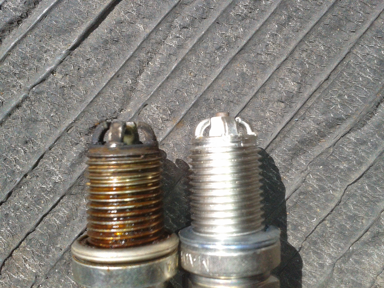

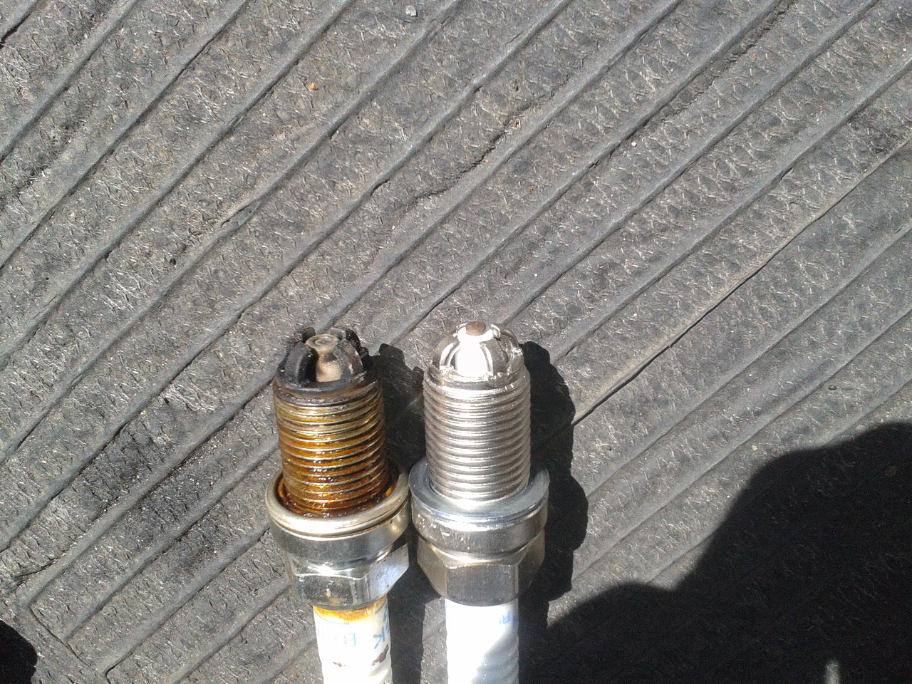

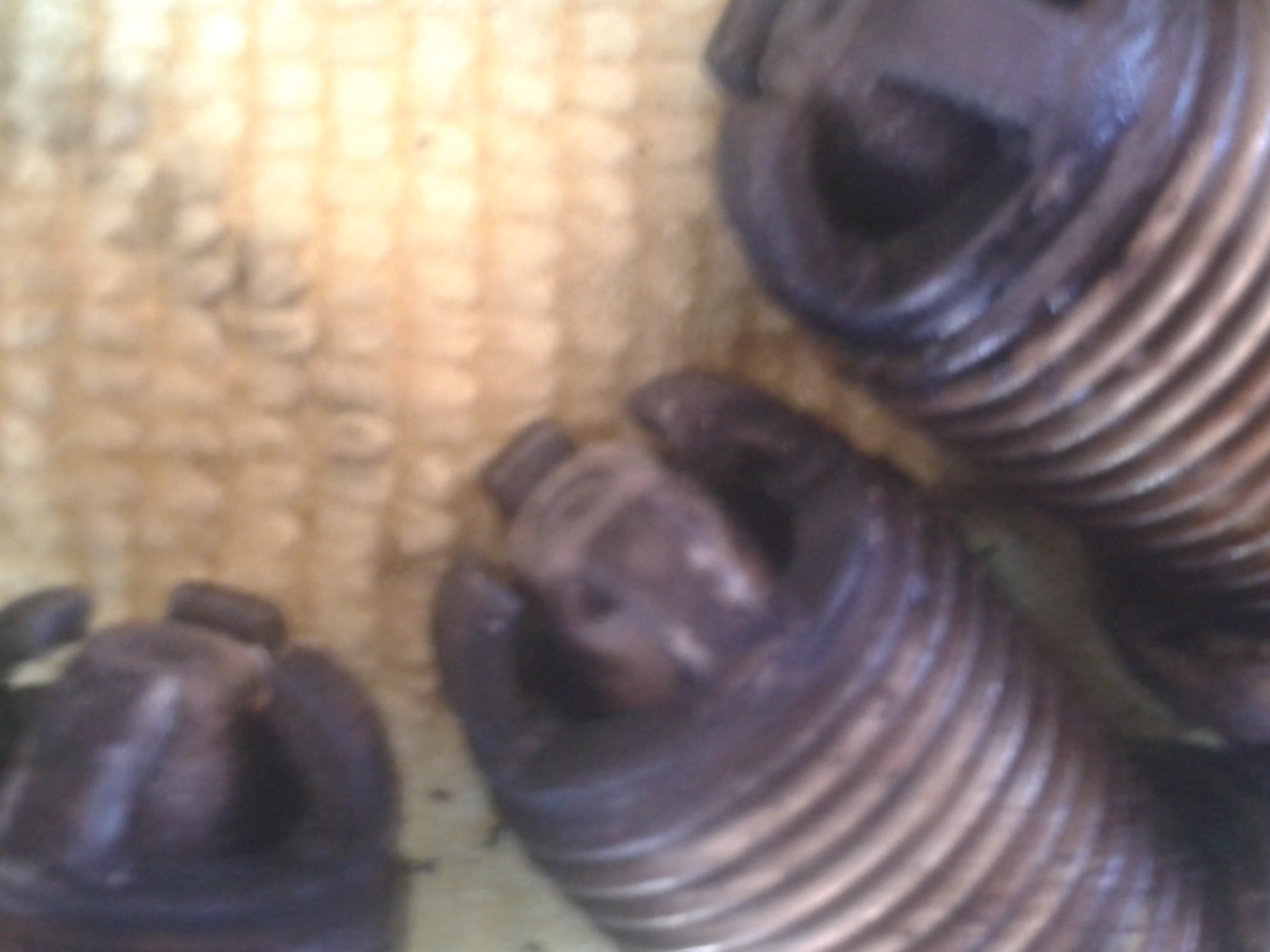

New POD Posted May 11, 2017 Author Posted May 11, 2017 You can draw your own conclusions from the pictures. There were codes P0170 P0300 P0302P0304P0306P0420P0430P0650 (only on two pedal trick) I should have replaced Plugs as soon as I got the car some 12K ago. I would have noticed the oil leak from cam cover on 2,4,6 side. Since Sunday I have done 200 miles having reassembled without fixing leaking cam cover or replacing very dodgy looking Coil packs, but having cleaned and dried it all up using brake cleaner, before reassembly. Since then there have only been 2 codes - Both P0170 Fuel Trim. But only on Monday and Tuesday. I will check again when I get home tomorrow.
