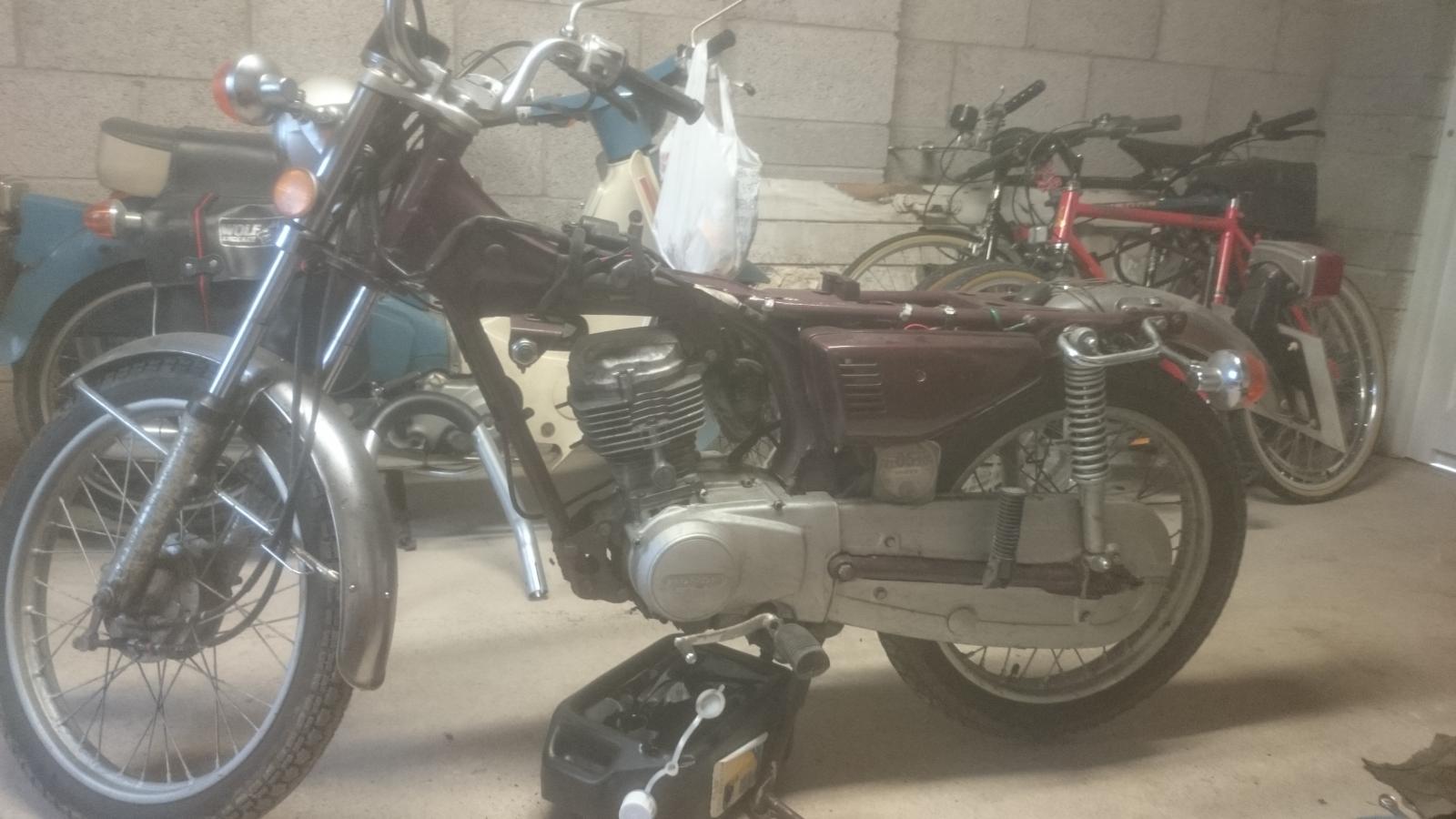

So. with an elbow freshly tennissed, and a good night's kip, I set about the next easiest thing; a Honda cg125.
It got put away several years ago cos after I painstakingly replaced the headgasket it started leaking out of the other side of the piston. And the very thought of working on it in my small shed again gave me backache.

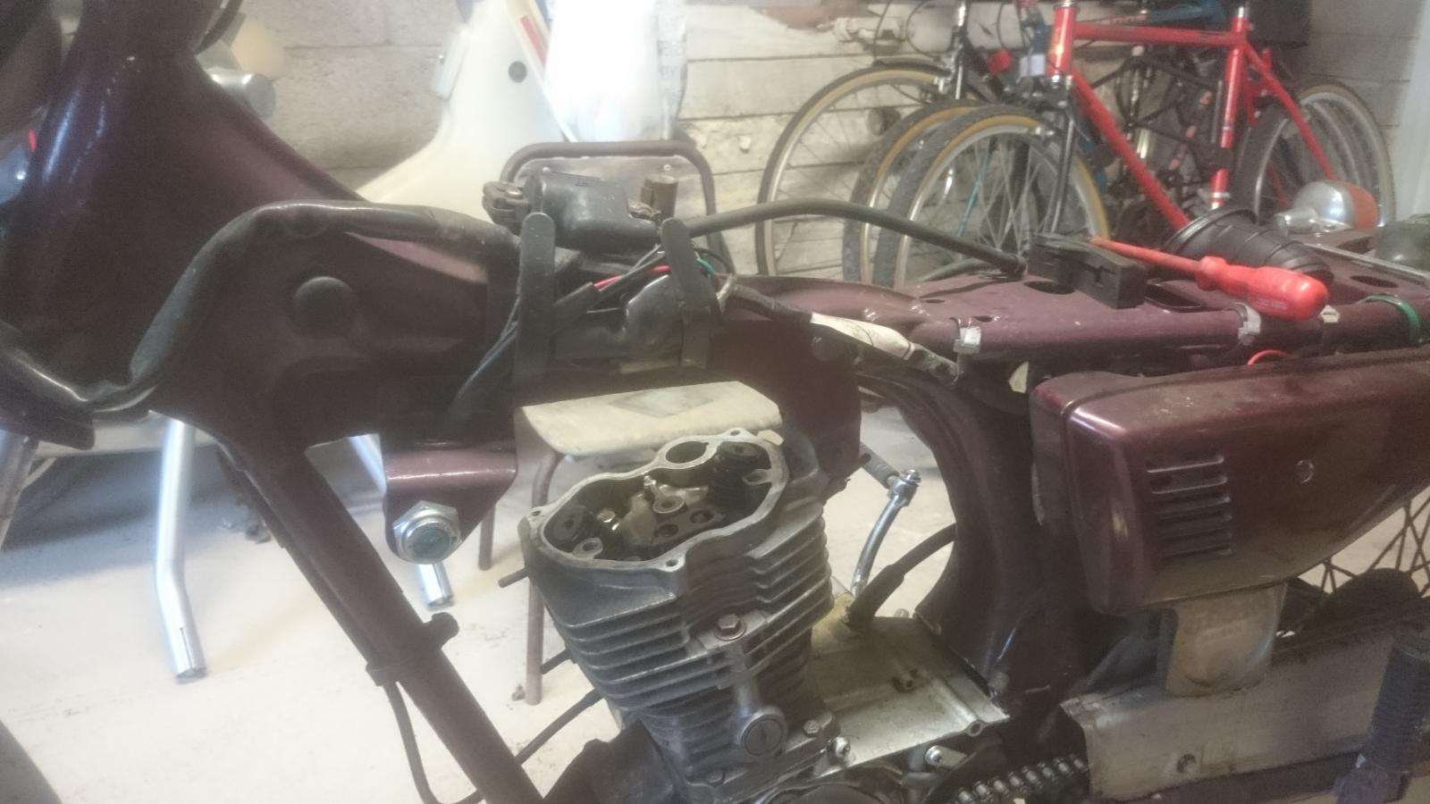

So; off with the seat and fuel tank, and out with the oil.

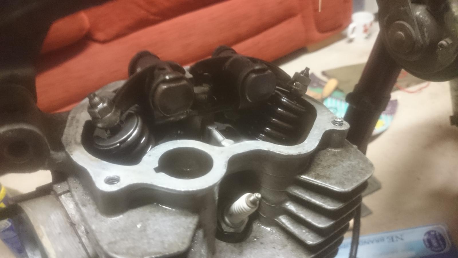

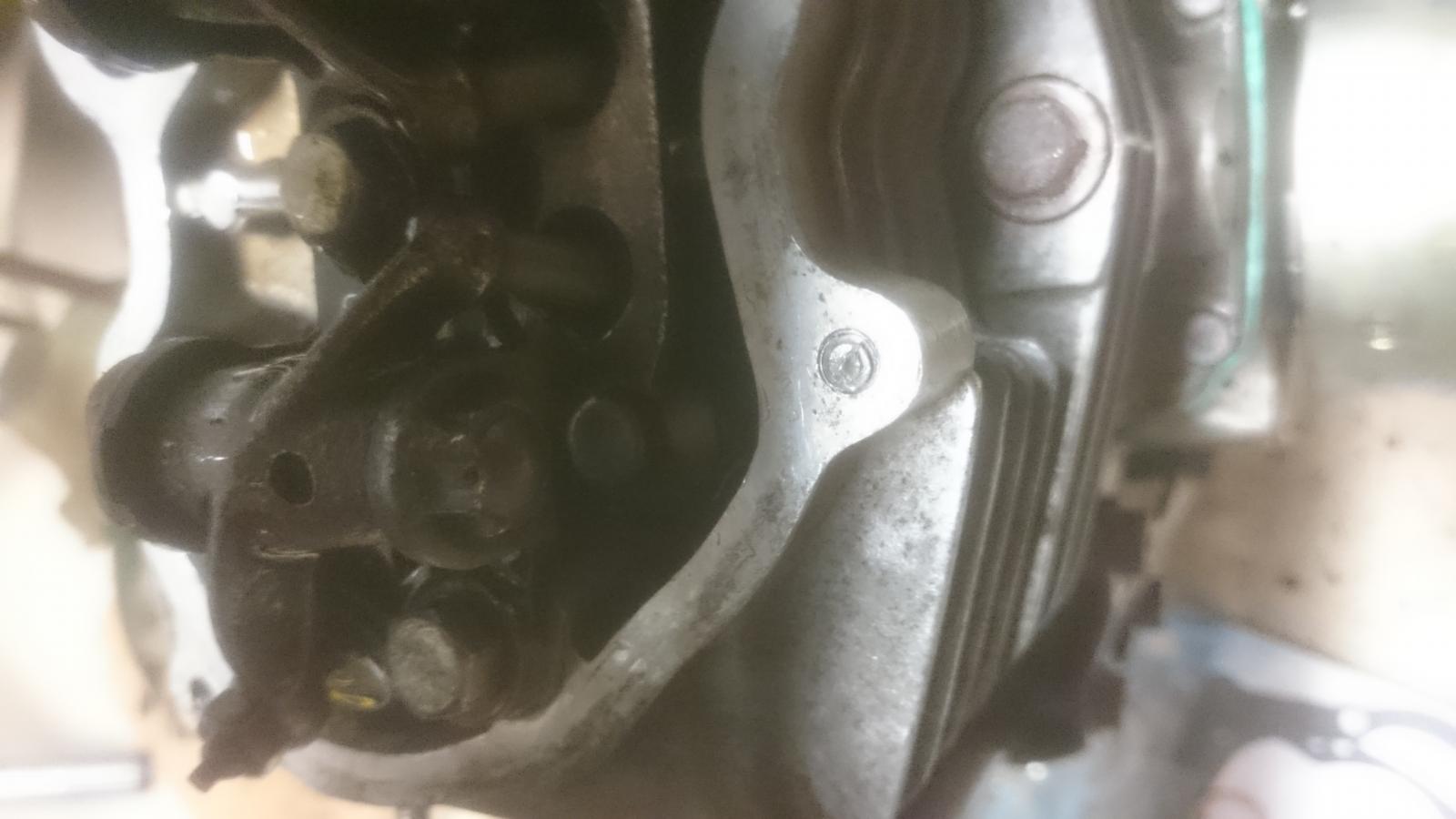

Took the rocker cover off.

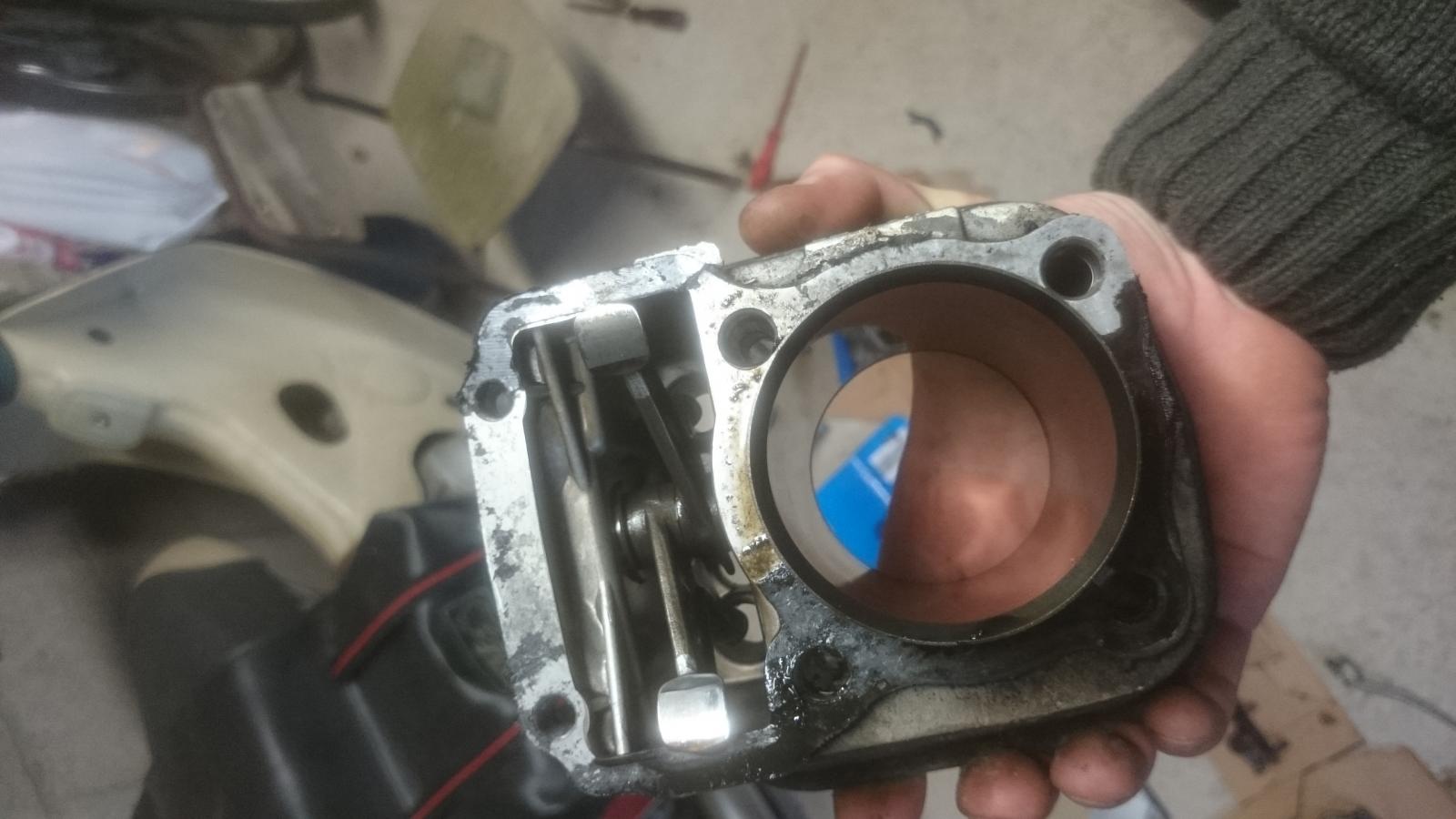

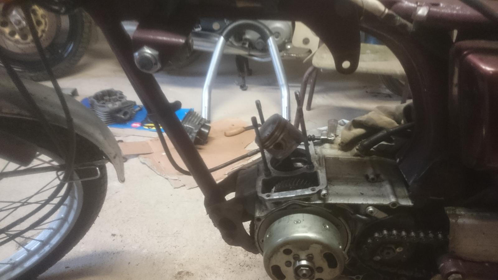

Removed the head and pot chamber.
Got out the most important tool of all.
This was a right bastard to get clean.
Nevertheless, got it all cleaned up, fitted a genuine* new Chinese gasket that almost fitted properly and set about putting it all back together.
Bastard.

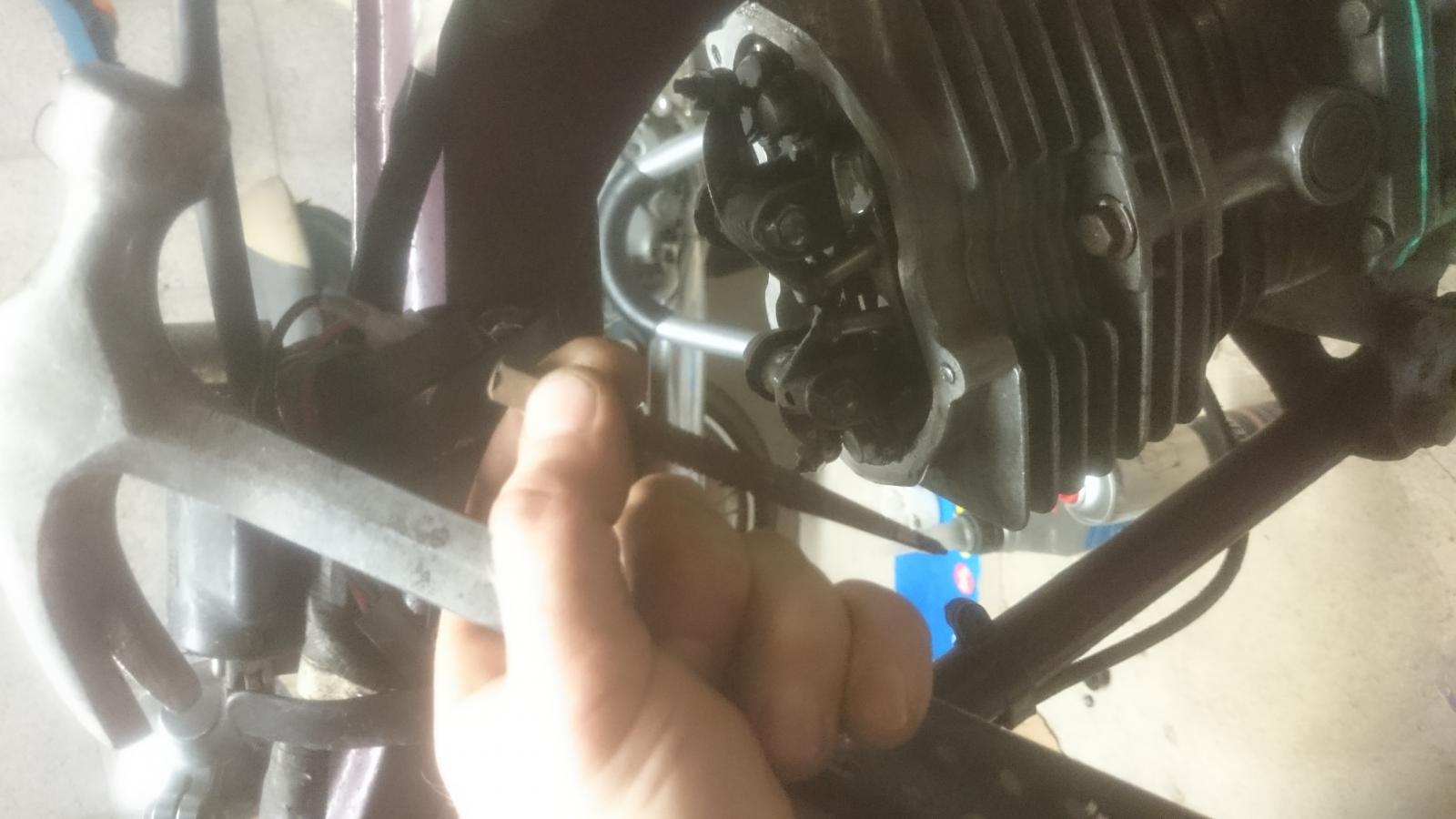

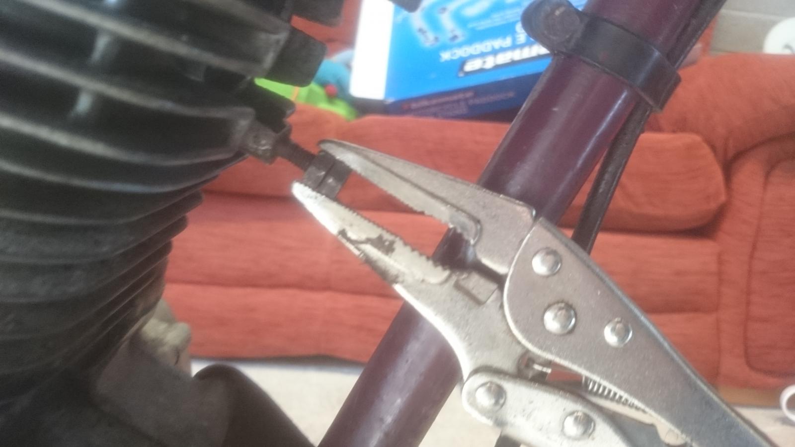

Whilst trying to knock a dent on the top of the fucked bolt so I could drill it out i noticed it shift a little. I managed to knock it round enough for getting a set of mole grips to bite onto it.
So, maybe my luck is changing i thought. So I made plans to visit the Honda stealership down the road and set about fixing the other side.

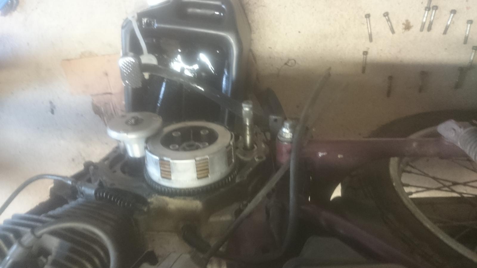

Undeterred, I re-fitted the carb and set about unsticking the clutch plates.
This didn't go too badly. I cleaned out the centrifugal oil filter as well. Judging by the gunge within I think the last person to see inside this worked in the factory. In Japan. In 1979.

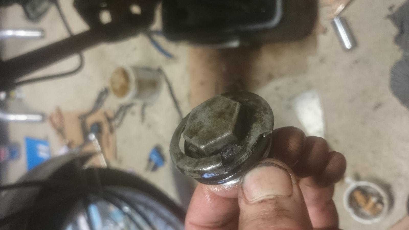

I put the crank case back on, then off again, then back on again due to the sodding gear selector fork having fallen off. Then I decided I'd clean out the gauze oil filter on the other side of the engine.
Then this:
Yep, that's a very broken o-ring housing.
The weird thing is, I didn't use brute force or ignorance on any of these fuckups. My best guess is I weakend them all last time i worked on it 7 years ago. either that or it's down to it being 36 year old metal.

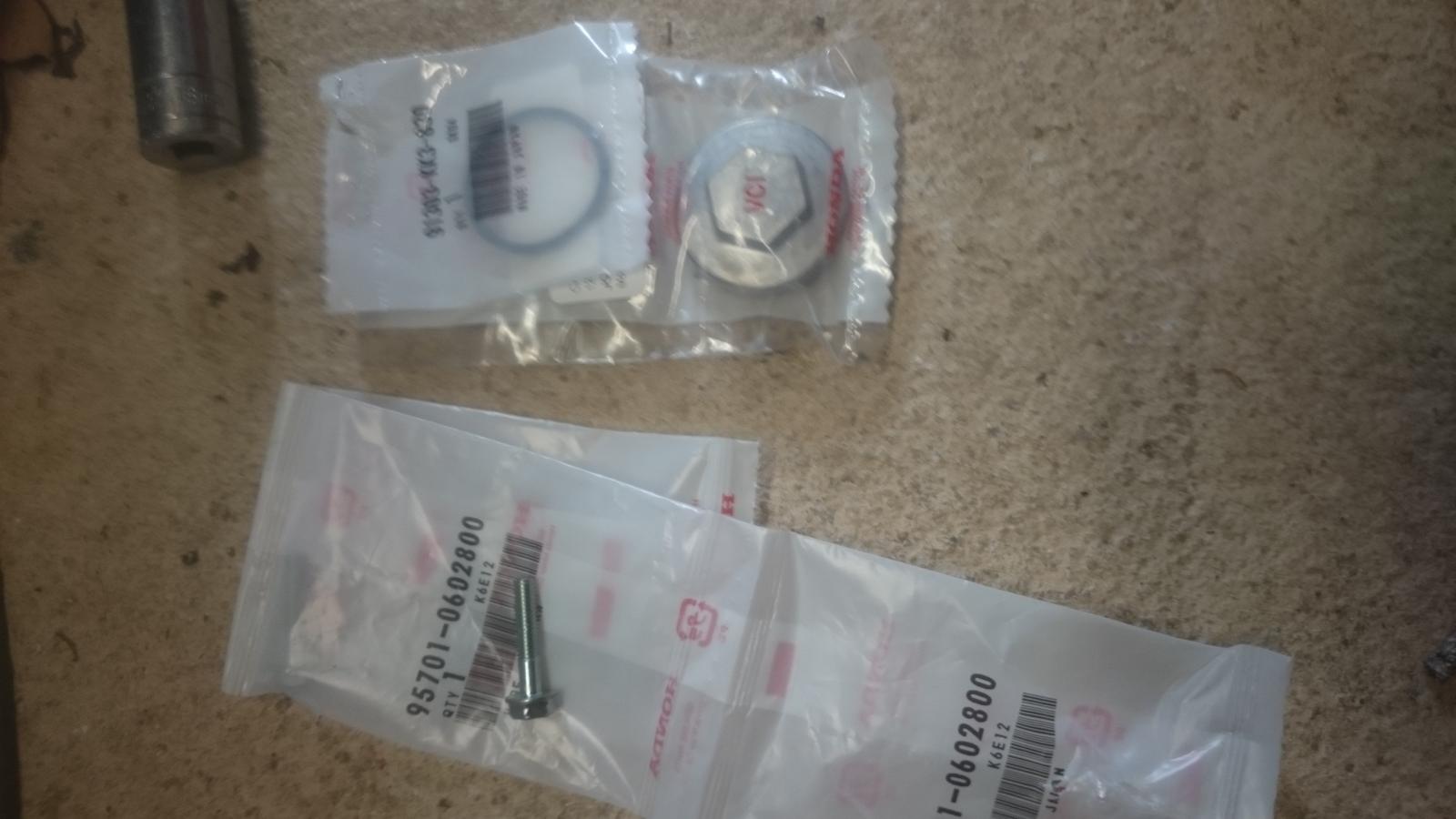

I managed to get the parts from a Honda stealership down the road.

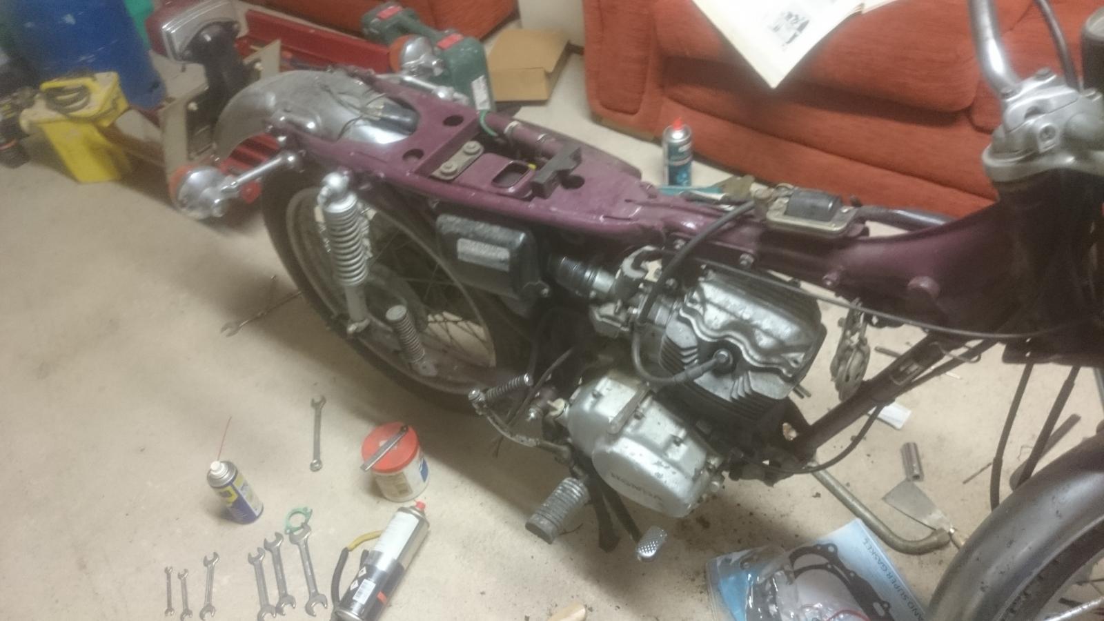

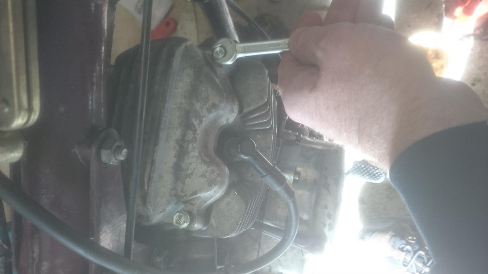

So having scoffed an egg banjo I set about putting it all back together.
Channeling my inner bomb disposal expert here.
Then I figured out a clever* way of straightening the exhaust header stud.
And by the sheer power of fluke, everything went back together ok. So I put some petrol in the tank, some oil in the crankcase, and on the crankcase, and the floor. Then on the 4th kick it burst into life, for the first time in seven years.
