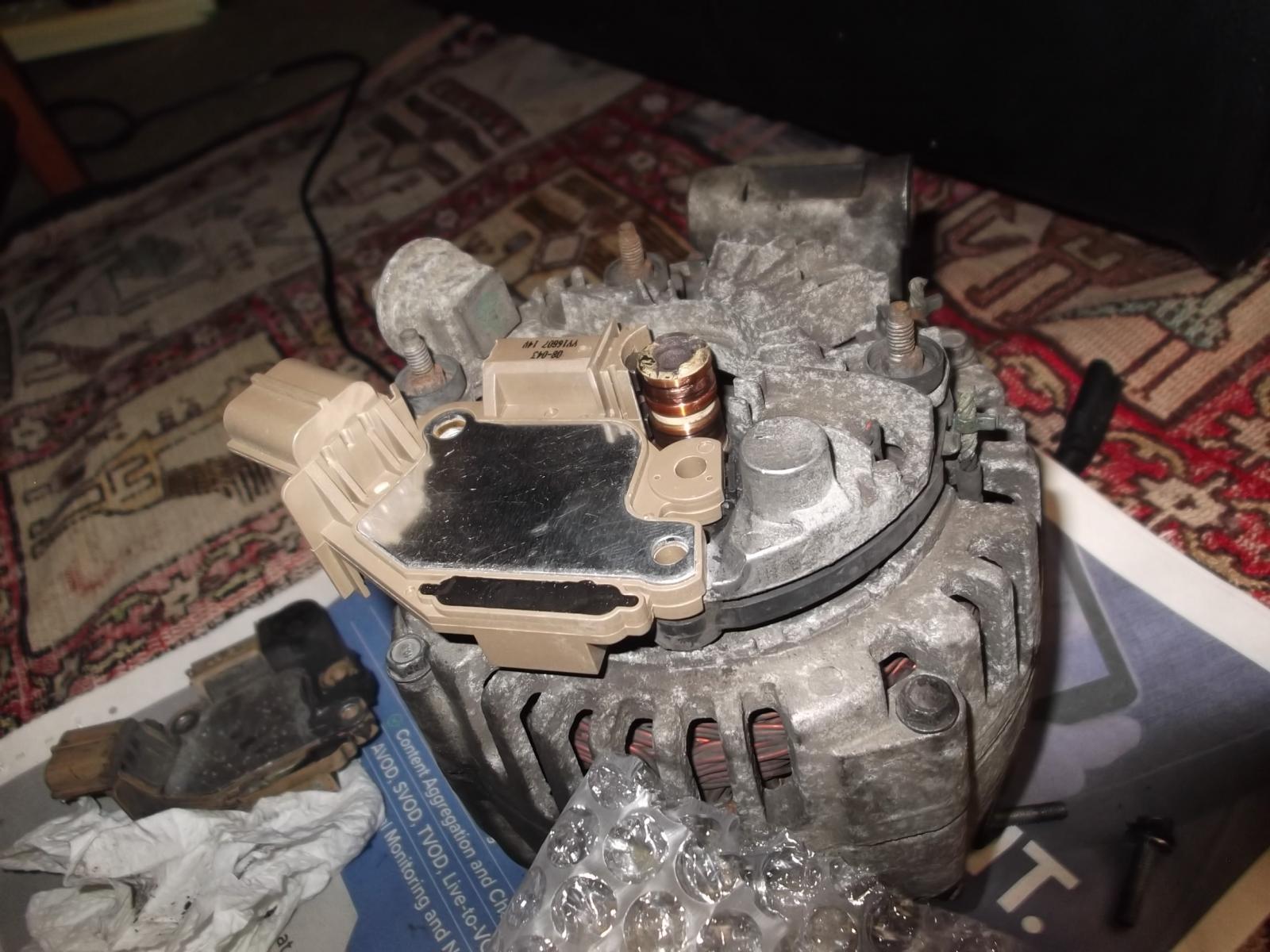

Rave Posted March 21, 2017 Author Posted March 21, 2017 I know you've all been waiting with bated breath for an update on this. A couple of weeks ago I went through the rigmarole of getting at the alternator again, and poked it with my multimeter, which revealed that there was good continuity between the alternator body, and the engine block. I then finally figured that I was being a dimwit thinking that I'd need an extension lead to test the positive cable for continuity- just test for voltage between the terminal at the alternator end, and ground...sure enough, 12V present and correct. So battery terminals off, and out the alternator came again. I googled around a bit and found a local chap whose business is rebuilding alternators from his garage. I rang him up, and after I'd explained that, no, I didn't need him to remove the alternator from the car, told him that I thought the regulator was probably faulty, and that I just wanted it testing. His response was "if you think the regulator's faulty, just buy another one!". So I sighed, went on ebay, and bought this: http://www.ebay.co.uk/itm/ARG134-ALTERNATOR-Regulator-Ford-Ka-Focus-C-Max-1-3-1-6-Fusion-1-25-Mondeo-3-0/261706747643?_trksid=p3693.c100102.m2452&_trkparms=ao%3D1%26asc%3D20140212121249%26meid%3D029ecba007814555add6e345c8cea944%26pid%3D100102%26 ...which arrived the very next day. Anyway, after another week or so of prevarication, today was the day I fitted it to the alternator: I was a bit concerned that the brushes didn't seem to fit into the grooves worn into the slip ring, but there didn't seem to be anything I could do about it. While I was at it, I gave the charge terminal and the contact faces between the alternator and the block a quick spin over with a little wire rush in my cheapo dremel clone. Then, with a strong sense of doomed inevitability, I trekked out to the car with my jack and all my tools, and bunged it back in for a second time. This time, I didn't even bother reattaching the drop link and track rod, just put the serpentine belt back on, connected the terminals to the alternator and battery, crossed my fingers, and started the car. Not pictured, but tested: battery charging at 13.6V . Anyway, I then checked the tyre pressures, only to find that they were still over the recommendations- I must have left them in "full load, 3 or more passengers" mode when I parked it up. So I gingerly set off for a drive round the block. Most of the rust noisily ground off the brakes in a few stops and they seem to be working fine, but the long layup has caused some part or other of the gearshift linkage to seize up, so it doesn't self centre any more, and I had a bugger of a time getting it into reverse. I guess some white spray grease aimed at the bottom of the stick would be my first port of call? I was also rudely reminded what a big bastard it is compared to the Mk1 Megane I've been driving for the last 5 months...and how difficult I make driving it by insisting on having the seat set as low as it will go, because handling y0. I might have to grow up and raise the seat a bit, so I can see the extremities a bit better, but equally I'll probably get used to it again soon. Just need to buy some breakdown cover now, for when whatever it was caused the old regulator to pop does the same to this one . Captain Furious 1
overrun Posted March 21, 2017 Posted March 21, 2017 Well done, but surely 13.6v charging is a bit low?! I used to have a mk3 TDCi 130 Ghia X with all the stuff yours has and the factory DVD screens in the headrests, so I wonder if that alternator is the same?
Rave Posted March 21, 2017 Author Posted March 21, 2017 Well done, but surely 13.6v charging is a bit low?! I used to have a mk3 TDCi 130 Ghia X with all the stuff yours has and the factory DVD screens in the headrests, so I wonder if that alternator is the same? I don't know, TBH. The battery's old and probably a bit flat from all the messing about, that was at idle with a cold battery and engine, and I don't understand the vagaries of the Smart Charge system. As long as the battery light stays off and the car starts and goes, I'm calling it a win. According to the fitment list for the regulator, it's not the same alternator as a TDCi. Interestingly the regulator itself fits all sorts, including Kas and Mazda 2s, but the only Mondeo listed is the 3.0 V6.
