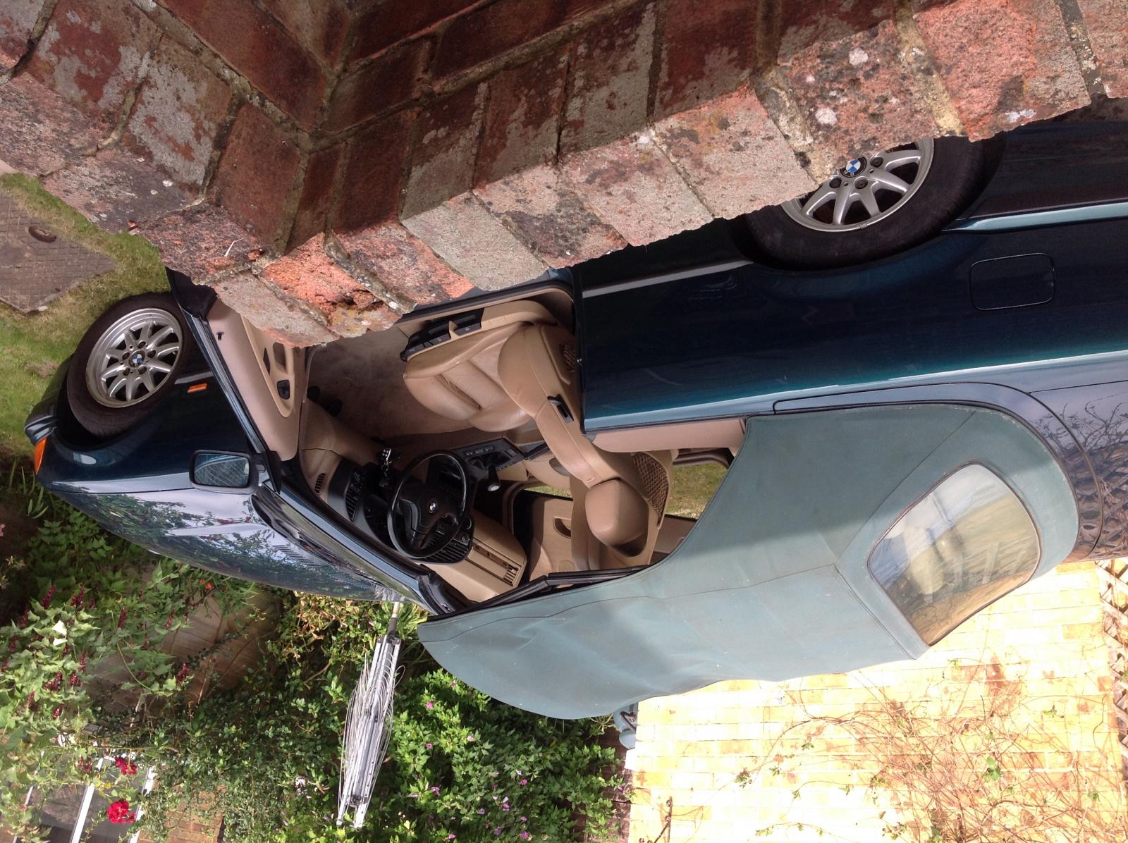

Vince70 Posted January 7, 2017 Posted January 7, 2017 My fathers E36 needs a new roof as its catching as it needs new tension straps and the rear window has seen better days plus its shrunk slightly so he was going to get a new top fitted.But the thing is I've just been offered a new a complete automatic (secondhand) roof in good condition for £150 and I can do the basics on a car but have never tried doing anything like this.Could someone tell me is it a diy job or is it a job for a professional. This is the roof and frame that needs changing, except the car isn't upside down

Dave_Q Posted January 7, 2017 Posted January 7, 2017 There are 3 types of '36 roofs IIRC, manual, semi-auto and fully auto. The semi-auto has a manual latch at the front but then drops on a button, the fully auto has motors for that too. As long as the roof you're getting is the same as the one on the car it's not too bad a job but needs 2 people really. If, for example, your dad's car is manual and the roof you're putting on is auto then you'll have problems with the wiring and motors etc not being there to drive it. Vince70 1
Vince70 Posted January 7, 2017 Author Posted January 7, 2017 The car has the full auto roof and the new roof is the same but the problem for me is the electrics as I imagine it must have a multitude of sensors.I've tried looking up on good old Google for a video on replacing the roof but can't find anything.
