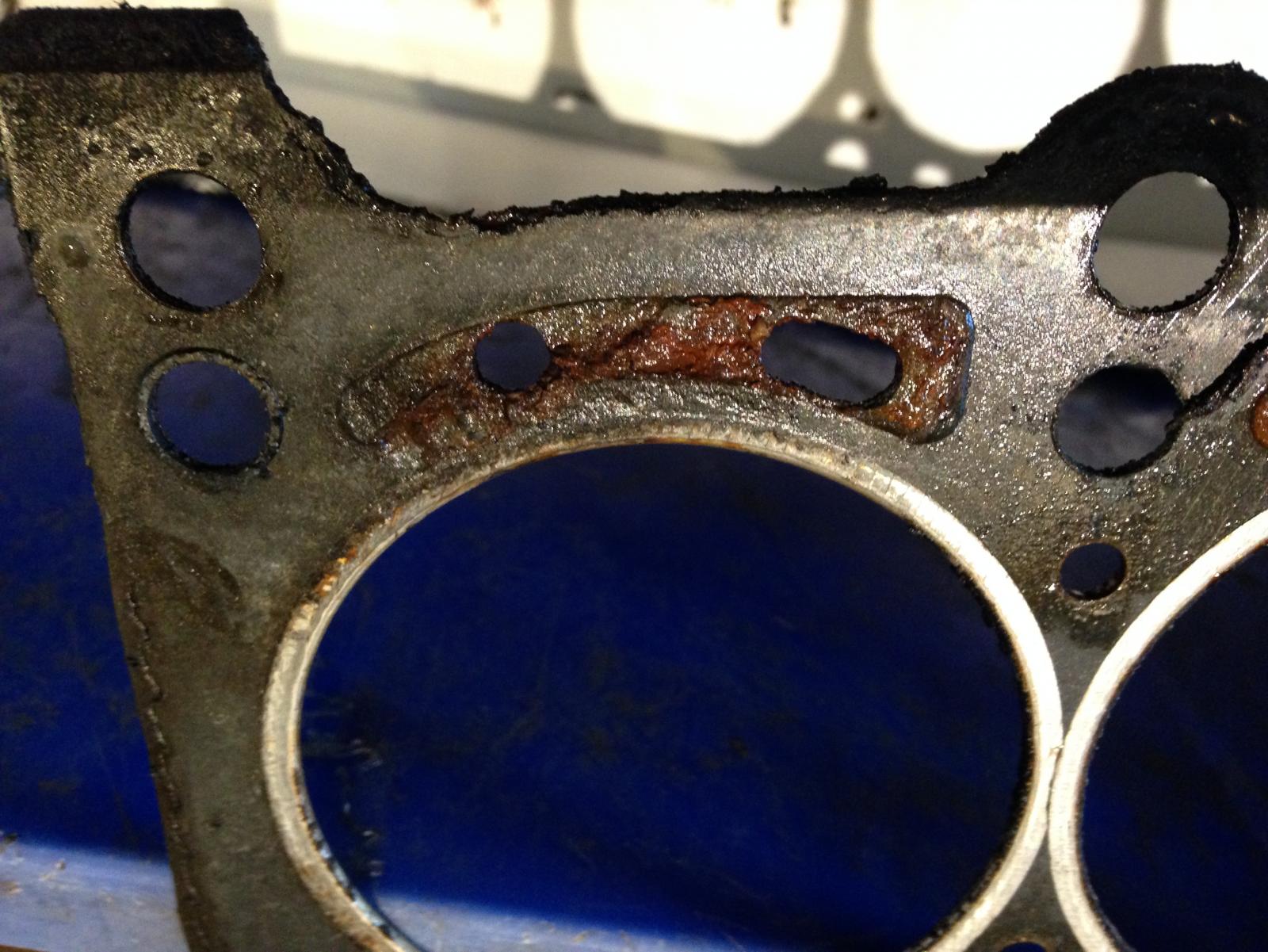

This shows the gasket by the only combustion chamber that had black sooted valves. All the rest were whiteish.

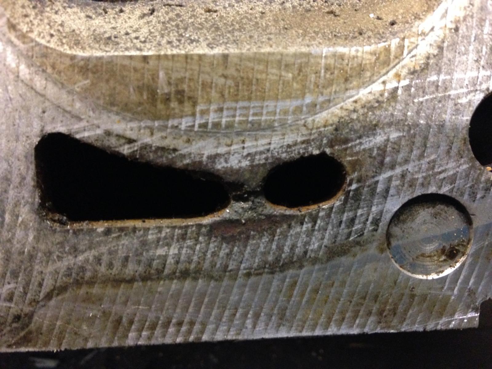

This shows the head in the same spot which how's some erosion of the aluminium is this acceptable? Should I have it repaired. ?

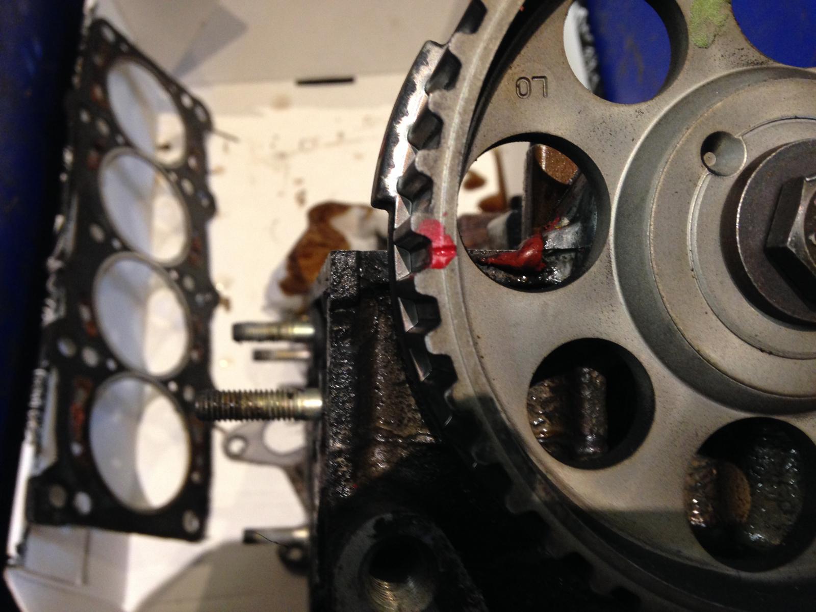

And the last one shows that the timing belt was one tooth out and may account for the low idle once the car is warmed up.
I will check the flatness of the head tomorrow but the erosion is a little concerning.

That amount of corrosive wouldn't bother me - if you're really worried, get the head skimmed: if it only takes a couple of thou' to get it flat, have it pressure tested.

I did a quick check and the head was flat enough but a bit pitted like yours so splashed £40 out on parts and nailed it back together where it then decided to leak from a perished o ring on the water pipe that runs along the block and into the water pump.
Oh i changed the exp cap too as that was no longer holding pressure.
It's since been sold to a couple of Italians and still running well and holding its coolant so i reckon yours will go again no problem.
