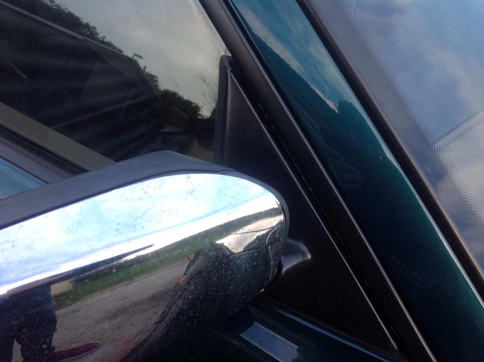

I paid 99p for a new trim panel on eBay £7 for the base coat from halfords and I had some old pound shop primer and lacquer sitting in the shed which I put in the oven before using and used a two pack glue which repaired the foglamp clip as the fog lamp was also knackered.post-9282-0-61779200-1482575144_thumb.jpeg
I should of done before and after pictures as the side of the bumper was scraped up quite bad.

At the end of the day it's all about prep I find once the repair is done it's always worth ghosting the primer a couple of times to check for imperfections and flat back before applying the basecoat also the cans end up going in the oven for 15 minutes before I use as I find they spray better and in between coats I go over the area with a hairdryer to help with the drying time.post-9282-0-46781400-1482666580_thumb.jpeg
