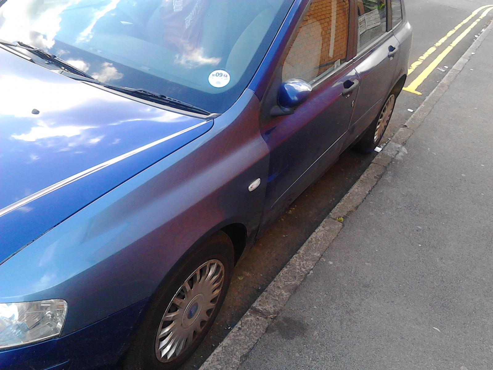

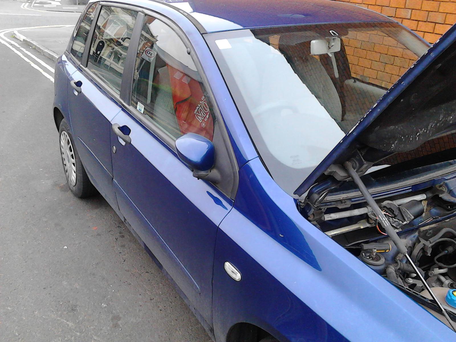

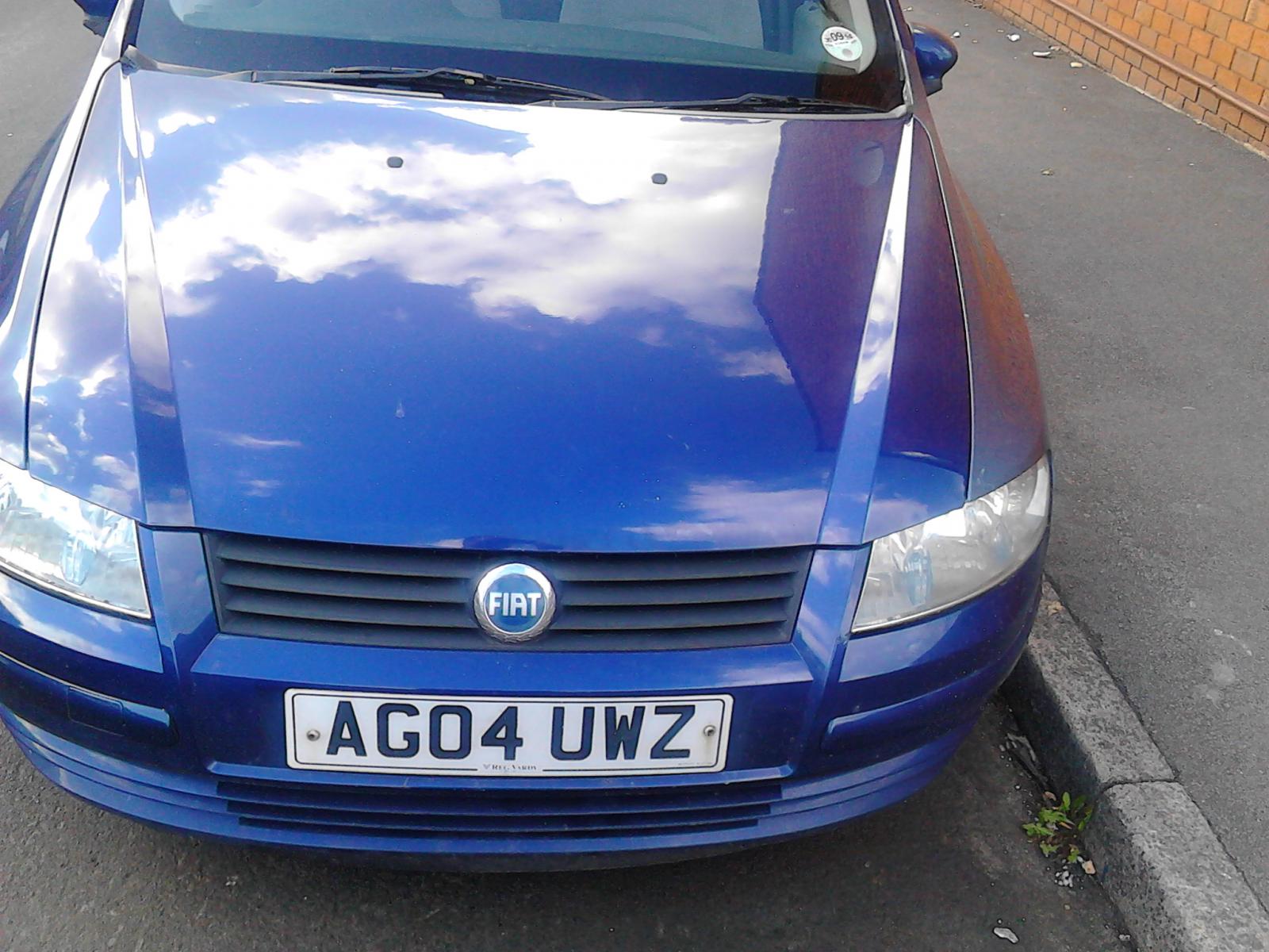

yes it the infamous stilo,better pictures tomorrow,here for now,giffer taped the indicator,had fun with transit van,but it passed mot fine,drives fine,six speed box,1.4 engine,usual electic switch not workingservice due,bought air,pollen filter,from euro.

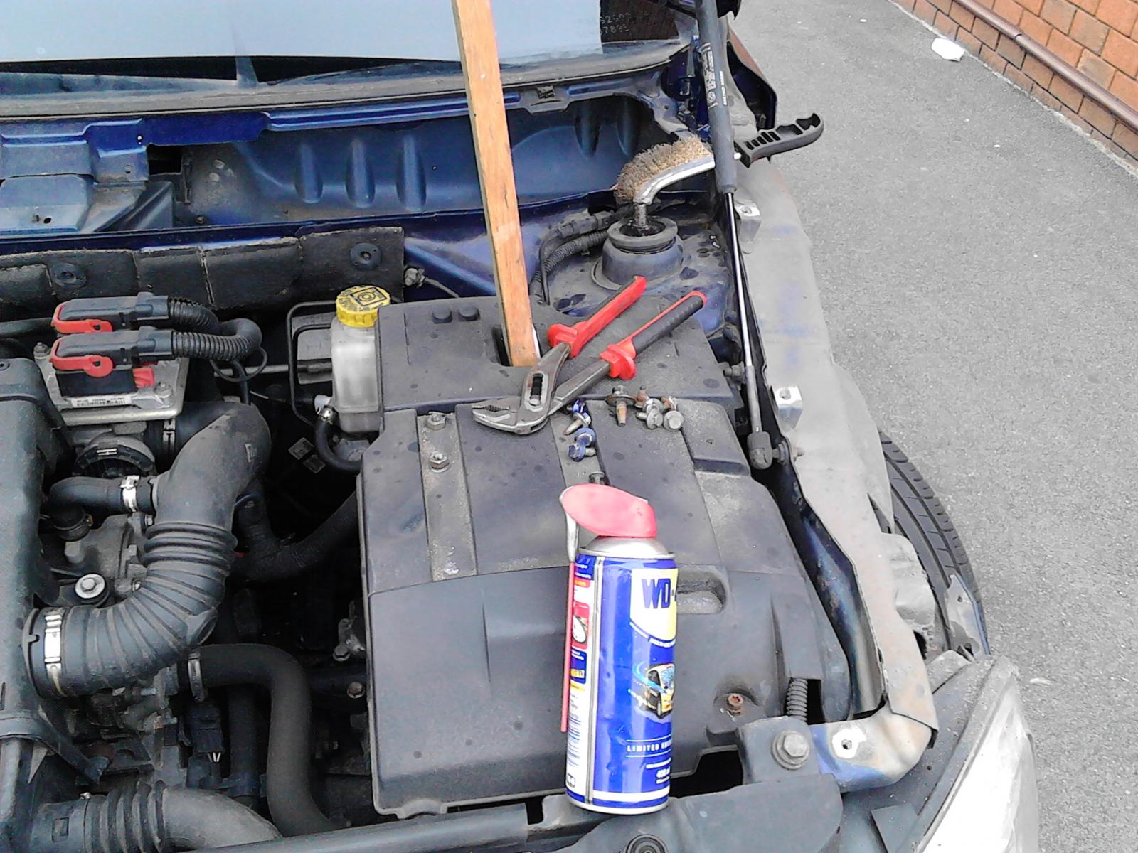

well did the airfilter,quite easy,but the pollen filter,what a pain that was,found 6p and mp3 player. :-D :-D

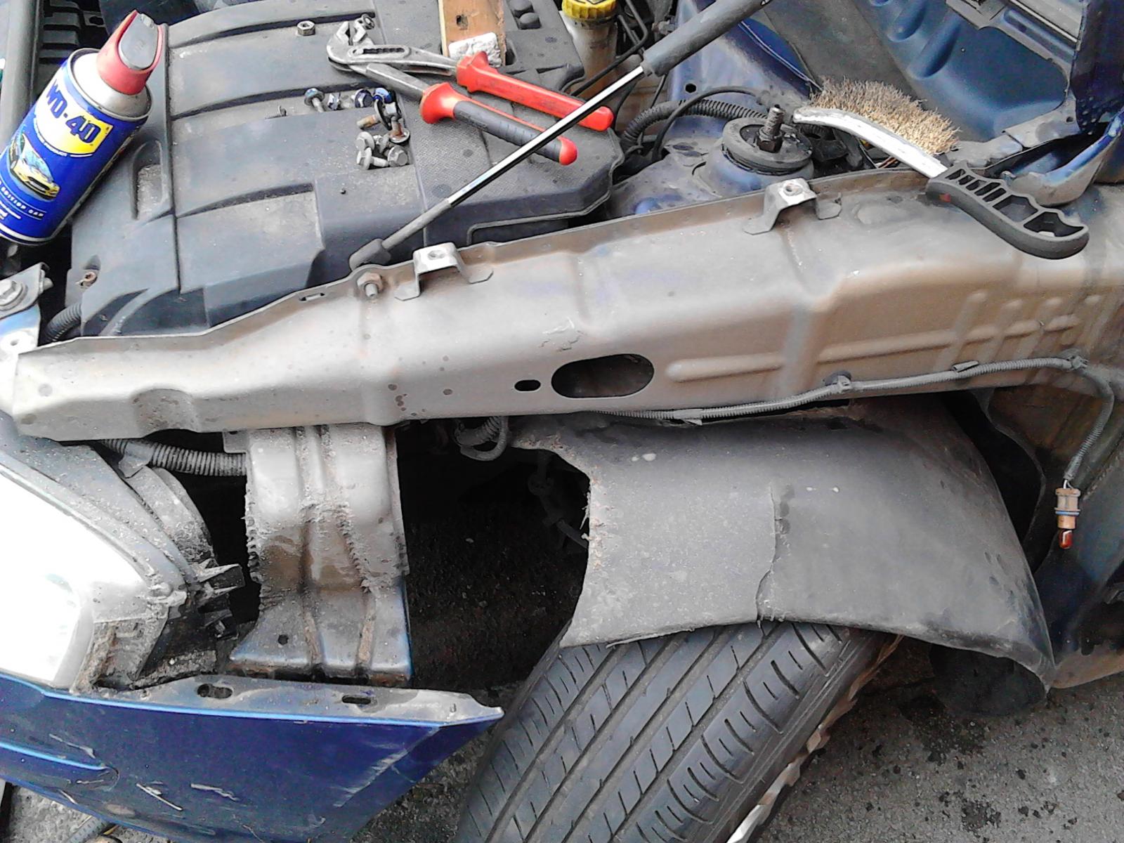

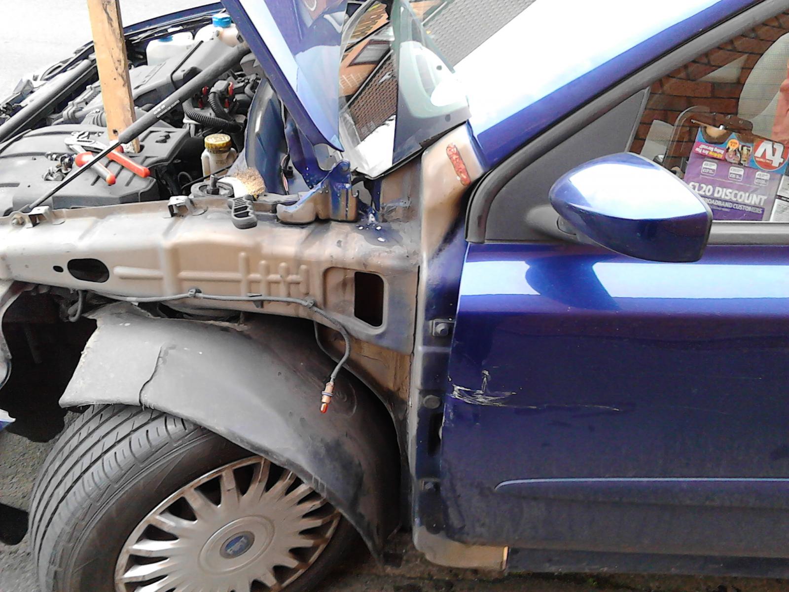

more pictures,went to breakers got a wing,see pictures,got some comma anti-rust spray,sprayed the front subframe,known weak spot,have got gates t/belt..
timing belt done today said it needed special tools,fook,well removed engine mount ,covers,fanbelt,just got to it in time,the old belt was cracking up,and very soft,looked like the original,undone tensioner,carefully slipped on gates belts,tippexd mark,spun over by hand first,not seized,put back togther all fine!!so i thought do the oil,it was like the black hole of calcutta :mrgreen: it was bad,was last done 2013,...spark,plugs tommorrow,

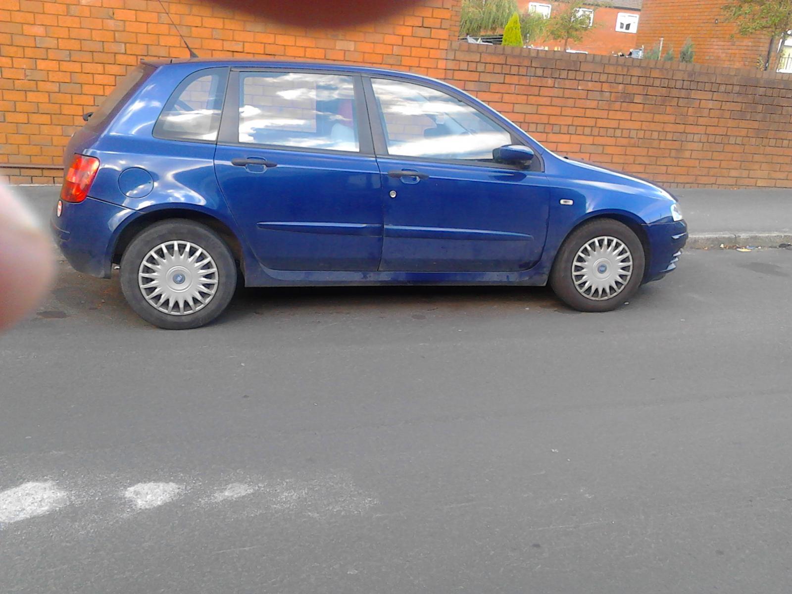

few more pictures,drove down skipton castle,drives well wth sixspeed box,good on fuel...

them sunroofs are excellent,wing may be coming of have found a better color match,and a door aswell, :-D :-D
