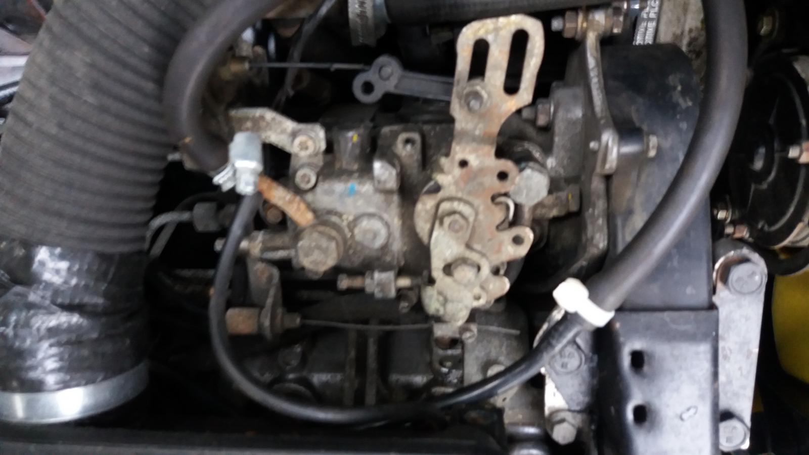

M'coli Posted August 16, 2016 Posted August 16, 2016 I have a feeling that this thread could turn into a FAQ type thingy, so just for clarity, this is a Lucas injection pump for the turbodiesel:And the n/a Lucas pumps are pretty similar. If someone has a n/a Bosch pump and someone else a turbo Bosch pump and could photograph them and add them here, that would be helpful - they too look similar but the td pump has more attachments. Laseraligningfoofooflanges and CYANIDE STEVE 2
CYANIDE STEVE Posted August 16, 2016 Author Posted August 16, 2016 Actually I could photograph the non turbo Bosch pump myself tomorrow and put it on here if nobody else has by then .

CYANIDE STEVE Posted August 18, 2016 Author Posted August 18, 2016 This is a photo of my non turbo Bosch pump on the fso camper.
