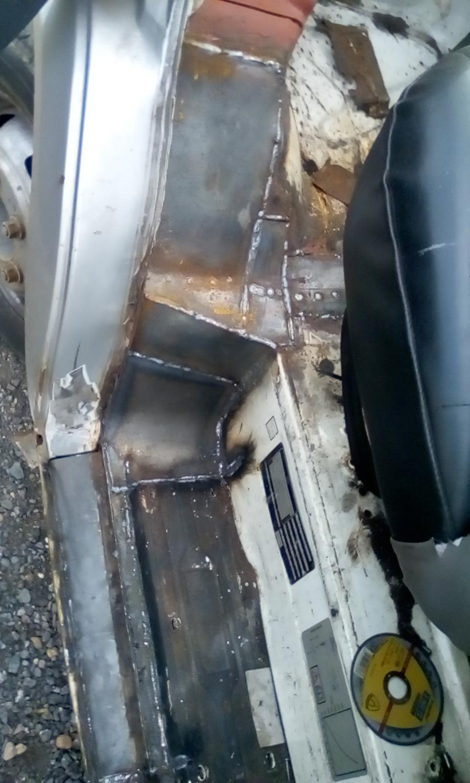

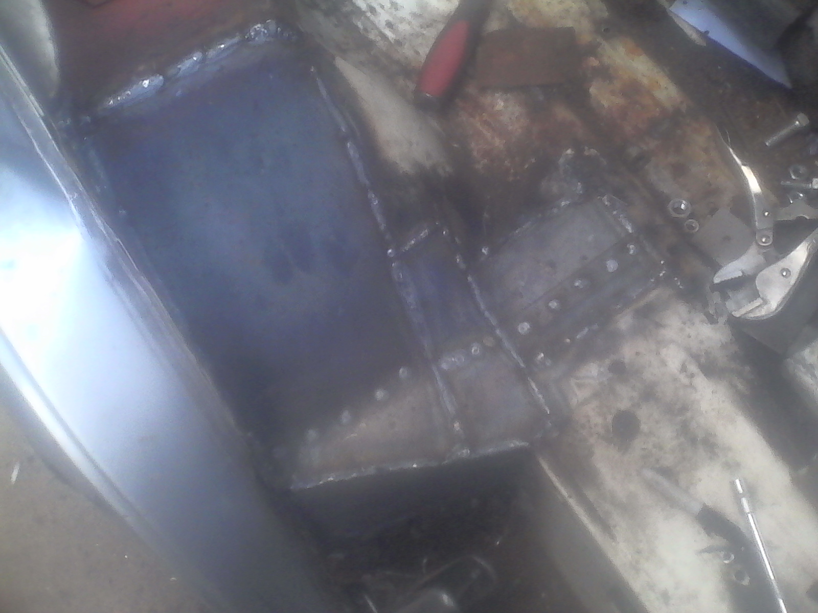

another saturday and another square foot of repairs!
pictures by potato cam unfortunately although it does disguise the more agricultural nature of today's efforts   :roll:

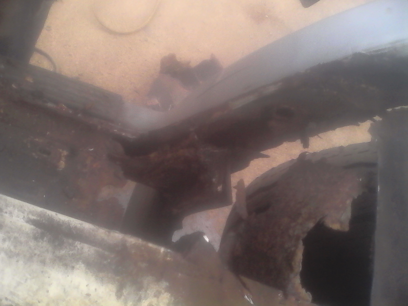

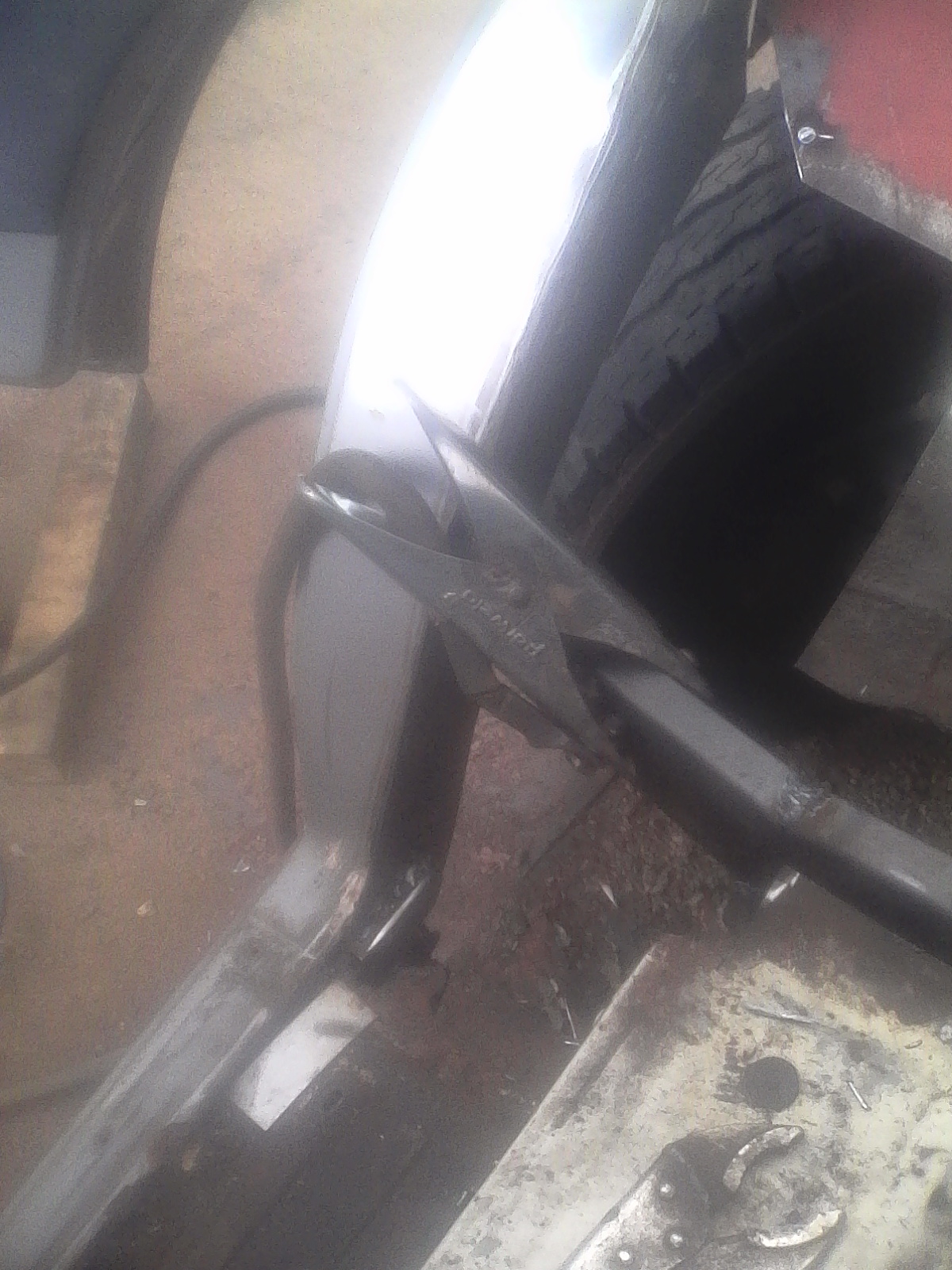

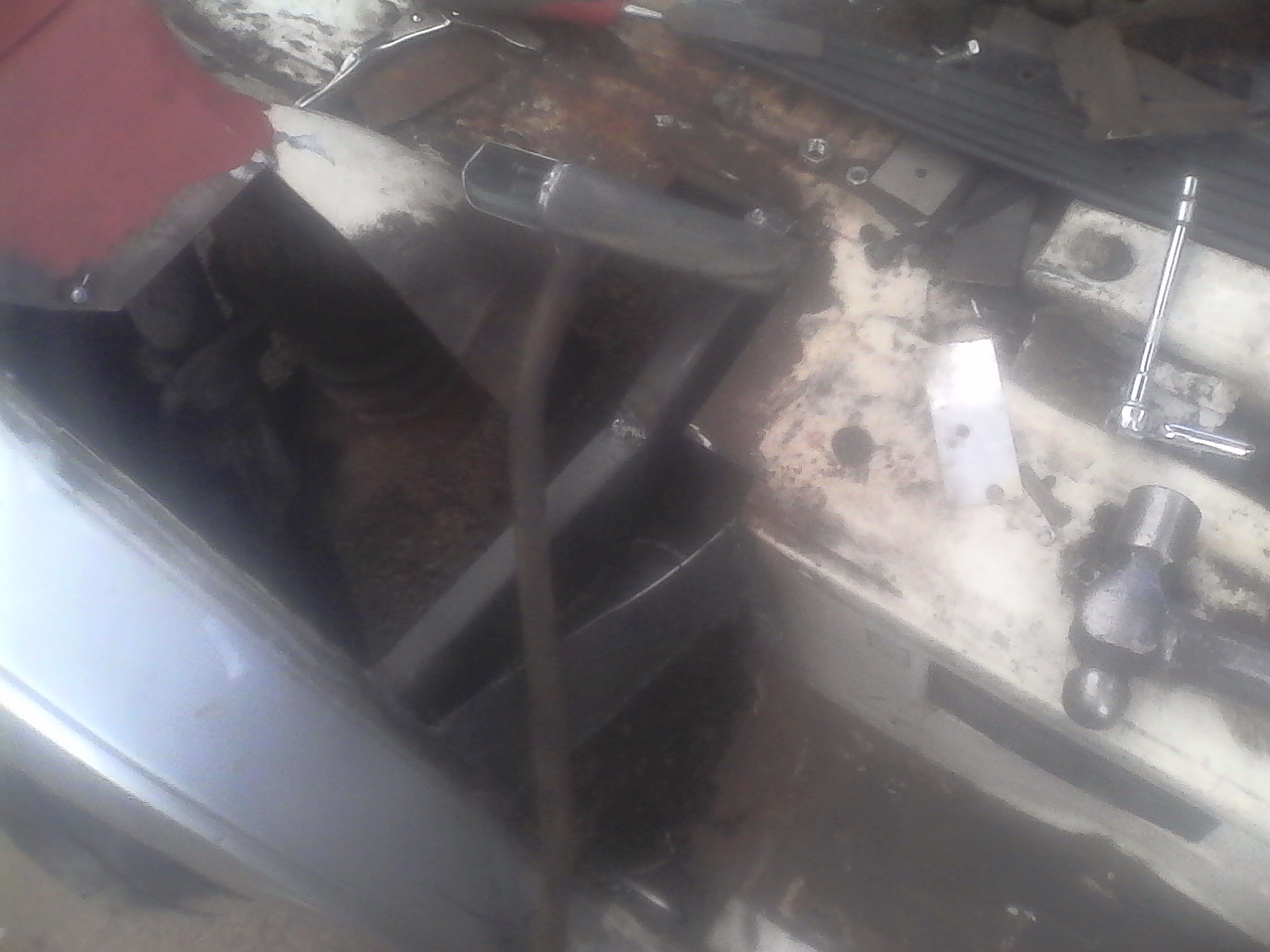

moving round the arch and into the step area
choppy chop

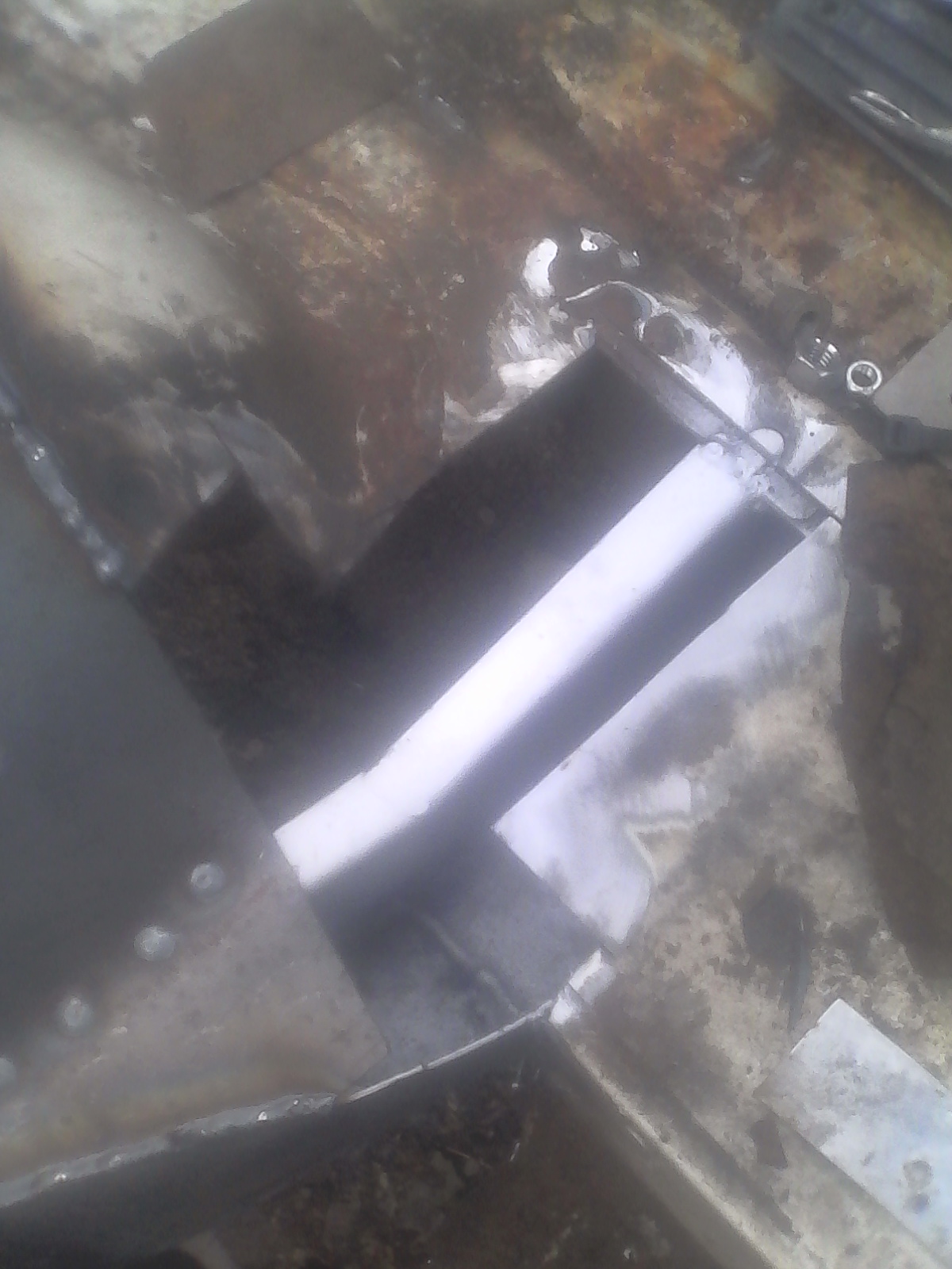

template of a post/arch section
difficult to see but outer arch has a cover panel riveted to it

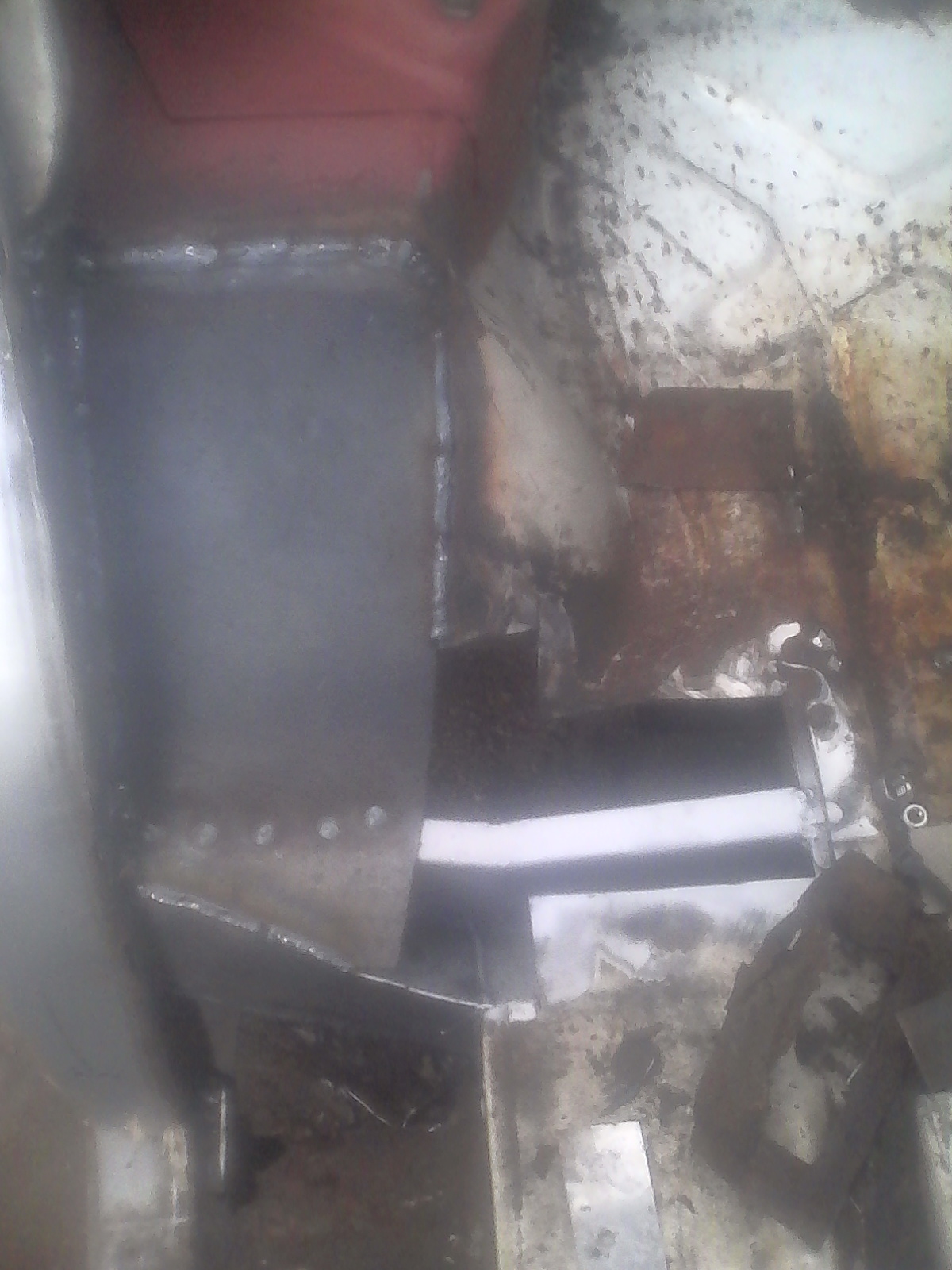

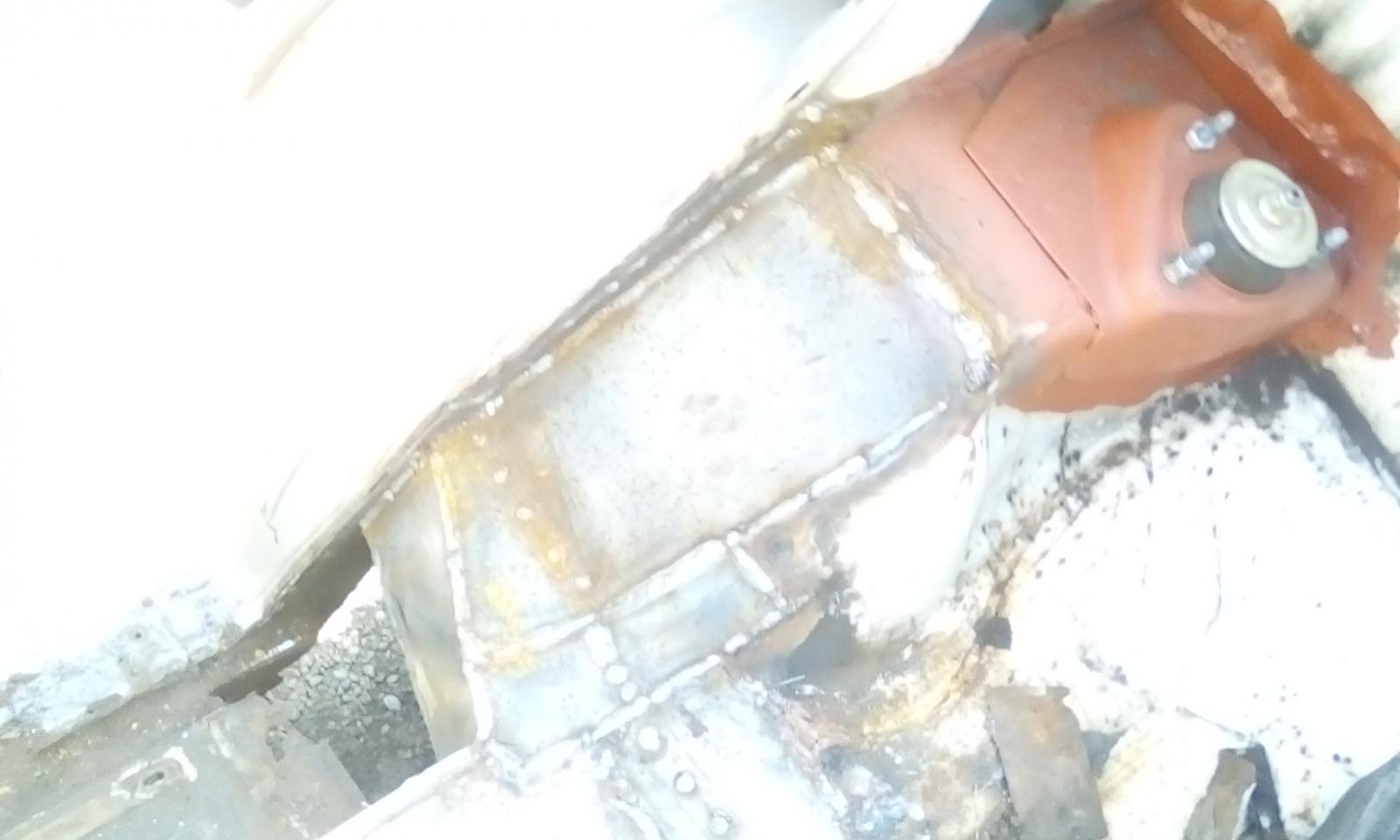

first part of outrigger
outrigger done and more filling in

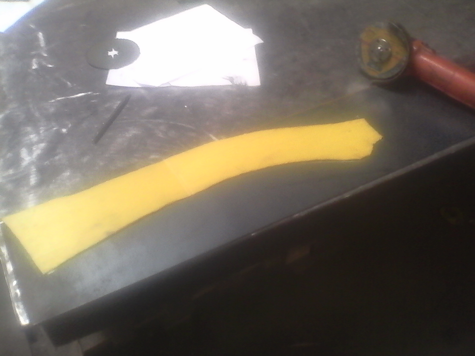

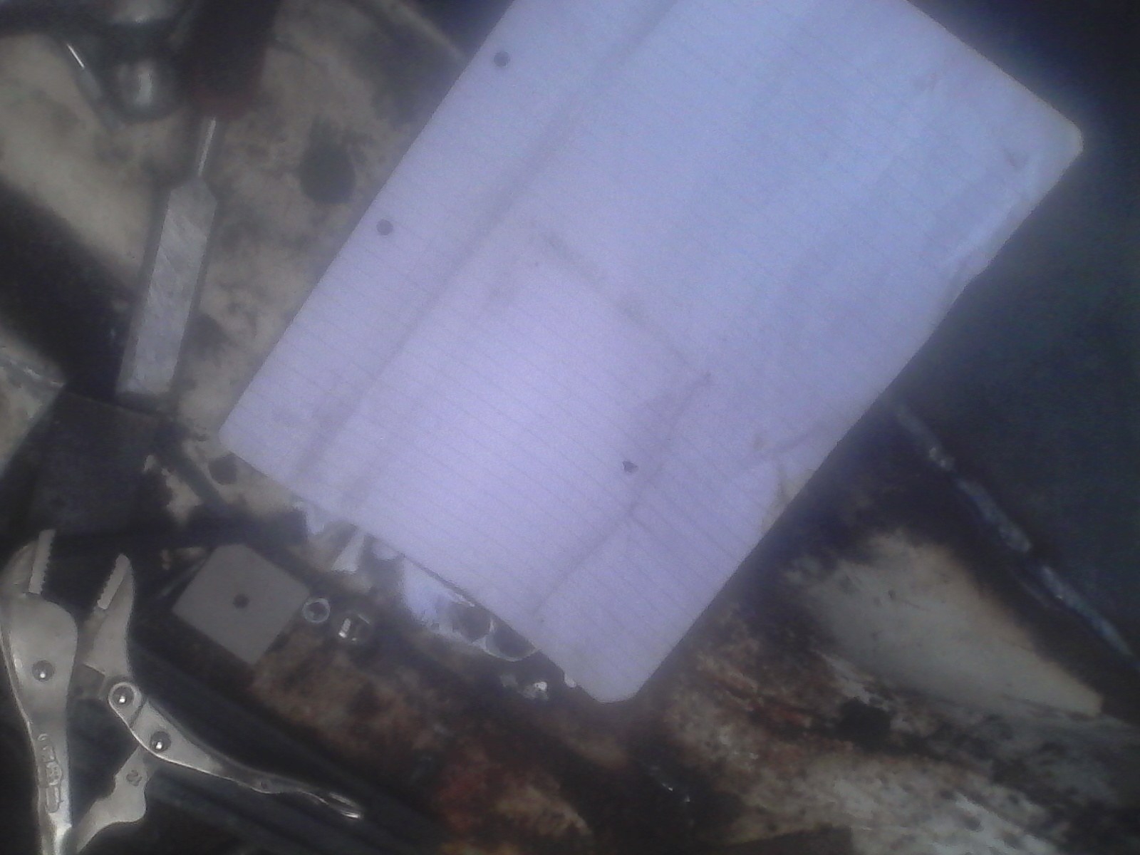

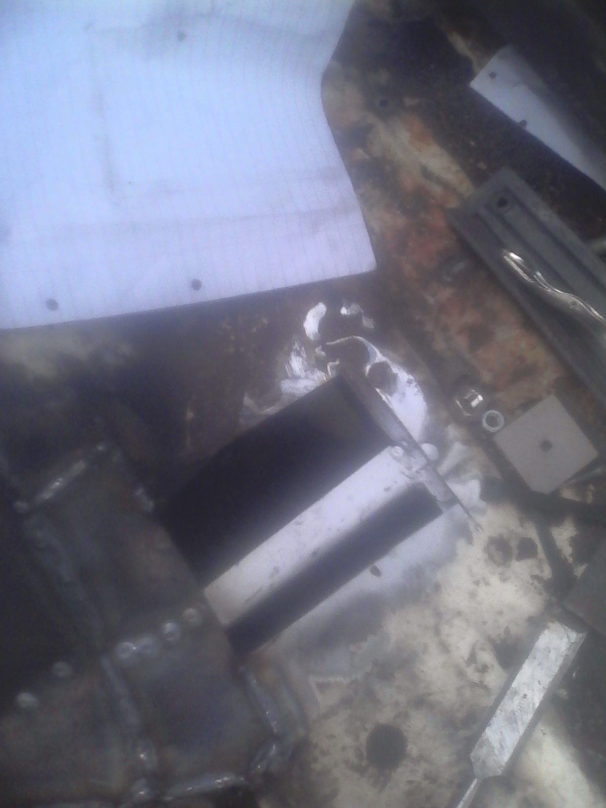

used a sheet of paper and running my dirty finger around the edge technique  to make a template for the last bit
not a great deal to show for a days efforts  :oops:

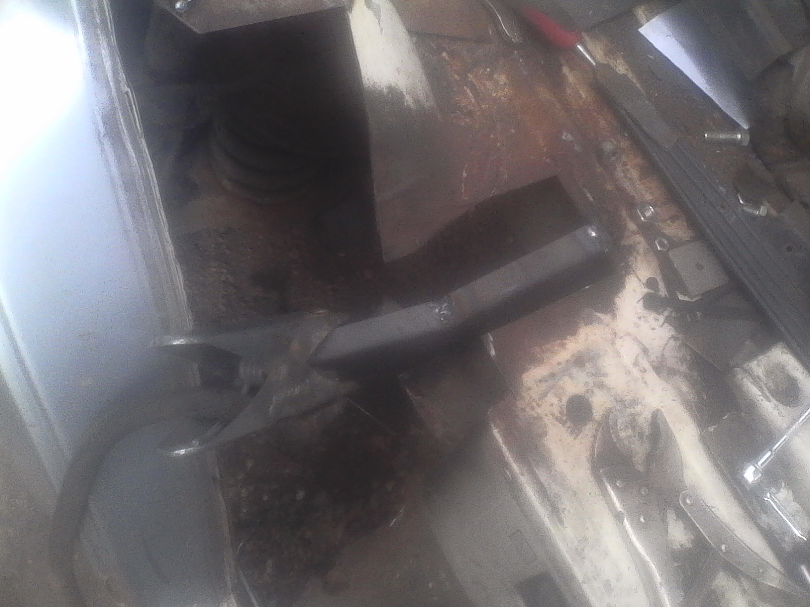

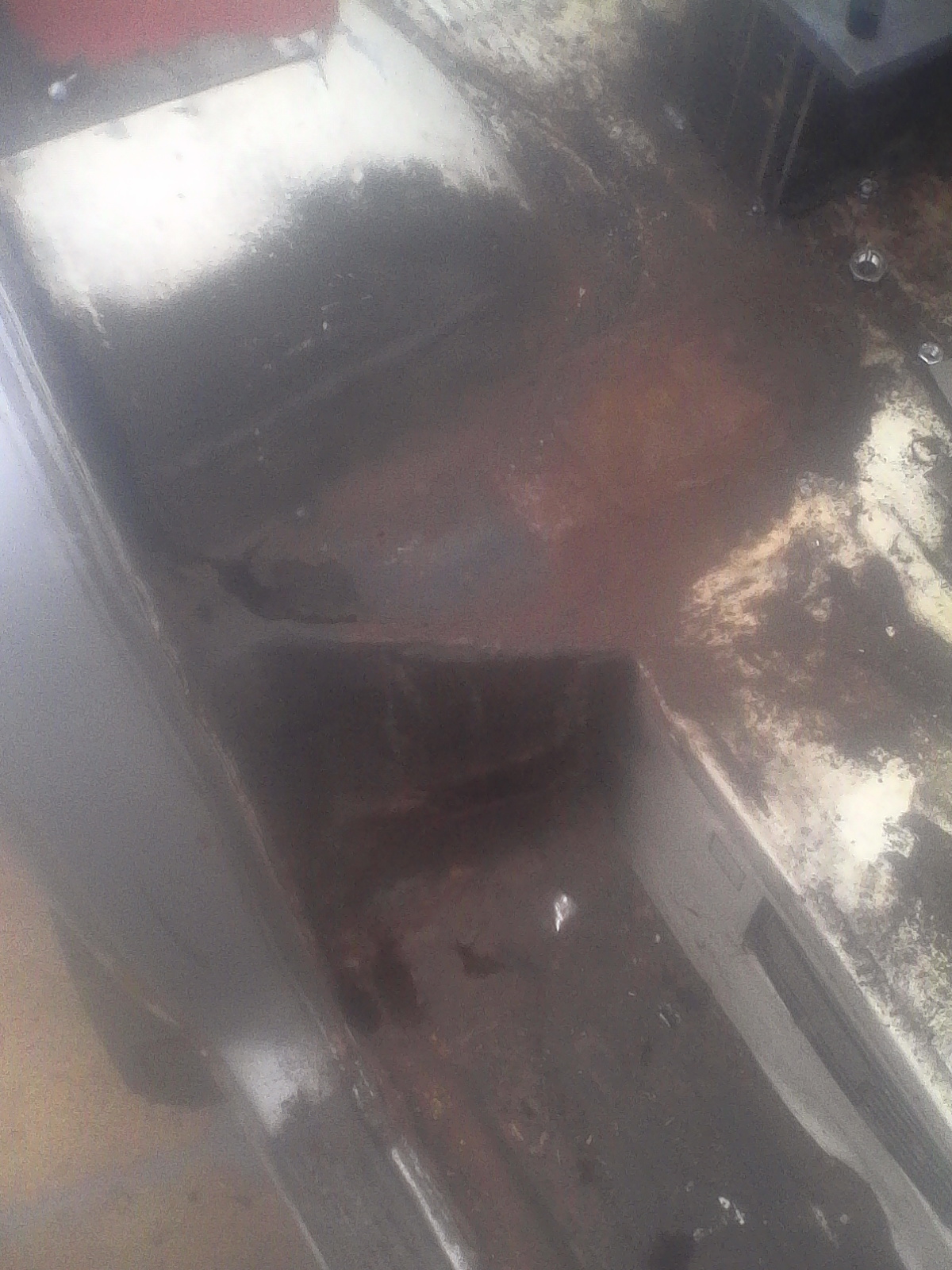

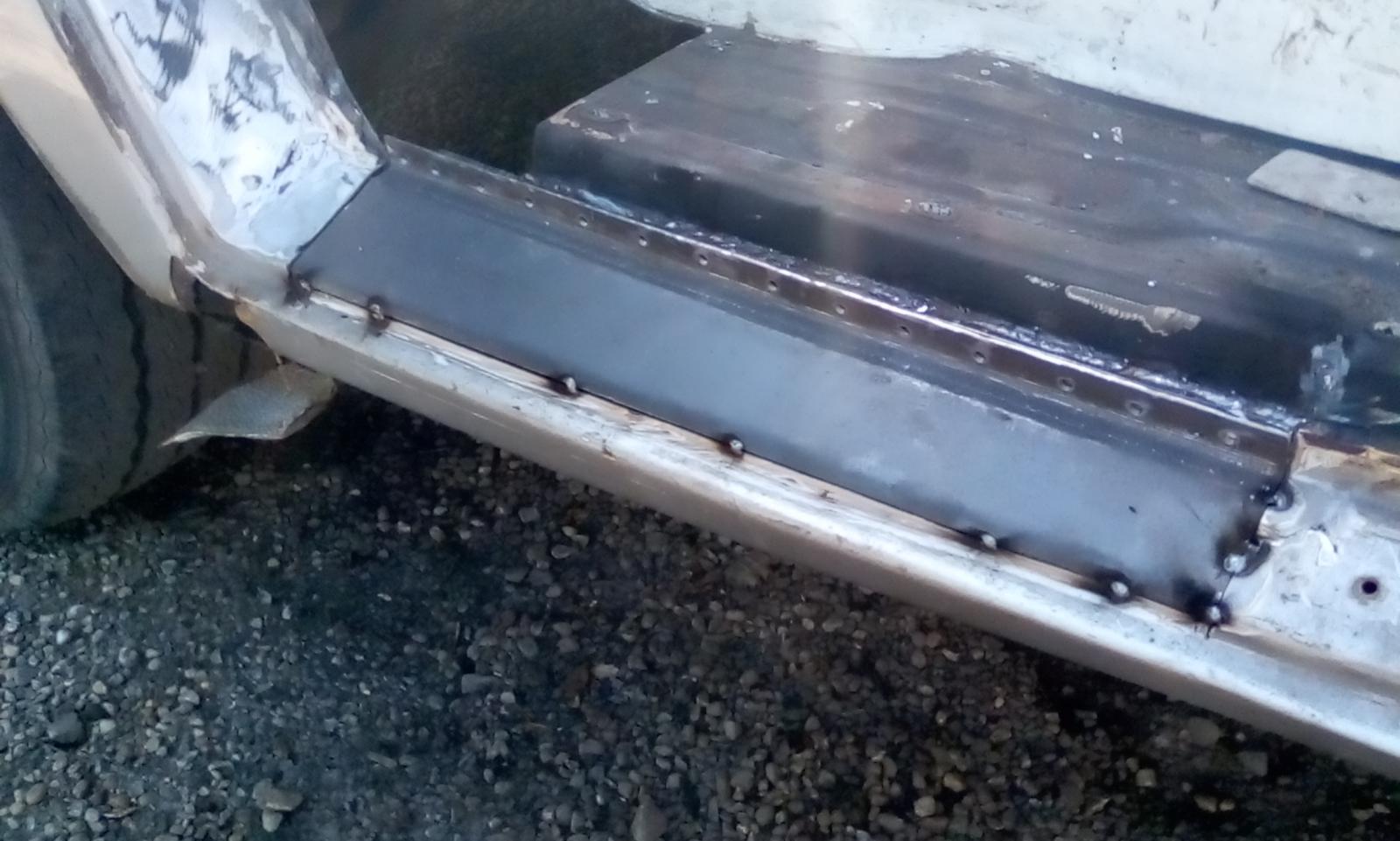

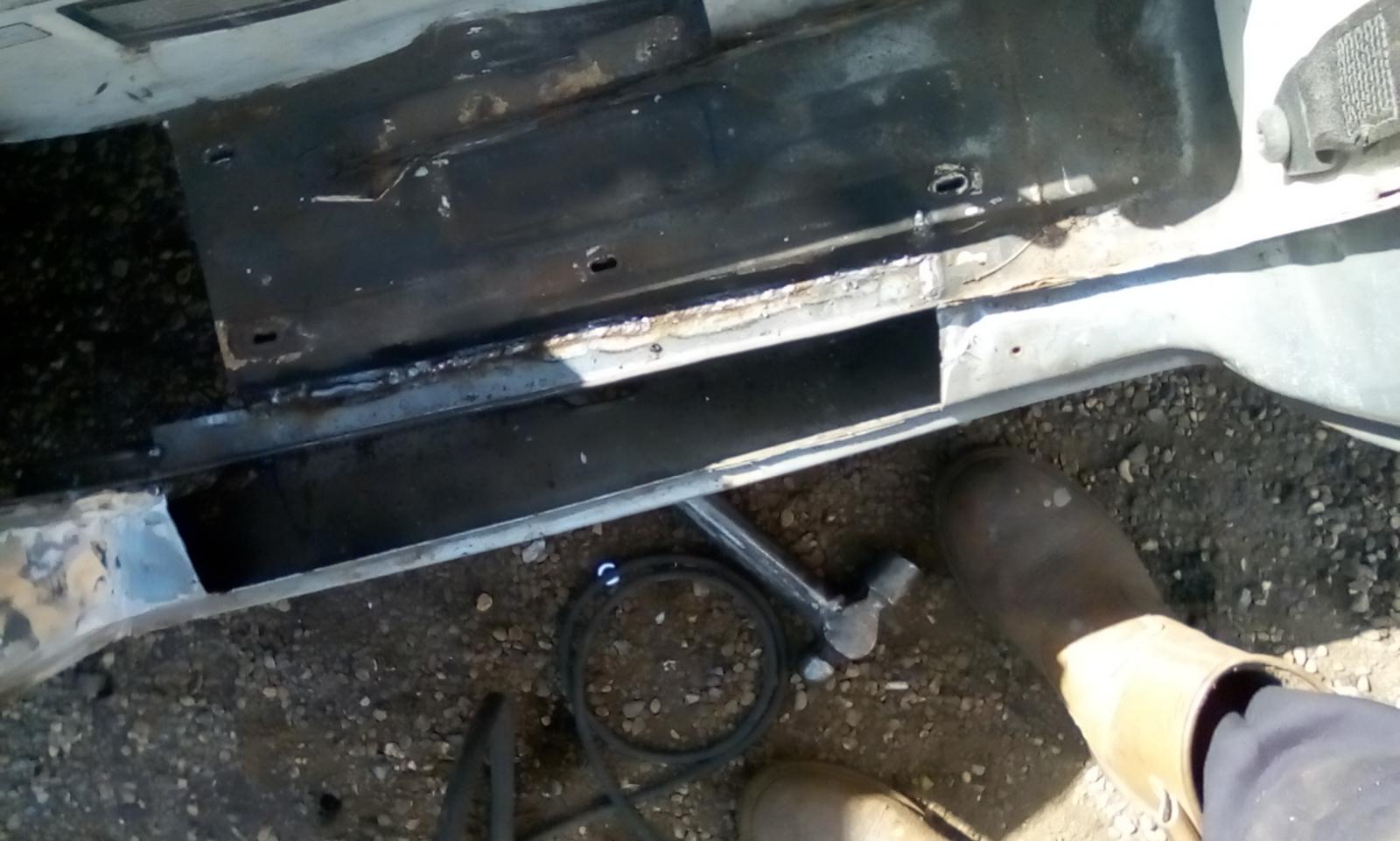

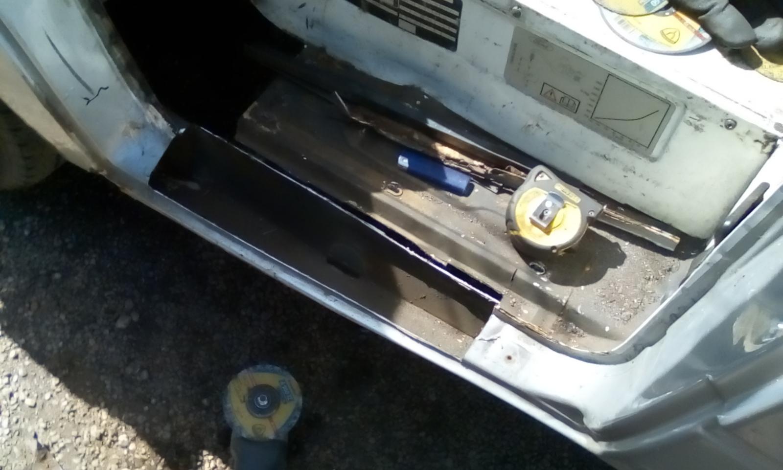

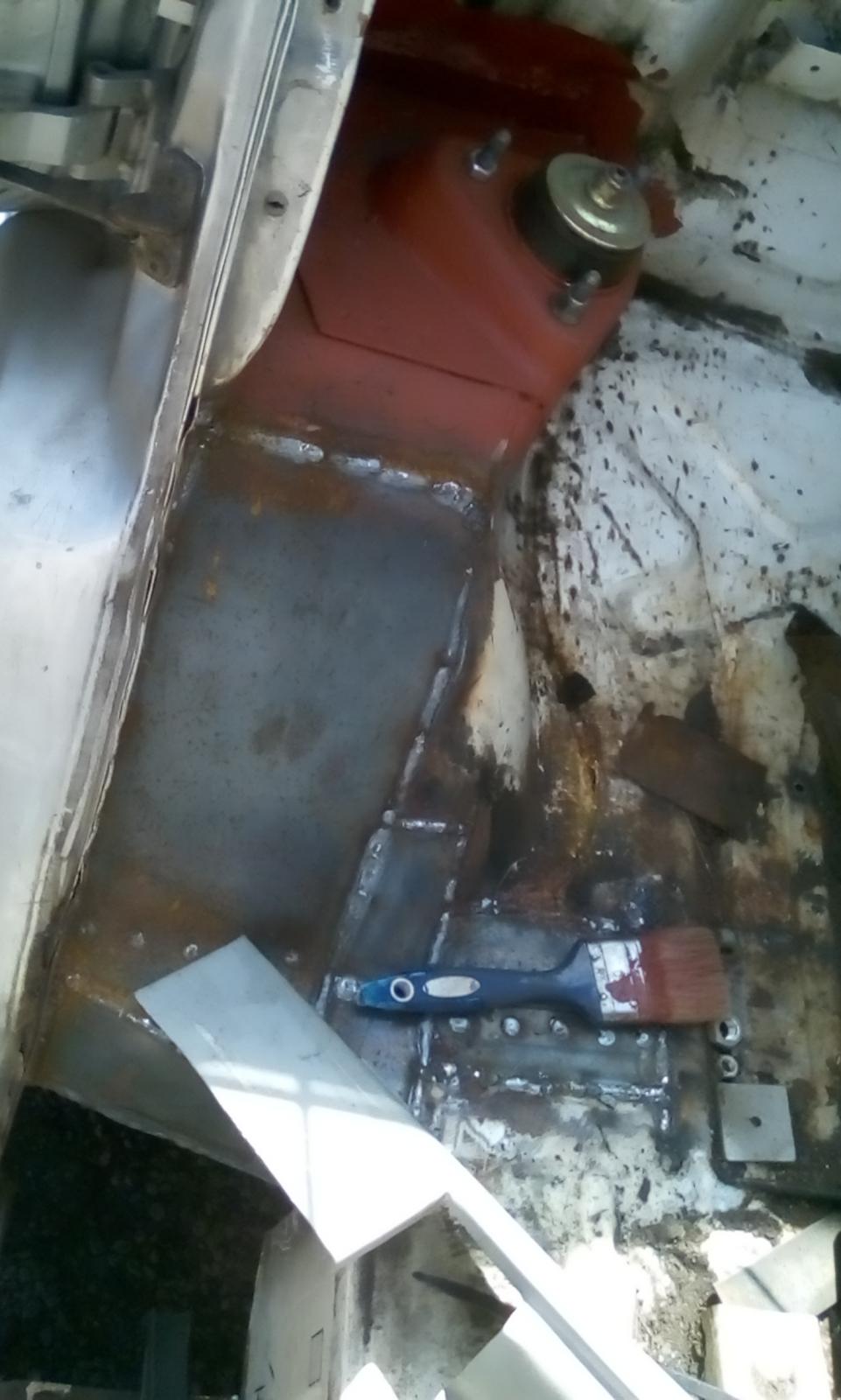

after pissing about with the camera settings on my new phone i chopped out the rotten channel on the step and cut back the sill prior to removal

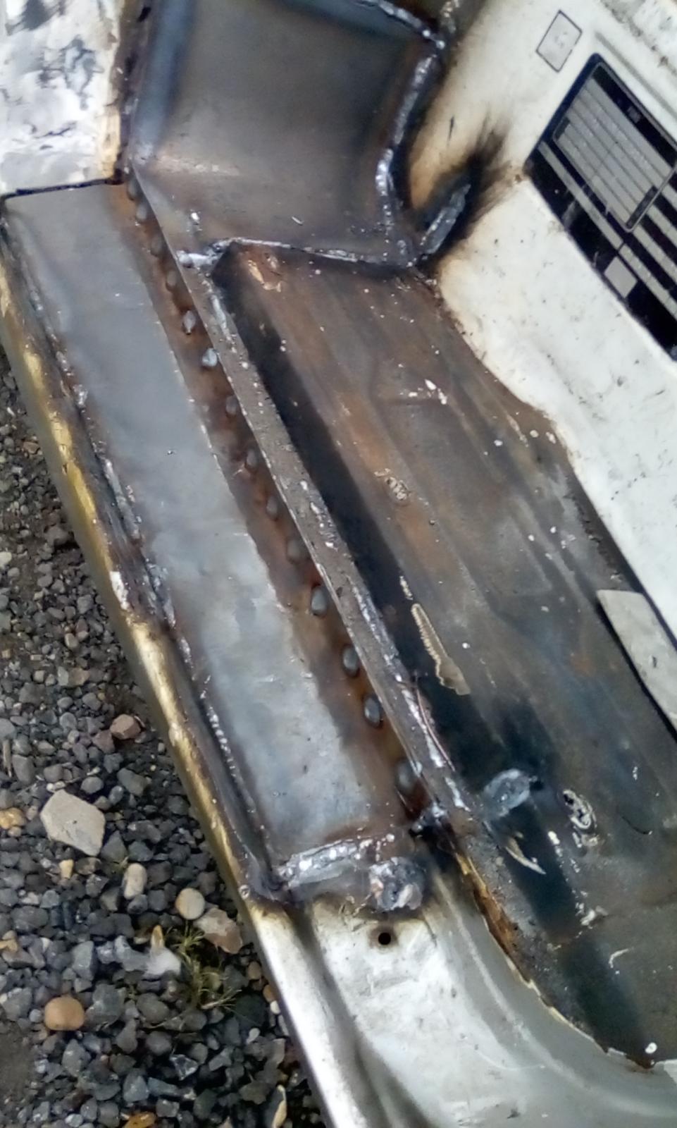

folded a section and welded the channel back in

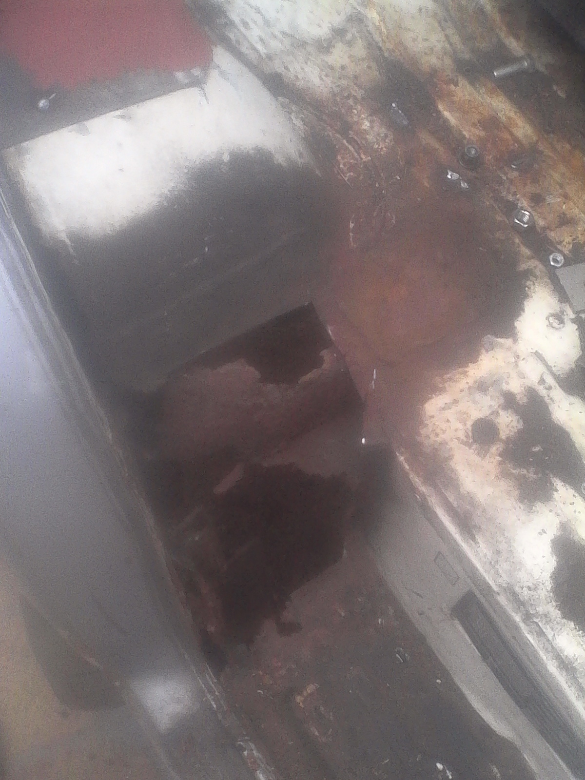

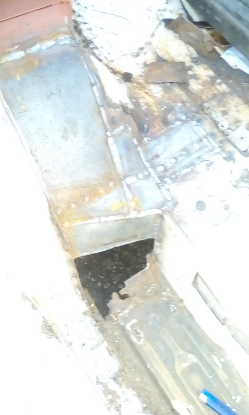

the inner and outer sill is pretty solid apart from the top flange and the front few inches which are replaced by the outer arch repair panel, so i made a piece to fill in the top of the sill
bit more weldy weldy and a huge amount of bashy bashy to make the curved infill section and bobs your uncle

not as tank like as it looks dave, mostly in 2mm-ish a little thicker than oem but a lot thicker than the flimsy pattern panels i have bought - hence the repair of the sill rather than using the panel i paid good money for :roll:
