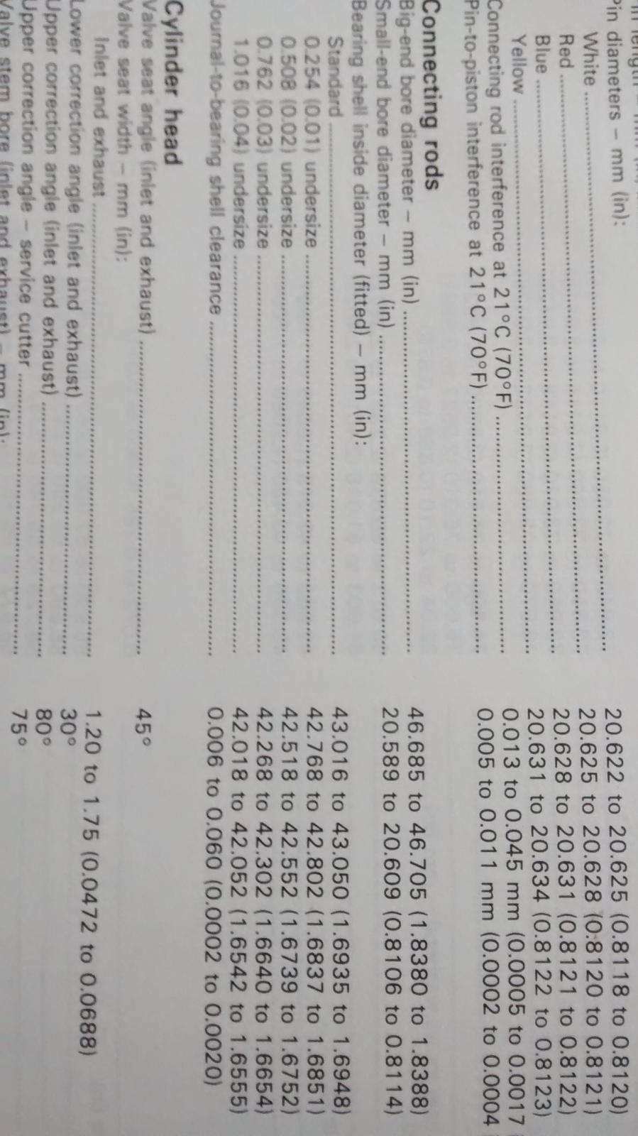

no just the ends moving on the crank....what should i look for in the haynes to check it
Connecting rod side play. But I don't think there is a specific measurement/tolerance for it.
At least I have never seen anything to that accord.

Sorry, I'm surprised there isn't a measurement. If you can't find what you need on the internoodle then maybe call a local engineering shop, they should be able to give you some idea of what's acceptable. I think you need to try and measure it though, so you know exactly what you're dealing with.
