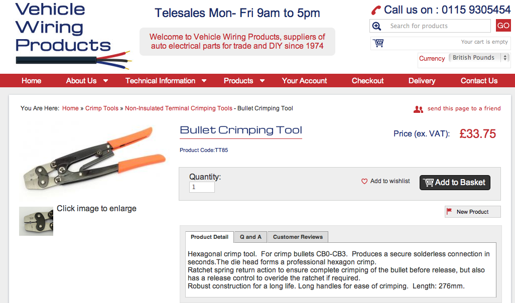

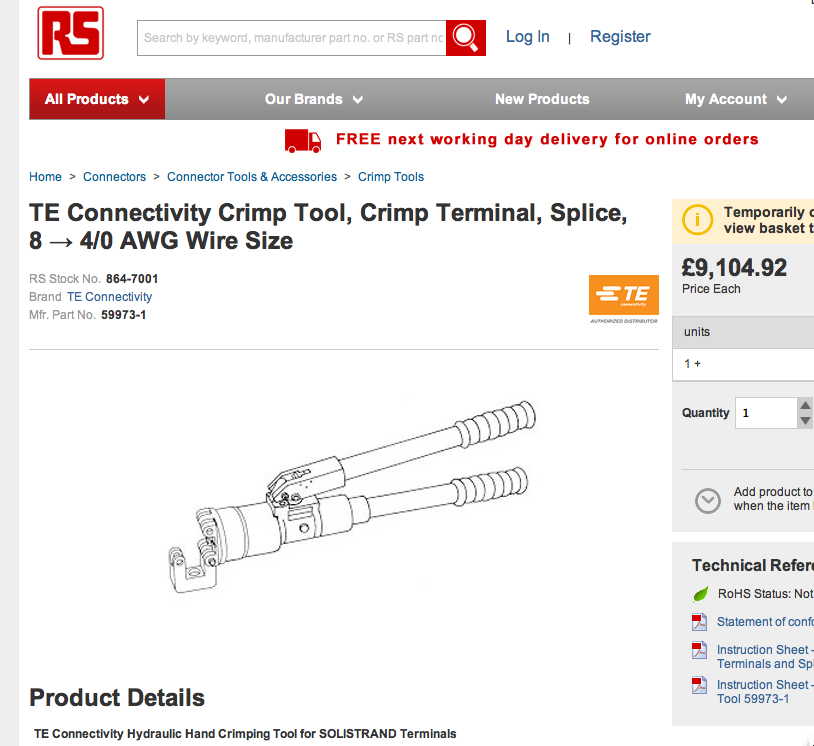

Asimo Posted May 22, 2016 Posted May 22, 2016 There certainly are tools that do this.The difficult bit is finding exactly the one that you need for the terminal you want to re-work. The tool has to be matched to the connector crimp / wire diameter because the difference between squeezing the crimp not quite enough - just right - too much is very small. They are also relatively expensive. Some of the ones I use at work are many hundreds of pounds, 30 to 50 quid should give a good choice of car- specific tools. Find a good vehicle electrician and ask what tool they would recommend - carefully! I just clean things up and solder, throwing the connectors away if they are corroded; splice joining the wires with solder and insulating with adhesive-lined heatshrink sleeve.

hairnet Posted May 22, 2016 Posted May 22, 2016 https://www.machinemart.co.uk/c/crimping-tools-fastener-sets/ these type are good cos you cant over crimp and squash them
steveo3002 Posted May 22, 2016 Posted May 22, 2016 ? cant see anything wrong with the question ? I am confuzzled...........i took it that you wanted to re tension the securing tabs/hooks they posted crimping pliers for fitting them? unless i miss understood too
noseypoke Posted May 22, 2016 Posted May 22, 2016 Don't know where you are in the country,but try RS SUPPLIES,They have shops in most town centers. hauserplenty 1

PhillipM Posted May 22, 2016 Posted May 22, 2016 I think it's the actual bullet ends he's having issues with, not the crimps?In which case, the answer is - never use bullet connectors. They're terrible, terrible things, cheaply made and loose their spring and deform from vibration, use spades instead.
