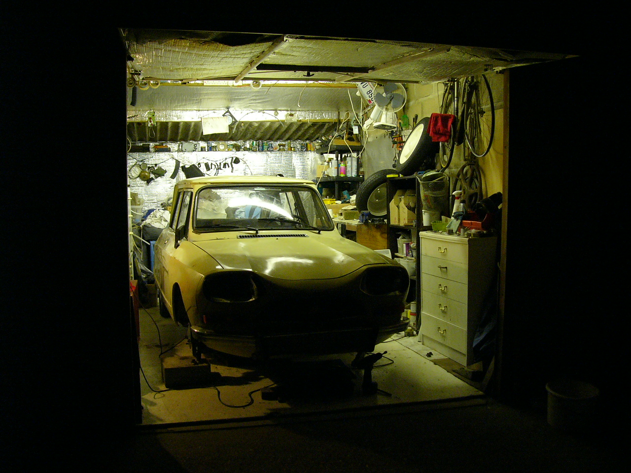

Bfg Posted January 20, 2017 Author Posted January 20, 2017 .No, I'm saying it's too firk'n cold &/or wet + those other excuses .. for this ol' giffer to work outside ..right now. "Thick sheets of ply to level things out a bit?" perhaps plywood with deep pile carpet ? I've done what I need to the steering, to get the car through an MOT ..so for now ..priorities swap around.. to replace the tyres, sort out the exhaust and electrics ready for the MOT and thereafter UK registration. That is the primary objective right now. Thereafter, as and when the weather allows paint to dry., the exterior panels have to come off to paint their undersides, and the underside of the body tub. They'll then have more pu sealant to seal off all the moisture ingress gaps. And at the same time adjust panel shut lines. Then I can set about wax-oiling inside the cavities. ie., to stop the car from rusting away - This being the secondary objective. In the meantime I can be looking out for the parts I need to sort out this steering rack. Only then, will I go back to correct things I'm not happy with, and otherwise move on to vehicle cosmetics. The tertiary objective being both to make the car reliable and to look ..er., better.!? And there again, 'in the meantime', I have two Sunbeam motorcycle engines to rebuild (in the warm n' dry ) and an old boat's interior and systems to re-do ..again in the warm n' dry I'm not laying in bed all day ! ^ 'nother job done ^ 'nother job done ^ 'nother job in the process of.. Uncle Jimmy and beko1987 2

Bfg Posted January 20, 2017 Author Posted January 20, 2017 .^ Not much to report on today, but with front wing readjustment and a little modification of the door itself, straightening the door seal's flange and refitting the seal properly ; the driver's door now shuts sweetly ..without scraping on the front wing shut, or bending the A-post hinge mounts !. So then I moved onto electrics.. front indicator earthing issue, main and indicator beam tell tale not working : wire off the main beam and dicky connection on the indicator relay. Unfortunately to get to the main beam's tell-tale - the dash had to come out.. And it's not a job I want to do very often.. I also choose to reconfigure the earthing to the rear light as beforehand it was a sod to assemble. Tomorrow I'll grease the wiper spindles, and then attempt to put the dashboard back together again without cracking the old plastic ! ^ the half painted bulkhead / floor white/grey looks interesting ! ..but as the paint is taking so long to dry in this cold weather I decided it best to leave painting the other half until after the car is tested. My old Jag had two knurled screws to hold the central part of the instrument panel closed. With those undone it hinged open for easy access to the wiring, instrument bulbs and fuse box. Oh why can't all cars be like that ? p.s. I think the furry ball thing dangling from the mirror was a leaving gift from Jani's daughter Larisa. lol Uncle Jimmy 1
Bfg Posted January 21, 2017 Author Posted January 21, 2017 .I had just a few hours working on the Ami-S today, and it took all that time to grease the wiper spindles and the motor gearbox. ^ as seen in the photo of my last post - the wheel boxes have link arms on the Citroen rather than Bowden cables, as was commonly used on British cars of this era. with link arm removed it looks like this. However the box doesn't have to be disturbed to remove the spindle and re-grease it. ^ The grease was baked on hard ..When trying to prise it out - I wasn't sure if some other locking device, like a circlip or split pin, had to come off before the spindles would pull out - they were that tight (no., there was no circlip nor pin). On one spindle the o-ring (water seal) had disappeared and on this side it was crumbling. Water had got in to the wheel-box and as a consequence the spindle suffered light corrosion. ^ cleaned up, with new o-ring (which I had to hand file to fit in to the wheel-box's hole !) before lots n lots of grease was stuffed down the hole and around the spindle. ^ inside the wiper motor - one lump (of grease) or two ? Note the puddle of oil in the other chamber which had separated out from the grease. I don't know how to stop the grease from moving away from the gears like that, so when repacking I used soft general purpose grease ..and lots of it. The wiper motor's link arm was secure but loose ...insomuch as its washer (which like the arm has a slotted hole rather than a round one) was not seated correctly - so the arm was free to clunk back and forth as it went around. Getting the wiper motor back in place was a sod, because the furthermost fastening is a short 7mm bolt with a small washer, and it's so close to the bulkhead that one can neither see it nor get a hand to it.. It also screws into the aluminium casing of the wiper motor and being fine threaded was ever trying to go in cross threaded. It was probably a very easy on the production line - with the windscreen out, but this one bolt took me the best part of 3/4 of an hour to get in. ^ all going back together again. btw. the block sander you can see through the windscreen was in lieu of a helping hand - to hold the now clean and freshly greased spindle in the hole while I attached it's link arm. It is now that free moving. So that was it for today. While out, I did buy some bulbs for the front sidelights (small size 12v 5w) as both had gone. And I noticed the speedo cable's screw head has pulled off the cable, so that'll be a first task to fix on Monday morning. ..Little by LittleBfg RayMK and Uncle Jimmy 2
Bfg Posted January 25, 2017 Author Posted January 25, 2017 .Little by Little I'm getting closer.. ^ speedo cable, end had become detached ^ driver's door courtesy light switch, the cable was on the parcel shelf and needed to be re-fed ^ dashboard back together again. ..Bitch of a job ..and I still think it looks shit (not even Shite) ! ^ electrical earthing of these rear number plate lights is supposed to be via the rear bumper. Crud was the barrier. 12v 5w bulbs are the same as those used in the front side lights. I've also spend a little time securing the wiring under the back of the car ..(having removed the metal gripper clips 'cause their teeth grip through the chassis paint and allow it to rust !) I've now secured the exposed wiring with cable ties. ^ Imo black rubber bumper overriders are just so flippin ugly., make the car look even more tall and gangly, and attack me as I move around the car in the tight confines of this garage.. so I got rid of them (so far only on the rear but the fronts will hopefully get lost tomorrow.. All the lighting & wiring now works as it should (except the timepiece has expired).. And thankfully I don't need rear fog lamps because of the age of this car. And I've welded a blow hole in the exhaust / carburetor pre-heat pipe. And because I'm skint this month, I've been swapping the wheels & tyres off the Dyane (just for the MOT). LHD drive headlamps. This'll do for the MOT And talking about MOT's - the car's booked in - for tomorrow at 2pm.. : Got a few jobs to do yet before it goes, like put some water in the screen washer bottle and hope the pump works., finish swapping wheels & tyres (two to go), and then check the exhaust system and adjust where touching the chassis or else slight leaking at joints. But I'm getting there ! oh yeah I might even run her up n down the lane before venturing out on the open roads.. Fingers crossed for tomorrow mat_the_cat and Uncle Jimmy 2
