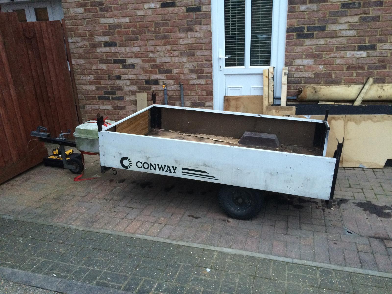

my latest thing i did collect....
....is not a car,.  but is definitely shite.
i picked it up for a measley £25.
the guy who i bought it from has started to try and build a box trailer, using that well known waterproof material - chipboard!  needless to say, it weighs a bleeding tonne, and is like a sponge.
it used to be a trailer tent, and all the mechanical bits look ok, so i cant really fail to recoup my costs later on.  the plan at the moment is to strip all the wood off, and then turn it into a motorbike trailer as cheaply as possible.
if anyone has done similar in the past and can offer any wisdom, please feel free to chip in with any ideas :-)
i'll post updates as i go if anyone cares lol
Lee

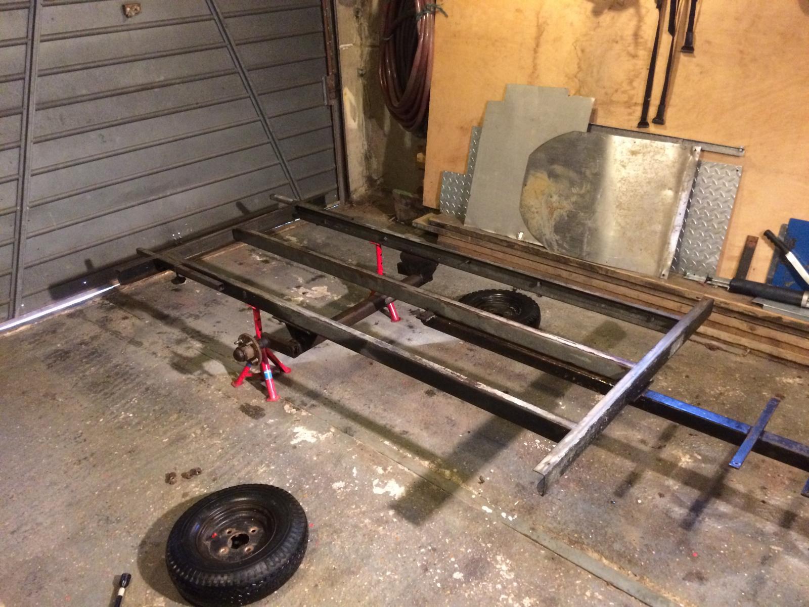

First off, remove chipboard,
Then remove old trailer tent body,

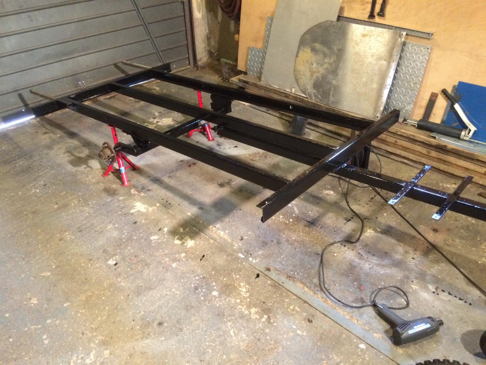

Then paint frame,

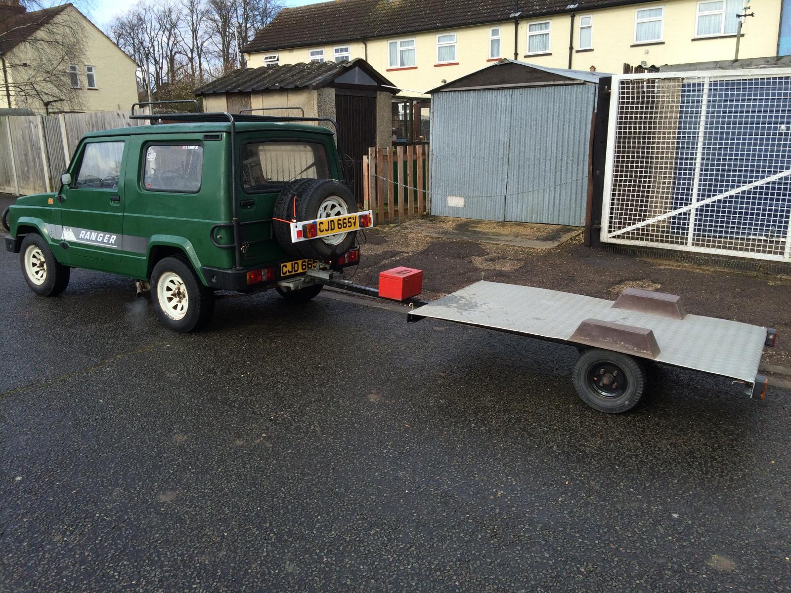

Then add some freebie chequer plate from work.....
Almost finished, just a few additions to make ðŸ‘
