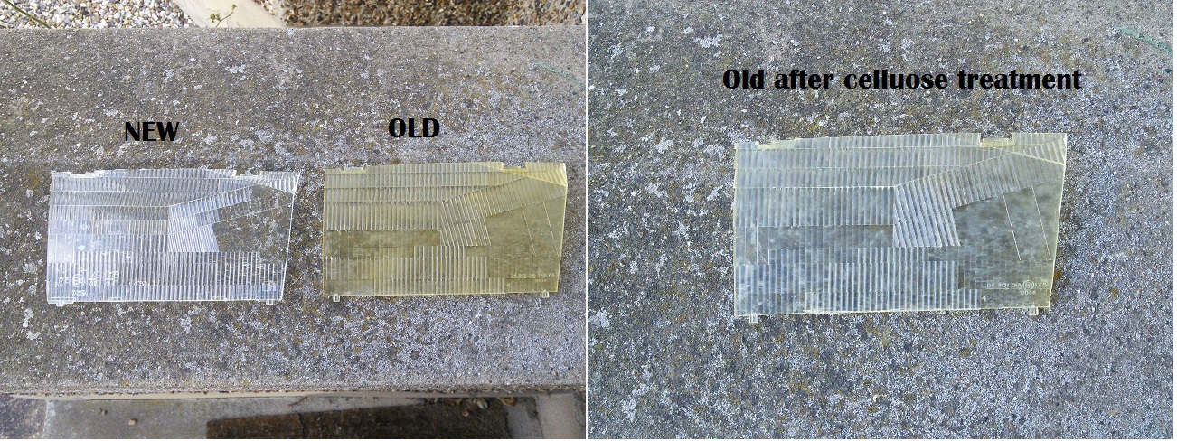

big bottle .. saturated !
Don't stop mid wipe ... Wipe it  fast and leave it . if its not cleared ,wait before doing it again .
I tried this on my Mondeo reflector (just removed for a new one) - and it was pretty effective, so thanks for the top tip (pic below). Had to buy the thinners - and did about 4 runs over this using about a quid's worth.

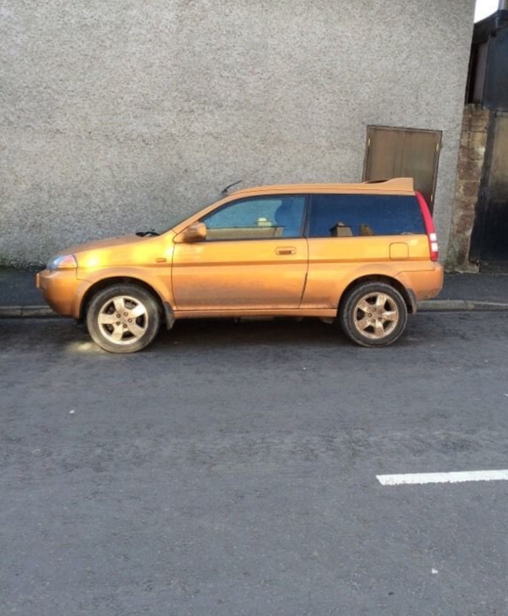

I like the look of these. One popped up for sale about half a mile from me yesterday.post-5582-0-62079200-1456657333_thumb.jpg
They're after £550 with very short mot.
Mot history check says it failed last year on suspension prescribed area corrosion both sides so presumably has had some welding done.
I should resist the urge but might go for a look later...
